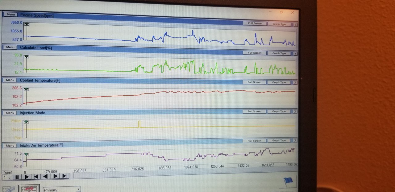

    So why I dont see more Port activity on this sample? Long idle, freeway drive, idle at the lights, rpms below 2500
    How to catch a cleaning cycle, cause I have not seen one yet for 70 miles driven?
    Thanks

    OVTune
    OVTune [OP] Well-Known Member
    Mar 27, 2017
    #214557
    8,112
    OVTune
    Send me the CSV.
    also I don't see your engine under 100* on that graph anywhere.
    GreyBaldTaco and xxTacocaTxx like this.

    Vlady
    Vlady Well-Known Member
    Dec 20, 2017
    #238986
    4,438
    Issy, WA
    2017 White SR5 DCSB V6 4x4
    Will do.
    Techstream started a few minutes after startup.
    Thanks

    OVTune
    Mar 27, 2017
    #214557
    8,112
    OVTune
    try again with the engine colder and you should see more port injection activity.
    Also, load stock tune again and check. It will use Direct injection almost exclusively after about 2500 rpm.
    MOC221_ likes this.

    Vlady
    Dec 20, 2017
    #238986
    4,438
    Issy, WA
    Nope. Stayed in Either for 15 sec and went to direct. 60F in the garage
    It is running now. Will share the data in a few

    OVTune
    Mar 27, 2017
    #214557
    8,112
    OVTune
    Either means both, so that sounds about right.
    Port *alone* is rarely used.
