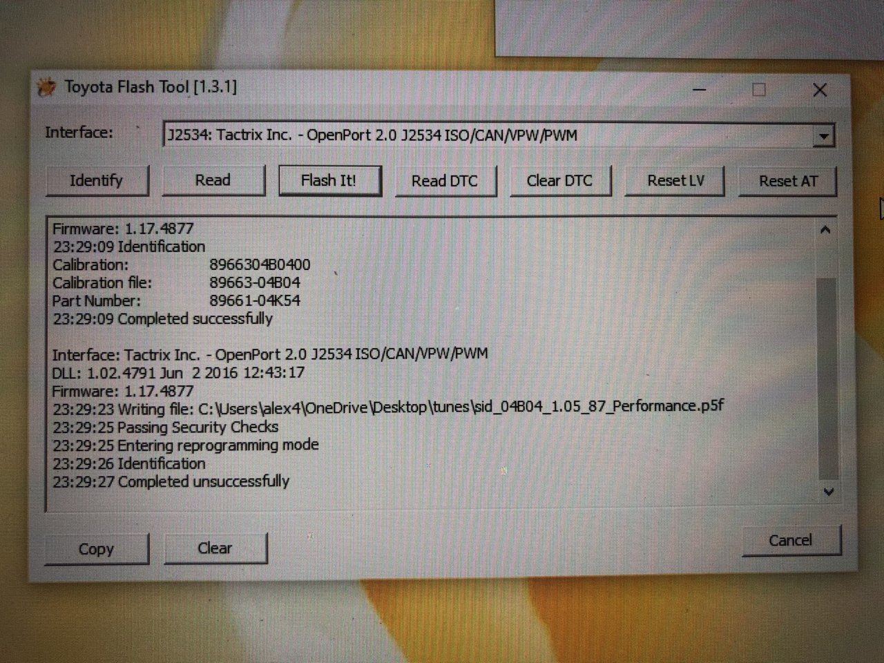

    Can anybody explain why it was unsuccessful?
  7. May 10, 2020 at 1:23 AM
    2017TRDpro
    2017TRDpro Well-Known Member
    Apr 16, 2017
    #216440
    555
    2017 TRD Pro
    Make sure your battery is good. Turn off your truck, turn key to on and try to flash again. Some users get flash successful after a few tries.

    Update your flash - I think the latest version is 1.3.0, not 1.3.1.

    I’m having the same issue. Keeps saying No response and crashes. Downloaded 1.3.0 and p5flash isn’t an option available to click on anymore.... @OVTune
    Tried to re download program and p5flash.when I go to flash a file it says not supported

    I just had this same thing happen trying to flash 2.0 to my 2020, didn't know if it was a success or not so I tried to start the truck, it turns but doesn't crank. Where can I find the stock 2020 p5 file? Whenever I try to download something it says download failed.

    Frustrating. This used to be very easy to flash. Now I just get There was a problem preparing selected file. Probably corrupted or has unsupported format. Yey

    Okay guys. This fixed it for me.
    go into your flash manager.
    Click help.
    Click update.
    Should then be 1.3.0 and you should be good with no errors.

    if you have an aftermarket radio that has OBD2 connection(digital gauges) you need to turn OBD connection off in the headunit until you flash then you can turn it back on when done. i have a pioneer 8400nex or any of the top shelf models that have gauges should have the same issue.
