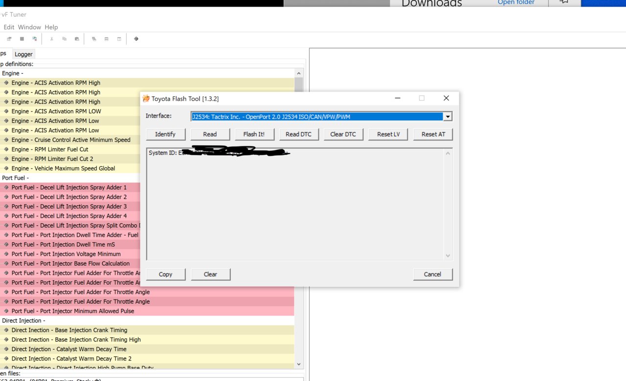

    I'm running into an issue trying to flash with getting `completed unsuccessfully`. Battery is older and voltage sometimes falls to 11.9, but I've tried flashing while voltage holds 12.3+ and still getting that error. 4x4 MT using the .vft files if it makes any difference. Is there a certain voltage threshold the flash manager requires before actually flashing?
    I'm using macOS Catalina with Parallels Windows 10.
    Here's the log:
    Code:
    Interface: Tactrix Inc. - OpenPort 2.0 J2534 ISO/CAN/VPW/PWM
    DLL: 1.02.4791 Jun  2 2016 12:43:17
    Firmware: 1.16.4769
    08:19:57 Writing file: \\Mac\Home\Downloads\04B81 v2.0 Final VFT\04B81_Premium_Stock.vft
    08:21:03 Passing Security Checks
    08:21:03 Entering reprogramming mode
    08:21:04 Identification
    08:21:05 Completed unsuccessfully

    Are you using the flash utility from vf? Or the one from flash manager?
    vft files need to use the vf flash utility 1.3.2

    I'm using the Toyota Flash Tool 1.3.2 inside vF Tuner.

    Can you identify sucessfully?

    yep, identification completes just fine, that's how I sent Mat over my calibration info.

    Your signature says 2016 tacoma but looks like you are trying to flash 04B81?
