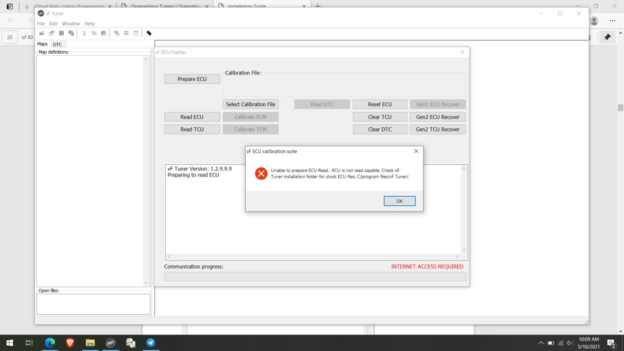

    Alright, got up this morning before the graduation party to see if I can at least get licensed, and uhh, well... Yeah.
    Ran into this first during Read ECU.

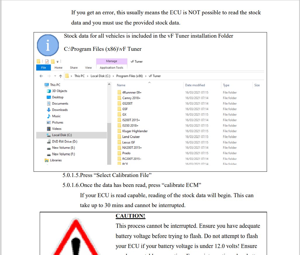

    I already had the guide open behind vF and it states:

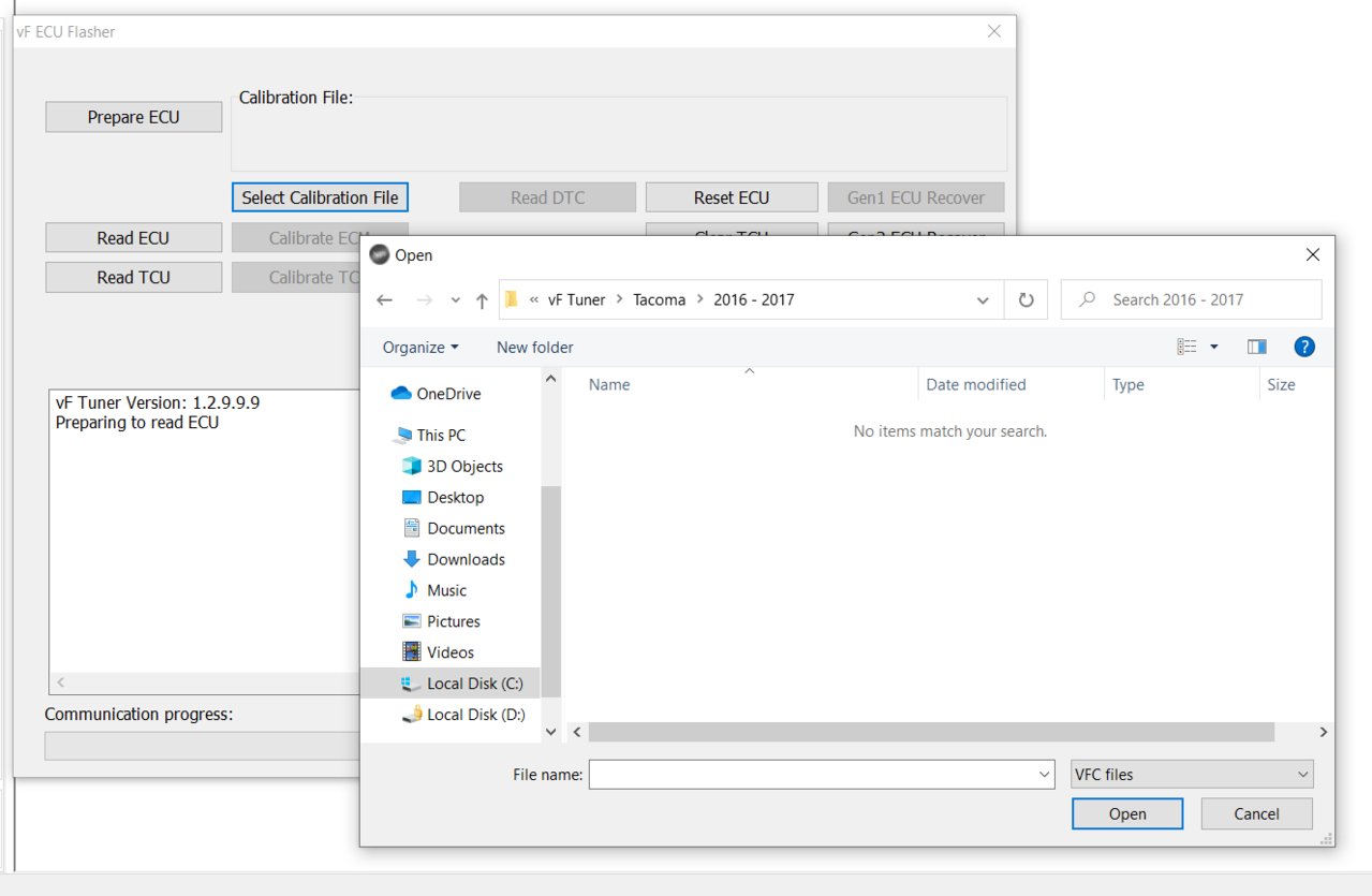

    So I went there with the Select Calibration File to see if I can load up 04B04. But, it appears this version only looks for .VFC files, not the .VFT files that are present in the stock tunes folders?
    Do we need to have those stock calibrations updated to .VFC? And in the meantime, does this mean I need to do the manual licensing method? Sound like it's very picky on typos.

    2. You cannot read your ECU if you have previously tuned/flashed it. And if you know your ECU ID, which it looks like you do, there is no reason to try to read your ECU.
    Though if this is the case, it appears it will not pop up to ask to license the VIN as stated in the guide.
    5.0.1.4.On the popup, press "Read ECU" button This will gather the basic information about your vehicle as shown below. The “ID” is your CALIBRATION or ECU ID The software will then ask you if you would like to license the vehicle (4 credits are required)

    @BrettsMac08 - I ran into the exact same snag this morning. I did some reading through the various VF threads, and I think (don't trust me) that the textual instructions are wrong, but the picture in the instruction is correct. I think you're supposed to click "Prepare ECU" rather than "Read ECU".
    I took a chance and pressed "Prepare ECU", and after a few seconds of processing, I got a pop-up containing my VIN asking if I want to register it. I clicked register, which charged 4 of the 5 VF credits, all of which seems to be correct given the other posts I've read.

    Hit prepare. Not read

    Hitting Read pulls a copy of the stock tune file and hasn't been necessary for years. Used to be we'd need to do that and provide it to OVTune as part of the tuning process so he could verify ECU ID I'm assuming, in case you had an unsupported ECU version

    Quick question for @OVTune - for those that are getting the new Flash/Log vF Tuner (I got mine, yay!) what files are we expected to be able to flash or do we have to follow up in our email to request a tune pack in .VFC format? I notice all the stock files in the program directory are still .VFT and cannot be flashed. And since the 2.0 files many of us have are in .P5F format, we can't change our tune if we wanted to with the new software. Seems that we may get stuck with software to flash, but no flashable tunes?
    I'm alright as I have a purchased one I just successfully flashed but if I had the desire to go back to 2.0 base or had my gears changed etc, I could not. I also cannot go back to stock either, as the format isn't recognized for flashing.

    All VFT stock files will be VFC when 1.3 is out to eliminate any of that confusion. Makes it easier going forward to just have 1 single file type.
