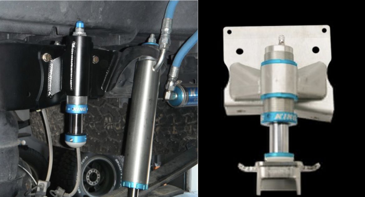

    That's funny, I'm actually right there with you on being super anal about mounting solutions. I got my front and rear Kings custom made with different hoses and reservoir lengths specifically so the mounting was just right. If anyone is interested in at least some nicer looking clamps, check these out. I think I may order some and see if they will work for my from reservoirs if nothing else. --> https://www.phase2motortrend.com/product-p/p2-ahcblk.htm
    I'll PM you directly as well, I don't wanna muddy this thread up because I would imagine 99% of people could care less about the mounting.

    General question here, I'm about to pull the trigger on some King Air Bumps to get done at the same time as the relo install. Why has no one tried to fit 2.5" bumps in there, is that just because there is no off the shelf 2.5 kit? Or will they just not fit? Of course the 2.5's are weld on fixed only.
    Then on the next question, should I go with the threaded *2.0 only*, or standard fixed barrel *2 or 2.5.* I will be running the 2x12" kings.

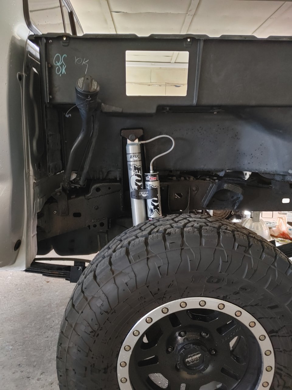

    So you don't want to mount the Fox resi to the tower? We do have a new offering for 304ss resi mounts, they still use worm clamps but clamps slots are a little wider spacing, maybe you could bolt these to the bed side
    https://archivegarage.com/explore-archive/ols/products/shock-reservoir-mount
    Personally, I am really satisfied with how it came on @jstemp 's install:
    https://www.tacomaworld.com/threads...x-12-2nd-3rd-gen.709229/page-15#post-26692700
    wi_taco[QUOTED] likes this.

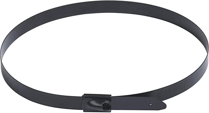

    The Pirate
    The Pirate Takoyaki Takoma
    Feb 15, 2019
    #283117
    358
    These are black plastic coated stainless, I bet they would look pretty clean.
    https://www.amazon.com/Supreme-Polyester-Stainless-Cable-Ties/dp/B084T5C3YS?th=1
    wi_taco[QUOTED] and ARCHIVE[OP] like this.

    wi_taco My skid plates give rocks taco flavored kisses
    Jul 20, 2020
    #335129
    4,117
    Adam
    SE Wisconsin
    2015 Toyota Sienna with rear locker
    Ooh those are an interesting option, I like it. Thanks!

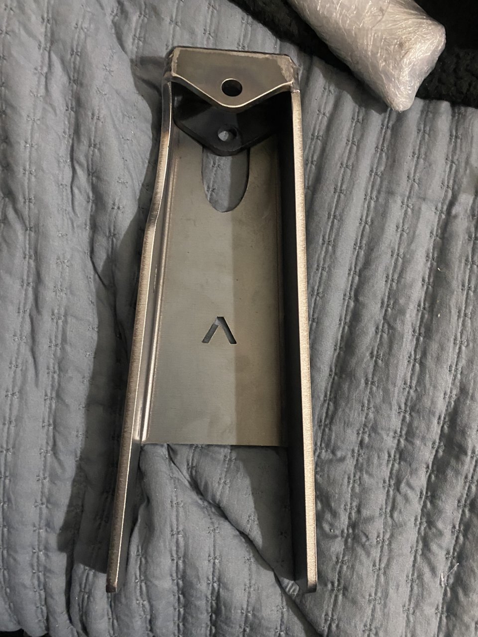

    @ARCHIVE are those resi mounts bolt on? Looked that way. I think if they are id rather tack weld em then drilling more holes in the frame.
  19. Feb 22, 2022 at 11:48 AM
    #319
    ARCHIVE
    ARCHIVE [OP] Well-Known Member Vendor
    Oct 29, 2015
    #168099
    2,253
    Eric
    Orchard Park, NY (Buffalo)
    '05 Taco, '22 Tundra, '91 Cummins
    2.5" Fox relocation * Hammer hanger * Archive MD springs
    Bolt-on, drill two 5/16" holes is the recommended install, then the frame can be cleaned behind down the road
    wi_taco and Brian422[QUOTED] like this.
