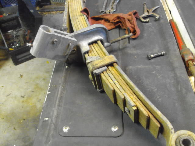

    HA! On the very first post in this thread....vvvvvvvvvvvvvvvvvvvvv
    Chevy S-10 1 ton , Factory SUA.......vvvvvvvvvvvvvvvvvvvvvvvvvv
  18. May 20, 2012 at 12:16 AM
    #558
    4WD
    4WD [OP] cRaZy oLdmAn
    Jul 2, 2009
    #19185
    23,530
    Doug
    Lakeside, Ca / Gardnerville, Nevada
    2004 DC TRD 4x
    Grey wire MOD, deck plate, diff breather MOD, 2nd gen. OME 883# on Tundra 5100's, OMD custom 3" leafsprings, rear shock relocation, Ivan Stewart TRD rims w/285/75/16's, '02 bumper MOD, Famous Fabrications sliders , LED interior/exterior lights, bed bar, Custom tube bumper, Old school KC day lighters,Red Ring 8" HID flood, Kenwood vhf 2M.. umm some other shit I'm forgetting right now
    Did I call that shit or what ??..;):D
    Seriously though , when I saw this beautiful (surface rust & minor scaling is no issue clean up) set of springs I thought holy shit the possibilities
    & I encourage Ryan to do the same, these fuckers just may bolt right on to a 5 lug, no shit, or real close, maybe no hangers to relocate
