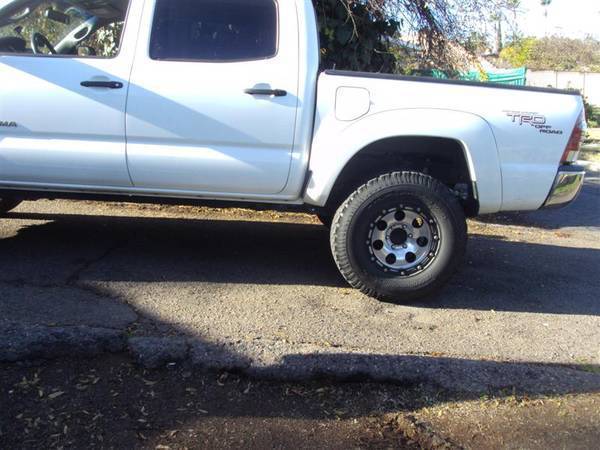

    Before, stock 2 leaf w/overload, no TSB...
    After...
    We measured before & he was 21.5" from top center of hub to bottom center of wheel well, after he was 23.75" for a total gain of 3" (we dumped the overload)

    He's def. gonna need extended shocks...

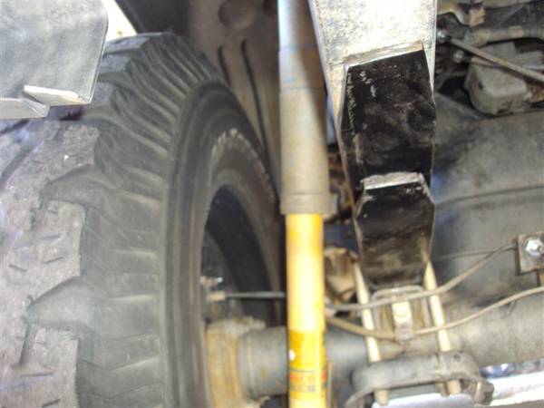

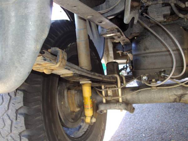

    I've been running this 6 leaf progressive & gotta say. these springs are horrible, they look nice but they ride like shit, I can't wait to dump these POS !! & go back to linear springs

    You are half right , its a spongy ride on smooth surfaces (streets/roads/some dirt roads) but they're like that by design, soft suspension until you start hitting rougher terrain then is when they ramp up & get stiffer.. There in is the problem, in this pic. I can't even stuff this tire into the well..I've got like 2.5" of shock travel left & it won't go because the springs have hit a wall, meaning that almost all the flexation is gone because of the progressive design (thinner to thicker/thicker to thinner) The other leafpack (linear) performs waaaay better in all areas from these POS's that are on now...
    & the droop isn't great either.....
