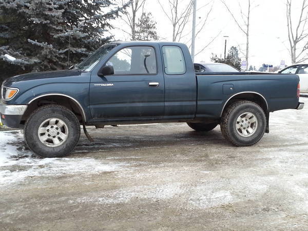

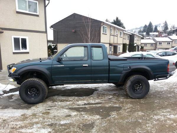

  14. Jan 21, 2013 at 7:08 PM
    #1234
    4WD
    4WD [OP] cRaZy oLdmAn
    Jul 2, 2009
    #19185
    23,530
    Doug
    Lakeside, Ca / Gardnerville, Nevada
    2004 DC TRD 4x
    Grey wire MOD, deck plate, diff breather MOD, 2nd gen. OME 883# on Tundra 5100's, OMD custom 3" leafsprings, rear shock relocation, Ivan Stewart TRD rims w/285/75/16's, '02 bumper MOD, Famous Fabrications sliders , LED interior/exterior lights, bed bar, Custom tube bumper, Old school KC day lighters,Red Ring 8" HID flood, Kenwood vhf 2M.. umm some other shit I'm forgetting right now
    Wow truck looks great !! you got 3" in front with the eibachs & looks like your level ....:thumbsup::thumbsup:

  16. Jan 22, 2013 at 6:47 PM
    #1236
    4WD
    Jul 2, 2009
    #19185
    23,530
    Doug
    2004 DC TRD 4x
    Dylans truck before 3" Eibach/Toytec coils & OMD leafspring MOD....
