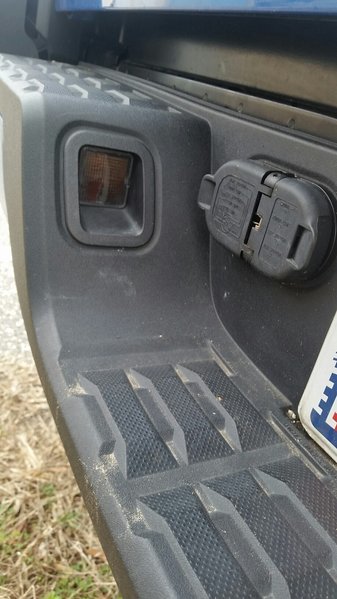

    20170301_134245_1488542143956_resized.jpg third replacement whats going on?

    Havent gone wheeling, Just the LH side ,I looked at the new one before the dealership installed it ,it has a rubber o ring to seal water out.Not sure if any others are having this problem.
    I even thought about sealing around the o ring ,but that would void the warranty.
    So I'll see how long this one will last only have 22/m.
    My wild guess they just keep replacing till factory warranty runs out.

    If it does it again make the dealer seal it up better

    Unfortunately yes, I've also been dealing with this for months now.
    The TL;DR points of what I've learned:
    • These housings have been used since 2014 in Tundras, part number 81270-0C040. Apparently with no issue on Tundras.
    • There's no left side/right side part number, but generally if yours leaks it's only going to be on one side and not the other.
    • The water apparently intrudes from the back of the housing, along the wiring harness.
    • The bulb housing O-ring itself is fine (tested by dunking a housing into a cup of water: as long as the water level does not pass the harness connector, light remains dry)
    • Dealers have no idea WTF to do, cases have been reported to Corporate, official solution at this point appears to be "keep replacing housings until customer gets bored of getting replacement housings"
    • Some members have permanently silicone sealed their wiring harness and stopped the leak
    This is partially why I want an aftermarket plate bumper, but sadly a lot of fab shops out there advertise "uses stock bulb housings" as a feature.
