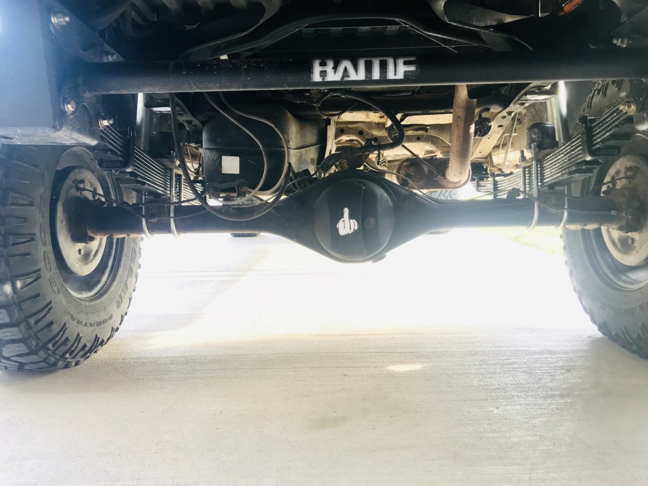

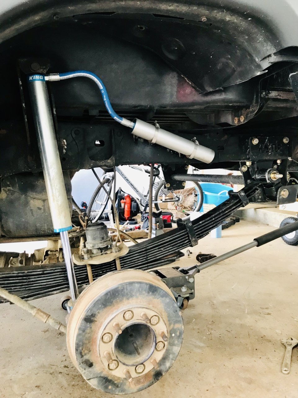

    Why not go with a company like deaver or alcan and gave a custom leaf pack built that will fit your needs better than something off the shelf?
    I had HD daks and moved to deaver stage III U402's. Much happier and zero squeaks.
