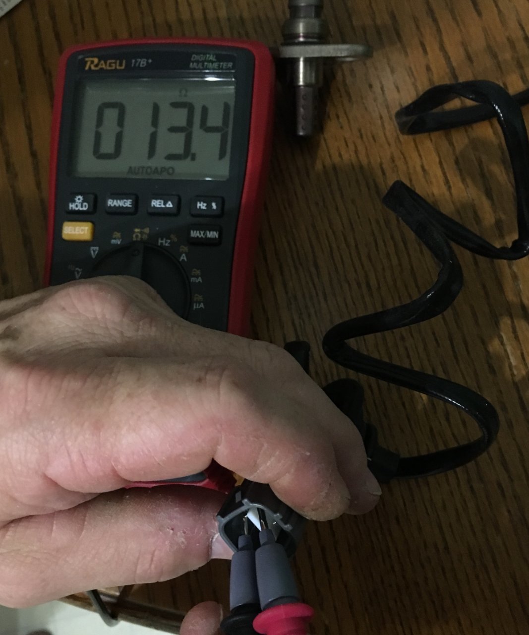

    This is a 234-4189 sensor. Checking to see if any knows the range it should be reading for a good sensor. My ohms reading is 13.4 which seems kinda high. Hoping someone may know. Thanks!IMG_E1327[1].jpg

    Thanks Currygoat! So, I am guessing at 13.4, I have a bad 02 sensor that I just bought new off Amazon.

    Ok, checked the ohms on the existing O2 sensor that is still in the truck. 14.9. So, I am guessing the new one at 13.4 is okay. I am getting the P0136 code and running the truck and putting my hand up by the sensor, I feel a good bit of exhaust air coming out. I believe that is why I am getting the code and the sensor is okay.

    https://www.yourmechanic.com/articl...it-malfunction-bank-1-sensor-2-by-jay-safford
    States that it could be an exhaust leak before the sensor...
    Looking back at the previous post I sent you, I think the guy moved the decimal point incorrectly when writing the post. My take on his post is 8.0-14.0 is ok.... but I dont know the factory spec. So it sounds like your new o2 sensor is operating within the expected ohm limit.

    Same here...getting P0136 CEL yet i pull the harness and measure and i show i am getting about 13.6 ohms. No leaks that i can tell or see or feel....
    Can the sensor still go bad and read the right ohms? I dont want to waste the money or fight the nuts if i dont have to.

    Thank you so much for this post!! I have a 98 Taco and the check engine lean bank P0170 has been on.. thanks to OP posting here and ya all's comments I was able to test the oxygen sensor.. came in at 13.1 ! thank you!

    Sorry to Lazarus this thread, but... the only valid way to test an O2 sensor is to measure voltage across it with the engine running. That voltage should be between about 100mV when the engine is running very, very lean to about 900mV when the engine is running very, very rich.
    Never try to test an O2 sensor by measuring resistance across it. O2 sensors don't work that way.
