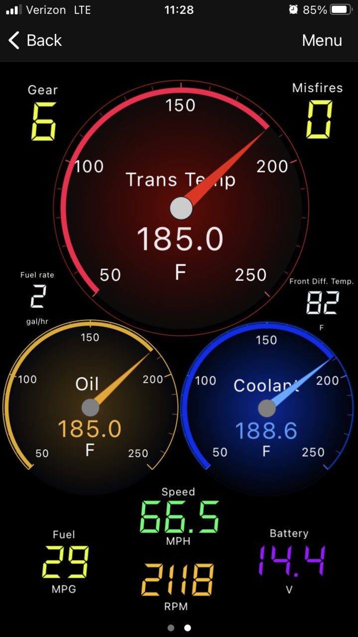

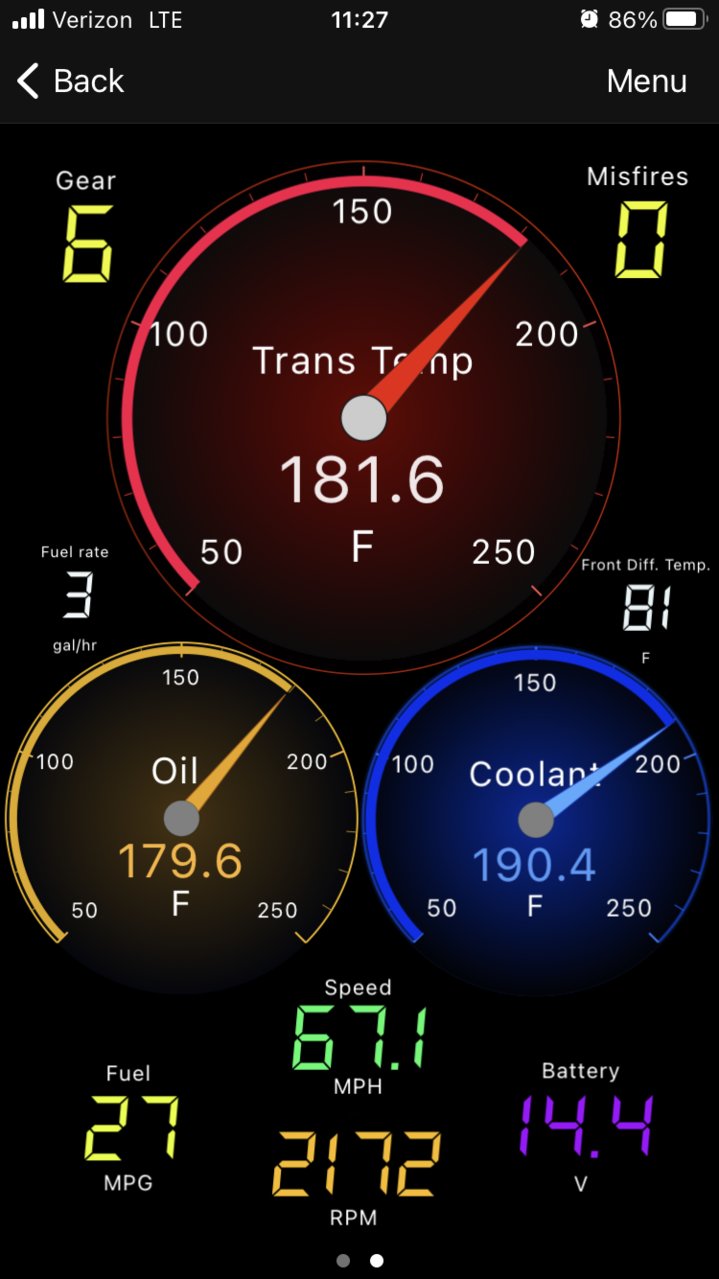

    4.88’s and OVTune towing 500lbs today.
    love the gears. Tuned is another world.
    Hit up @PapaRee or @Mooseditty17 for tune info if interested in upgrading.
    32’s (255’s). With the right combo it’s crazy what this setup can do.
    71tattooguy, jholc21 and DUSTYNEOJET like this.

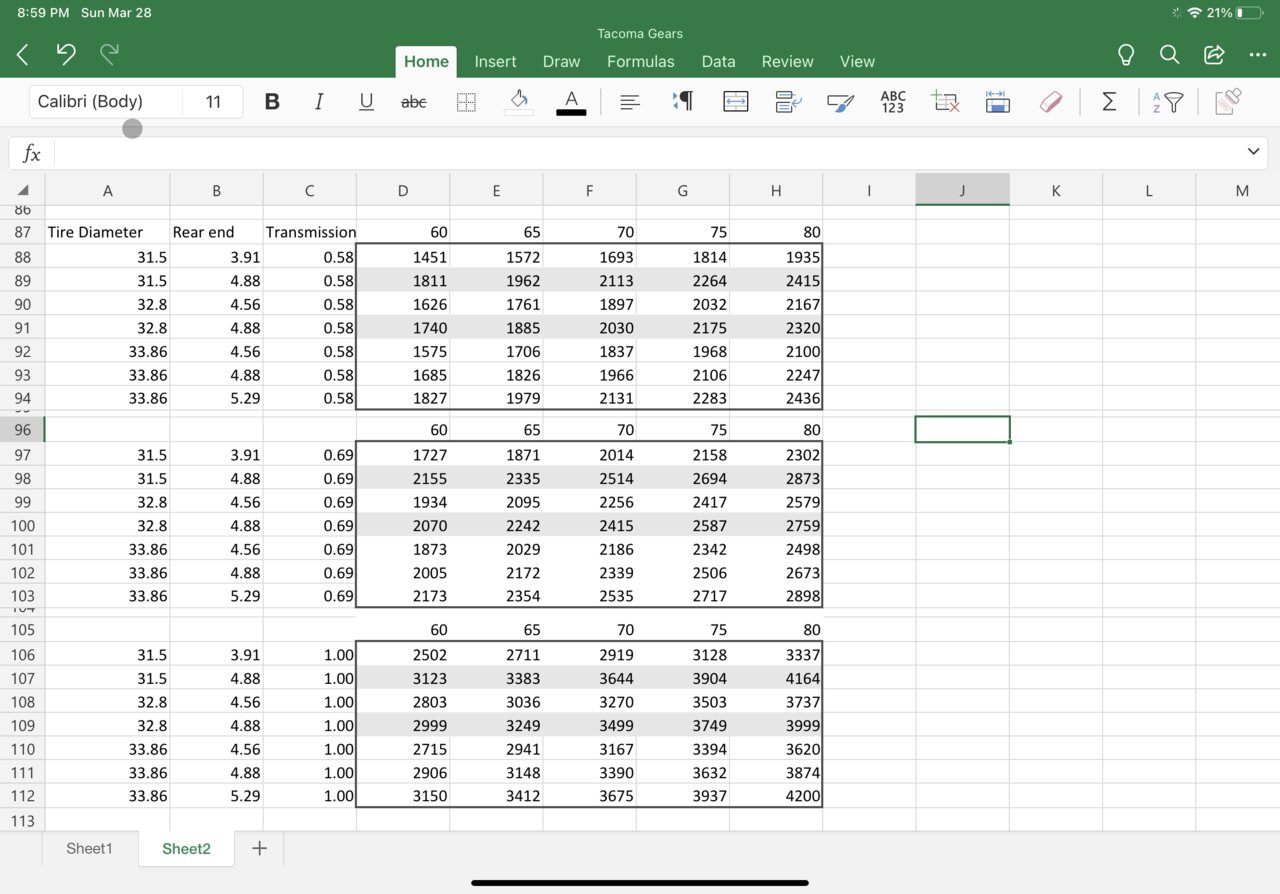

    RPM is simple enough to calculate, see the tables below. I’m still trying to figure out the balance of power you need for a larger tire vs maintaining some semblance of fuel economy.

    16 DCSBOR
    Trans temp is looking good, what app is that? I have used OBD fusion and Torque and I'm not thrilled with either.

    C4Fab LoPro, BAMF Sliders, Ext ADS 2.5’s, 4.88's, OVTune (OG to KDMax)
    OBD Fusion
    (customized gauges on my end)

    16 DCSBOR
    Good job, it looks very slick

    See post #1496 for RPM tables. Nitro has a video that says 4.88s are perfect for a stock truck. That would make a 5.29 a no brained for 34s when you look at the RPM. Row 89 vs 94. Nitro also says 4.88 for 33s, row 91. TAV said 4.56 for 33s row 90, 4.88 for 35s, 5.29 for 37s. That would make a 4.88 for a 34 analogous to the TAV builds if you look at the calculations.
