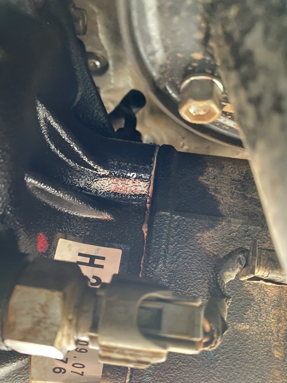

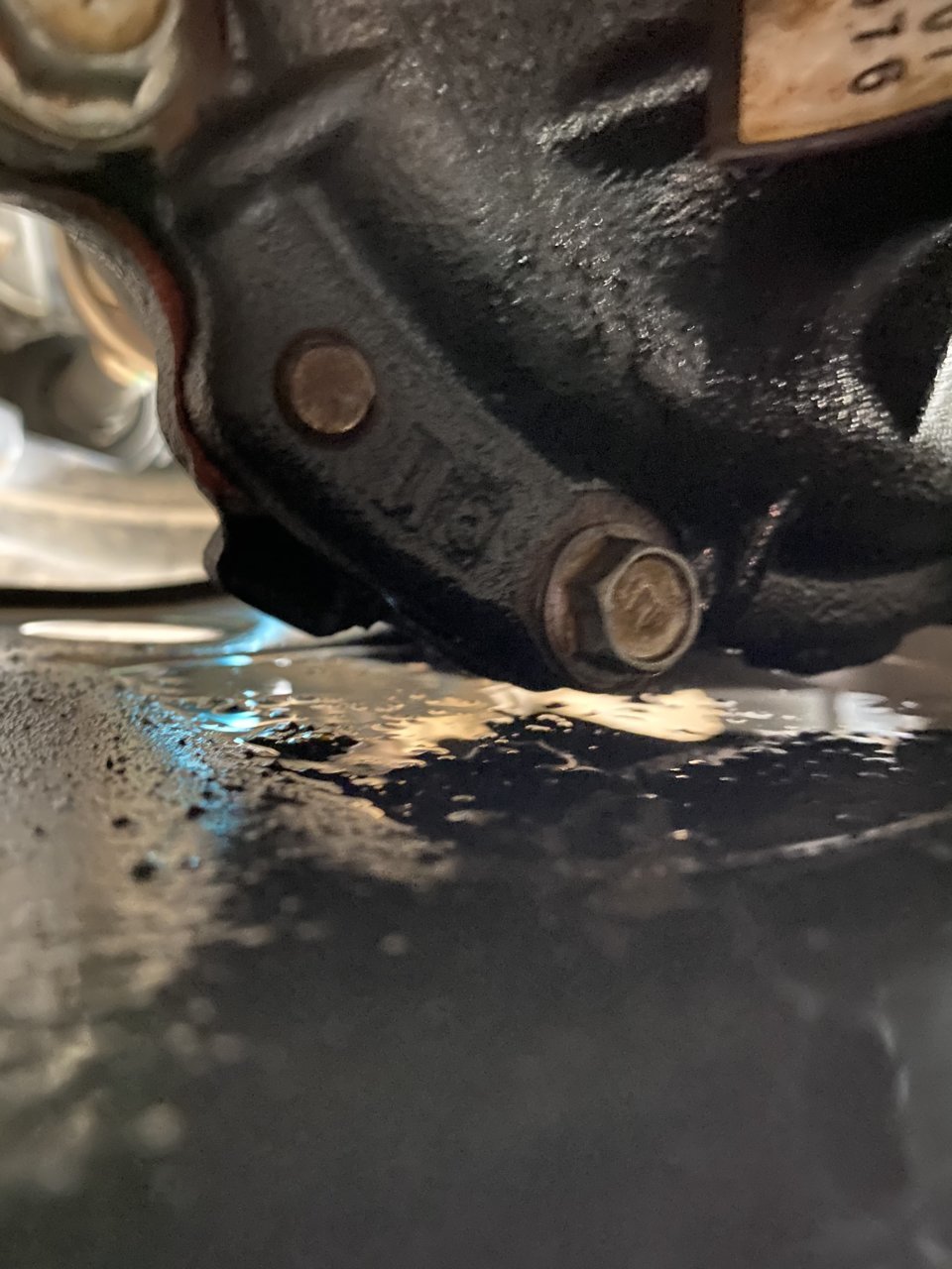

    its coming from the front, there is a pool of oil on top of the skid plate, so i'm going to remove that and take a look.

    looks like it’s coming out of this not the pumpkin at the bottom. Is that like the cv or axle input from the right tire into the front diff?
    would they even touch that side would doing the regear?

    So I would definitely wipe and clean everything completely (if you can get a rag in there). Residual oil is super annoying to deal with sometimes but thats the best way to see where its coming from and observe the leak.
    Where the heck did you get your regear done where you are leaking from both differentials?

    I'm sure they will make it right, just be sure its not residual oil. I blew a CV seal and dumped a 1qt of oil from the front diff and it took weeks for all the old oil to finally burn, wash, dry off.

    The side tube has to be removed to re-gear. Worse though, your vent hose is not attached.

    That hose being off is likely your oil leak also.

    Yep, i managed to get my hand up there and its definitely the source, however i cant get an angle to get it back onto the metal fitting. I have decided to cut my losses with Mobile Gear Installers and just take it into Toyota. Hoping it doesn't cost too much... maybe i can keep my regearing a secret and they will just cover it, because the hose came off...
