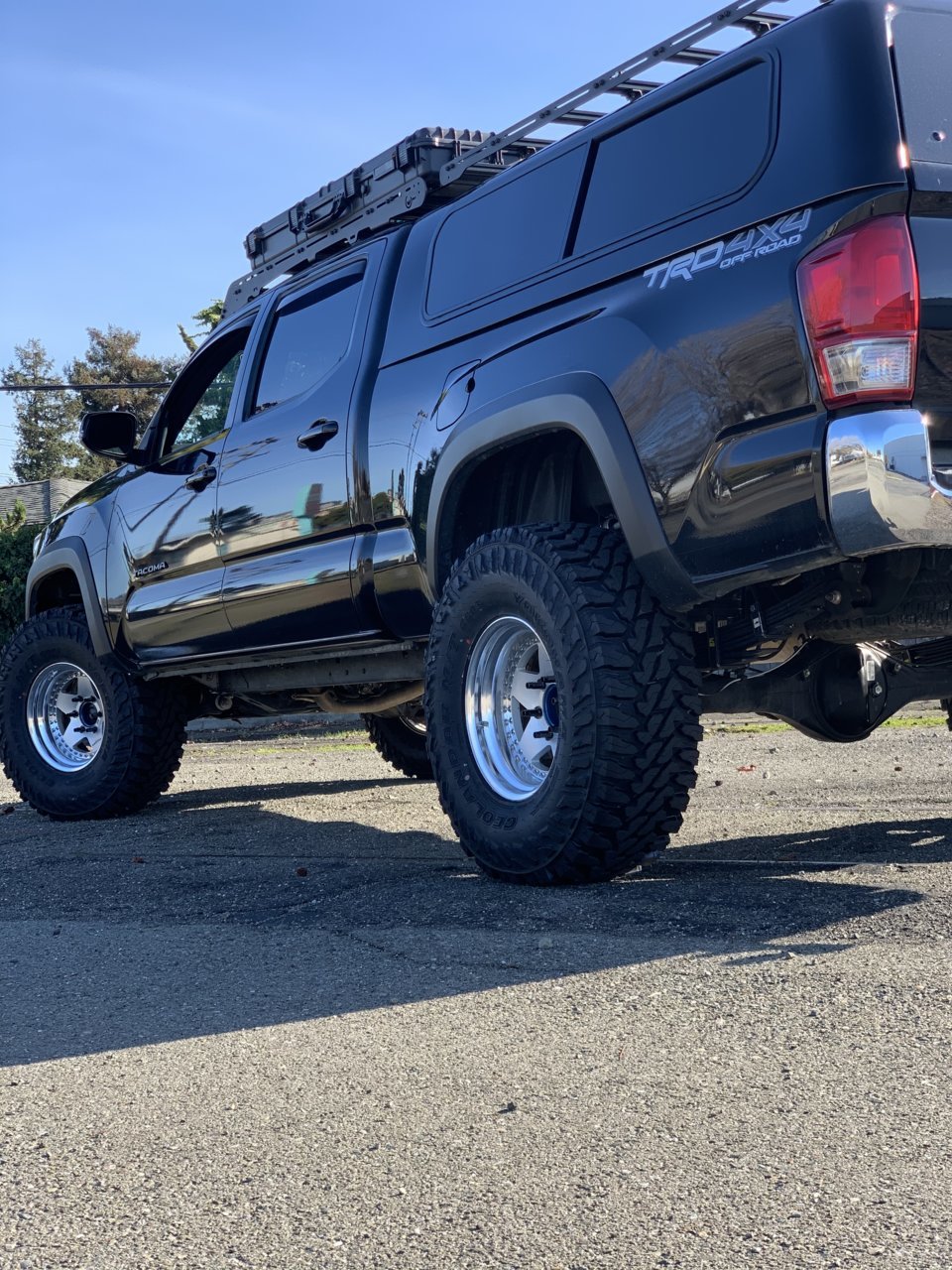

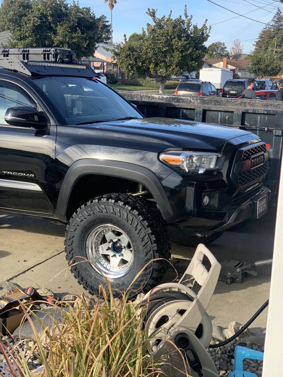

    thanks for reaching out my guy. Hope it continues to be a smooth ride for u, as of now I’m fitting the 315s on to see if it’ll make a difference ,once all the trimming and hammerings done I’ll take it out for a spin to see if the buzzing vibe is still there at those higher speeds.
    Here’s a pic of it being test fitted to see where the rubs are

    Well took it out for a spin on the freeway, it slight vibration is still there, it’s like the sound of going on those steel bridges or driving on the shoulder lane where the grooves are 55-65ish .I’ll do what @Texoma said and measure those angles. Here’s some few photos ... the wheels are work pitneys 3 piece from Japan.
