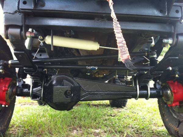

    Didn't work on it too much, but I got another couple small jobs done. The steering stabilizer is installed and the gussets on the front spring hanger are burnt in. I'm debating painting the shock for the stabilizer black.

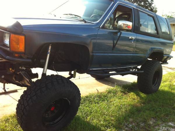

    Got the V6 brake calipers and pads in, nice difference in stopping power.
    The list of things to finish is getting very short.

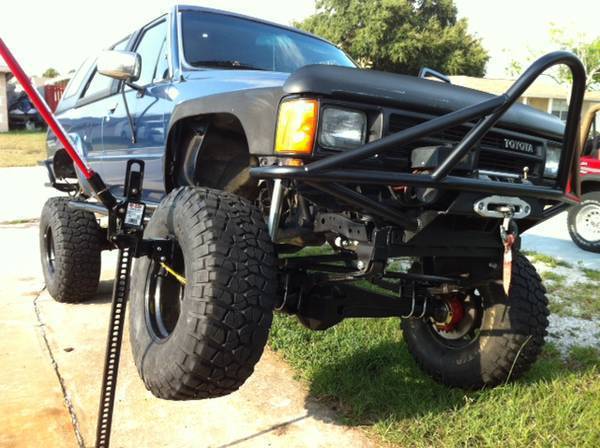

    Flexed it as much as I could to mark for the bumpstop extensions. Still plenty to go before it would have touched.

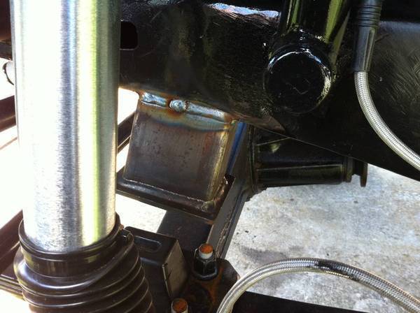

    Got the bumpstop extensions welded in.

    very solid man well done :thumbsup:

    Man you do some pretty welds. :thumbsup:
  11. Sep 8, 2013 at 9:44 AM

    I get lucky every once in awhile. I don't claim to be a good welder, okay at best, I'm still learning. Hopefully nothing falls off :eek:

    I got my alignment done today. I was very happy that the camber and caster were in spec, no bent housing on my rig. Rear thrust angle was really good too, measure 10 times weld once worked out.

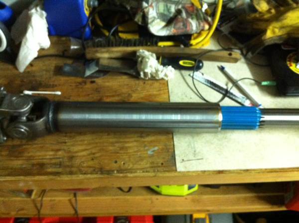

    I decided against the square front shaft and went with this. It's a slip kit from Trail-Gear, you just weld the CV side from the stock shaft to it for 12 inches of slip. At the time when I go dual cases I can just cut that tube off and weld a longer one on.
