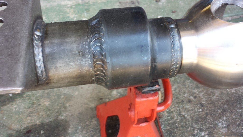

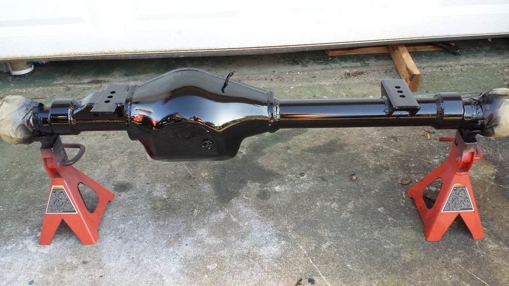

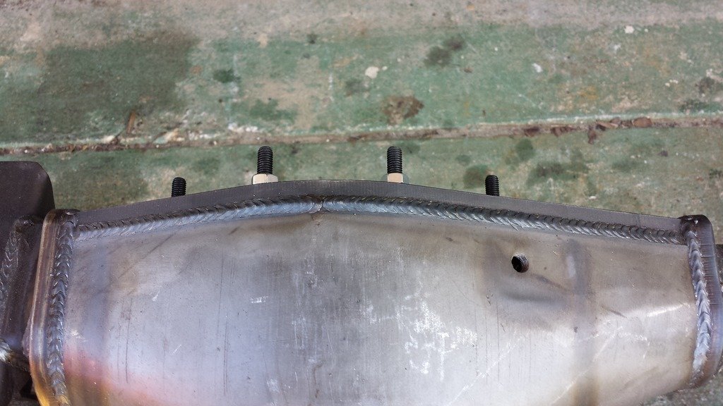

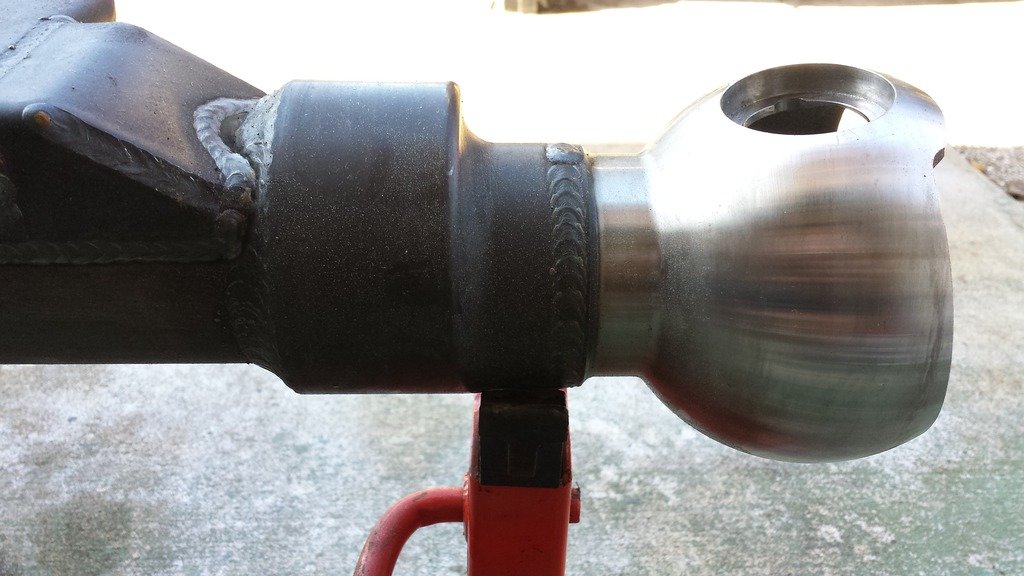

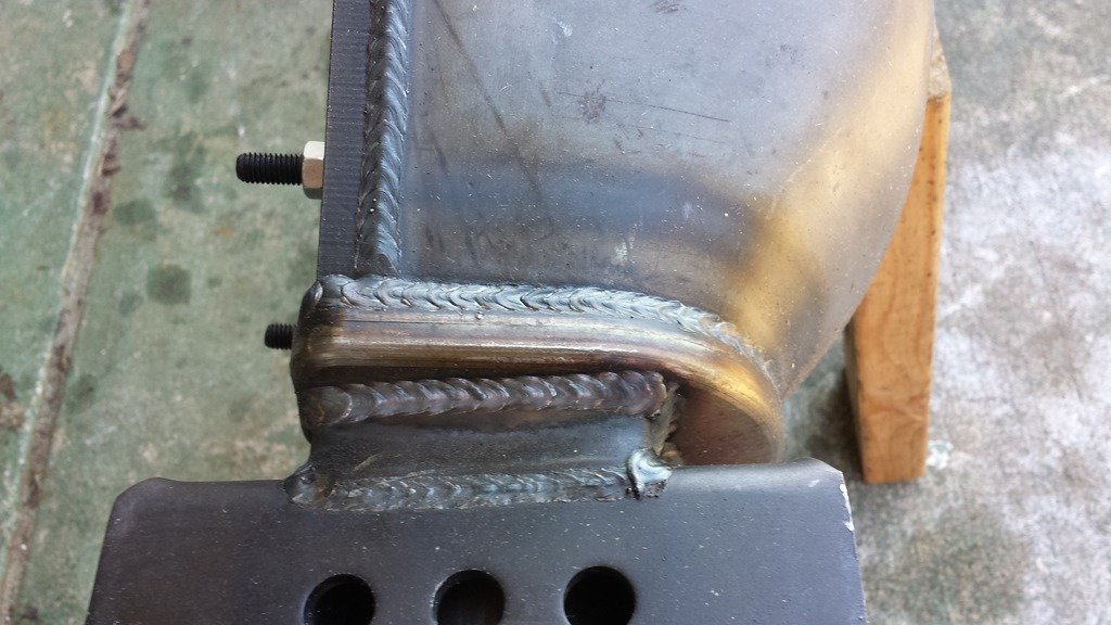

    This housing should work well. The welds look nice. The knuckle balls are both set to the same angle, the housing is square and straight. The only think I can't check is axle alignment, I don't have a bare third, pucks and an alignment bar to measure that. It looks like it should all go together well.
    The housing came with their stud eliminator kit and a tube of RTV, I thought the RTV was a nice touch.
    And all painted up..
