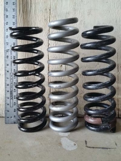

    Our trucks use liner rate coil springs. All linear springs are wound from a steel rod into a cylindrical shape with even spacing between the coils. As the load is increased the spring is compressed and the coils twist (deflect). As the load is removed the coils flex (unwind) back to the normal position.
    From left to right, Bilstein 6112, Eibach, Toyota stock coil,
    photo credit @HB Taco
    The spring rate is a measurement. It tells us how much the spring well deflect (compress) 1" at a certain load. On linear rate springs this is a constant rate, no matter how much the spring is compressed. For example, 600 pounds compress the spring 1 inch, and 1800 lb compress the spring 3 inches. The book says that spring rates for linear rate coil springs are normally calculated between 20% and 60% of total spring deflection.
