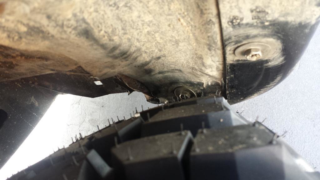

    wow pics came out pretty bad... 33" bfgs with 1.5" spacers rubbing hard on the outer edge when near full lock. any ideas or does it get the grinder?

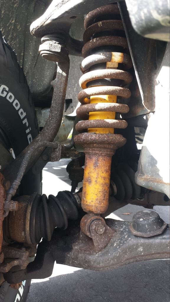

    i wonder if this has anything to do with it?? stock uca's nasty OME's with 1" spacer soon to be replaced...
    prev owner hammered out the pinch welds really bad but dont have an angle grinder so cant do much to fix it

    ^Yep, it's cutting time. First, cut that plastic liner off about half way up the back side of your wheel well. Then, you'll know what you're working with. If the pinch weld is still back there, get a harbor freight angle grinder ($15) and grind it down.
    Here's what I did:
    http://www.tacomaworld.com/forum/1st-gen-builds/278223-lumpskie-build-96-5-speed-5.html
    More pics here:
    http://www.tacomaworld.com/forum/1st-gen-builds/278223-lumpskie-build-96-5-speed-6.html
    Then check to see if you need to cut a little of the body back. Scroll down to see what I did here:
    http://www.tacomaworld.com/forum/1st-gen-builds/278223-lumpskie-build-96-5-speed-10.html

    Yep hammer and cut

    quick question take off the sway bar now or later on?

    Depends on the front coils. If they are OME 882 or 883s then yes. If 881 you can too just sway a bit more.
    Really though its the cheapest best offroad mod you can do haha well worth it
