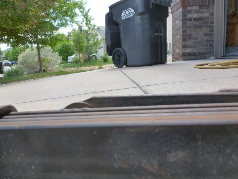

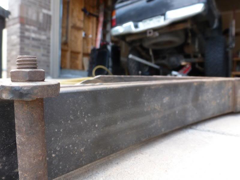

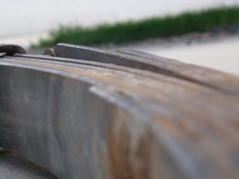

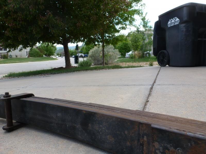

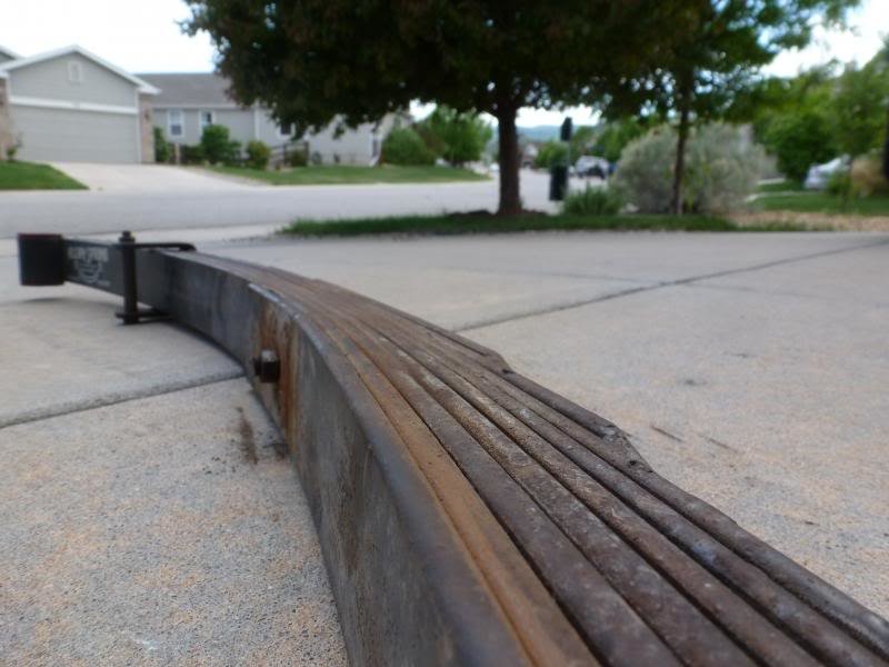

    So, here's a contributor to some of the binding in my rear suspension. You can see how the spring pack is tweaked, with the bottom leafs sticking out.
    So, I straightened the pack out as you can see here:
    We'll see if this improves my suspension's behavior...

    Mmm..might..doubt it thou. My AALs are crooked all the time. If the leafs are literally twisted then you have problems.

    yeah, my leaves are also always crooked as well.....way worse than yours were. haha

    Well, it looks like you might be right... I think that the main leaf is twisted a bit. Some of the binding was relieved and the springs flex better in their range of motion. But I didn't get any more travel. I'll just keep saving for those Orbit Eyes...
    Thanks man! I really need to get around to building the rear bumper to match. Looks like you and Blackdawg were right. The suspension still binds quite a bit. I'm thinking about getting the Alcan Orbit Eyes. I know that you've got the Johnny Joints in your rear... Do you think the orbit eyes would help my problem?

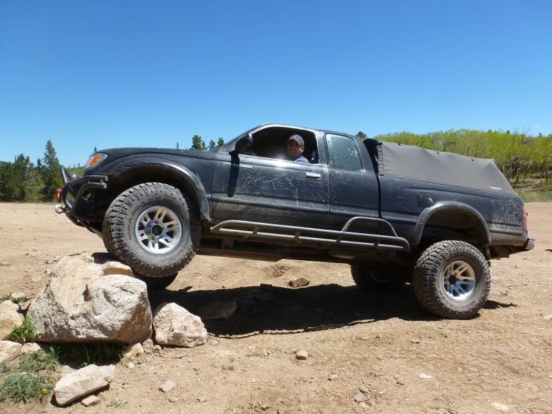

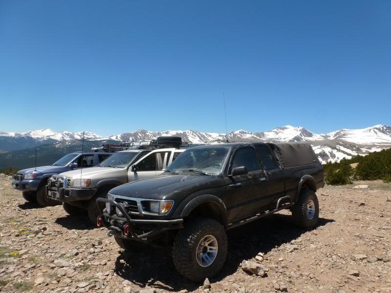

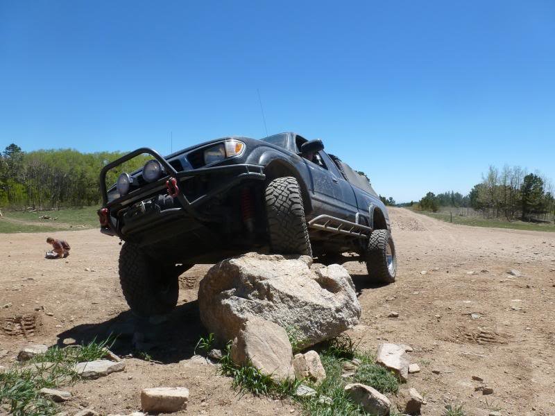

    Went wheeling today.

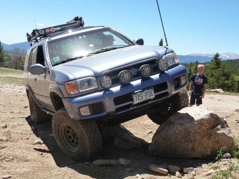

    More pics:
    Here are some climbers... if you can see them.

    You removed your sway bar too right??
  11. Jun 9, 2013 at 8:03 PM
    #171
    Lumpskie
    Lumpskie [OP] Independent Thinker
    Apr 20, 2013
    #102450
    1,978
    New Hampshire
    '96, 4x4, v6, manual hub
    Toytec 16" coilovers with Tundra Bilstein 5100s, Light Racing UCAs, Alcan Leafs with Orbit Eyes, 12" Bilstein 7100 short Bodies, ARB rear locker, 33x12.5 Duratracs, CBI sliders, Bushwacker fender flares, self made front bumper, M8000, Vision X 6.7" Hi/Lo Beam HIDs, full skids, Inchworm dual case setup - 15º clocking
    Yes sir. Why do you ask?

    Doesn't look like it when you were flexing on that rock..

    Might not (probably not) cure the binding, but definitely will help!

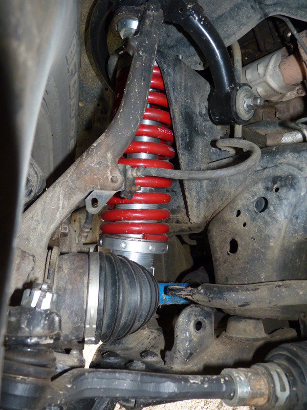

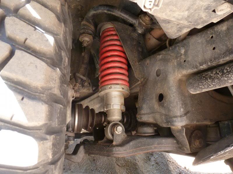

    Yeah, I can see how it looks like. I cranked up my coilovers and lost some front travel but I wasn't anywhere near flexed out in the pic.
    Here's the old full compression compared to the newto show the difference in flex. As you can see the first pic is against the bump stop on the LCA and the second isn't quite there. My hope is that over time the springs will continue to break in and I'll get that little bit of travel back.
    Old:
    New:
    I was hoping that getting a non-twisted leaf with relief against twist, would be enough to fix my bind but things don't go the way I plan with this truck...
    So what do you think would be the best solution? Do you think my current leaf is twisted?

    The only way to tell for sure if the leaf is twisted would be to pull the leaf pack out and check the alignment of the spring eyes. if the front eye isn't level with the rear eye, then you've got some twist.
    If there is twist, the solution would be to send the leaves to someone like National Spring to get re-arched and hopefully straightened out. Or replace the leaves with a new spring pack. Or I suppose you could try just replacing the main leaf. Personally if it were me, and there was twisting it would tell me that there is a pretty high level of fatigue on the springs already and might be time for new leaves.
