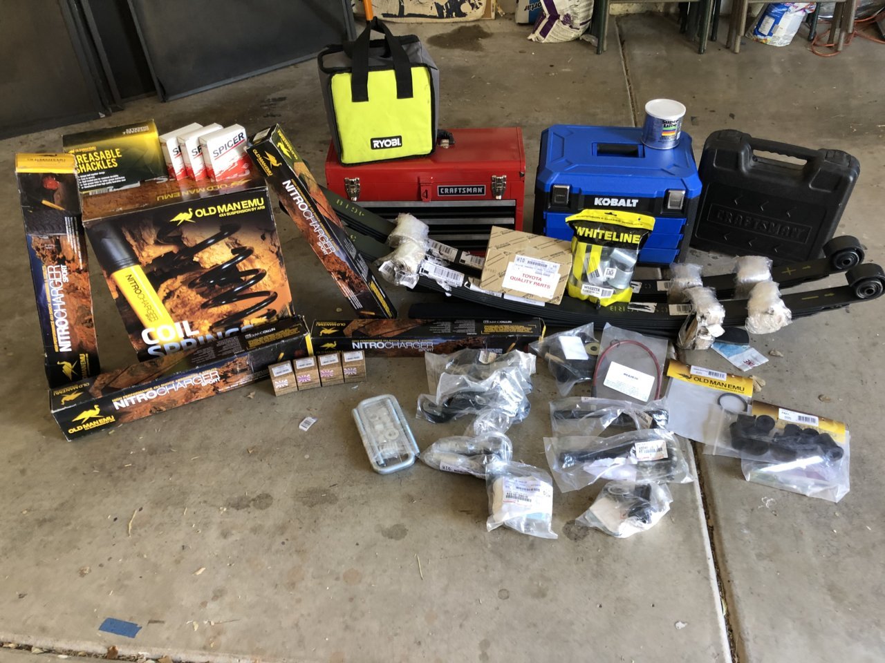

    I've decided it's time to start doing cool(er) things with my truck now. This thread seemed like a fun way of keeping track of my progress! Here it is in the very beginning:
    It's the Lunar Lander because everything is manual except the transmission. Bought it used at a Nissan dealership back in July 2010 with 141,000 miles on it. Now at just shy of 240,000 miles I've decided to throw some money at it in this order:
    1. 2. Buy this rear locker because it looks awesome
    3. ???????
    4. 4x4 Conversion!
    Planning to pick up that OME suspension package around Black Friday to maximize my savings. Next year I'll tackle buying that locker, and after that I'll dive in on the 4x4 conversion. Hoping to be more capable off road and get to some pretty sweet camping spots!
    I'll update this thread as I make progress!

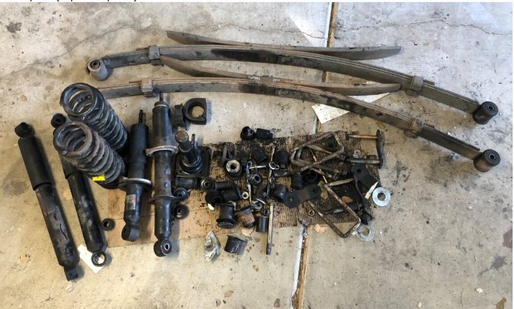

    Bone yard (replaced parts)

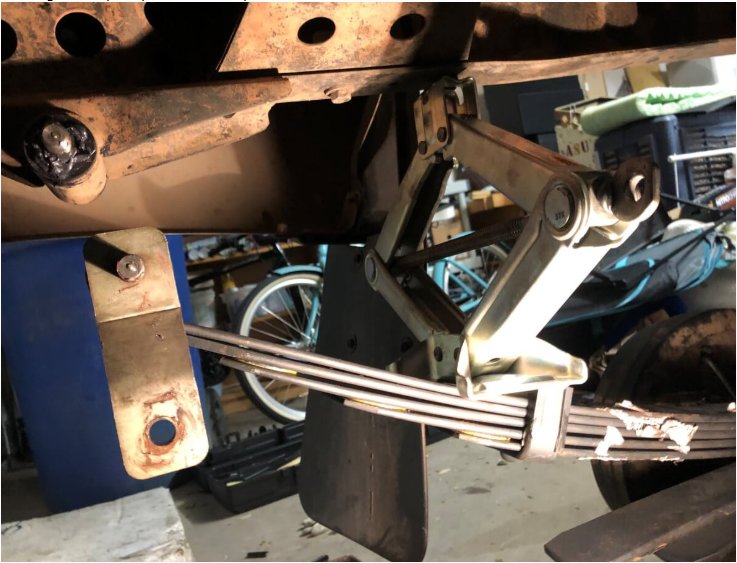

    Getting those pesky leafs lined up

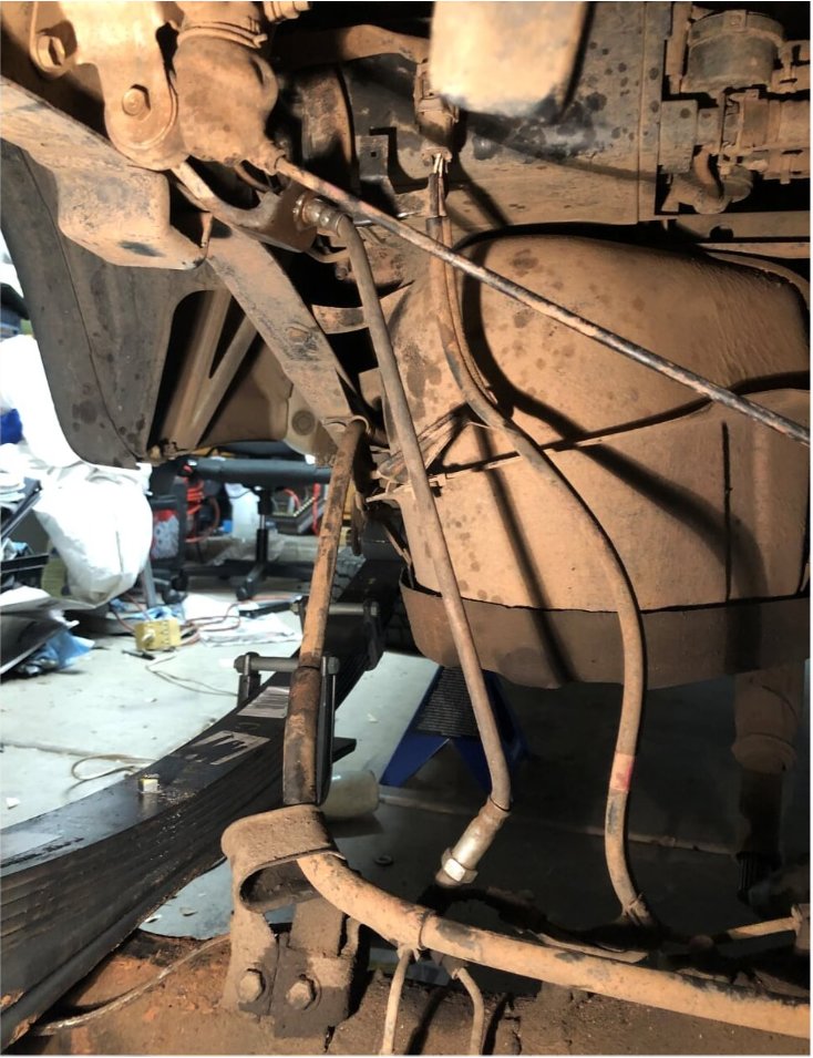

    The little brake line that could. Really amazed this didn't snap. Not my smartest move.

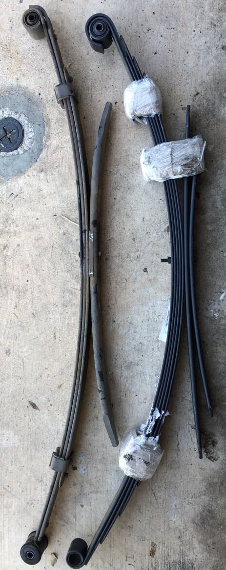

    New leafs vs old

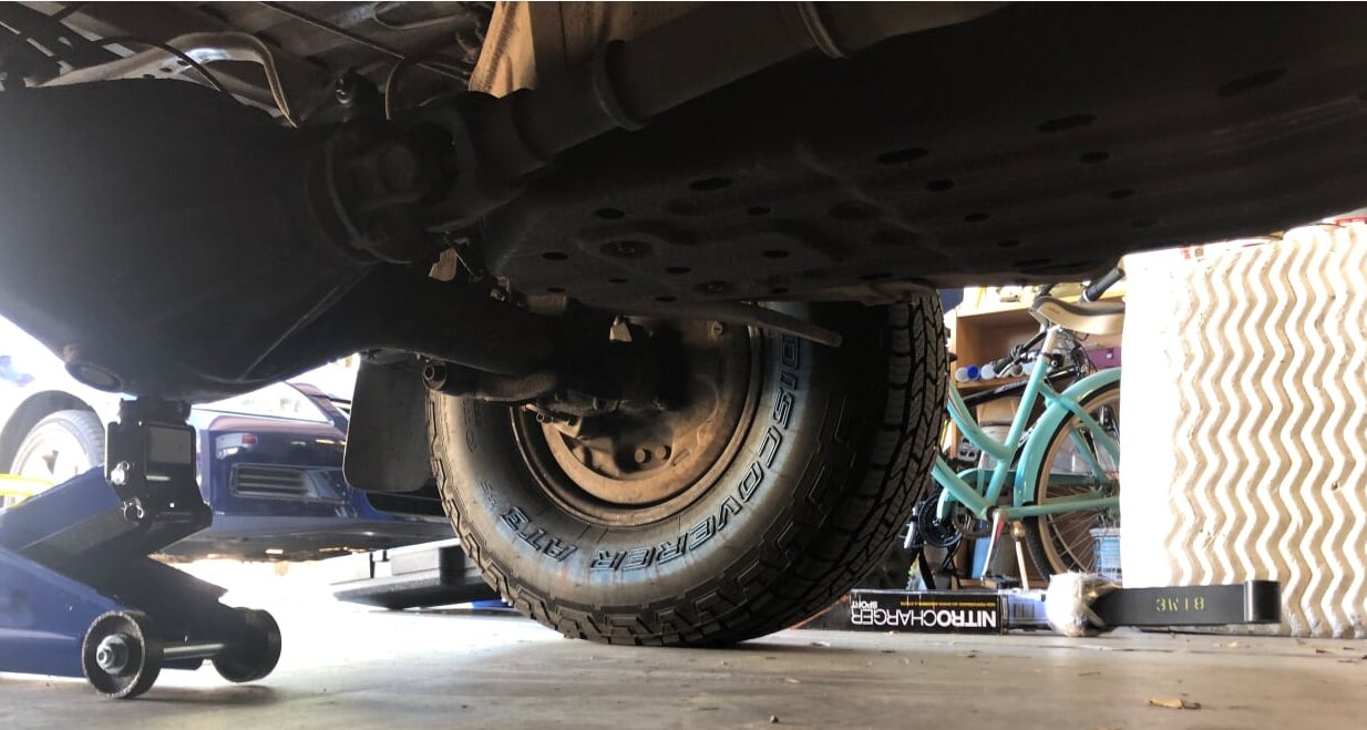

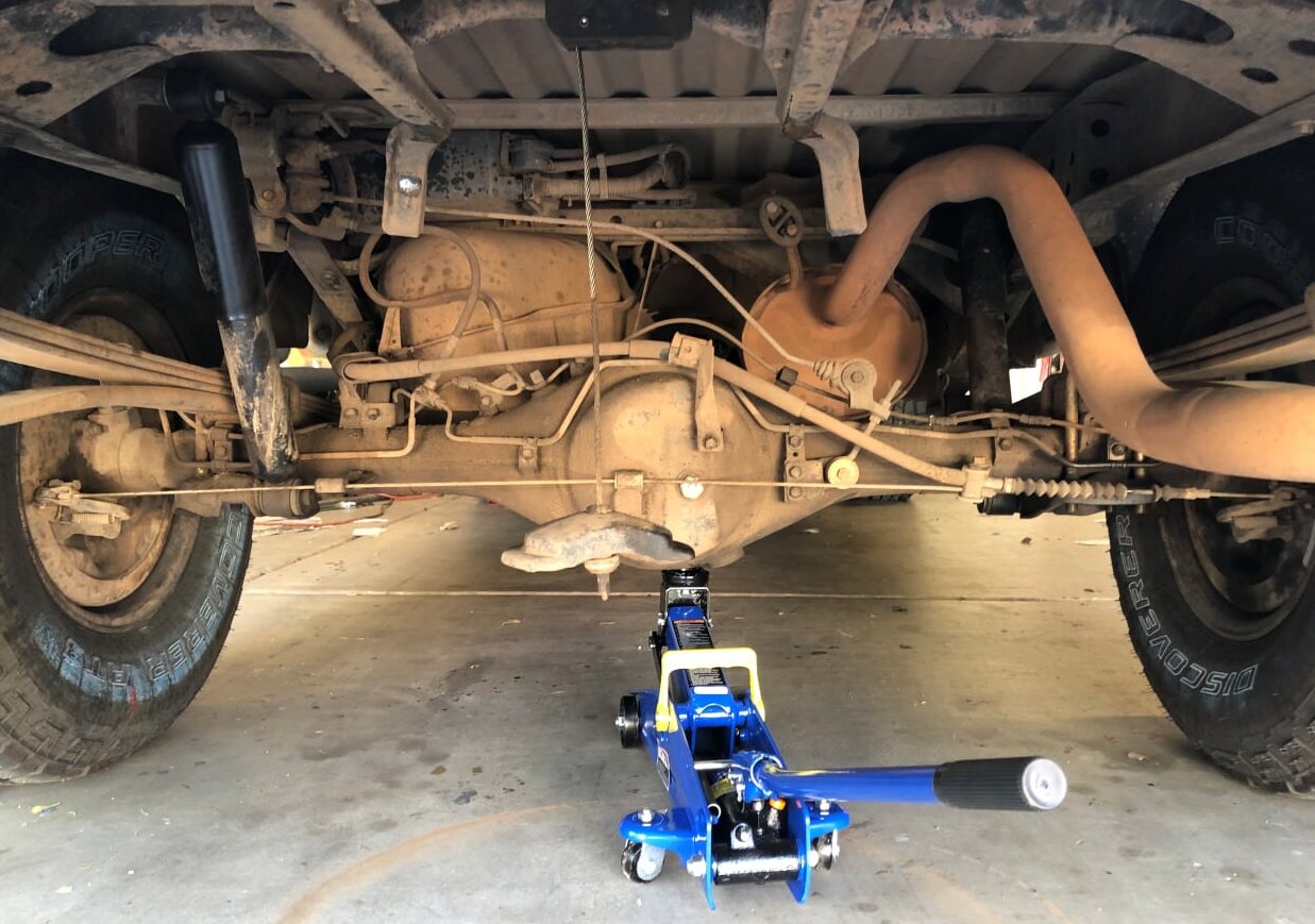

    Before the axle slipped off the jack. Really should have ponied up for some more jack stands and put a towel between the pumpkin and the jack for a little more grip.

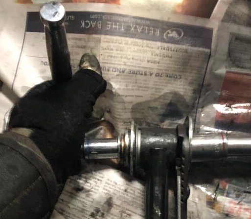

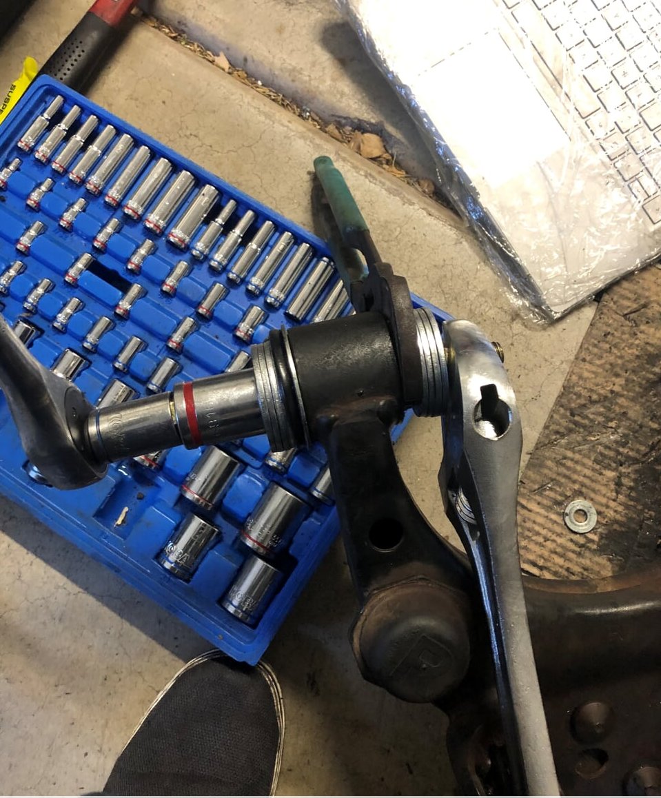

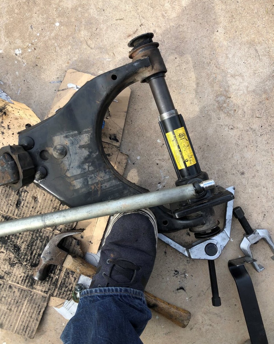

    Makeshift press that worked pretty well. Followed these instructions and added a bunch of washers, used a pair of angle pliers, and a long pipe for more leverage. Also tons of WD40. Uppers went in like butter. Lowers fought me every millimeter.

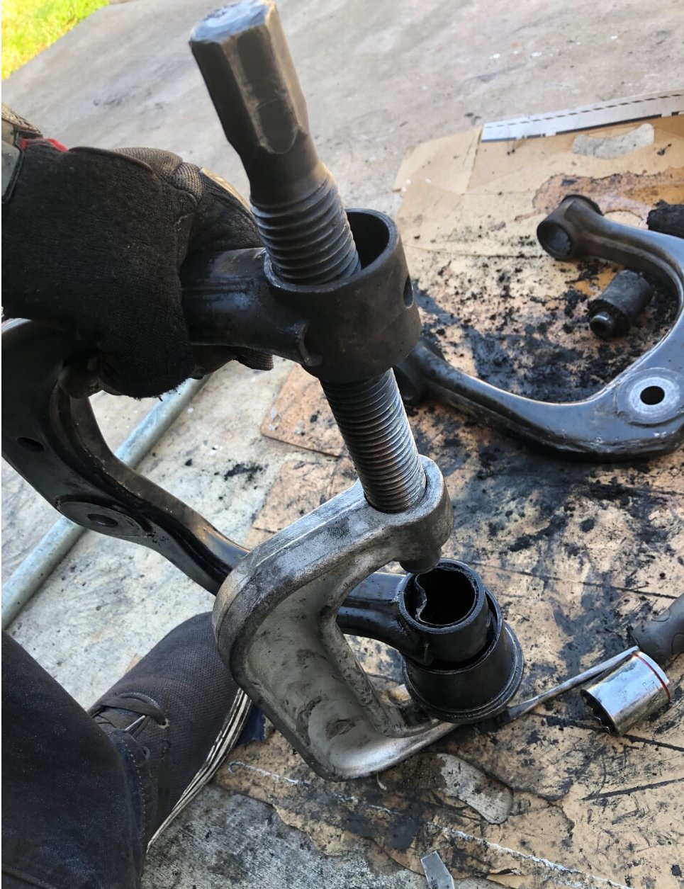

    Balljoint press kind of worked if I hacksawed through the sleeve and bent it up. Huge PITA though.
    This worked until it broke my bottle jack.

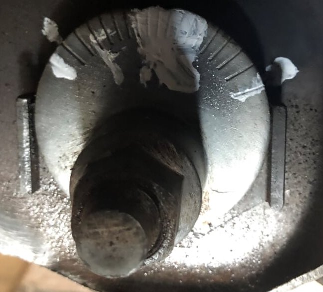

    For the lower arms, I found marking the alignment with whiteout worked pretty well. Getting the washers in after installing the whiteline bushings was a huge PITA. Took at least two hours. Not a lot of space in there.

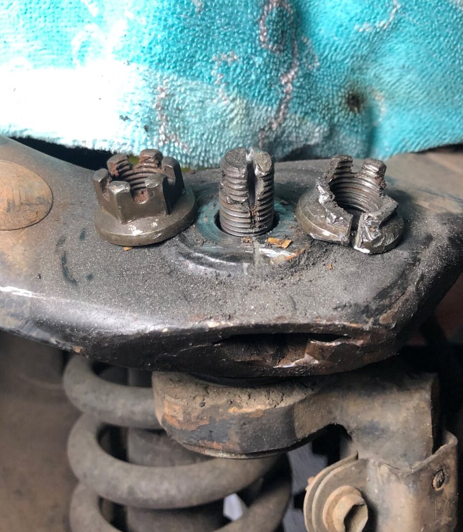

    Castle nut was seized on one of my upper ball joints. Had to dremel through the bastard to get it off. Also keeping an eye on that UCA hole. It's been there since I've had the truck.

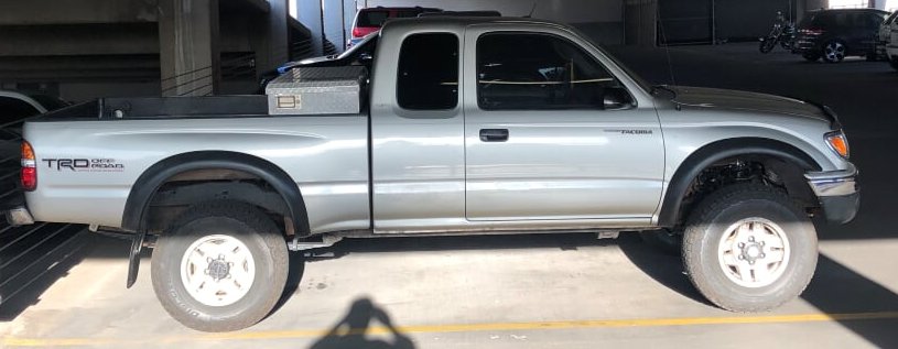

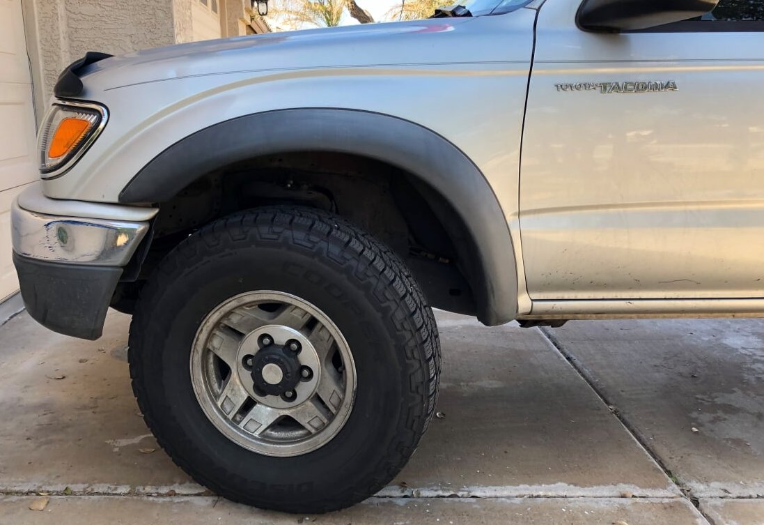

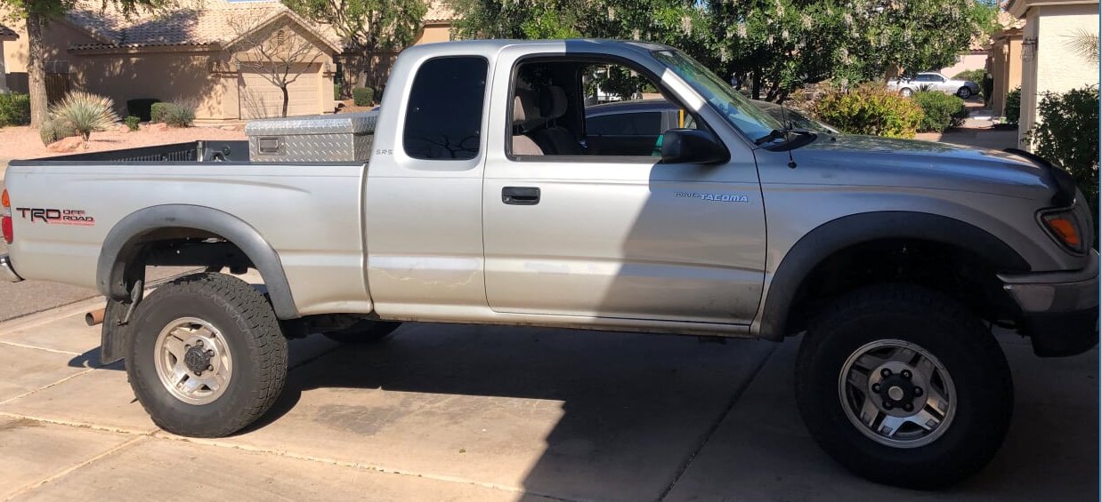

    Before the work:

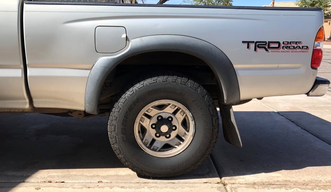

    With only the front installed (notice the gradient)
    With the new leafs in
