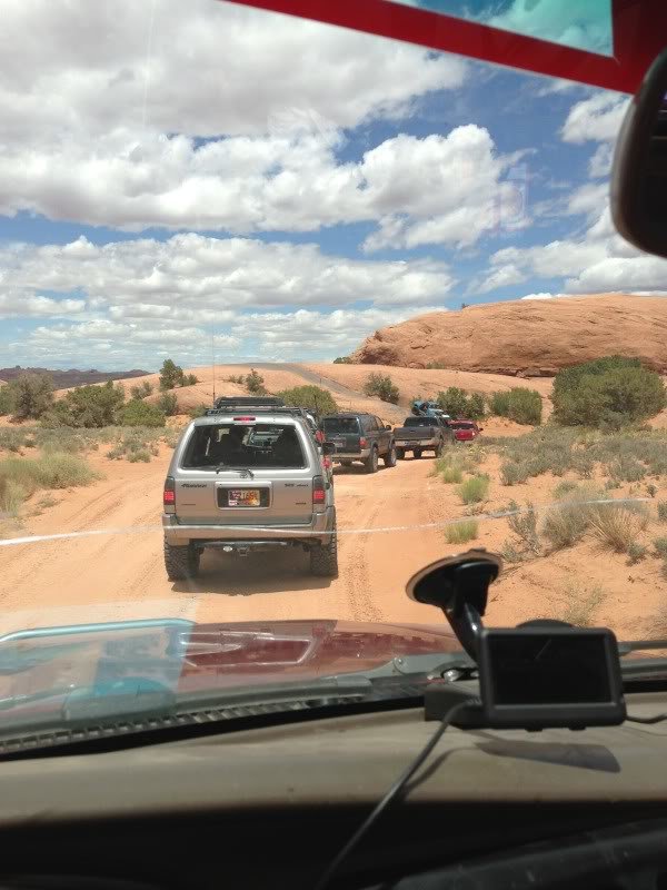

    Arrived in Moab about 10pm in the rain
    7B4447DB-E75D-43AB-B0B0-DE0AF164470B-101_9f917c40e62579aa85c2f846b92e9644da2472c1.jpg
    All the trucks getting ready to run Hells Revenge

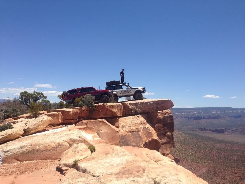

    On Top of the World with Sierra Expeditions and ARB
    2652F7B2-9238-4B2F-8411-7AB7711F5032-101_40d1b3bf7b61a5024ebe43ac64c9f4c9ae90c50f.jpg

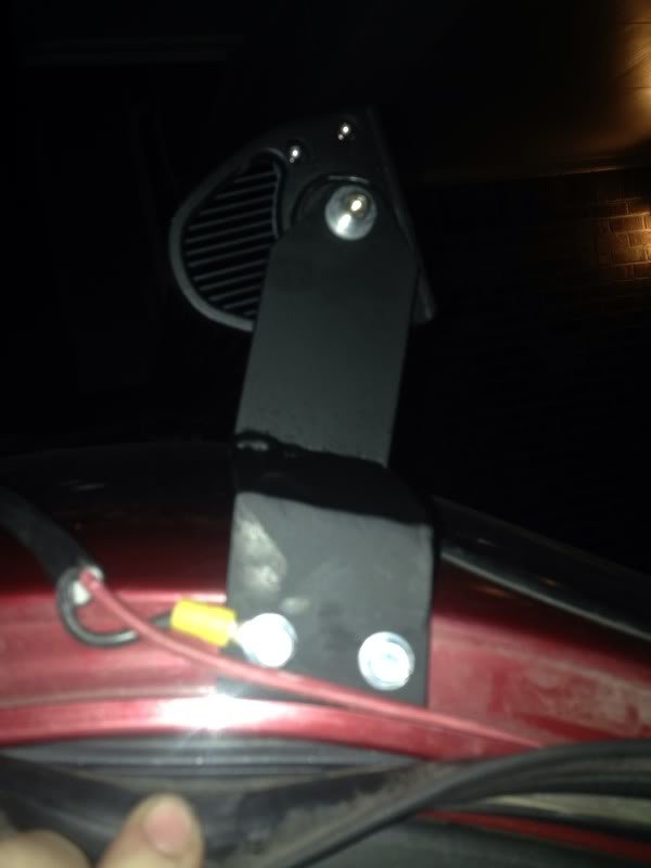

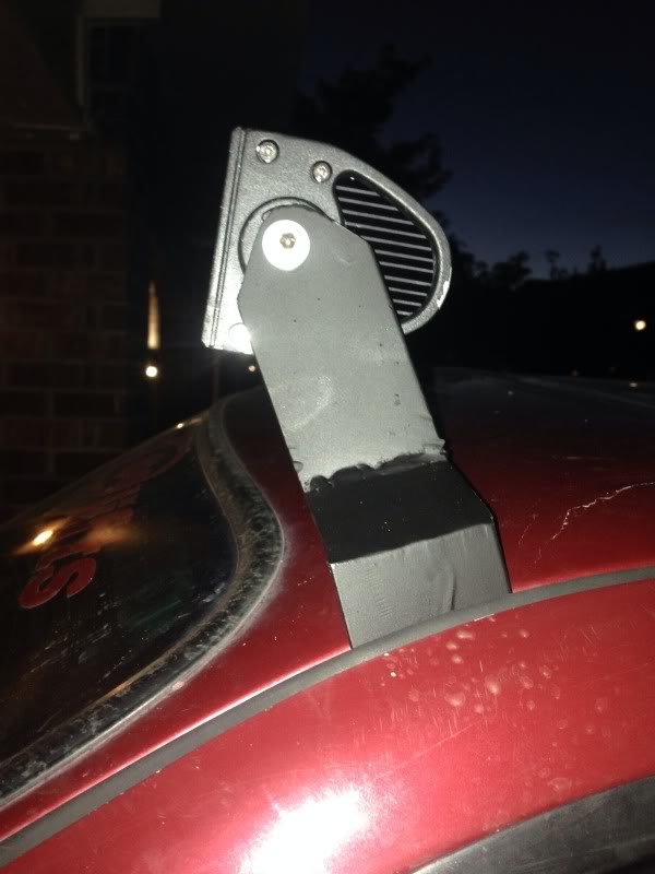

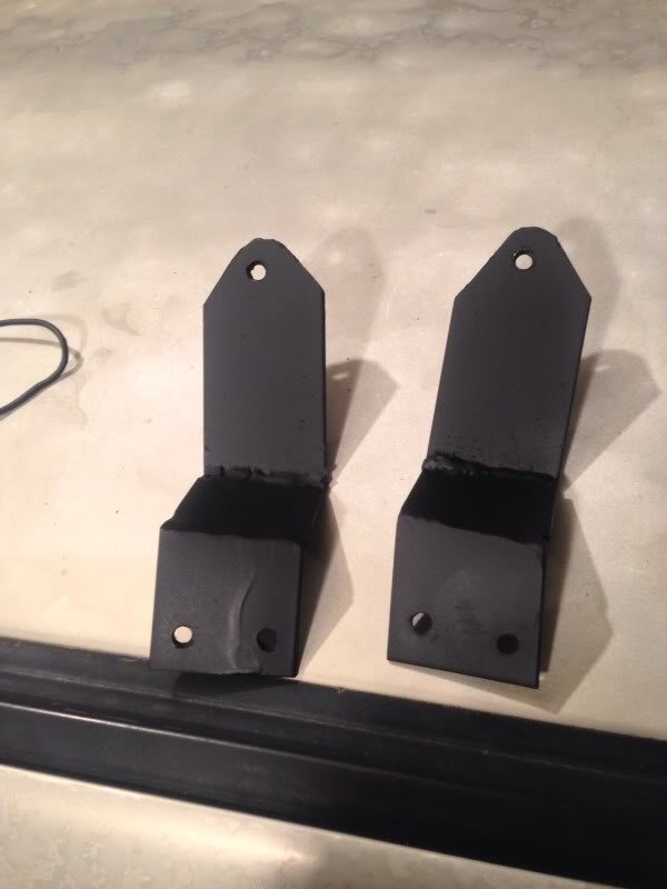

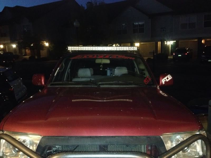

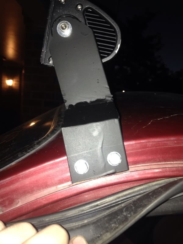

    I picked up a 42 inch double row light bar and wanted to mount it on the roof. I sat it on the roof rack but felt it was too far back. I have plans to build a full length roof rack but i'm impatient and wanted the light bar up there now :D.
    I grabbed some 2x1/8 plate and made up some brackets to mount the bar. After mocking them up, i think a 44 inch bar would be the perfect length for the roof of a 3rd gen but i'll have to make to with a 42 inch :rofl:
    Here is what i came up for the mounts
    6F057ABA-1191-41B2-BF55-35AD40B9B177-286_5774a911d4f9b10ea0d47c84402de056abc2dc3f.jpg
    They aren't perfect as i did them by hand with a angle grinder, welder and mostly just eyeballed it. Do i care? Not even a little bit.
    On the truck
    7439D683-0762-4F02-B96C-369AE4184146-286_f050aac84e2e531b3f597f881eeae009e743440b.jpg
    They sit behind the weatherstrip and rain gutter and are secured with 2 self tappers per side.
    6B6B16F9-1A2E-4F46-8A6C-A8310FA23236-286_af96d80a4a7854911d74ac99b4f45a6a7cb3705e.jpg

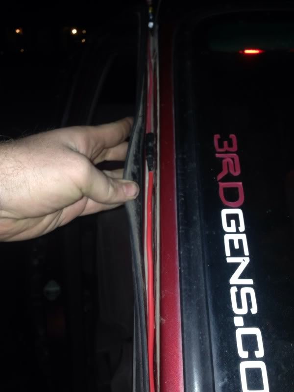

    Wiring runs to the passenger side and its grounded to one of the self tappers
    86B2FD6A-4830-4867-9AB9-64621B167A6F-286_5541176da908809a9409df3eb51d7aaa141d5d11.jpg
    Positive wire runs down the rain gutter to the fender where it runs under the hood to the relay. No holes were drilled in the roof to run the wires. Less holes, less chance of a leak.
    924D4A42-9976-417E-82A5-909282E039A9-286_0da72a29674f7b25703aa0d500b2e3df2051b751.jpg
    All done!
    3D72C4D9-D95F-444D-8B1A-A044B00F8B9A-286_dde65d5fbba6371fc8105ddf58fdbee9a6211b7e.jpg
    3D7D6D8A-BF4C-4643-8E6C-2528F1226997-286_df4adaab099c4ef593ea65be1748d390f07954d2.jpg

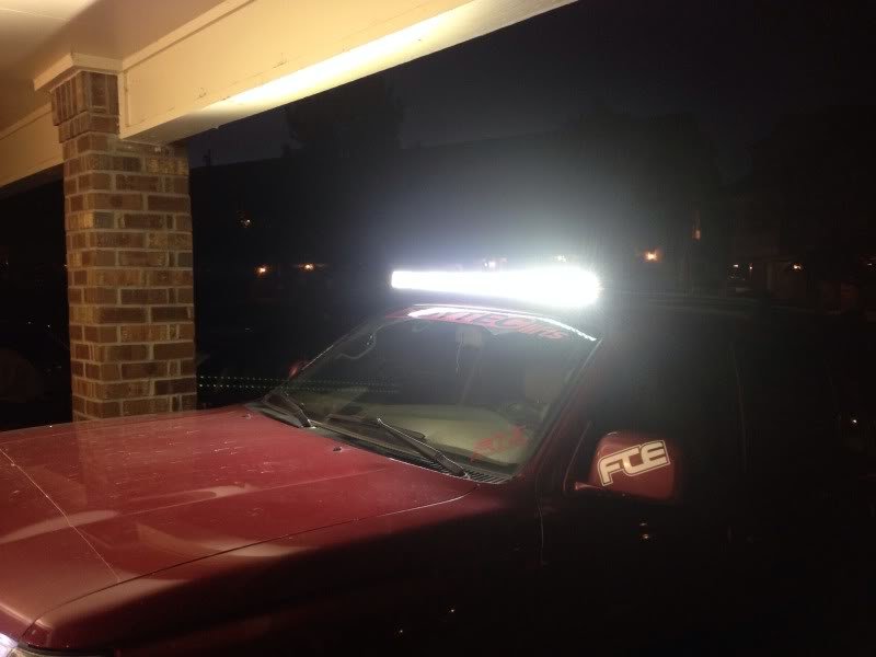

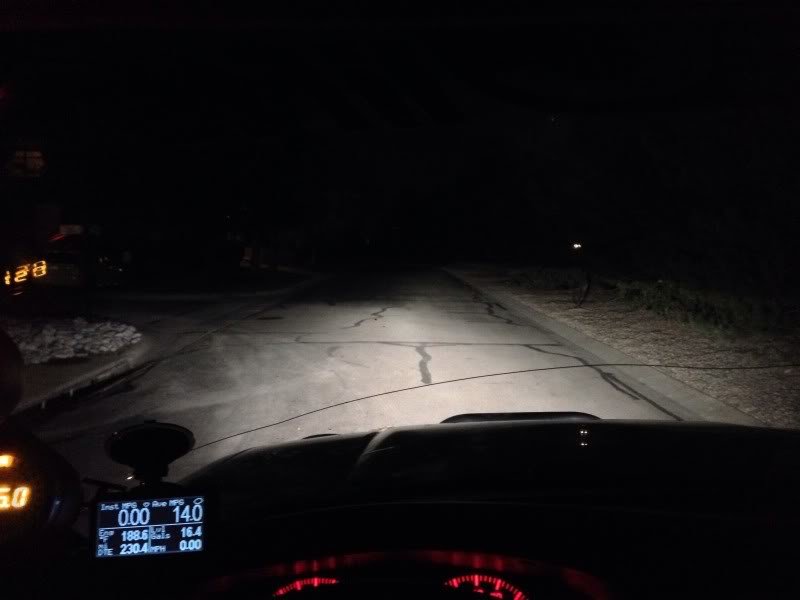

    Now what everyone wants to see! :)
    Its hard to get an accurate picture of the beam output. This was the best i could do.
    Low beam. 55w HID projector retrofit
    52B34961-8E33-4EA7-80DA-34CA3AC5ECFB-286_5531c887f7b2b66fd0aa325df711fc00fef3cbe7.jpg
    High beam
    1A2279D8-7508-4A8D-A6A8-FA4279B12516-286_13930916dcd19d2944afa448cc83caa05d515839.jpg
    High beam and light bar
    66439FBF-9D68-483F-AF36-2DC3DFC1FBB6-286_5e1af9516b472c15c0125c94bec29be0c8dd4a92.jpg

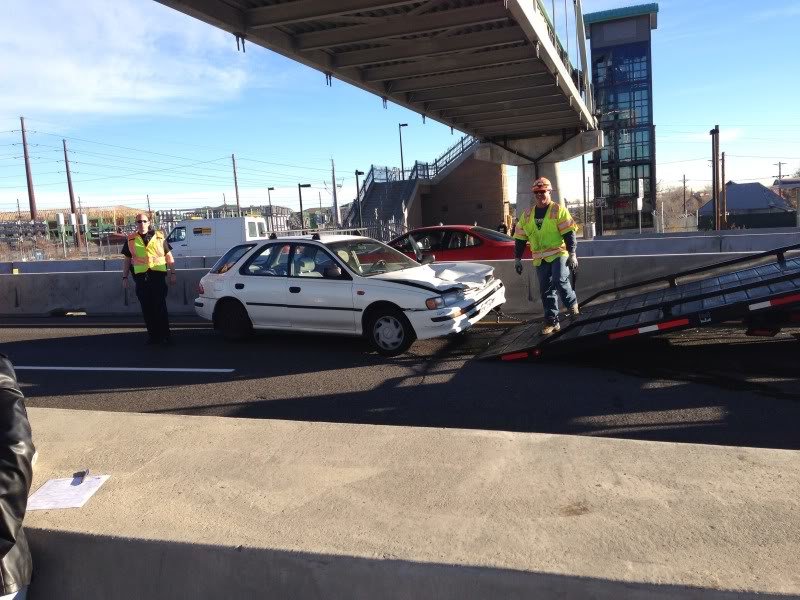

    First off, i got rear ended about 3 weeks ago by a kamikaze Subaru. I was stopped in traffic on the highway and she hit me doing about 30

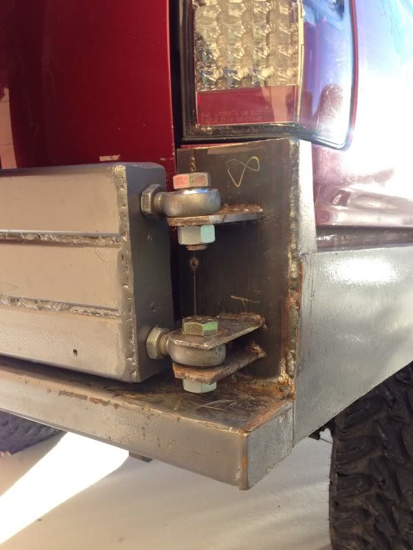

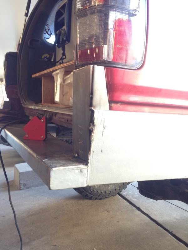

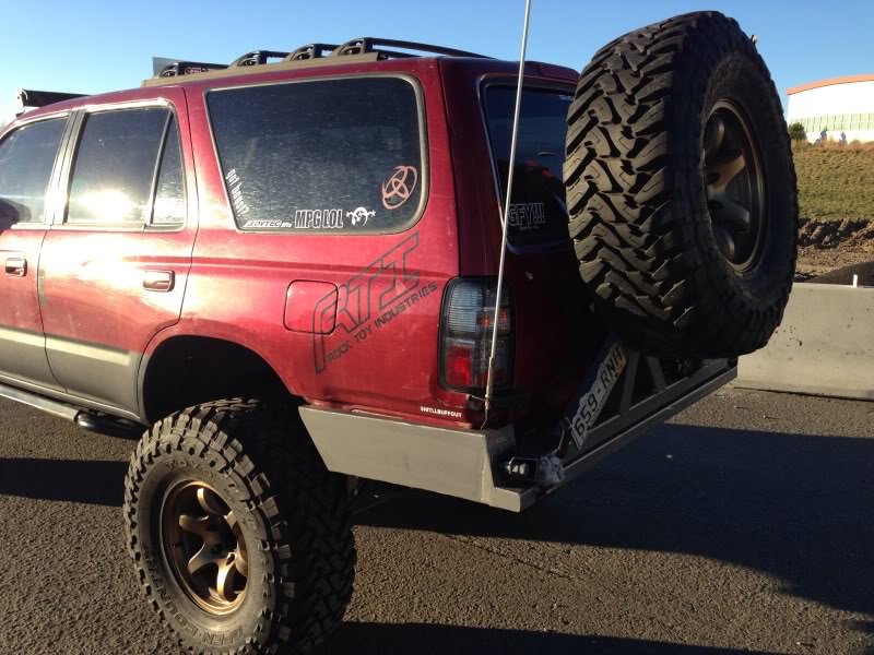

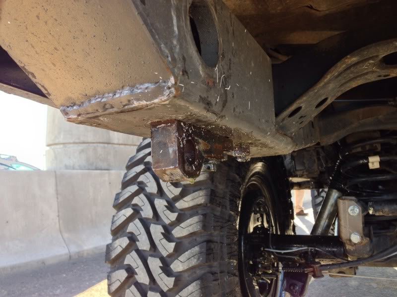

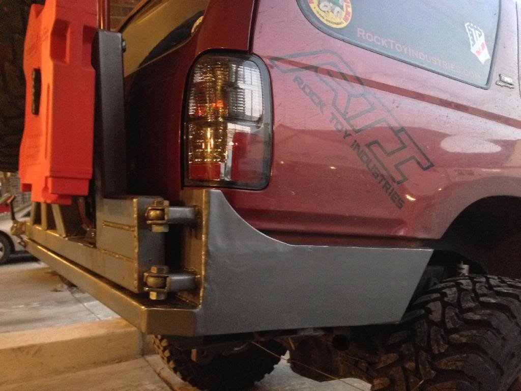

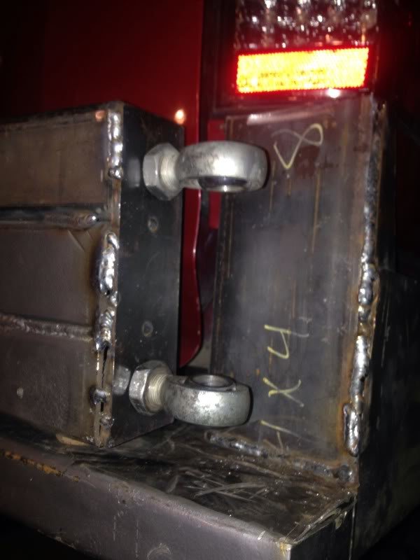

    It did end up tweaking the swing out hinge. I was never really happy with how that ended up when i built the bumper so i decided to use this as an excuse to make it better
    First i cut out all the old hinge and made the mounts for the heims much taller.
    A14FE165-D5A9-4E88-9A02-0B7364873B3A-110_0f9d5995bb22f1e0c09546e40374ad77278e7f1f.jpg
    I also added another tube on the swingout and moved the heims further apart so there would be less leverage on them. All the mounts are now made from 1/4 instead of the 3/16's i used before.
    4974CC20-CC44-438B-B0AD-43E3DDBE181C-110_8b38de914926175104c990e937ab9481a8664ef4.jpg
    B1BE9B0A-0EB2-4E07-B0FA-A27469F0187B-110_bfea10230a7335fcc18cb9a900fd0fff754b1f4a.jpg
    During the rebuild, the weather hadn't made it much above the single digits so progess has pretty much stopped for a couple weeks. This past weekend i finished it for the most part

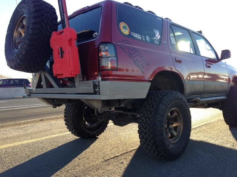

    All done (ish)
    39335289-5E99-4BAF-B134-AA34694ED598_zps_0b9b96692b92936cb0a8cc8136071082615e8c17.jpg

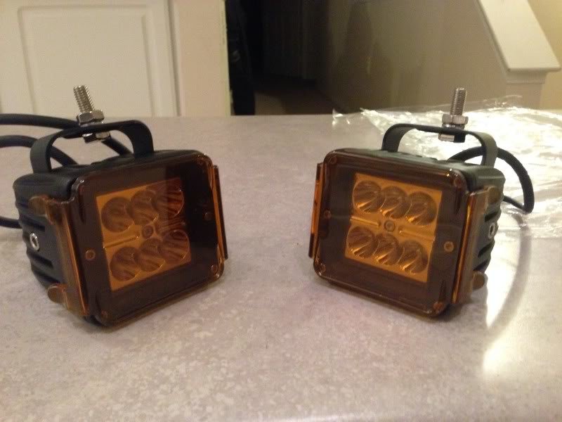

    In other news, I picked up a pair of spot fog lights to replace the floods in the bumper that really don't project light far enough to do much.

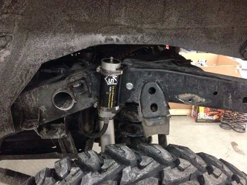

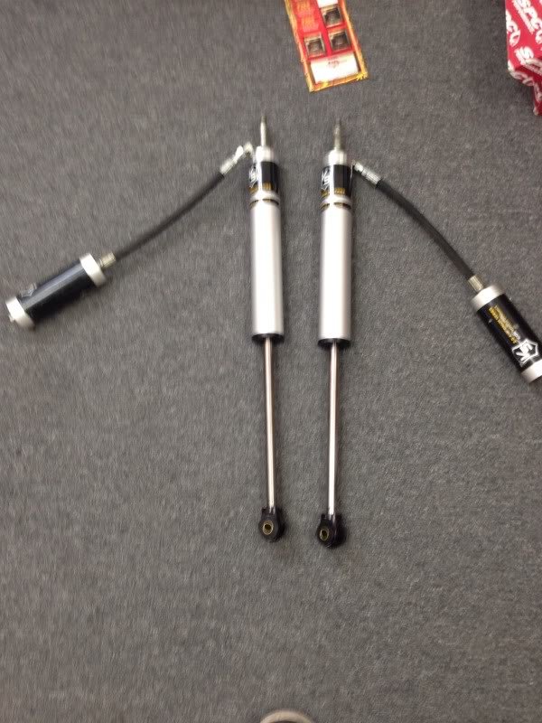

    And i upgraded the rear shocks to some ICON VS 2.0 resi's
    482930D4-6E59-4536-8E00-9EBB14E76FED-110_9df95f9a6a0422e57c1b1159031dc57ccf7c187a.jpg
    710BE139-E136-407C-AF39-F40910EA1D6A-110_656b34dfa599bf7876e4bbbd62a60a0df3c3fba5.jpg
    They are the 05+ Tacoma shocks which are the perfect length for my setup. I did have ICON custom valve them for my 4Runner and the extra weight i have. They ride freaking AWESOME.
