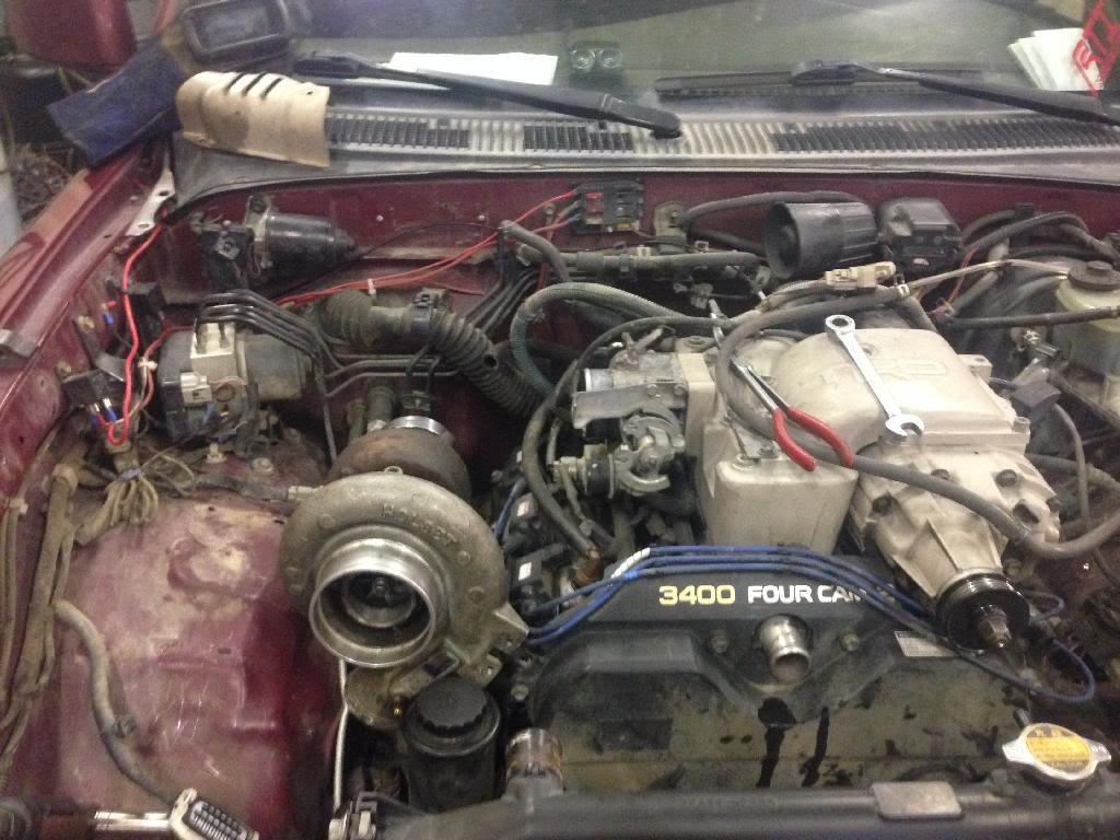

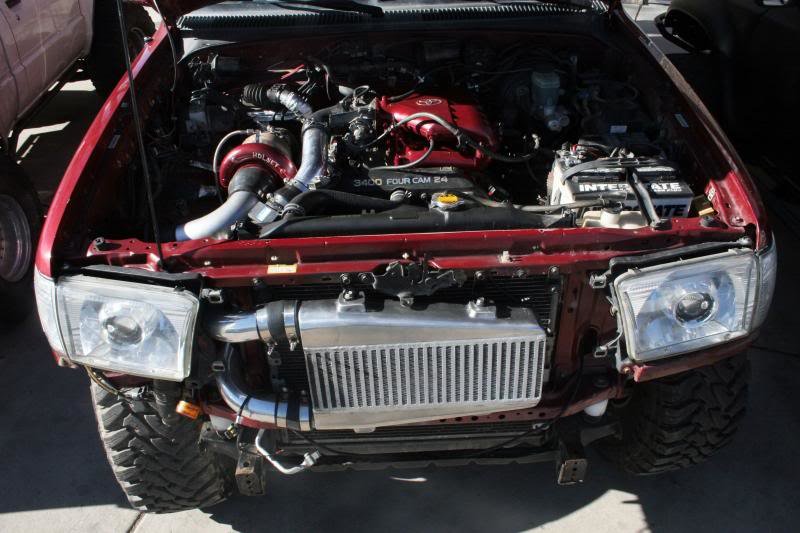

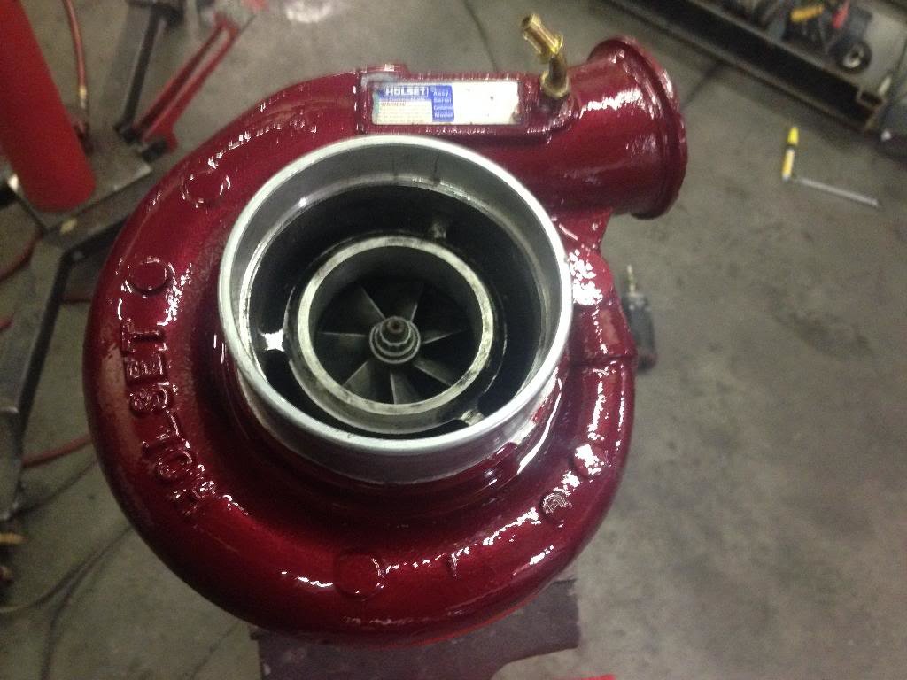

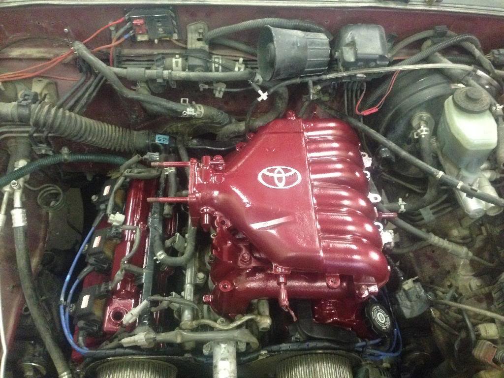

    Probably time to update ye olde build thread.
    If you have been following , you know some pretty major changes have happened to the Lobster.
    The TRD Supercharger was pulled off and sold. It was time to get a little crazy with boost.
    The specs for this setup are:
    Holset HX35 turbo
    URD FTC piggyback
    315cc Supra injectors
    RTI custom built manifolds and exhaust
    Intercooler, piping, silicone couplers, and clamps from FrozenBoost.com
    Greddy BOV
    3 inch Turbo-back exhaust with a Borla XR-1 muffler.
    That build thread covers the build of the turbo setup so i'm just going to let the pictures do the talking in here.

    Right now, i need to get the bumper and skids back on, Get an AC line made, finish the exhaust as it just dumps after the muffler, and get some tuning done.
    The difference between the S/C and this is pretty incredible. The S/C never seemed slow even with all the armor, 35's, and the 4.10 gears. However, it didn't feel much faster(if any) than a stock 4Runner. Even now before the tuning, it will throw you back in the seat.
    Once i get it road tuned, i'm going to set up a time with a buddy who owns a shop with a Dyno. It will be cool to see some real numbers.
