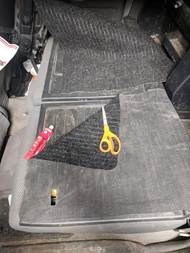

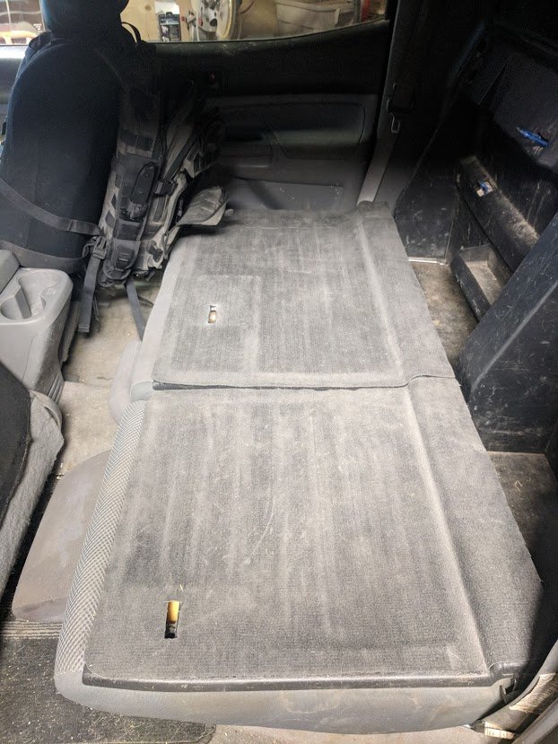

    BackSeat Carpet Mod, Ferda Dogs

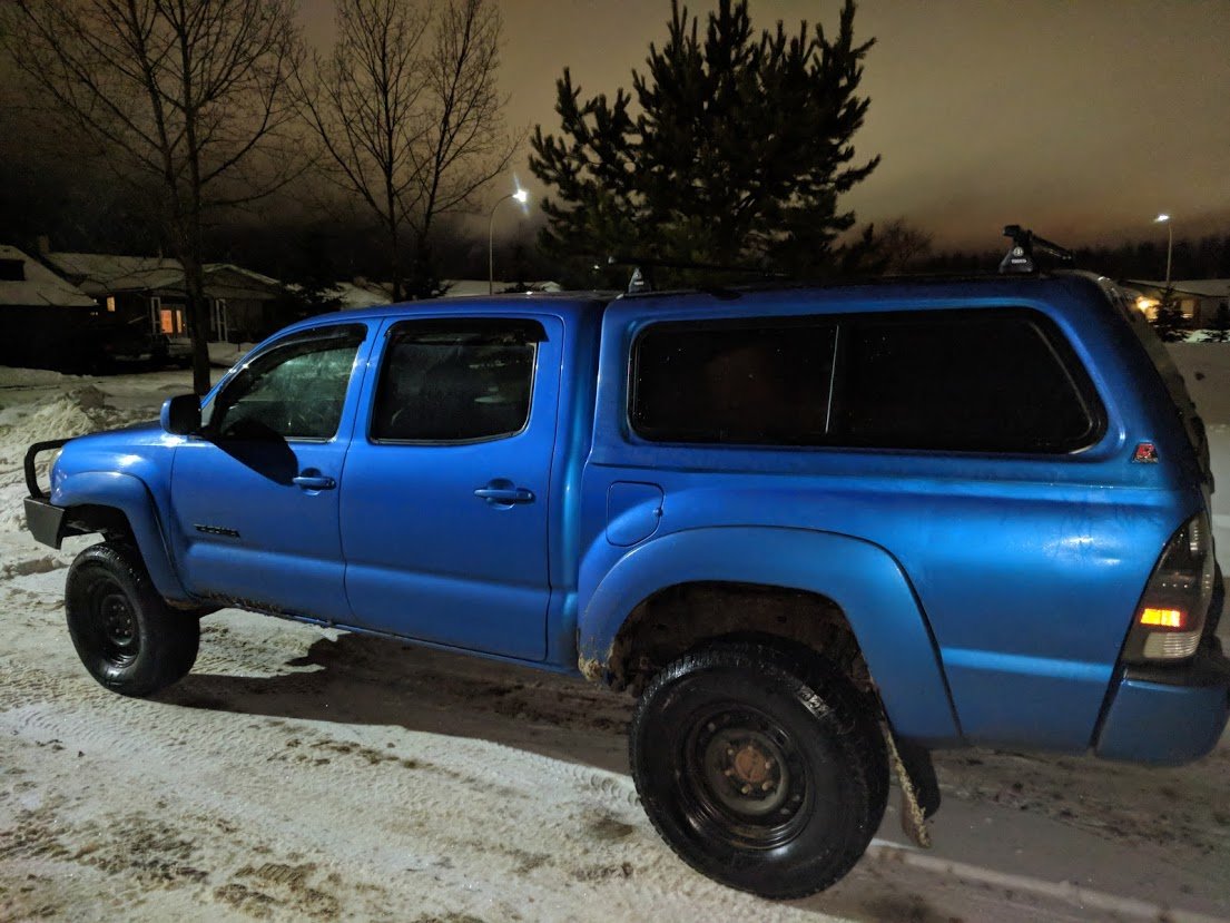

    WAc_rw39VZ6nyGlVH2NhvLYoX7kE4OUjvffNbFUr_23262cc7aa9457b3576a037fa7dfb53eb420da71.jpg
    This was right after installing Bilstein 5100s, with 886s on 0" but right before removing the 2" blocks and ride rite airbags from the rear.
    I knew at this point that I'd get my desired lift without having to screw around with airbags, and spacers were just bad news. Sold the ride-rites for $100 to a heep

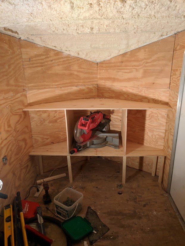

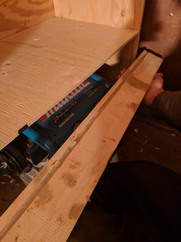

    At no point was the bed empty, I am a framer, and carry a full outfit of tools with me, so the bro-lean was part of life for a while.
    Here was my custom bed storage for carpentry tools.cvBQjvhjjlpGnYxwl7ZsB7bGxYoT8dmPOTQMTHJz_5a62ae55c467a6889ccb456fb461c2e5131bb9f5.jpg Rt_EOrOpkm0q_QsTjfM6_fxWuj098fkV4efxLTWG_edcf9b273c40aa5520c29055c063a240b701a0c0.jpg

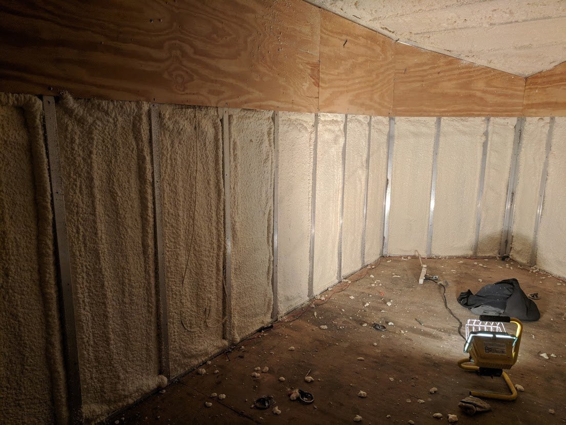

    6x12, plus 2' v nose, slanted front, all aluminum.
    Single axle, and just shy of 1000#s dry. I figure after adding brakes, spray-foaming the walls/ceiling/underside and building the shelving, it's probably 1250lbs.

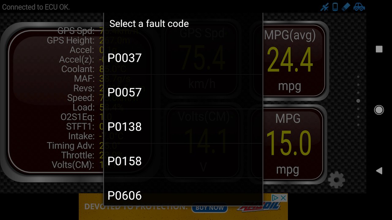

    I've been driving around with the following codes since I purchased.
    HJm3W42buxqqtSb52mlwthMKx7DzizVYeyG2YNs0_3d323fc6f04b2fc6d4833682e88b52116d11fc33.jpg

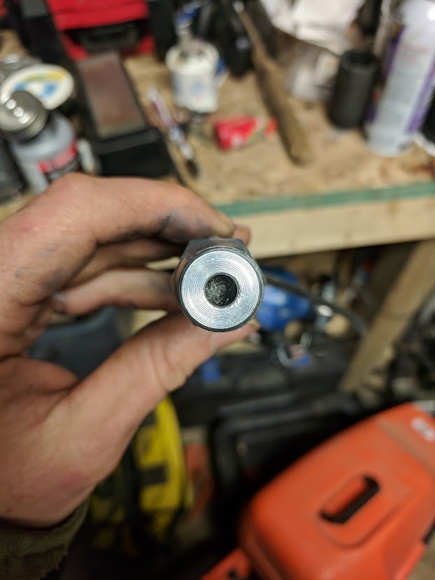

    I determined that both downstream HO2S were kaput, and replaced them both, a few days apart.

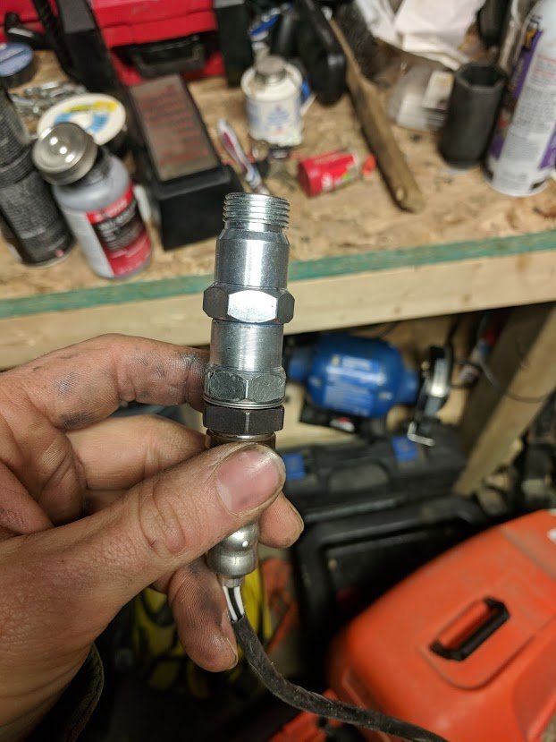

    Taking a tip I found online, usually applied to older machines, I also purchased two pairs of Spark Plug Non-Foulers, to back the sensors out of the direct flow of exhaust gasses. This is a $20 dollar solution, that otherwise would be a $200(cad) fix thru URD O2 simulators.
    hQwmHHz4mKDRADoBQZpKpde3qpGKNENd6euitHlO_11721789d71df7ce8830101cecb37b02aebe3b65.jpg
    R6BIm_3mQ3nR5U3hmqyKA5HK-LVCbGMCecMaujro_c950c84bb95a51b10adec4ddc4642eadcd01ba53.jpg
    I also started experimenting with steel wool placed between the sensor and the intact non-fouler plug, to act as a further buffer.
    Y6XB5-i_y9LY1UCUAIp-oTuH-3x5sLFZqBlDRcth_6c29b7db6786435867f029bbab194c772d9a4e02.jpg

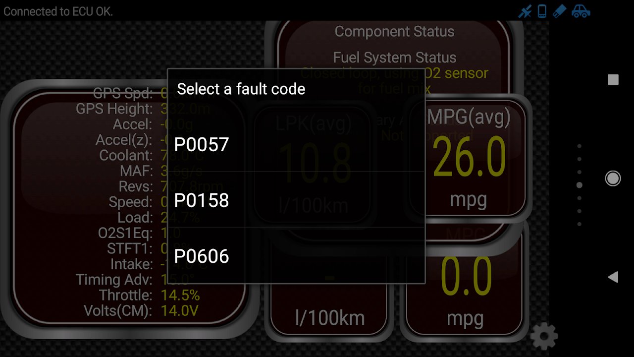

    I put the new sensor into Bank 2, and drove it around for a while after resetting the CEL
    Result:
    c8w3OksAbgVzwt97d9tN4ZhE2fT42PXJzk3hU0FC_41d098c32f27a066ea65b61751118df08ef3b0da.jpg
    What causes the P0057 code?
    • The most common cause of the P0057 trouble code is a faulty bank 2 sensor 2 oxygen sensor.
    • Some other possible causes are faulty powertrain control modules or damage to the wiring in the heater control circuit.
      What causes the P0158 code? Bank 2 Sensor 2
      • Failed rear oxygen sensor
      • Failed rear oxygen sensor heater circuit
      • Engine coolant temperature sensor bad
      • Shorts, breaks, or exposed oxygen sensor wiring
      • Excessive fuel pressure
      • Necessary power control module (PCM) update
      • Failure of the power control module (PCM)
    The P0606 is a code that will inform you that there an electrical issue with you ECM, and if you were to take it down to toyota, they would replace your ECM, and take your firstborn child in return. There is quite a bit of evidence, however that having a damaged downstream sensor will trip this code. So I ignored it for now.
    I was kinda confused that Bank 2 Sensor 2 was giving the error codes, as this is where my new sensor was.

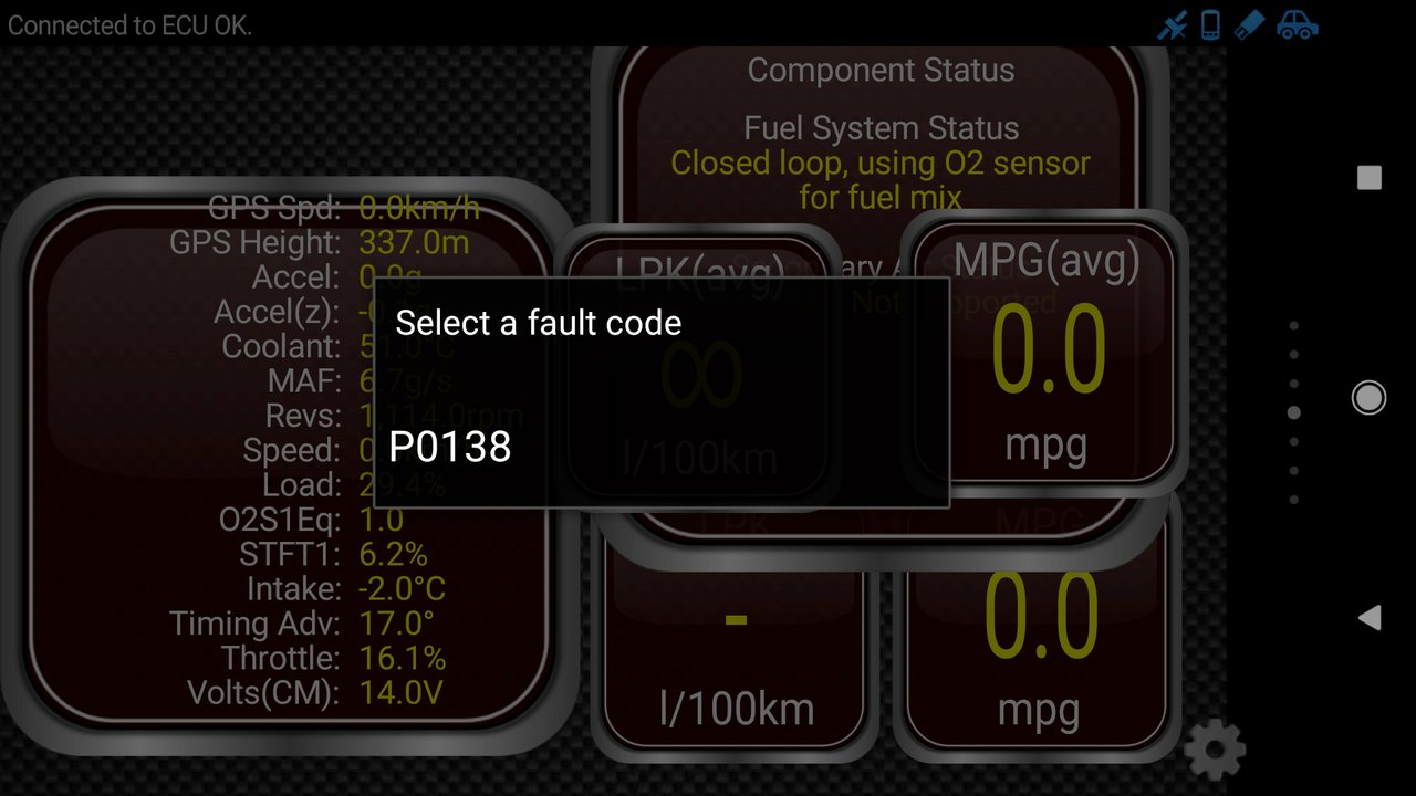

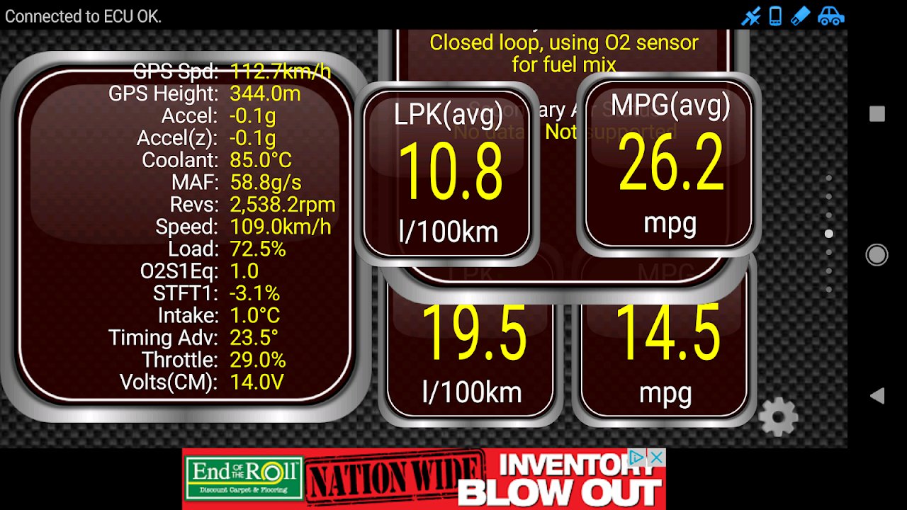

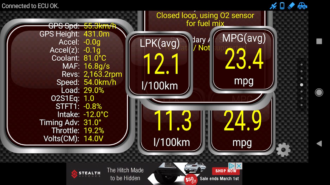

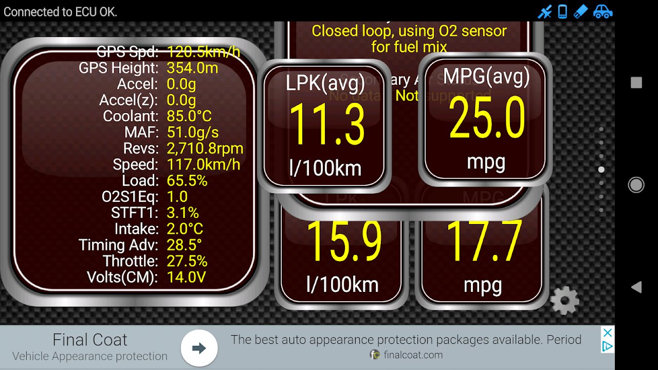

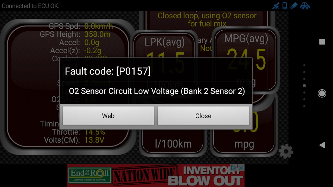

    At this time too, I also dug a bit deeper into my obd2 Bluetooth code reader to determine whether I was in open or closed loop condition.
    1Kl8HpqUB8YWI-vwPtUczDGqsakYVY8DxUhAsQFO_63f9fbe4f90f2f5f18e40667d56bda71bd1965d1.jpg
    Okay, so we we're in closed loop, so it wasn't using open-loop A/F ratios , and it was using Sensors for my AF mix. Which was definitely a step in the right direction. Still not convinced that it wasn't leaving pools of fuel on the road everywhere I went.
    Installed the second replacement HO2S, reset the CEL and went for a drive.
    Came up with the following codes.
    8EGedU1bVuYjXIwl-x-QgCtvm3R8acwOQApDSYEz_4731226831a18bce71d04c13ca336d11cde7117b.jpg
    nrnGwyzVVZwIdGRAzjl7iui0i9bt-ACRZKj6Gwrs_126599ebf29669970e9956f7f789938c154d15c6.jpg AG4mlORrTDdR50xZkfTo46XaMnHy309339XKa9ZK_0bd4b733151f3f80e773a1fc24e617f7432ce4ef.jpg

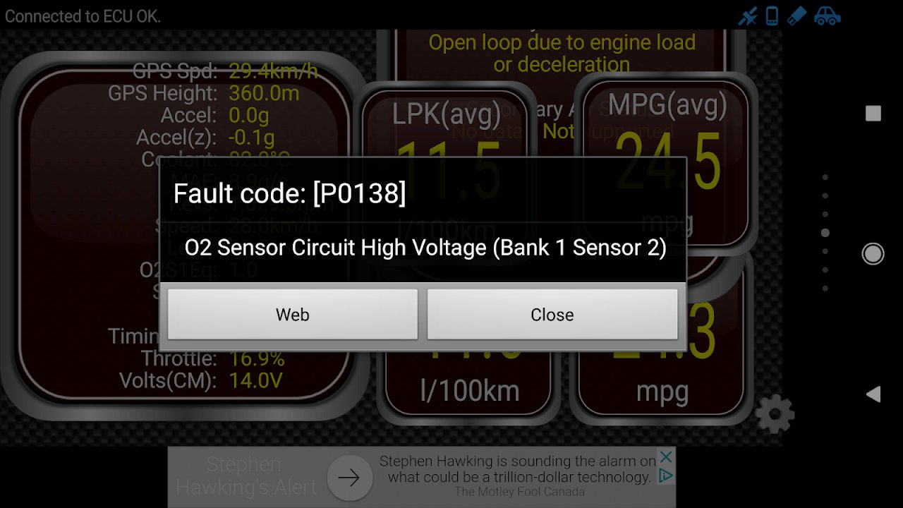

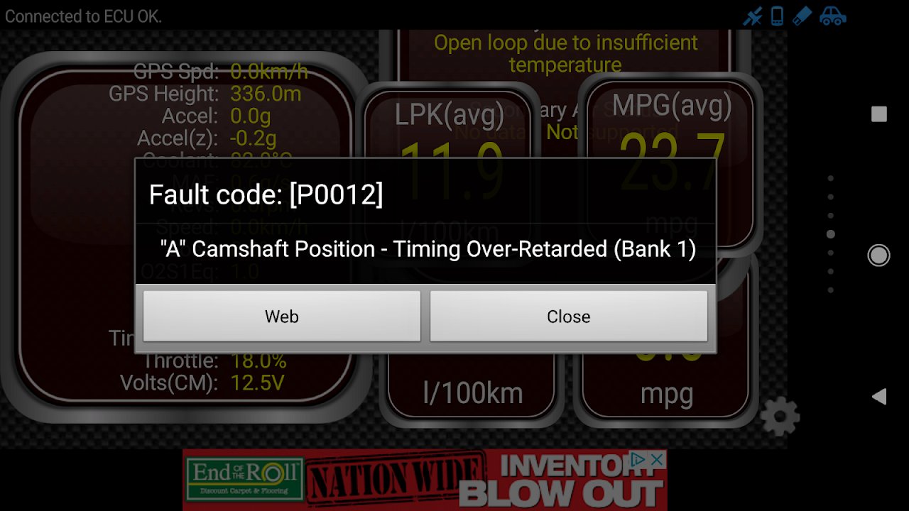

    So I had a new code about to trigger my CEL, the P0012 (just a pending code, at this point)
    I had traded my P0057 (bad bank 2 sensor) for a P0157 (lean mixture Bank 2)
    And traded a P0158 (too much fuel Bank 2 (driver)) for a P0138 (too much fuel Bank 1(passenger)
    Went for a cruise, and took it out onto the highway, and the pending codes triggered the CEL pretty quick, I think going over 60mph is one of the conditions for the CEL. Reset the codes, and made it home with no light.
    I also pulled my OCV valve, my camshaft sensor, and the OCV filter, tested the function of the valve, and it was fine.
    The filter was pretty grubby, so gave them all a bath, reinstalled, and the p0012 code has not come back.
    I am going to experiment with denser/looser steel wool packs in the non-fouler plugs to see if I can't get a fully clear code situation.
    annnd if I still have an intermittent CEL I am going to skip a step, buying the URD o2 sim, and go directly to the OVTuning solution. I figure for an extra few hundred bucks, and solve a whole range of driveability issues that I've learned to live with.
    Will continue to update with progress, gone to go for a drive and see what I can see.

    Just got back from a quick rip, bunch of city driving, bunch of highway driving, and bunch of off-road power line driving in 4x4.. The P0157, and p0138 are still showing up in pending. Going to do some digging and find out how seriously I should be taking these. After 50km no check engine light, so it's sensing some undesirable ratios after the cats, but not enough to trigger my CEL, I am still concerned about the P0157, it might be causing my engine to pump more fuel into the mix, screwing with my mpg.. I'd love to have it read normal, or fuel rich if anything..
    Edit: Cannot determine if clearing logged faults also clears pending faults, but a fault will stay in the system for 40 warming cycles (temps going from cold to 160F) before they clear from the system, I might have to disconnect the battery to clear the pending fault, but I'm going to leave it for now and see if they trigger the CEL over the next few days
    Here are some screenshots of instant MPG readouts at 110km/h and 120km/h.. which seem to suggest that I get better economy between 2500-3000rpm than 2000-2500. these readings were pretty consistent. Also, the mpg average for this rip was very high, and does not seem to correlate with the fuel gauge.. i still feel like i'm running rich.. this is going to take some time to get accurate feedback..
    k3RLCZmJmScMj1rWX7zOvzcAqypS4XsPLwXnsuk9_c1027c09e2d3ce53faafdaf4c413c7fd76167358.jpg
    ohp_9h8eteruJPpJ4-du5gujsmhB8MQH9RabrZ4Z_ae4fd22514a2f19176ade3cdde37947e2b26200c.jpg
    Also, I really need to get 33's on there.. I'd take that 10% decrease in rpm for highway speed...

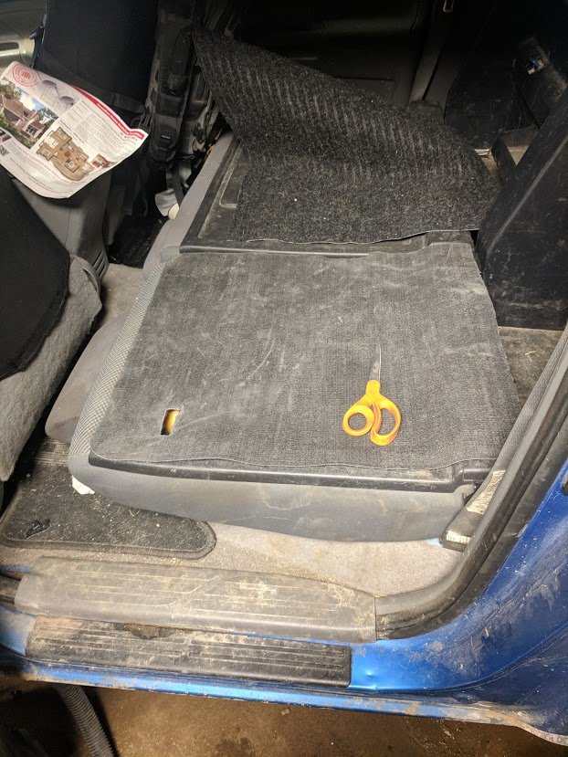

    For the dogs:
    I removed the back seat bottoms a long time ago, I don't have human passengers all that often, and when I do I just fold the seat backs upright, and it's fine. Most of the time I'm not taking people far.
    It's much more practical for my purposes, I had been throwing a floor mat across the back of the folded down seats, but it still slides around a bit, and it is a pain to access the storage under the seats. So I got ambitious and cut out pieces of the floor mat to adhere to the back sides of each seat.
    qNNfw254fm2_pWMSsWcU4l89t-m_Gm1dsScxQKKy_390ef3d9439620eee7c563450ba160bd443d6533.jpg DQYD24bDSOteRunYdzUJ_i4Ga04Yv0EBIRfrCX2w_d46dd0cfcc60b7b4dbc1007b219419c0830c997c.jpg
    I layed them out, cut out the holes for the latch, scrubbed down the seat backs for a better adhesion, and liberally applyed shoe-goo/automotive adhesive onto the seat back, then firmly pressed the carpet down. I installed the floor mat upside down for easier cleaning, and less dog hair embedded into the carpet, as kind of a last minute decision. Do no regret.
    I put some heavy crates on the bottom edge to ensure the glue set with the mats tight, left it overnight.
    Few weeks later and the dogs are happy, my equipment doesn't slide around, and cleaning it out is a breeze.
    HJEhZoNPmaa8iAVOx6LNr-ALH5IRo3gVXLcYDQhY_d60fe518218c7ac9265b5eac521d02cbc6673674.jpg
    The mat was a $5.00 factory cut off from Princess Auto, and I used the better part of a $5.00 tube of glue..

    Last night after a long drive, bombing thru some deeper snow along the power lines and letting the dogs blow some steam, checked the status on my fault codes. Still no CEL. But these two were still lurking in 'pending'
    P0157
    p0138
    After my drive to work this morning, I noticed the CEL was back
    ..it's just for the passenger side sensor..
    Going to pull Bank 1 sensor2, and try repacking with more, but less dense steel wool, as it seems to have calmed down the bank 2 sensor 2, or at least made it less sensitive..
    I'm also very sure that this is a case by case scenario, and there is not going to be a sweet spot that'll work for everyone, but for the time being, I'm happy to screw around in hopes of resolving my issue on the cheap.
    Also going to try to bust free my two upstream AF sensors and try giving them a bath, i suspect they're pretty gunked up.. and stuck af..
    Edit:
    Progress on the CEL and HO2 sensors is going to be on hold for a couple days until the roads dry up at least enough to make it from the car wash to the garage without packing the frame full of snow. Doesn't matter how often I clean it, 5 minutes on the road and it's covered.
    I'm also not going to get too carried away with my cheap-o o2 sensor fix, I suspect I'll be purchasing a tuner to take care of my issues regardless.
    Given the choice between the URD O2 sim, and OVTuner, I'll bit the money bullet and get some gains out of the deal.
    Will Update this with pertinent information.
    Update Feb. 26, 2018
    Went 150km on a 1/4 tank of gas, and no CEL light today..
    Pulled in for a much needed suds and scrubs for the truck, and noticed the CEL was back on..
    Going to pull in into the garage and pull the sensors, and drown them in dielectric grease.
    I have never gotten that kind of mileage with my truck though, it was at 60km before it dipped below the F line.
    e1eCTPIRjCQEzJgZbamVEUdM5WR5uSEHK_YoKV4D_be7411877bfeb21b6f4a9060f4f706bd55715bcf.jpg
    I'm usually happy to see 100km per 1/4 tank, I know it's not a proportional gauge, but something's making my engine happy, and running with a proper AF ratio.
    Also noticed that my sensor voltages are reading 0 for a while after first starting up the truck.. They start to give normal readings after it warms up, I'm thinking it could very well be a connection issue.

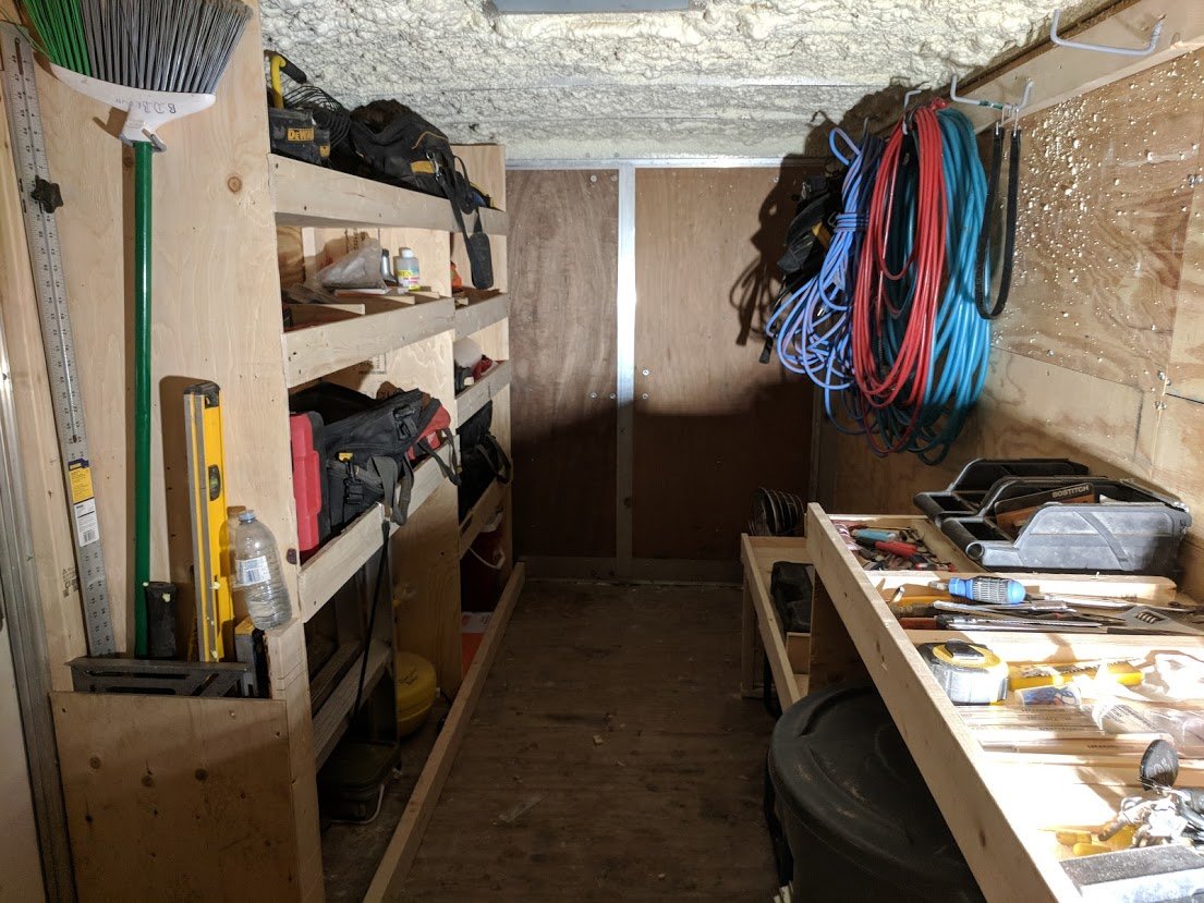

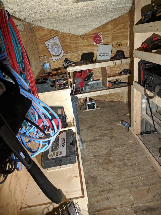

    The trailer build.
    With the used market being so good where I am, I had an impossible time not acquiring more tools than I could comfortably store in my short box. The first time I had to make two trips to job site because I couldn't fit everything in the truck I started watching kijiji for trailers. I am extremely protective of my tools, I put everything away, under lock, key, camera, and alarms so I can go take a piss off-site.
    I've been ripped off before, and figure it's just best that it doesn't happen anymore. So dropping tools off at a site to go get more tools did not sit well with me at all.
    I was undecided about what size to get, most jobsite trailers I've used in the past were 7x14, and I wasn't too keen on going smaller. But 7' wide trailers don't offer any view behind you. They are a pain in traffic, they are a pain to park, and they are a $$$ pain to pull. I've used tow mirrors before pulling my TT, and while they do work, they look hokey AF, and really don't do a very good job.
    At the end of the day, my mind was made up when I found a killer deal on a 6x12 slanted v-nose aluminum trailer by lightning. It was far away, but it was also the week before christmas, so I could take the opportunity to go see family for christmas, and borrow my brothers shop to do the preliminary mods on the trailer.
    So off I went.
    UM9tOZYUWrT4sf11Q8HxLpmrefhIKQ36m4ZGQVFx_2cf06593abd9c51120d78a884de2b51e46a12ae0.jpg
    It looked just as good in person as it did in the adds. Year was 2012, and it had been stored indoors, except when it was being used to move the guys possessions from ontario to saskatchewan.. Only wear was some gravel dents from being pulled by a big lifted diesel, and the door trim had been damaged from loading heavy furniture in. I will be doing much worse to it I am sure.. I handed him $3k, he handed me the title.. Good Deal!
    Made it 60km down the road and realized I had burnt 1/4 tank of fuel and started panicking.. Pulled over, and went over everything.. I had checked everything out at the property, the tires were junk, and I'd be buying new tires, axles were fine, leafs looked good.. I figured I'd check the temperature of the hubs, maybe the bearings were bad... I put a knee on the tire and sunk in, they were quite low.. I hadn't checked my psi:anonymous:.. Filled them up to proper psi, and hit the road.... mucho bueno, pulled so much better than the TT, mpgs were barely effected..
    Made it to my brothers house, pulled a set of brakes off my tandem axle Travel Trailer, and threw them on.. Pulled the plywood off and blasted 1" of foam between the studs and on the roof, and about 2" underneath,
    I was using the frothpak 200 kits, which are pricey, but if you've ever tried using air equipment in -30, they don't work... I wanted to be able to run a small heater in the trailer overnight and keep my equipment within operating temperatures. I had done the same with my TT, and lived in it thru a northern winter with a 1500w heater, so I knew it worked.
    EVzHG2ocMUBUgmD_LkQsbPYPPD2pbJzMnt0V3Gwx_b51cdc71f22f06270a02d9421a3fde9535504b4f.jpg
    Just having the 500w halogen light in there, it got uncomfortably warm with the doors closed.

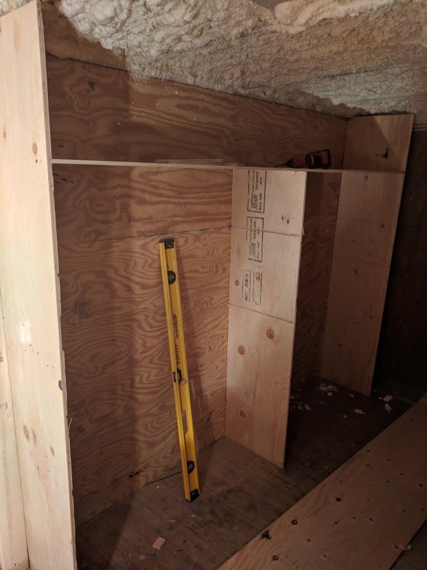

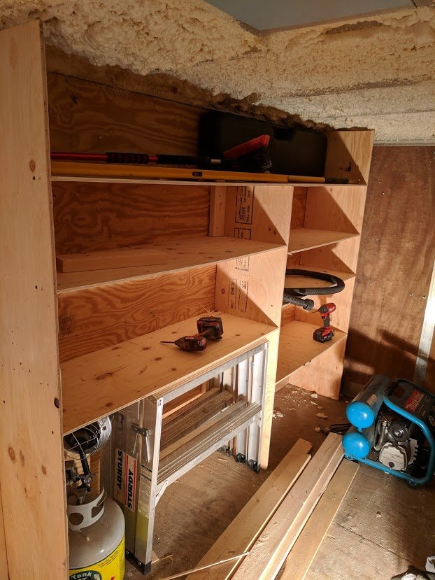

    Next I started shelving, I didn't have much of a plan, so I just started cutting plywood and making custom sized cubbies for the essential/bigger tools.
    u6lqiJ0SKVGCM9ow_q9ArwHBbBVDjzlzhUevZD-b_3ad7adf071b001e90e16790874d54011a9af41ef.jpg
    Vd63bLFnR-e1Z5jTtqBh8Ywg2NN7Hat9CAb74_jj_b21055a8db40c4e132cd2eb7ffe30ffeef5e0b8c.jpg

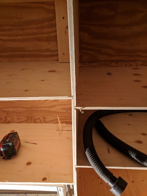

    I was also experimenting with my new router.. Usually it would have been 2x4 frame and plywood shelves, but I wanted to make it as light as possible, so mostly 3/8ply, with some 1/2" for the bigger stuff, and routered grooves with lots of PL premium.
    Ubj25XZSLZ4kBy3O6MIzZ08W8fsEFv29TuiLDeKi_766447c820d2ca7e3a73806235a138b8e9f563b5.jpg b8PYKI9HGCZzyDZZZs1NE1RfPqVrzLtielo6GPrg_64e87f3dc353dc49f5e6ad3b646240e688912155.jpg nK7SvcJFfanK4wNuADc614_DxchFH3gtKA9RR0x6_037b93bd9876b311ee6828c79f2921ab0f27a2e6.jpg S9uKQUzzLi4v4tgStIMgixV0mfyJx9QvmaTu8NQ2_9d23a439a59ec43f7e9bb3f38afbde9d752e8a56.jpg DpwwJQ2dukDbOoNdiavWcz8_H65rBu7NTUCikano_857bbecb82d9e0a084958645e621af68a5b52d05.jpg
    After a day of cure time I'm convinced I could back out the screws and dance on the shelving, the router/glue combo is insanely strong.
    and I don't see how it could have been more than 100lbs of material to fully equip it.

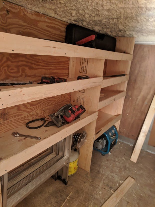

    aK7mQn_YvjT4243SgAkNfg8W7vAEij-CwoWWYQUe_537e31c31d43b6bfd7aff9659108def4b928808c.jpg TDQ3sUGkYt627IpyLs8kCSJ6QQ2KtYVzGTnR0quU_31b97d196858f654420d74021f38cbda199891b1.jpg
    Everything has it's space, and everything is staying warm.. I found that when it drops to -40, I have to move my compressor next to the light/heater and have direct heat on the block, or it just coughs at me in the morning.
    I also punched a hole thru the trailer to run power/air manifolds. I run a cord to the power source, and air from the trailer to the job, and the compressor stays in its spot.
    I also just finished wiring up a battery to the 7pin harness, to power my security.
    No photos or real details of security, because that's how it works.
    Total cost of trailer. little less than 4k cad (not including tools and security)

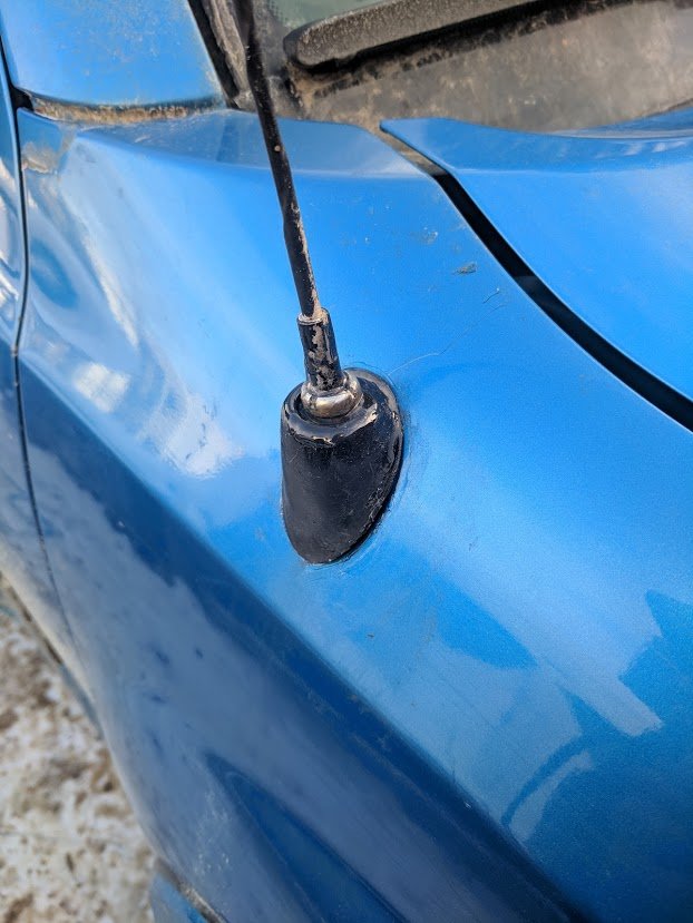

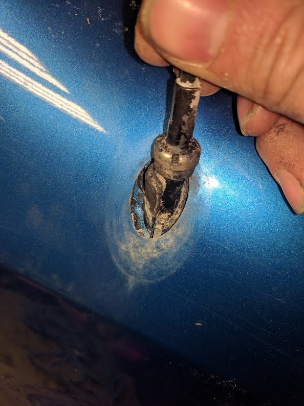

    My DIY super cheap antenna fix.

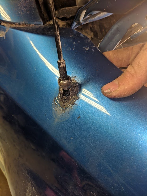

    Pretty common problem with tacoma antenna's is corrosion of the bracket, to the point where it completely siezes up, and will simply break when you try to remove/replace it, or, in my case, before you even look at it.
    pFzPtDW0l8p7-opzMjt5wEYUA2lrn5XJW1rArW77_1ee7e09c7483c4003a8fe0c08b3675aa2c1430f6.jpg
    The replacement parts cost $100us, and the procedure is fairly complicated.
    I barely ever use my radio, and spending an afternoon, and a pretty penny on replacing something that does very little for me just didn't sound like a fun time.
    My solution?
    JB weld
    I peeled the boot up, broke off the remaining pieces of the bracket,and gobbed JB weld all over it
    WOIAJNJS_-Ug-3gJr7hkWQyWOI_BiCZL5eZ49Un3_8202dc14d237081ba203e0f1c9182ae90214b655.jpg YeHIsgo_wgrUO0M8q5jj0TXKIUU3CLIJovtcMEb8_d9d323f3d1863c93877328f019b6470738849986.jpg
    Recommend you use quick set, there is no great way to hold it in place while it sets, and any more than 5 minutes and I may have gotten bored.
    After it set, I filled the boot with an automotive adhesive and re-seated in where it was.
    dY5Q3GLbpeaBfEcupouJd8-8ugD0YjgVEwlq6tLZ_a04c529f394849ada097ccace9a279f55fc1d35c.jpg
    BpTuHHN0i5GJJjsSti9G181FF4iE59nUinmyIXAZ_7c48a9131ae737b6b3af678f0cfee42ae56c43ab.jpg
    For 10 minutes, and $10 of adhesives, my antenna is no longer rocking back and forth, radio still works..
    Remember, If she doesn't find you handsome, she should at least find you handy.
    Edited for photos, thx @tcBob
