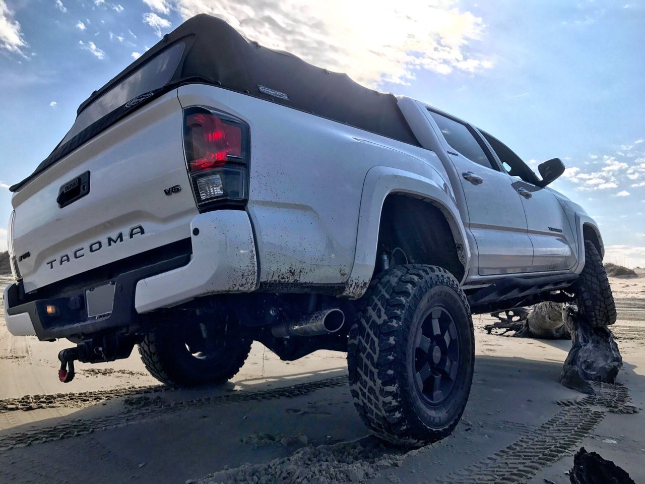

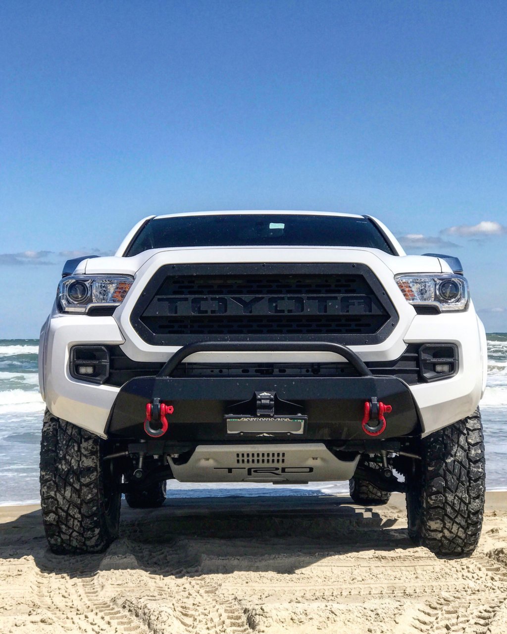

    This is my truck sporting 255/85/16 Toyo Open Country M/T. BTW - I was able to fit this under the truck on the spare wheel.
