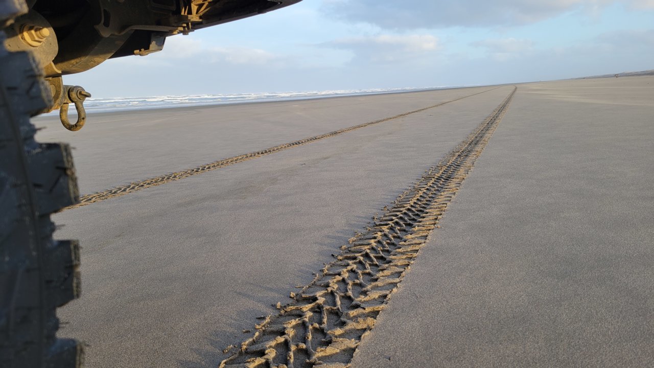

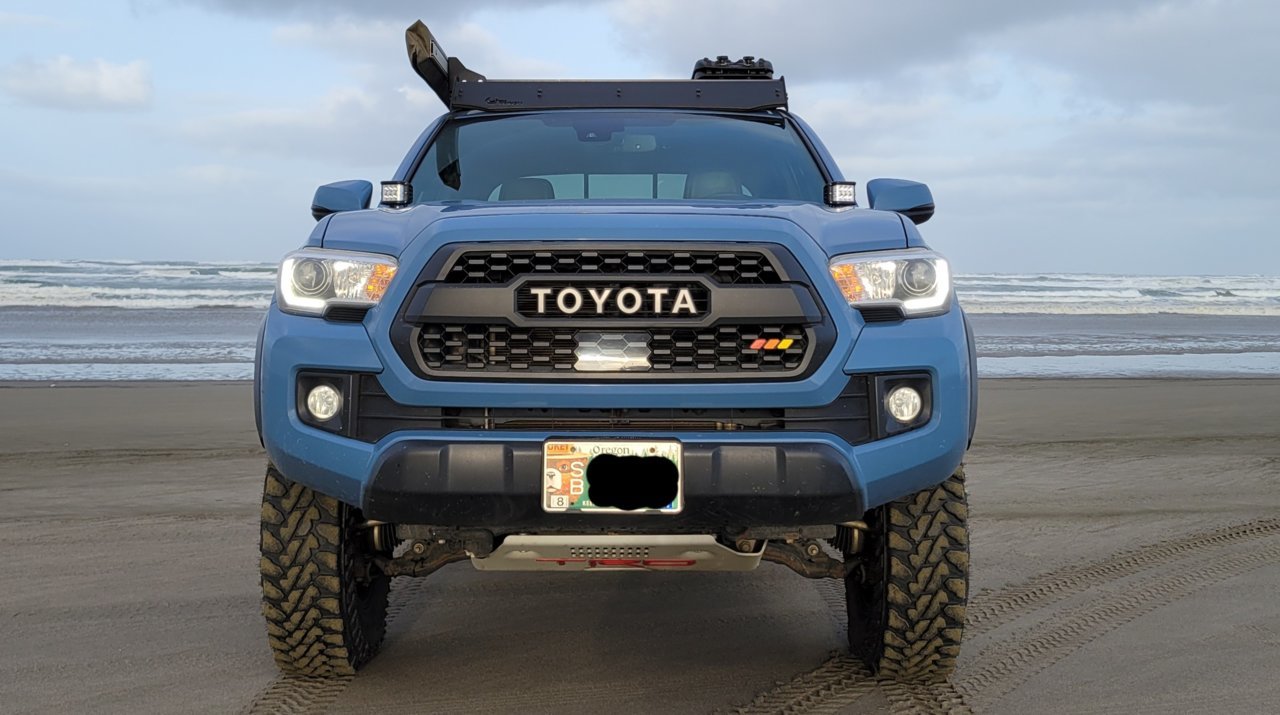

    The skinnies are doing great on the beach!

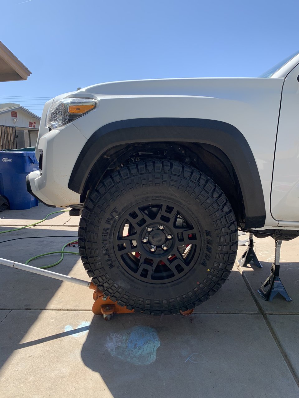

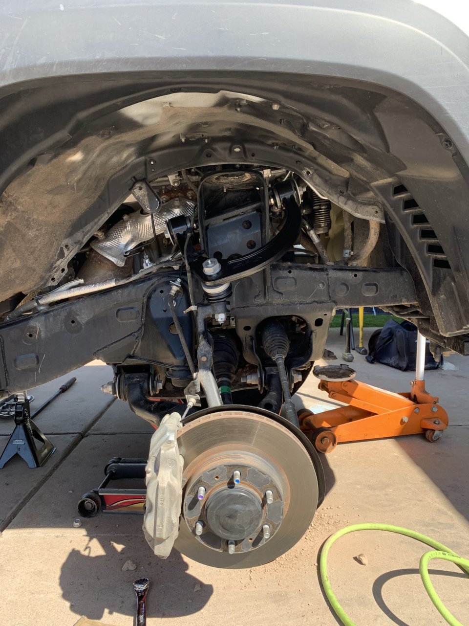

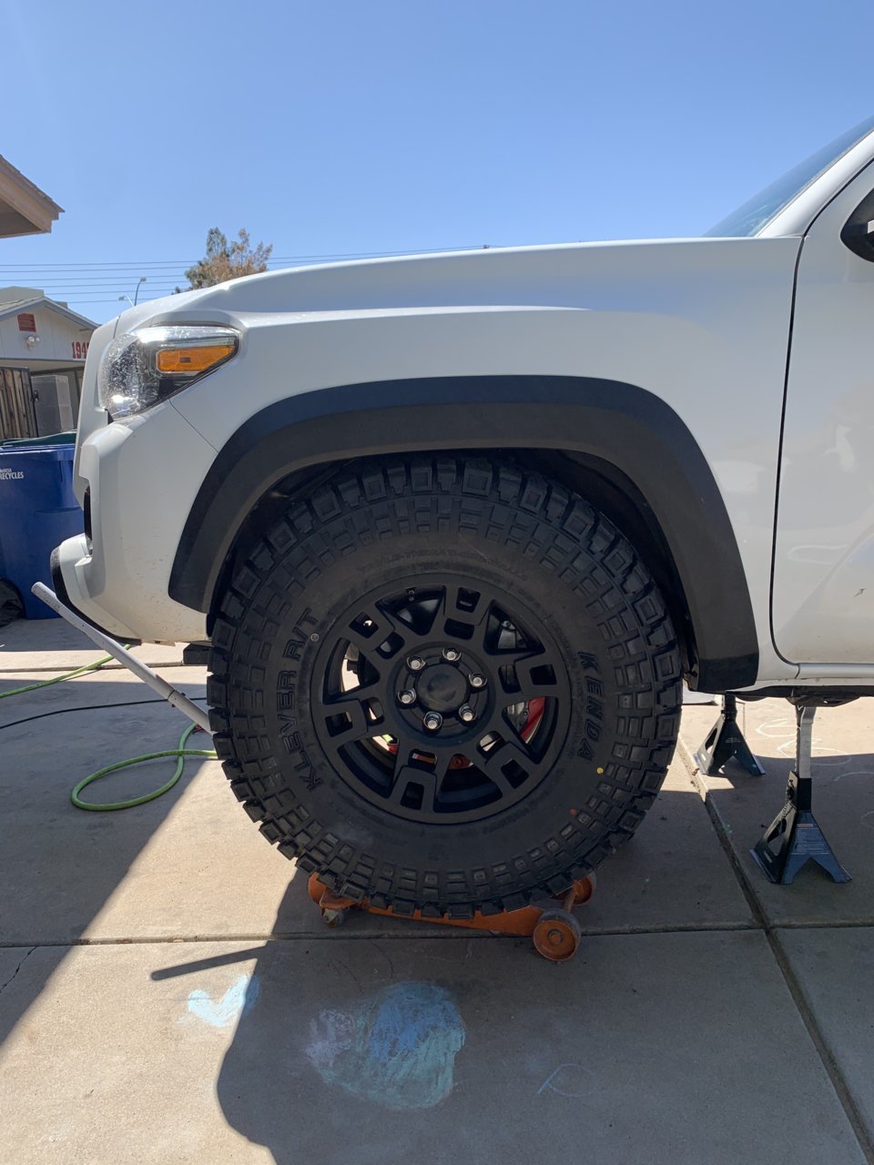

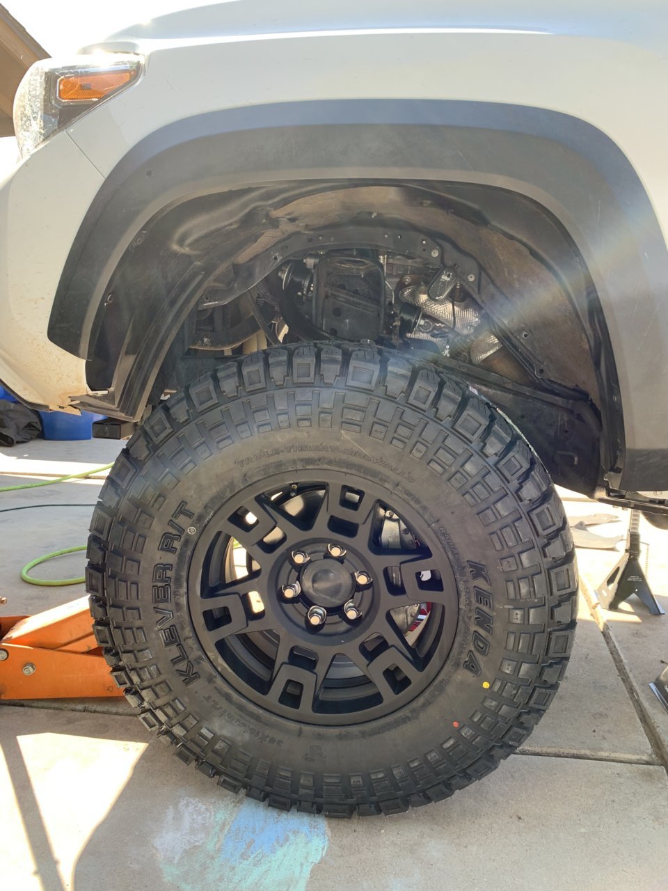

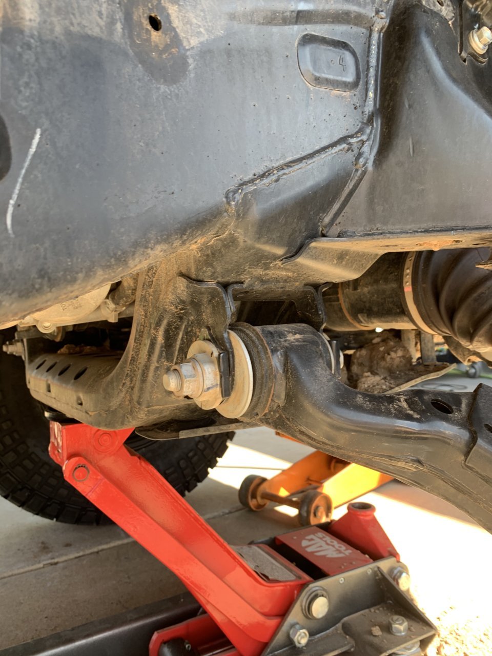

    Good to know. I’ll try it later. Just finished the control arms and about to start cutting after I eat some lunch.

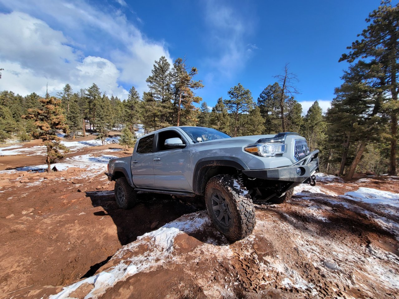

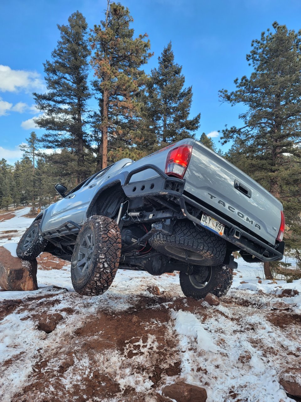

    I need to cut some more of my liner away. They did well today on mini moab.

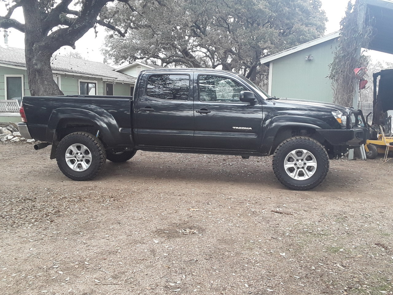

    Got my 255x80x17 cooper st maxx put on today. My buddy gave me the wheels off of his wife's new 4runner. I put Icon rxt's at stage 2 in the back today. When I have time I've got 5100's with ome 888's and jba uppers for the front to replace the spacer that I bought the truck with.

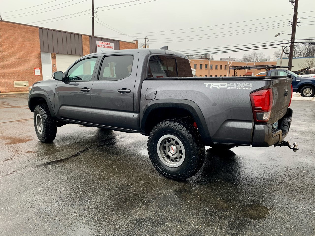

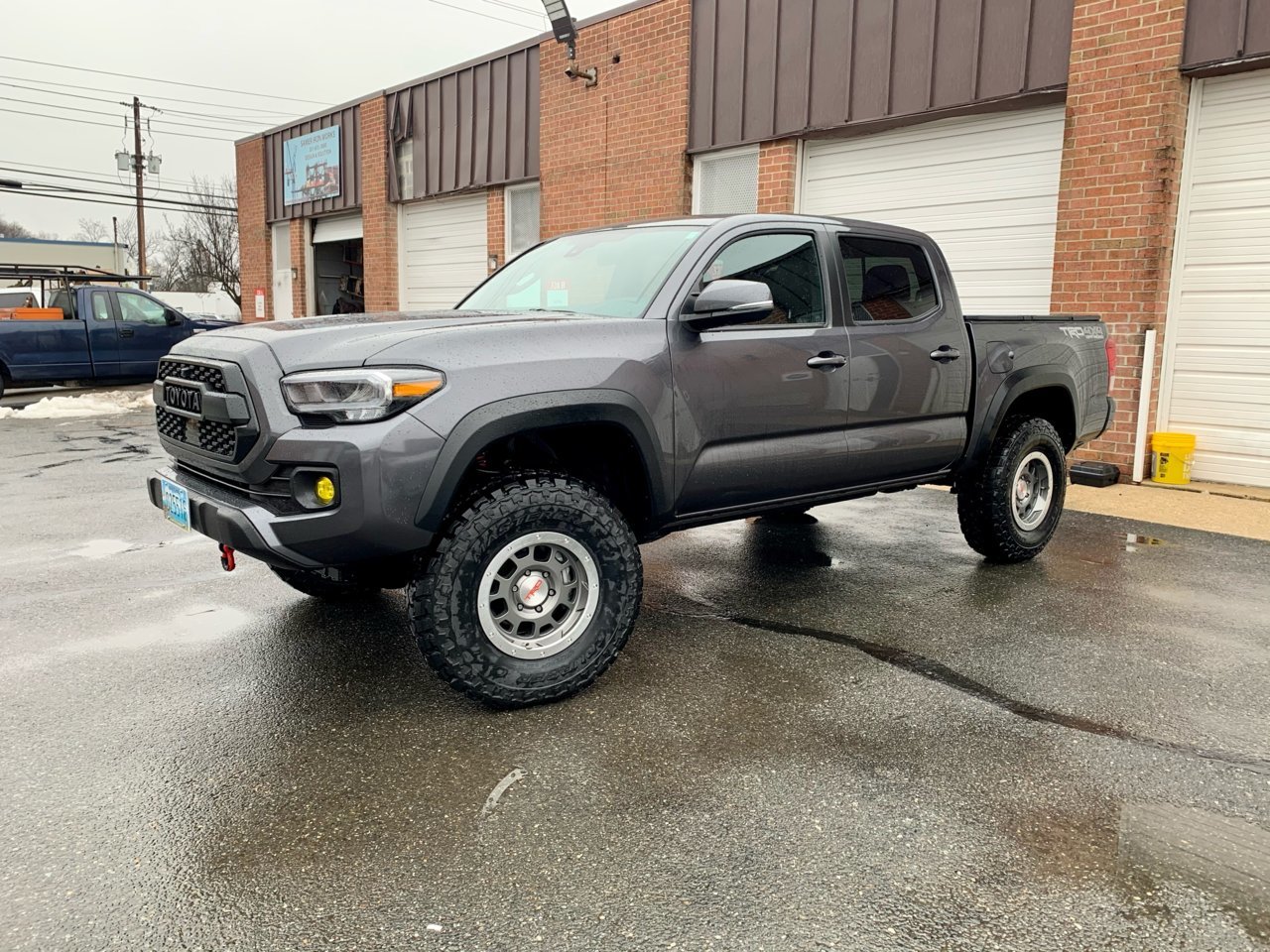

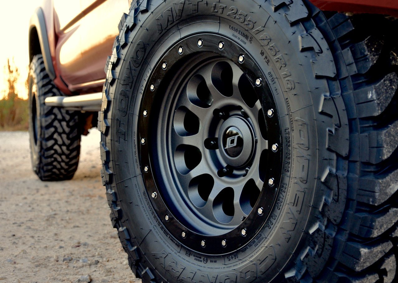

    I'm really loving my pizza cutters! Mastercraft CXT 255/85/16

    Your setup has made me reconsider my options for new tires this spring.
    Those Mastercrafts look awesome! Still one of my first choices, wish they were more widely available. Your wheels look familiar:
    I was just about to pull the trigger on some Cooper Evolution MT 265/75/16 but damnit I had to take a peek at this thread once again.
    Before I take the plunge on 255s...
    • I'm on 5100/885s and an AAL out back (maybe a 2" lift?)
    • I trimmed a bunch of plastic wheel liner when I installed my plate bumper.
    • I'm sticking with my TRD wheels (16x7.5 +10)
    Do you guys think I will have issues with rubbing?
    Power loss?
    Shitty braking distance?
    Anything else?

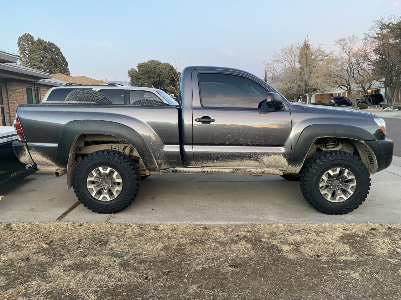

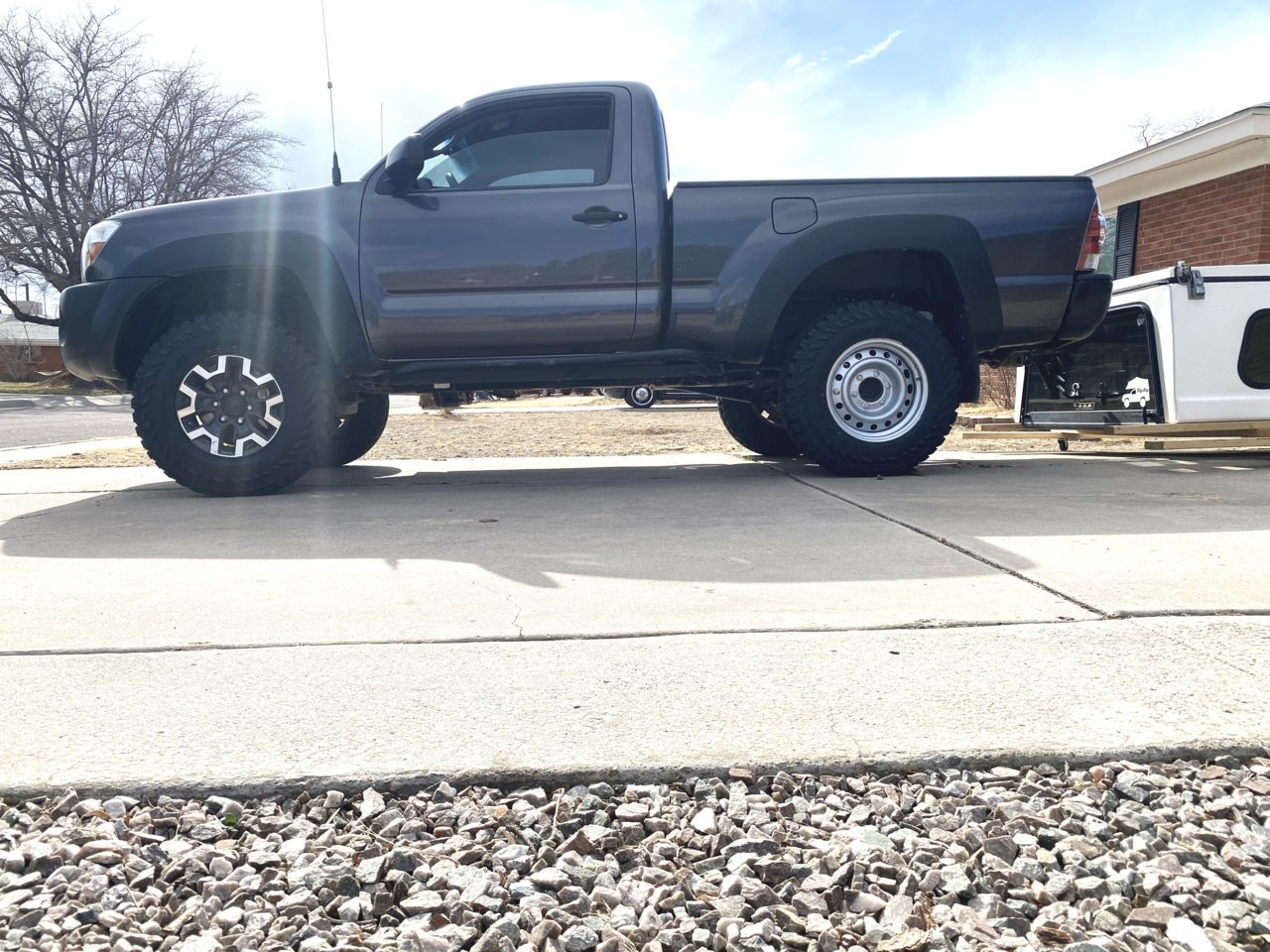

    I picked up a set of five 235/85R16 Geolander M/Ts the other day. I got a killer deal from discount with their price match. I haven’t had chance to test them out on the trail yet but pretty excited.

    They’ll grip hard in the rocks. Taller than the 265/75s most people run but much thinner / smaller contact patch. Lots of force per sq. inch!

    Ya I’ve got a buddy with the 255s they seem to do really well. I’m sure they’ll be a huge improvement over the 265/70R16 A/Ts I had.
    At first they were a little loud but I did the chalk test and the shop had them overfilled for what I needed to be at. I drop from 45 to 40 and they are much quieter and smoother now. I’m curious to see how they wear overtime and if they get louder but my buddy has about 20k on his and they aren’t loud at all.
    On another note I picked up a set of steelies I’m working on repainting silver. I thought the steelies would look great with the tall skinny.
