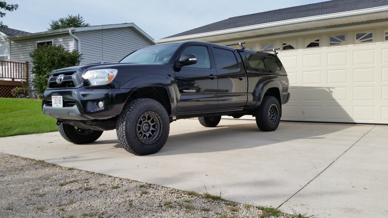

    255/75/17 Hankooks, ,Ray10s
    2.25 lift front
    2.0 lift rear
    Tire/wheel combo weights 1 pound more than stock rims with 265/65/17 Kumho AT51
  2. Sep 7, 2018 at 2:16 PM
    #1162
    jgallo1
    jgallo1 Well-Known Member
    Dec 19, 2011
    #69010
    123
    Ca and MT
    1988 fj62, 2018 Tacoma
    @Taco-Grinder Thanks,
    This is exactly what I am after.
    You running an AAL and bumpstops in the rear?

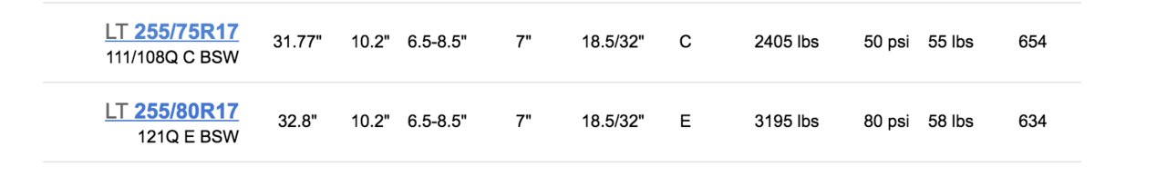

    this has been posted before but here it is again, Cooper st maxx run alittle small according to tiresize.com

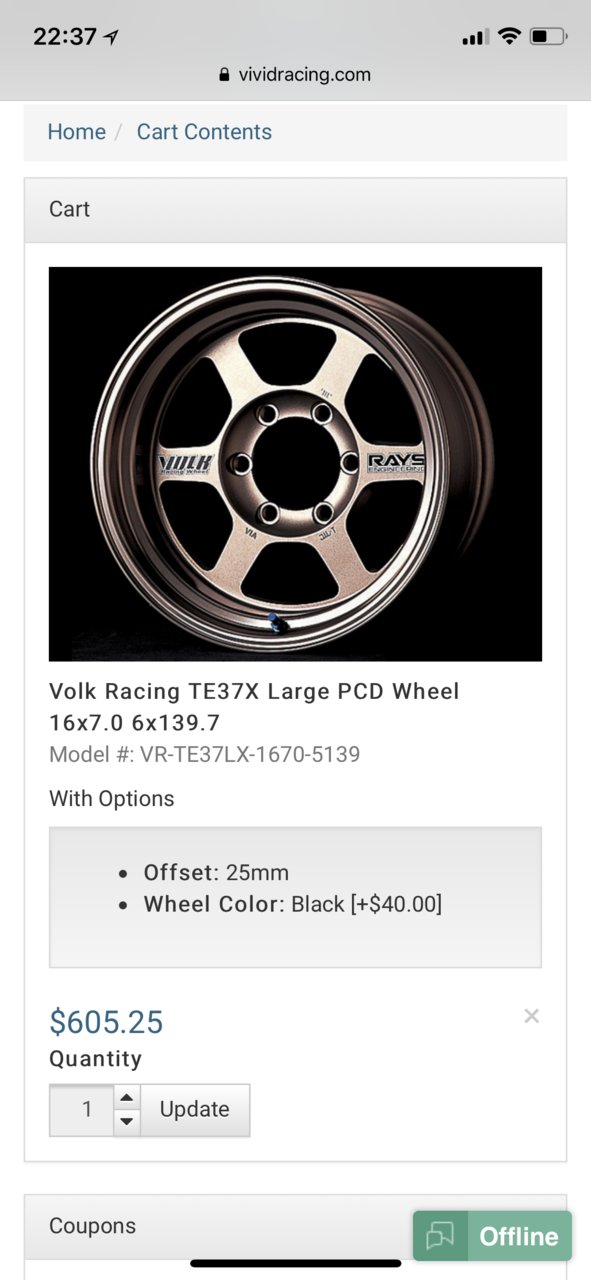

    If I wanted to purchase the Volk Racing TE37X Large PCD Wheel 16x7.0 6x139.7
    Model #: VR-TE37LX-1670-5139 and use the 16” wheel setup below. Could I?
    16" Wheel:
    235/85/16
    255/85/16
    @r

    Both the 235/85/16 and 255/85/16 should fit a 7" wide wheel. When you decide on tire you should check that specific tire specs to make sure, but from a quick check on a couple tires you should be just fine.

    Would I need to lift the truck or good to go as is.

    Folks have been fitting 255s on stock trucks but you need to look at your new wheels. Depending on the backspacing and offset of the wheels, you might have some rubbing. It looks like those wheels have a positive offset, you might rub on the UCAs. If they do, you could remedy the problem with a spacer.
    235s would be an easier fit because they are a 32” tire.
