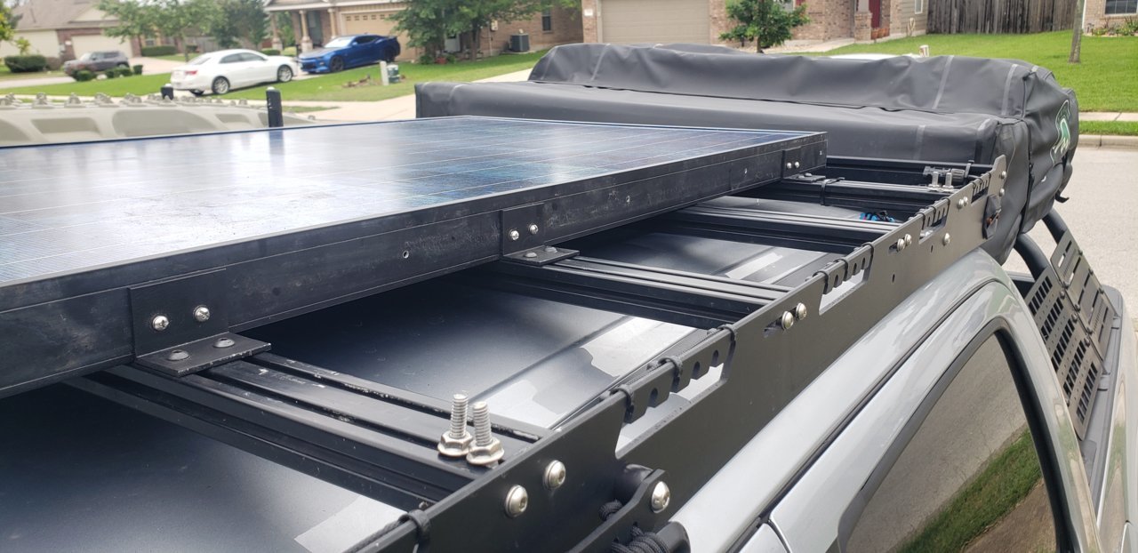

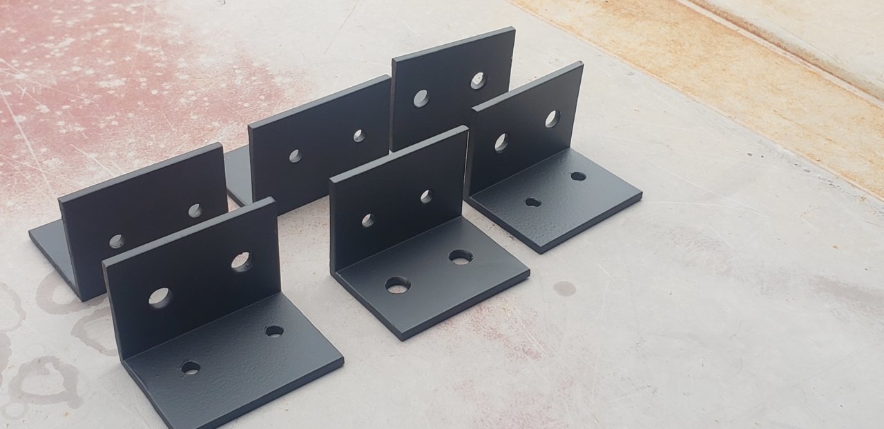

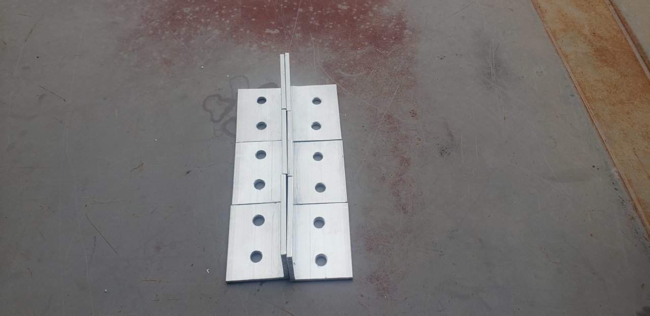

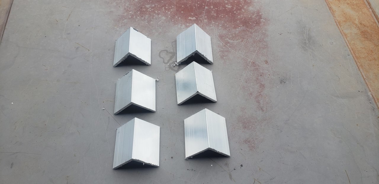

    Built a set of solar panel brackets for the roof rack.
    Started of by cutting some aluminum angle into 2 inch pieces
    Drilled some.mounting holes
    The arts where powder coated matte black.

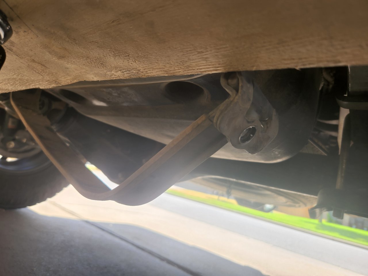

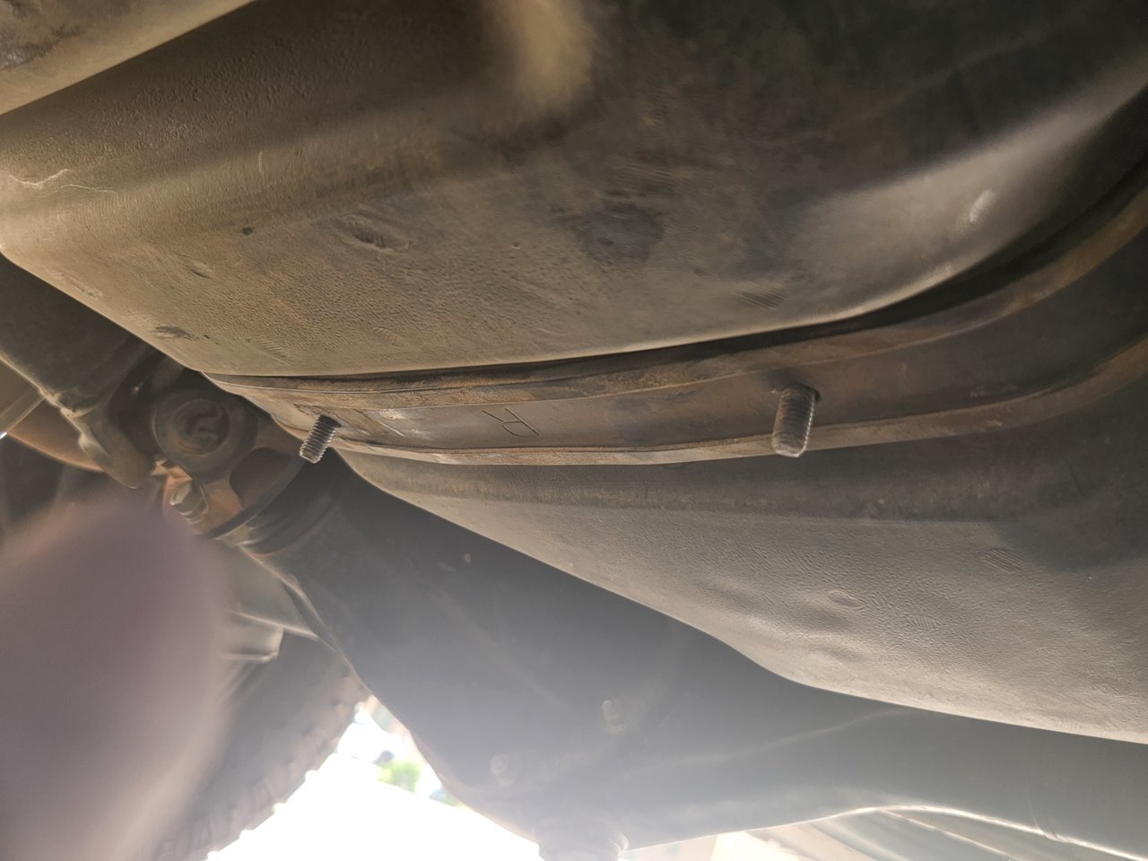

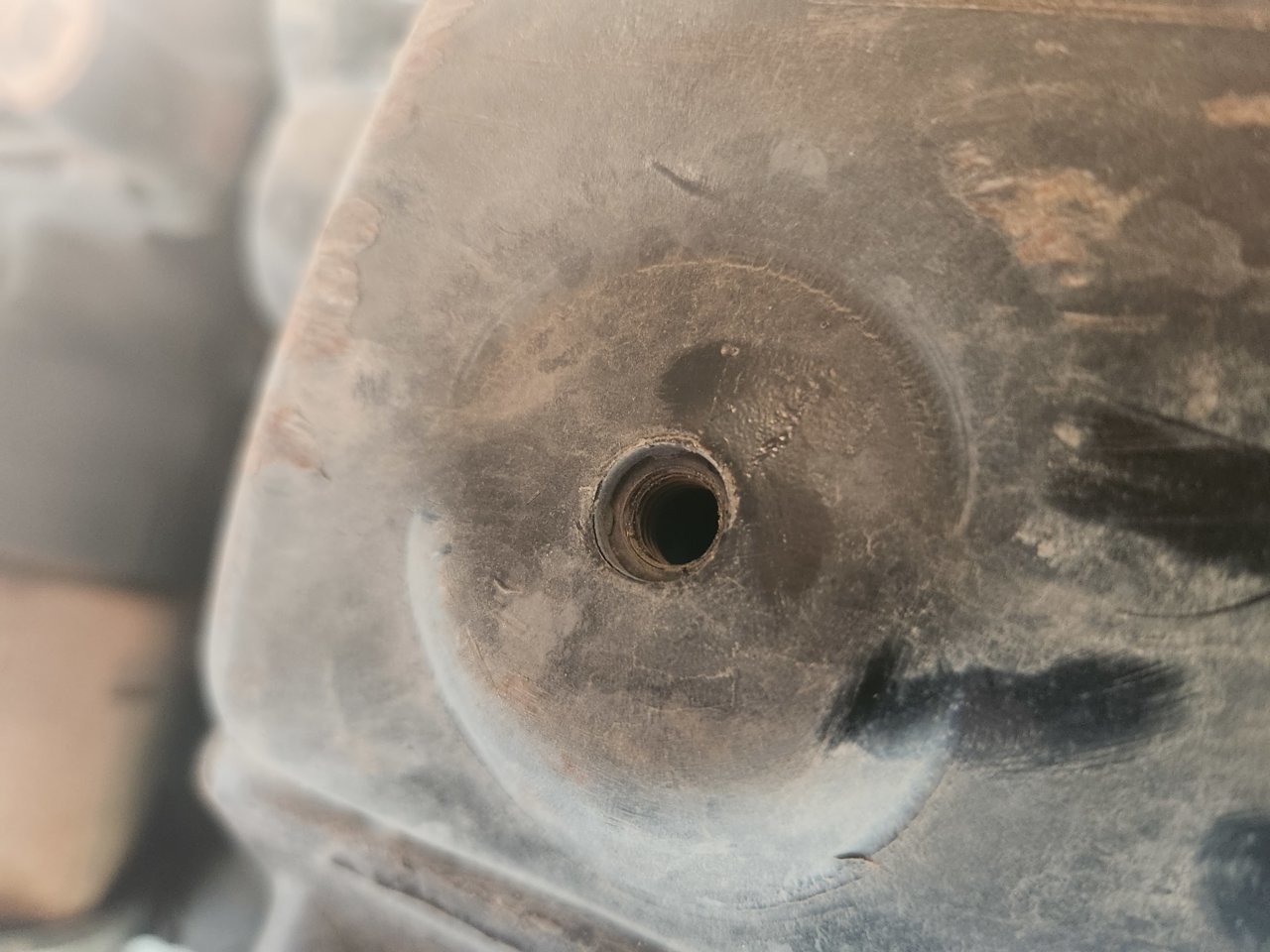

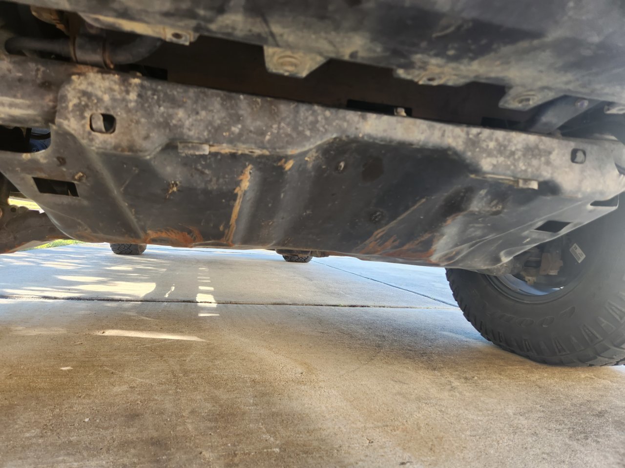

    Recently picked up a Gas tank skid on marketplace,
    Had to swap out the studless straps.
    new straps installed..
    the guy I bought the skid plate from upgraded to a Long range Tank, so the skid no longer fit. as part of the deal he ended up throwing in the OEM tank at no extra cost. so it ended up being a really good deal on the skid plate.

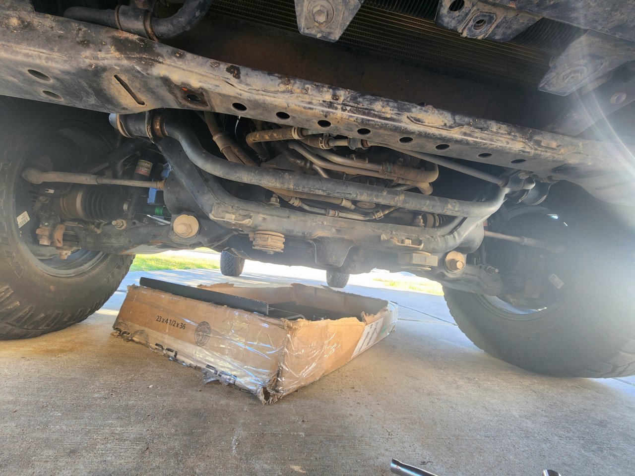

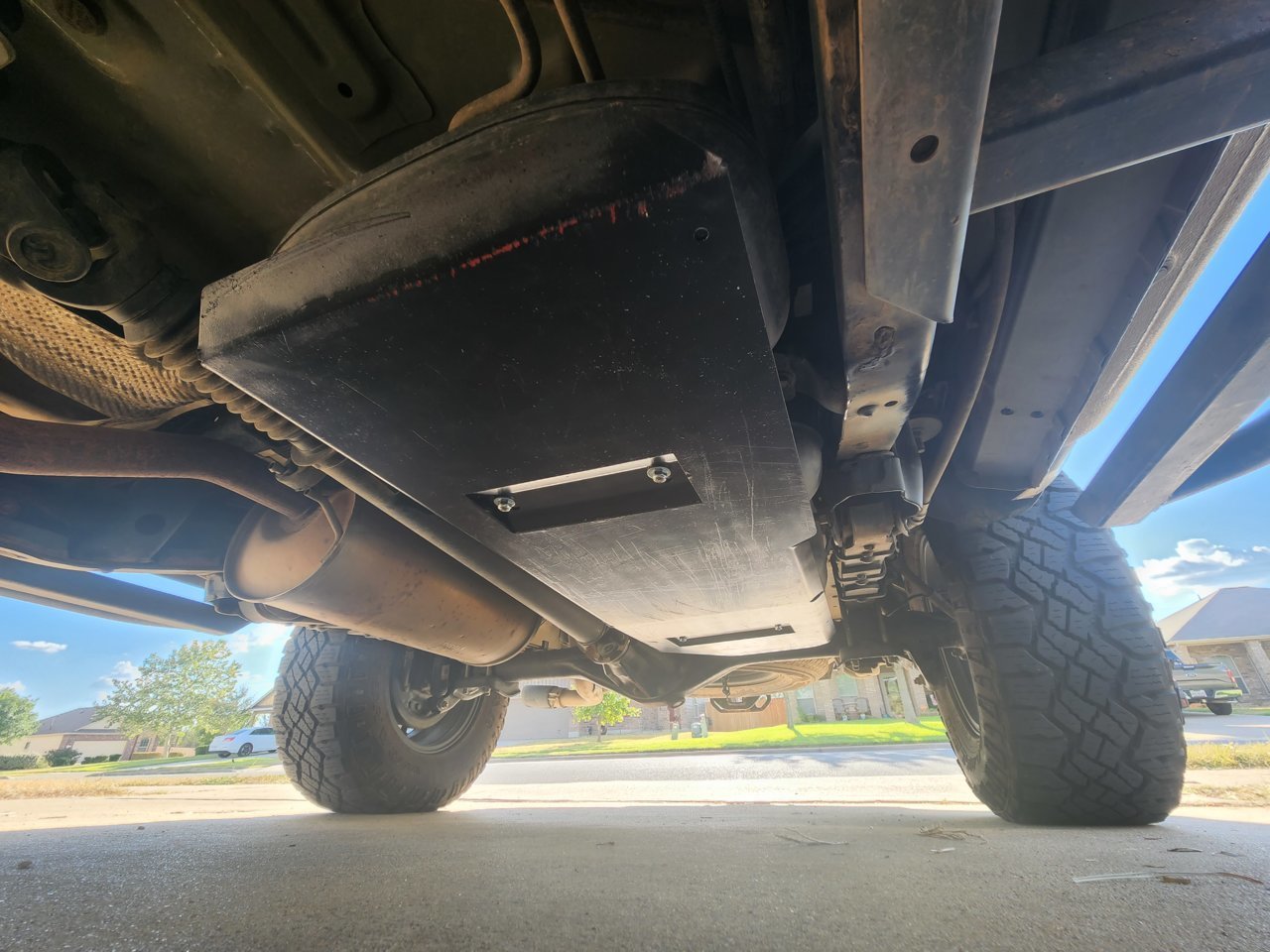

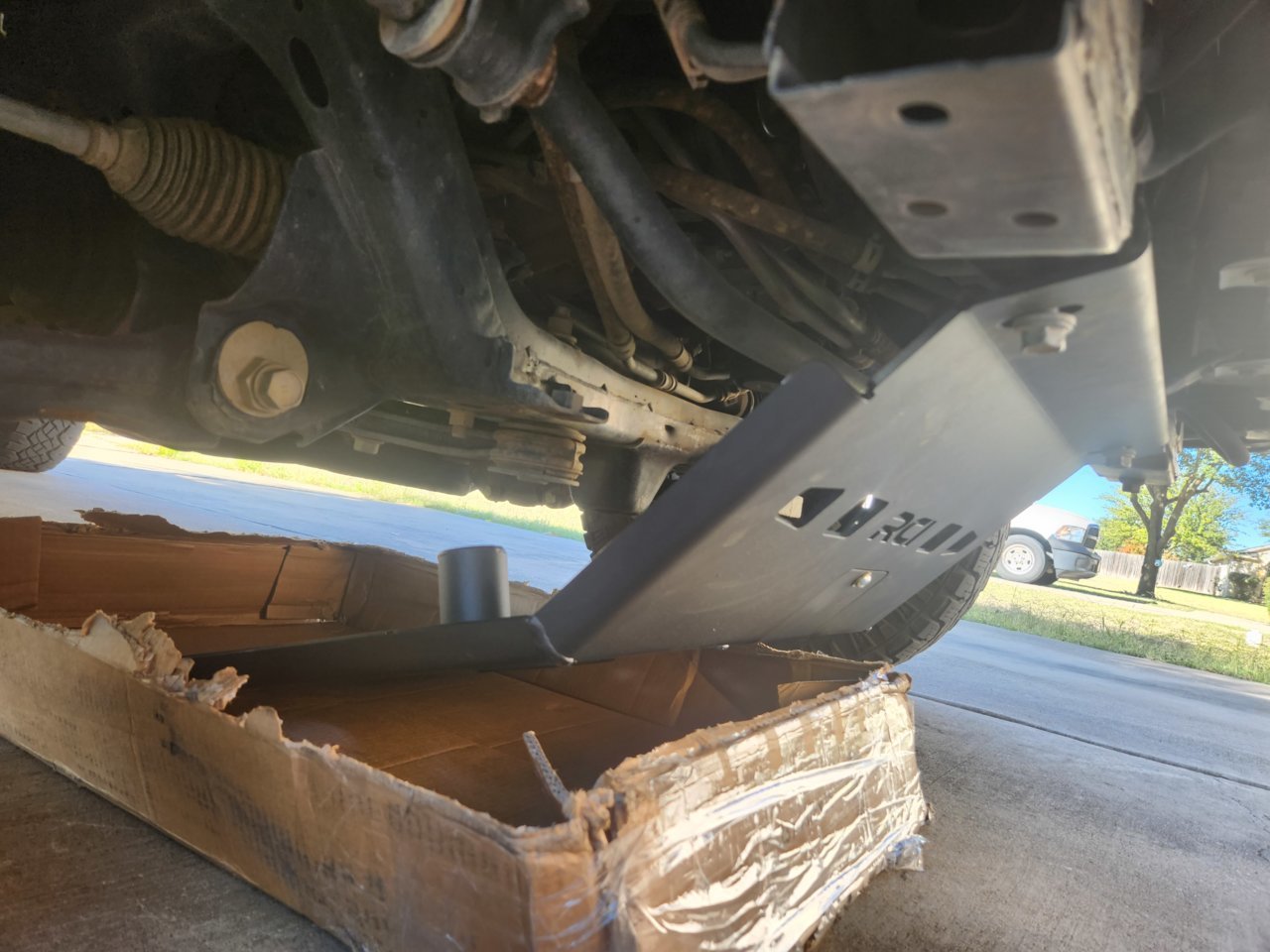

    TWSS sent me an amazing gift this year.
    I took advantage of the first nice sunny day we have had in a couple weeks and got this installed in about 45 min.
    First up, off with the old OEM plate
    Next the factory mounting brackets
    The shipping box was used to protect the new skid plate as it was slid into place.
    The OEM bolts from the brackets where reused for the front two bolts. they where installed first to take the weight of the front
    Next the rear two bolts installed using the supplied hardware. this is the threaded hole on the outer edge of the crossmember, they may need to be cleaned out to ensure the bolts run in cleanly.
    After the rear two bolts are installed loosely then the center 2 bolts are installed using the OEM hardware from the factory brackets. everything was torqued to 30ft lbs.

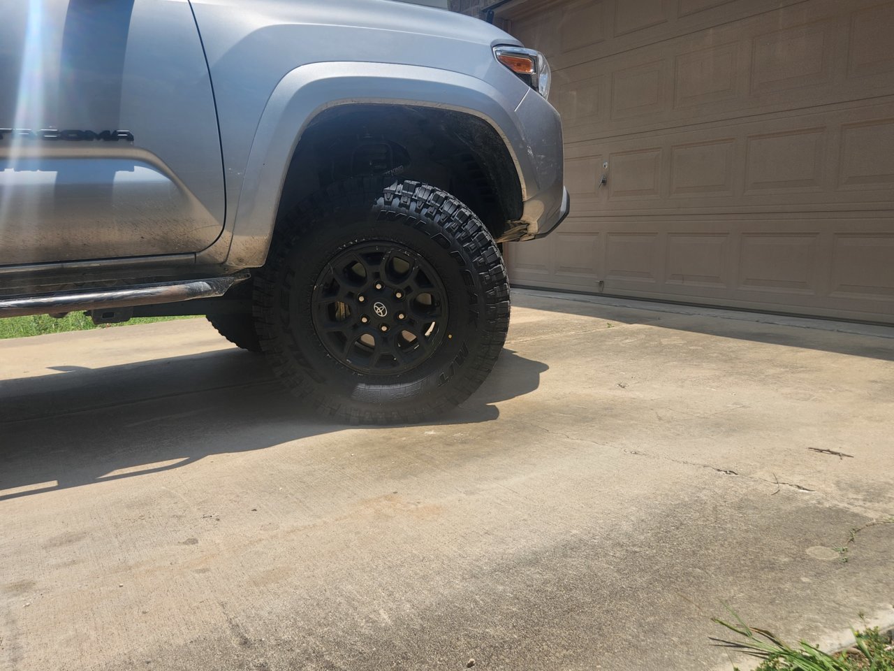

    New tires...
