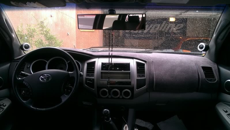

    Beautiful selection of products. Are thinking about relocating the tweeters?

    Yeah, I already bought an extra set of sails/mirror trim panels to move them up there. I also have some Alpine Type X (vifa) ring radiators, a set of LPG NFA25 tweeters, and a set of the Morel made Xtant tweeters to play with if needed. so I may change later, but wont mess with sails until I am certain of the setup.

    Cool. I moved my tweeters to pillars and im never looking back.

    I have already had a break in, and I am worried about another (at work, middle of the day - Cameras + patrolling security, with witnesses driving by). I have a hard time moving to anything showing audio - I have had tweets up there in other vehicles, and know the limitations, but its really down to "live with the limitations, keep the gear", or "best sound, paranoid".
