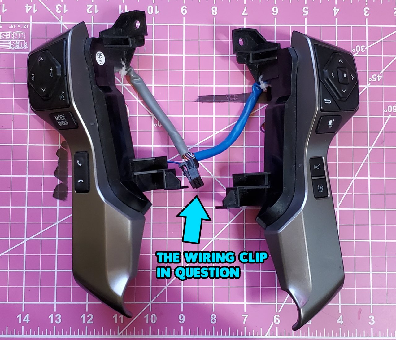

    REMAPPING STEERING MEDIA CONTROLS (PART 1)
    Instead of taking "What Have You Done To Your 3rd Gen Today?" further off track with more posts about this, I'm moving anything that isn't the finished result into the build thread where it belongs.
    In true "me" style, this project is moving ahead based on the assumption these controls showed up in working order.
    Can't wait see how this project turns out... :rolleyes:

    There is a stray blue wire for whatever reason, but it doesn't bother me since this harness isn't the one being installed.
    Disassembly

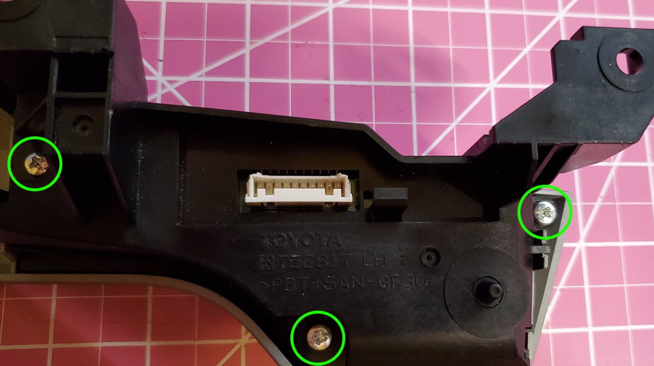

    This parts pretty easy. There are three phillips head screws that you need to remove and the back cover pops right off. I also opted to snip the zip tie and fully remove the wiring harness from the back side.
    So... what's in there?
    The number of wires in the harness it gave me hope there was one wire per button, and this would be as easy flipping a few wires on the harness that plugged into the controls.
    But life, much like the internals on this control set, isn't simple like that. Things don't look too bad, though.
    Shot of the circuit board with the button leads traced:
    • BLUE: volume down
    • YELLOW: volume up
    • GREEN: seek backward
    • MAGENTA: seek forward
    Detail shot of the area where the leads punch through:
    It looks like the button leads all follow a nice simple path and then punch through to the other side of the board. On the back side of the board where the leads come through they attach to a shared lead, with resistors between them.

    Ambitious. It's not possible to attempt to rotate the 4 way button using jumpers from there to the board?

    I think we're talking about the same thing?
    The request for the PC shop was going to be whatever the technically competent version of this was:
    Edit: or are you referring to the button side? I was worried about anything on that side interfering with the rubber mat the buttons are on.

    Yeah, I was mostly thinking that extending the button with jumpers to the board and rotating it could be the minimally invasive approach.
    What you're going to get is buttons which say one thing but do another, granted it's more in line with what someone might expect from other vehicles but still it'll be non-intuitive.
    I believe others have looked into rotation of this guy and it's a no go but a closer breakdown of photos might help me understand why/how that's trouble.
    The board itself looks manageable.
    BudFriendguy[OP] likes this.

    Unfortunately the button face is asymmetrical and can't just be rotated. I haven't been motivated yet to break it down further due to a seemingly hidden clip within the button itself.
    If it gets bothersome enough maybe I would strip the button and spray it plain black, then take to a local maker shop to laser etch new icons. But that's a few more steps down the road... first is get the rotation work done without frying anything.

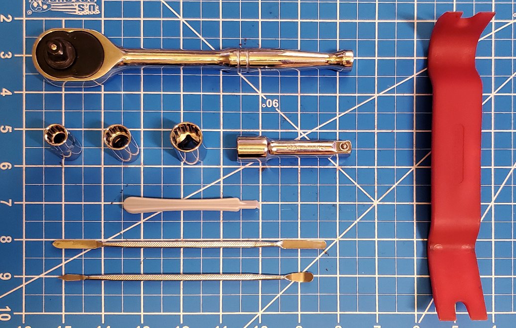

    STEP 0 - Suggested Tools
    Tools
    • Socket wrench + extension
    • 10mm socket
    • 12mm socket
    • 14mm socket
    • Interior trim removal kit
    • Supplemental trim removal/pry tool(s)

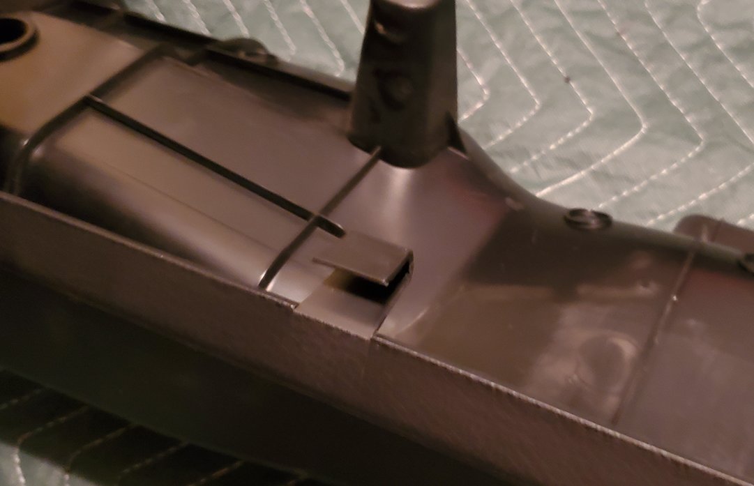

    STEP 1 - Removing trim caps obstructing bolts n' sitch

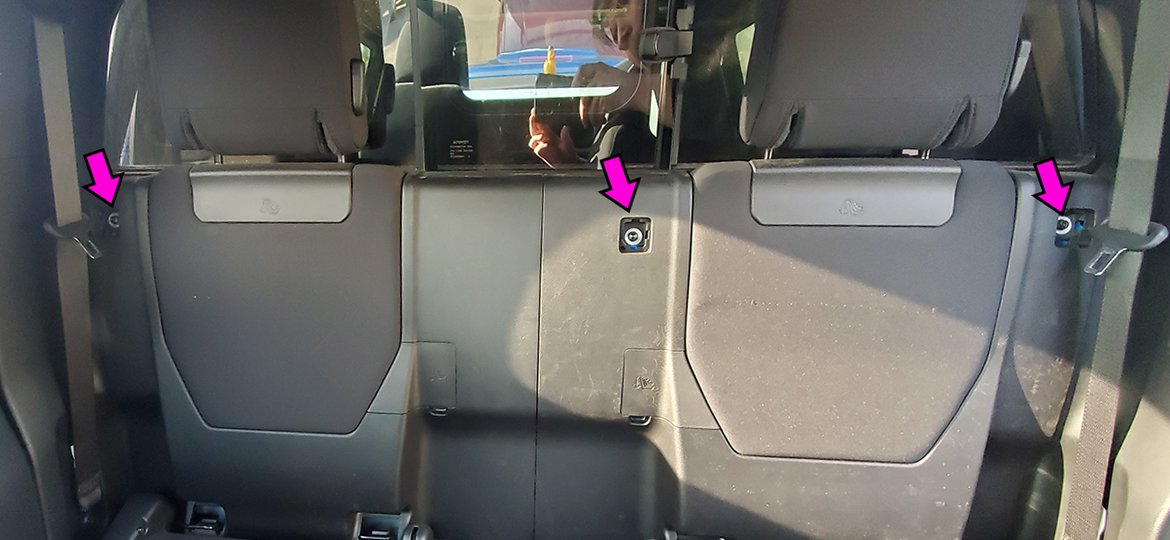

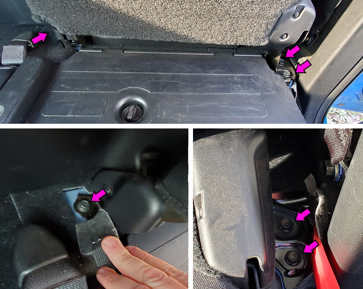

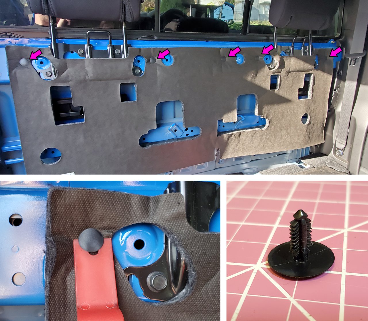

    There are nine trim caps either covering bolts, or preventing removal of trim panels. Every cap has a very tight tolerance and the usual plastic trim removal tools were too blunt to get in there without marring everything. This is where the "supplemental" trim removal tools come in; I used pries and spudgers from a small electronics tool kit.

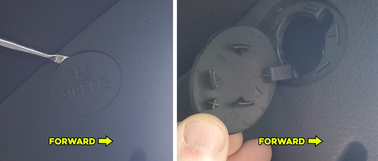

    Start with the "SRS Airbag" cover on the rear pillar trim near the headliner, there is one on each side of the cab. The rear side of this cap is semi-permanently attached to the trim panel it plugs into, you can avoid snapping its clips by prying along the front edge to ease the piece out.

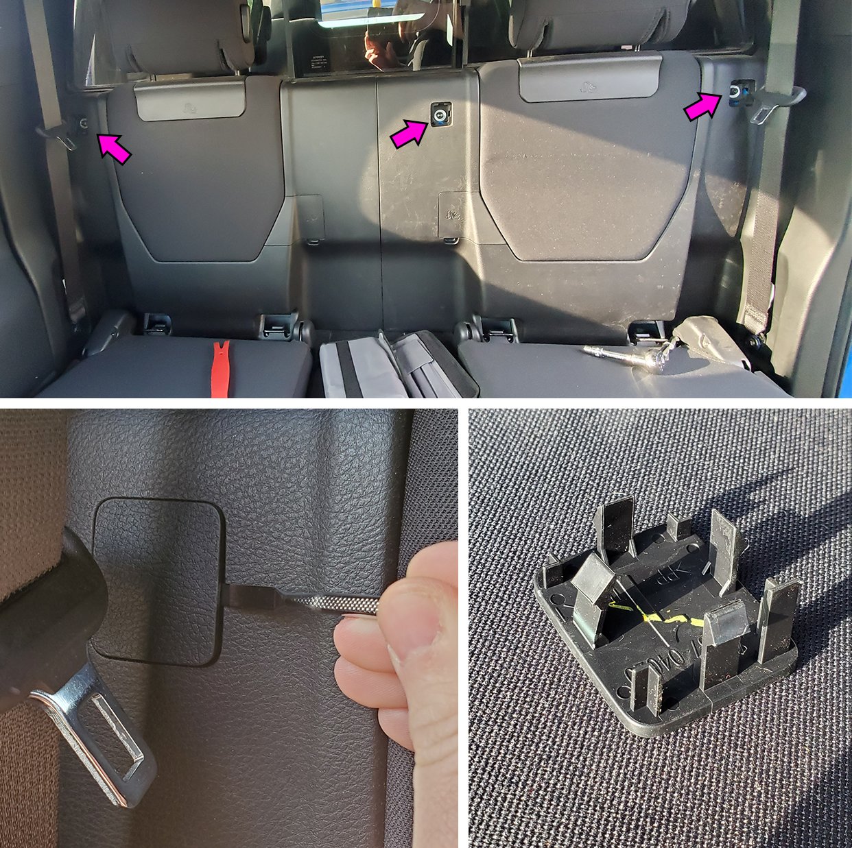

    There are three trim caps along the top of the rear seat back panel covering bolts that need removed.

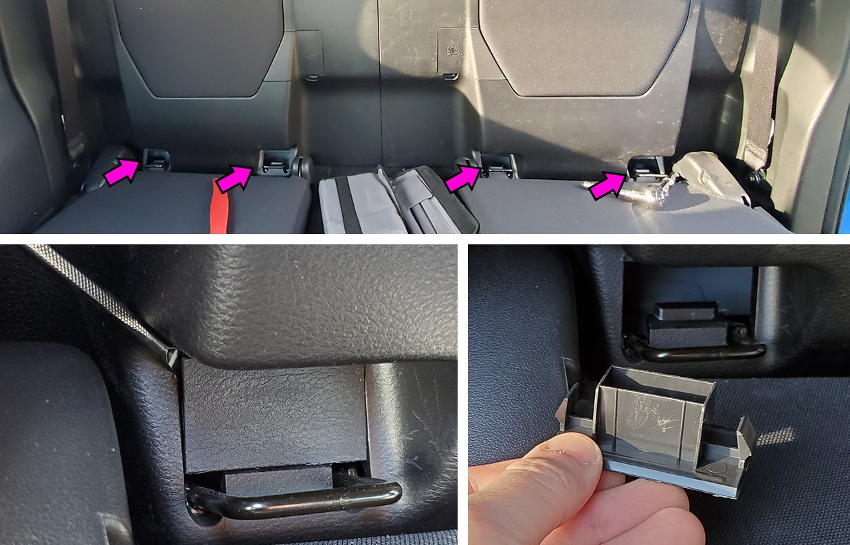

    The last four trim caps cover the fold down seat hinges and need removed so the rear panel can be uninstalled. These were a little tricky to get out, but working from the top corner of the cap it wasn't too hard to sneak a pry tool in there for some leverage.
    STEP 2 - Removing the fold down seat bottoms
    Both seat bottoms are a single assembly containing the handle/hinge mechanism as well as the padded seat bottom. Each seat is held in place using three 12mm bolts, which are covered by a small carpet flap that can be peeled back to expose the bolt heads.

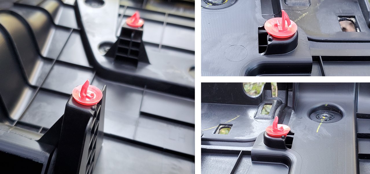

    STEP 3 - Removing the seatback trim panel
    The rear seatback trim panel has a vertical line running down the middle. "This panel" is actually "these panels"... they split into two half-panels.
    There are three 12mm bolts (un-capped in STEP 1) that run across the rear seatback trim panel.
    Now it's time to pop out the rear seatback trim panel. I started by hand on the passenger side then used a hooked pry tool along the top edge toward the driver side and just pulled until the panel(s) came loose.
    Maybe it's possible to yank the panels off without breaking any clips, but a few weeks ago Robby Layton put out a video and in it he mentioned how "all disposable clips are single use." Since then I've decided he's right and breaking (DISPOSABLE) clips is just the cost of doing business.
    The last step here is to remove the insulation/sound dampening pad, which is held in place by five small plastic clips. These all came out without any damage using a two pronged pry tool.

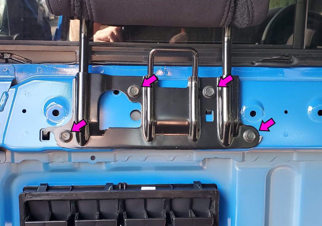

    STEP 4 - Removing the rear headrests
    Both headrests are identical, and are each secured using four 12mm bolts.

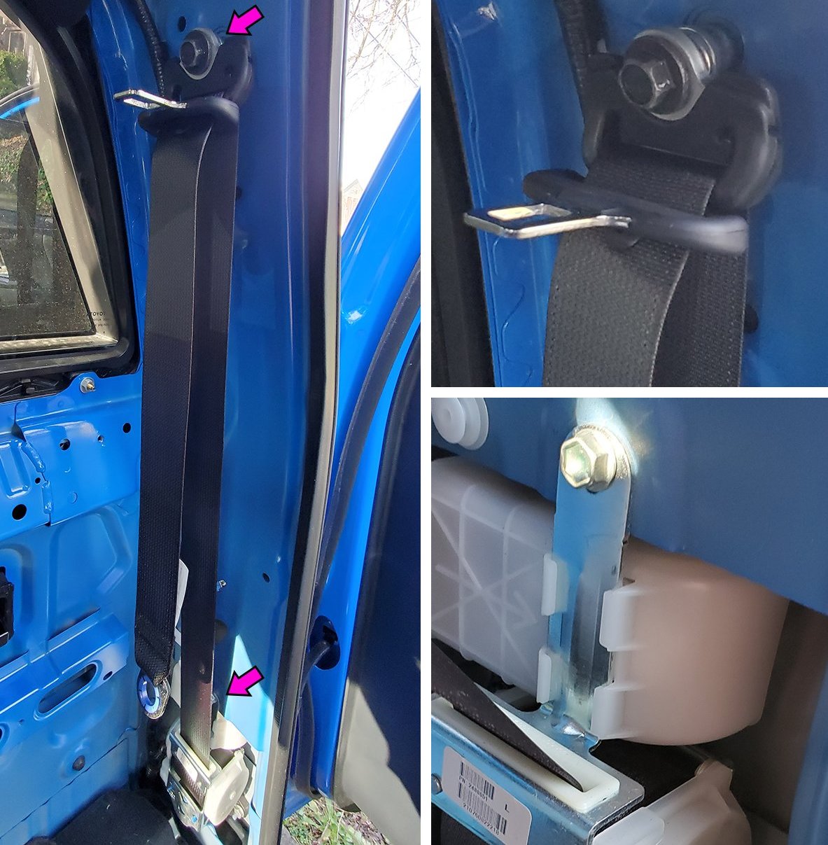

    STEP 5 - Removing the rear seatbelts

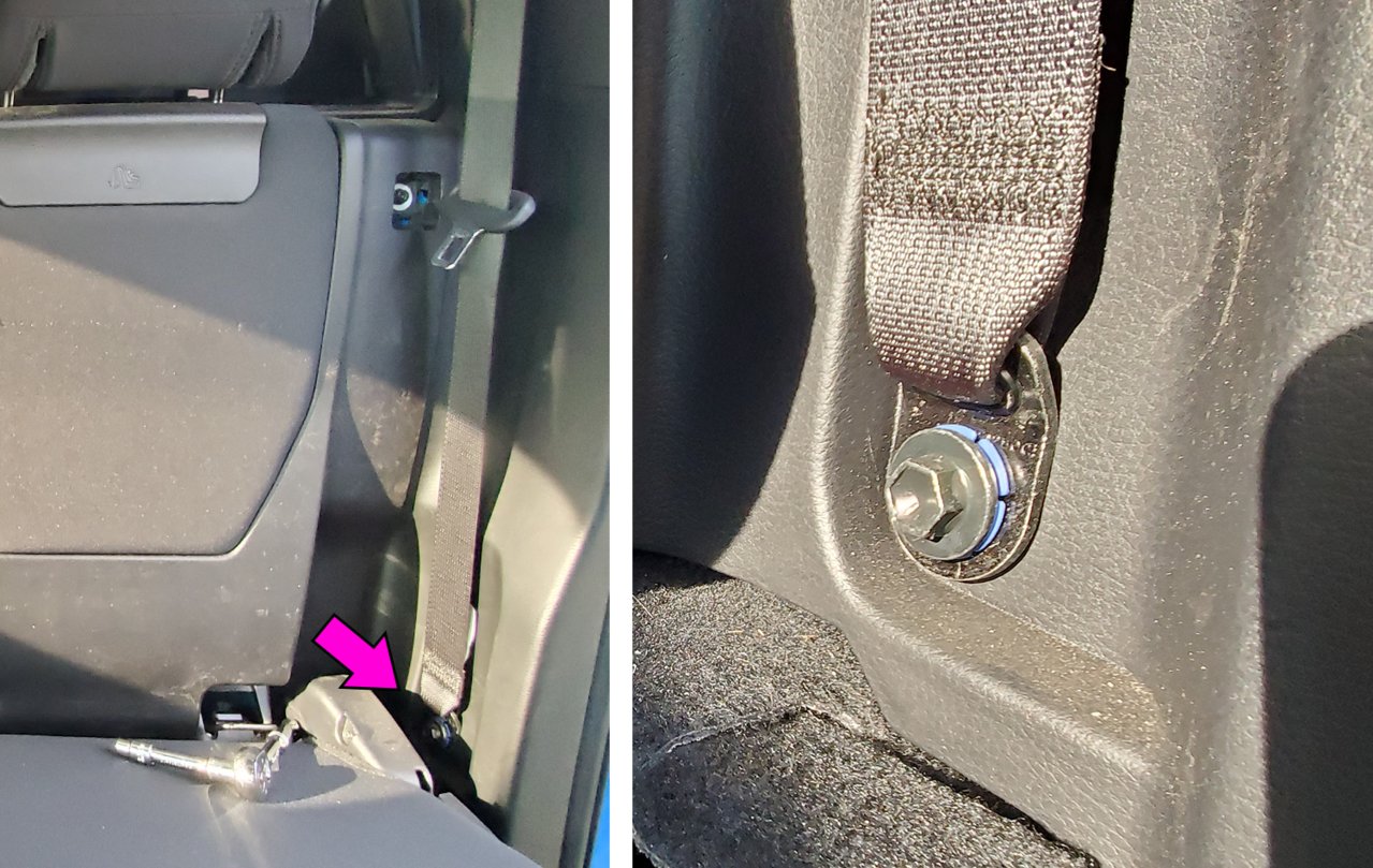

    Remove the 14mm bolt attaching the seatbelt to the lower rear quarter trim panel.

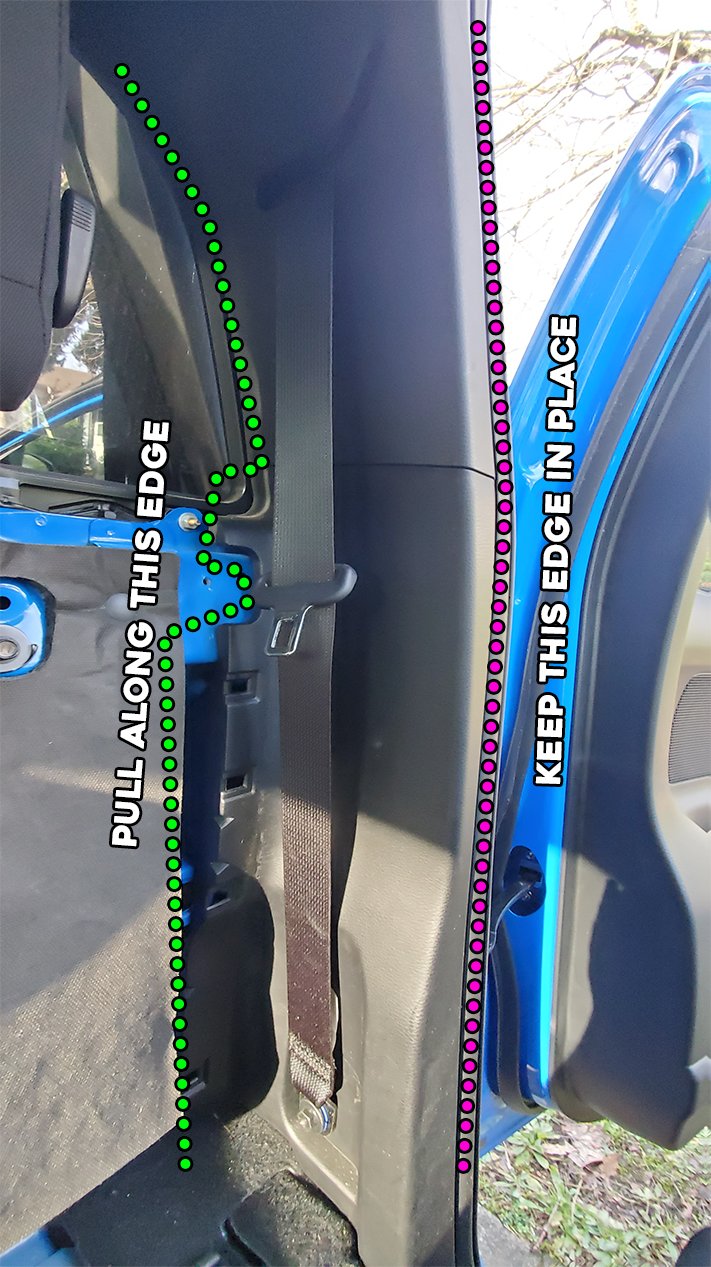

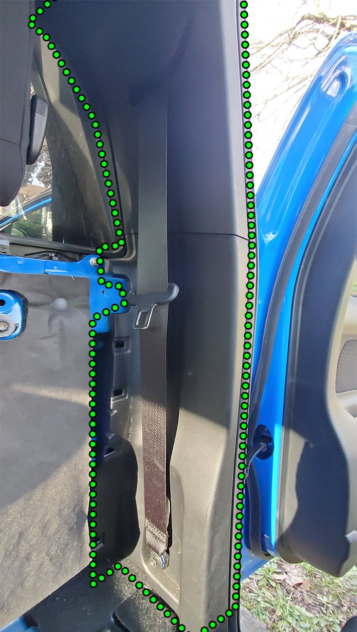

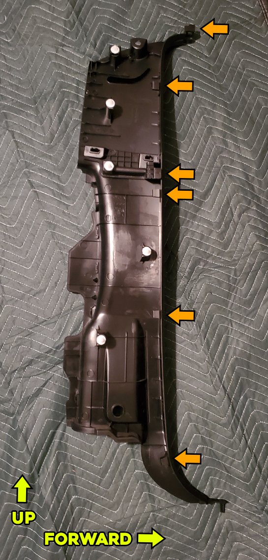

    Remove the upper and lower quarter trim panels (outlined in green below.) This is one of the trickiest pieces to remove without fucking up lots of shitty little clips, so take care and don't go all Hulk yanking on it.
    There is an upper and lower door trim piece clipped onto the one being removed, so start by prying the upper/lower trim a bit to help finesse the quarter panel clips out.
    After the ends of the upper and lower panels are pried up, and the clips are released, un-tuck the edge of the trim from the headliner/carpet.
    Once the headliner and carpet are free, pull on the back edge (marked in green) of the rear quarter panels, pulling toward the middle of the cab in order to release the replaceable trim clips.
    DO NOT keep pulling if it feels like only the front edge (marked in pink) is still clipped; the panels have a J shaped front clip that wraps around the weather seal and other trim pieces.
    Here is some detail on the back side of the panels being removed. The disposable clips (white ones below) need pulled inward before the J shaped clips (marked in orange) can move toward the back.
    Once the panels are loose, push them toward the back of the cab and the J shaped clips will free up; feed the un-bolted seatbelt end through the trim pieces in order to fully remove them.

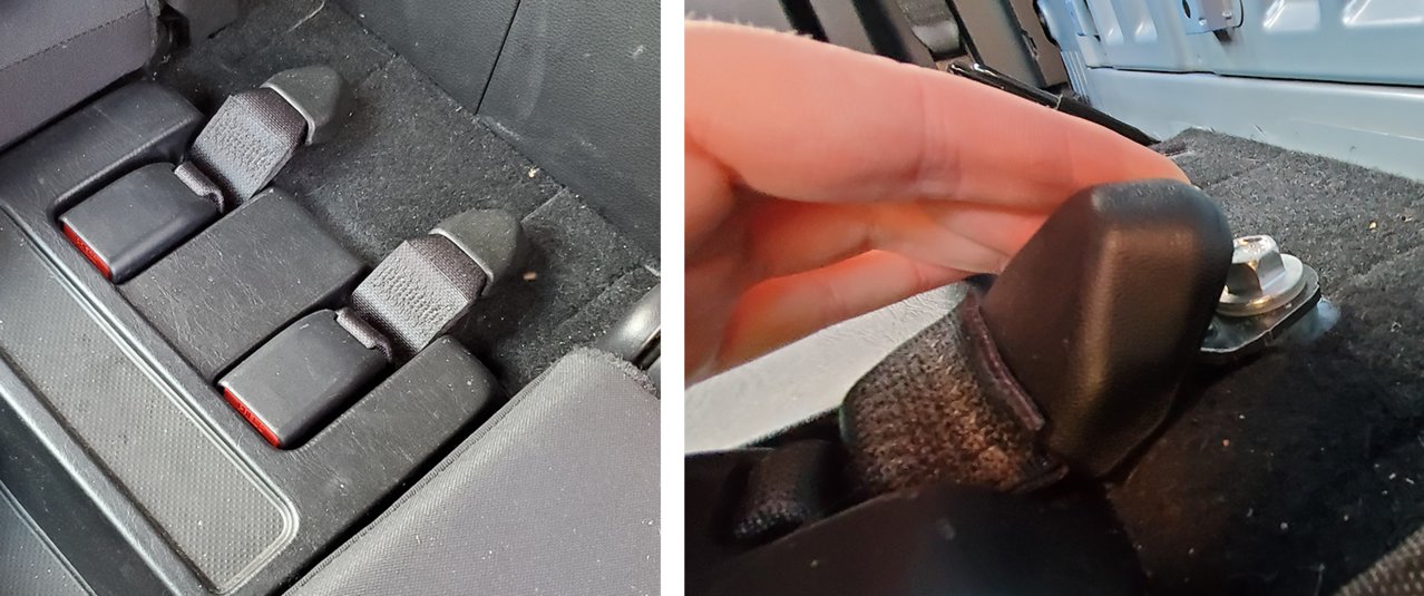

    The seatbelts are almost out. There is one more 14mm bolt securing the seatbelt near the headliner, and a final 10mm bolt holding the belt assembly in place near the floor. Once the 10mm bolt is removed the whole belt assembly slides out.
    The seatbelt buckles are directly behind the rear center console and are each held in place with a 14mm bolt.
    Repeat STEP 5 on the other side of the cab.

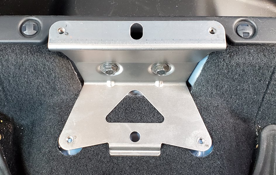

    STEP 6 - Remove the rear center console
    The rear center console is held in place by six bolts; four 10mm bolts on the top covered by rubber inserts, and two 12mm bolts holding a small metal bracket in place.
    Remove the rubber inserts from the top of the console to expose the bolts.
    Once the bolts are out the center console should lift up easy, and reveal a small metal bracket. The bracket is held in place with two 12mm bolts.

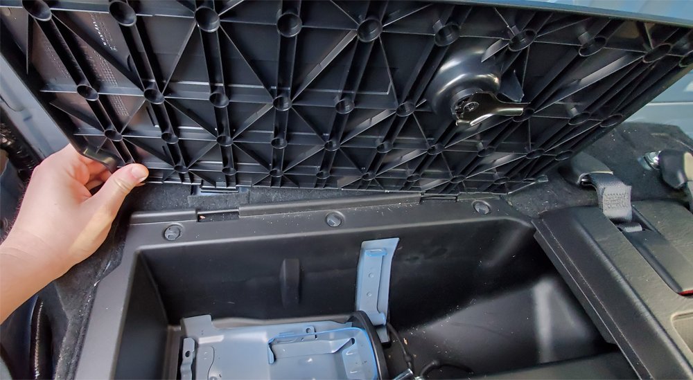

    STEP 7 - Remove the cargo box lids
    With the center console removed the original lids don't fit; there is a ~10" gap in the middle where the console used to be, so they're getting replaced.
    Removing the lids is easier than typing this sentence. Open it to about 90deg and push the bottom edge of the lid toward the back of the cab.

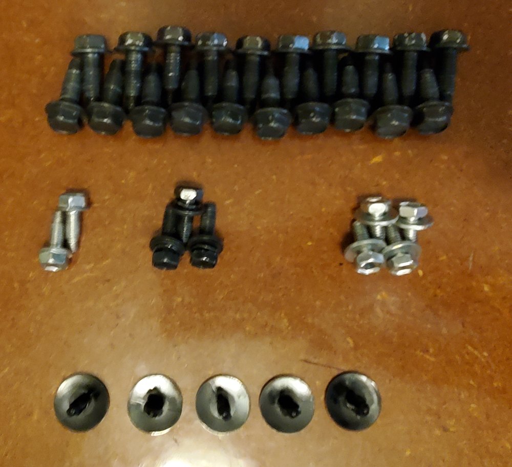

    STEP 9 - Take inventory
    A lot of stuff was removed here:
    • 64271-04120 - Back Panel Trim (Passenger)
    • 64270-04160 - Back Panel Trim (Driver)
    • 64141-04030 - Sound Absorber
    • 71940-04130 - Headrest, Rear (2x)
    • Part # unknown - Rear Seat Assembly (Passenger)
    • Part # unknown - Rear Seat Assembly (Driver)
    • 73705-04020 - Child Restraint Anchor Plate (2x)
    • 2488650 - Rear Seatbelt Retractor Assembly (Passenger)
    • 2488651 - Rear Seatbelt Retractor Assembly (Driver)
    • 64287-04020 - Cover, Room Partition (2x)
    • 64287-04030 - Cover, Room Partition
    • 64425-04020 - Back Panel Trim Plug (4x)
    • 64716-04020 - Cargo Cover (Passenger)
    • 64716-04010 - Cargo Cover (Driver)
    • 58912-04030 - Rear Console Assembly, Lower
    • Part # unknown - Rear Console Bracket
    Last but not least
    Even with all the right parts a non-factory jump seat install can be dangerous if bolts aren't fastened to spec. Even more so when it comes to safety equipment like seats and seatbelts.

    REMAPPING STEERING MEDIA CONTROLS (PART 3)
    This'll be a quick update. After a couple months of on-and-off searching, I actually found a supplier who produces the connectors necessary to fabricate a harness that could be used to hijack steering control outputs and pass them to an Arduino, which would in turn emit re-mapped outputs to the head unit.
    The man without a plan
    The harness shown below connects to the steering wheel behind the airbag assembly. Behind the airbag there is plenty of space to cram an Arduino Uno or similar device and hijack the outputs to meddle with them.
    But that's easier said than done. How exactly do you "hijack the media controls"??
    Sourcing parts
    The only problem is the female end of the harness clip above is meant to be soldered to a PCB and no manufacturers seemed to produce a female end intended for wires.
    KinKong Co. LTD to the rescue! After finding the male end on their website, I emailed their customer service who informed me there was no female end in their catalog besides the PCB-mounted variety... But a few days later they reached back out to inform me they did indeed have such a piece that was custom manufactured for another client, and it fit my needs exactly.
    Alright so it looks like after a couple hundred more dollars invested in a "maybe it'll work?" this project can move forward.
    The man with half a plan
    Assuming proper clips could be sourced, here's a rough estimation of how the Arduino would be wired up:
    With that harness produced, it's as "simple" as finding a power source for the Arduino Uno (5V if memory serves), and writing some custom logic to monitor for specific voltages related to the media controls in order to remap them to whatever voltage applies to the desired re-mapped control.
    Sounds easy... right?
    Next step(s)
    First, produce a harness that can be used to monitor the output voltages when specific controls are pressed and log them.
    Second, produce a harness that can connect to an Arduino and then connect the Arduino outputs back to the vehicle.
    Third, write some half-assed C code to monitor input voltages for those we logged, and output different voltages in order to re-map the controls. (This ALL assumes the truck cares about what voltage it receives, and does not monitor the actual resistance on the circuit...)
    Fourth, hook it up to the truck and fry the on-board computer.
