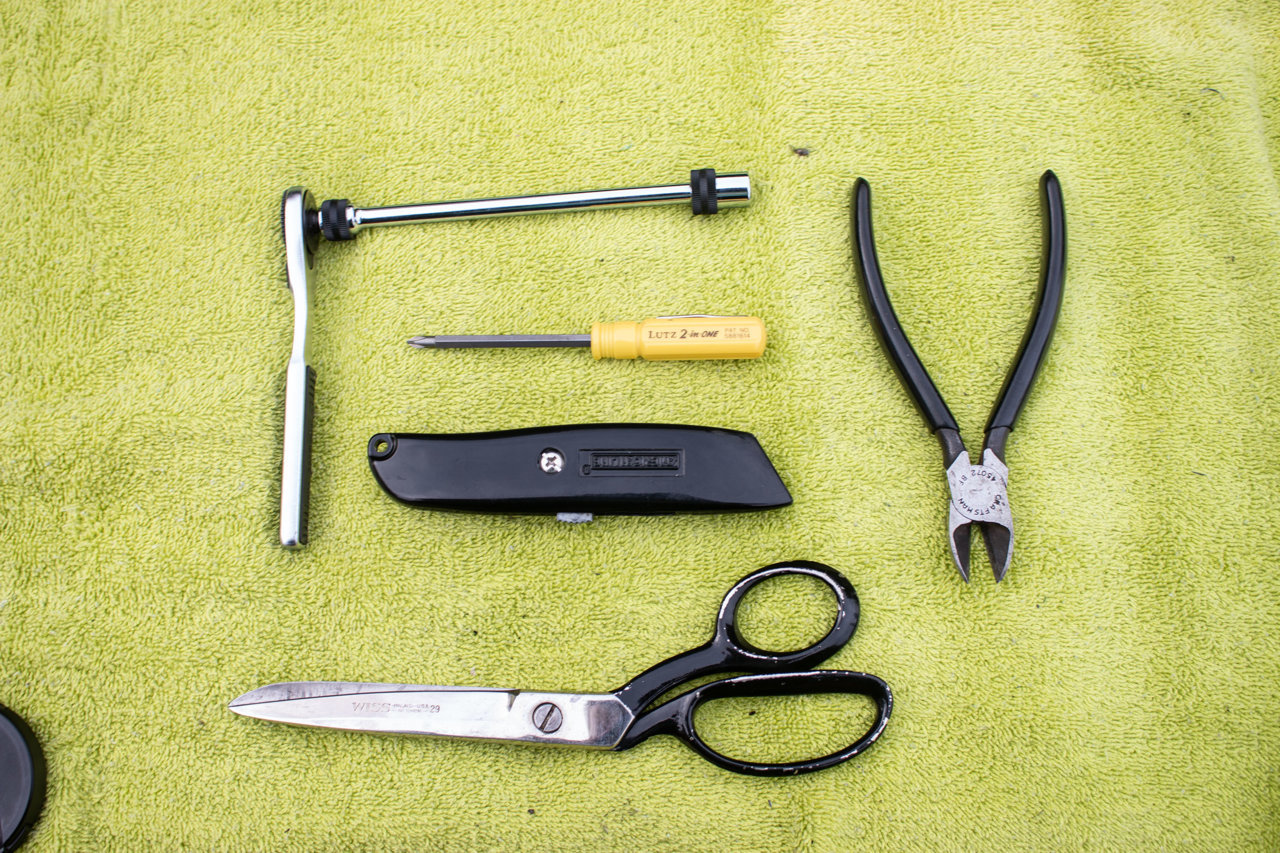

    STEP 0 - Suggested Parts & Tools
    Parts
    • MC Auto Parts Faux Pro grille
    • (2x) zip tie
    Tools
    • 10mm socket or wrench
    • Phillips head screwdriver
    • Flat head screwdriver
    • Scissors and/or utility knife
    • Diagonal pliers (if installing raptor lights)

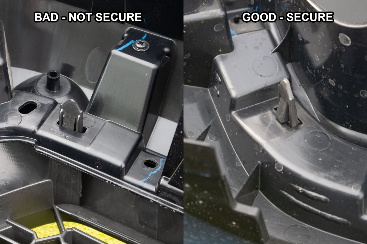

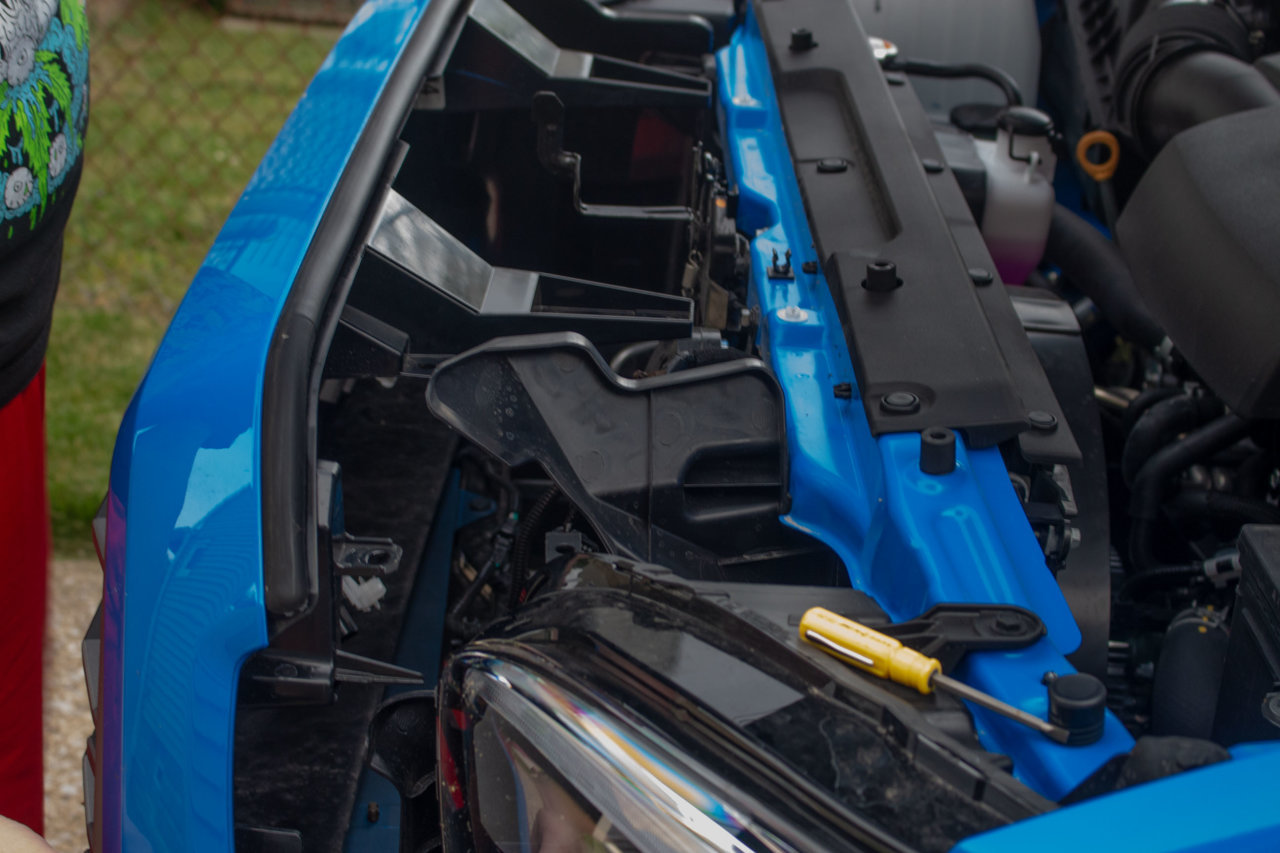

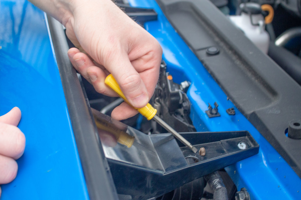

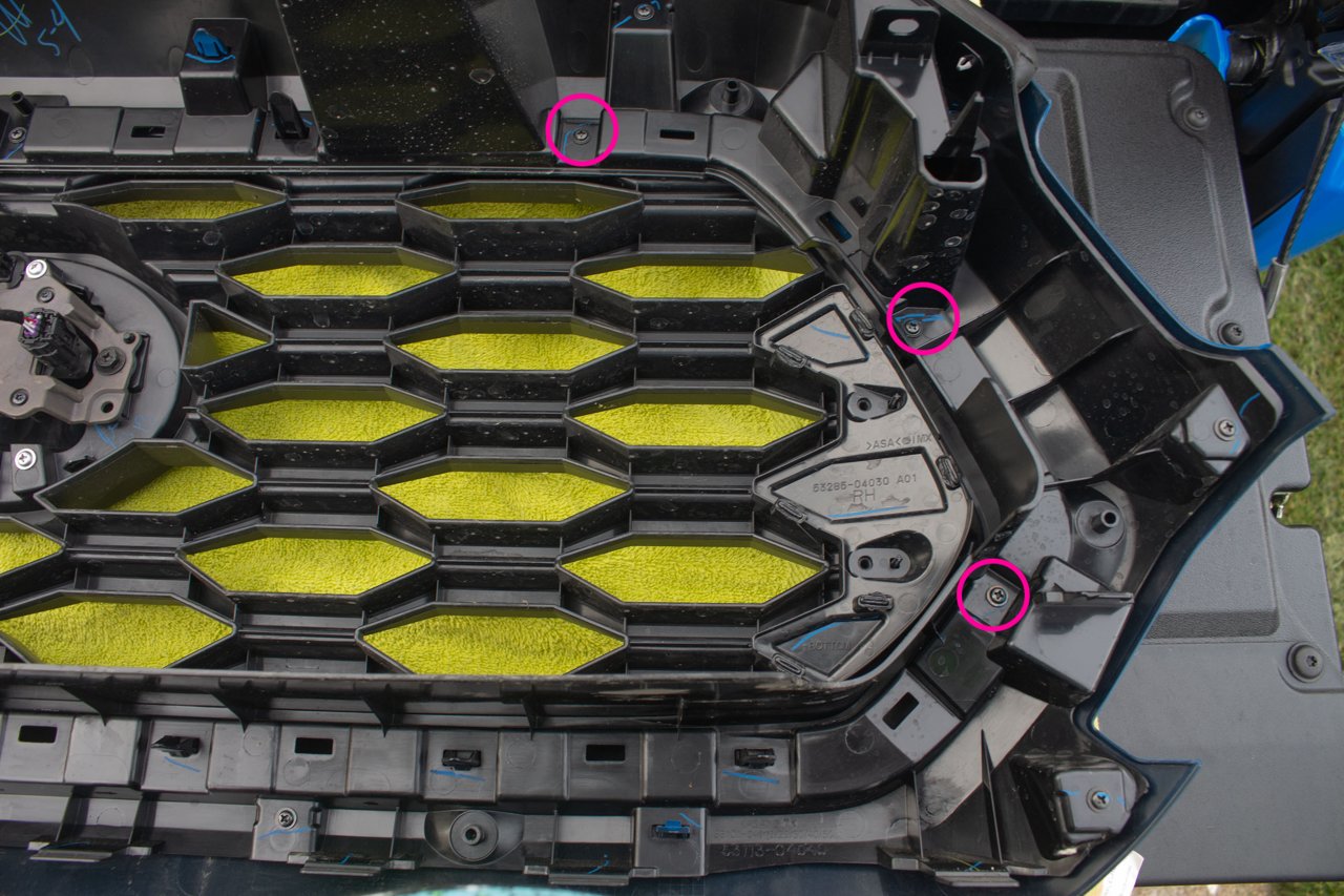

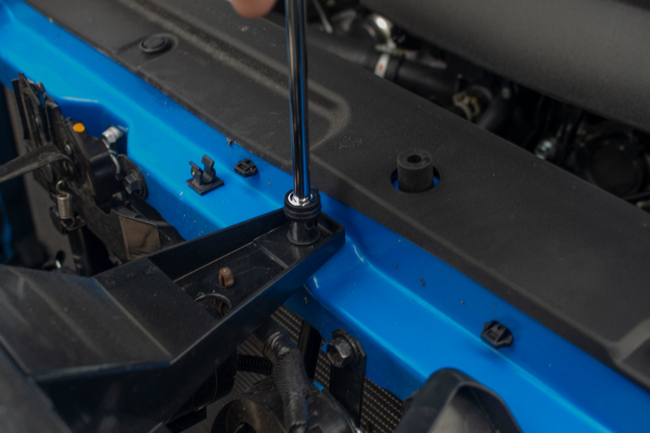

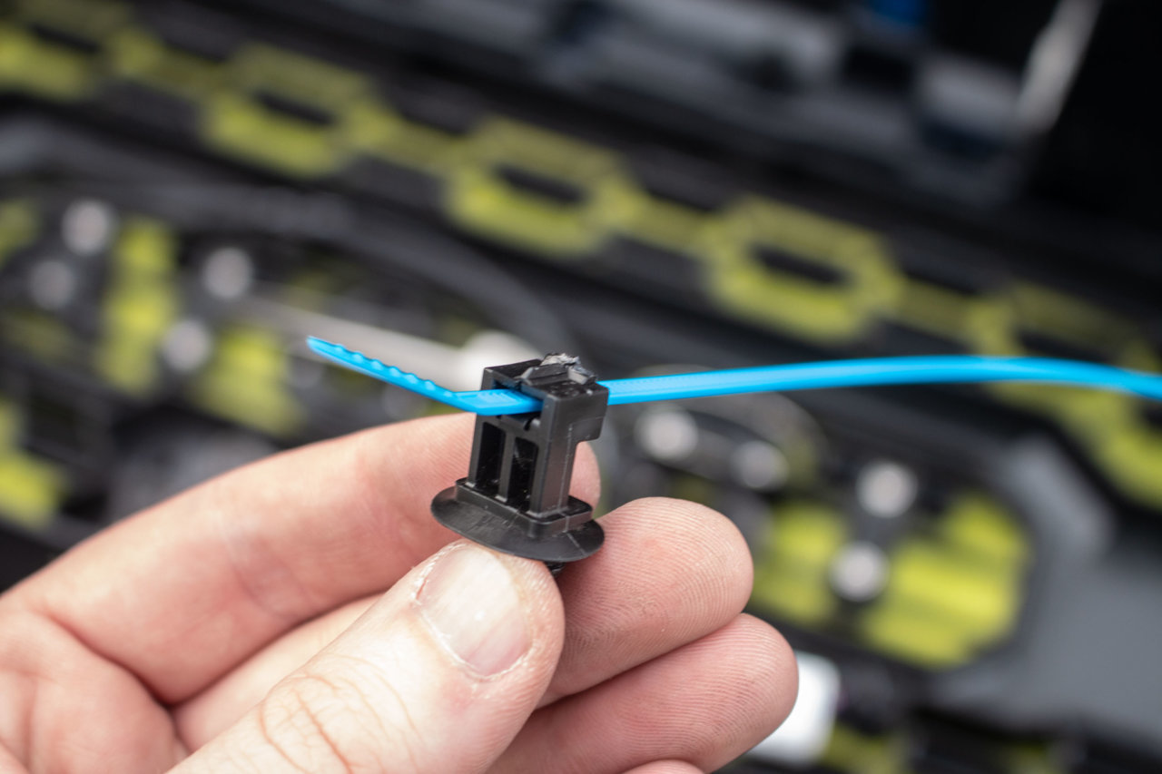

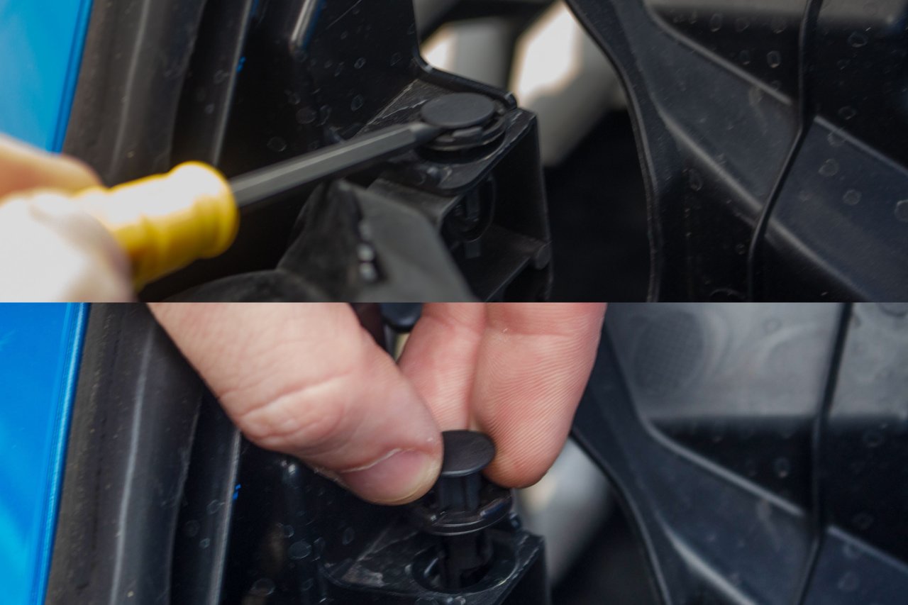

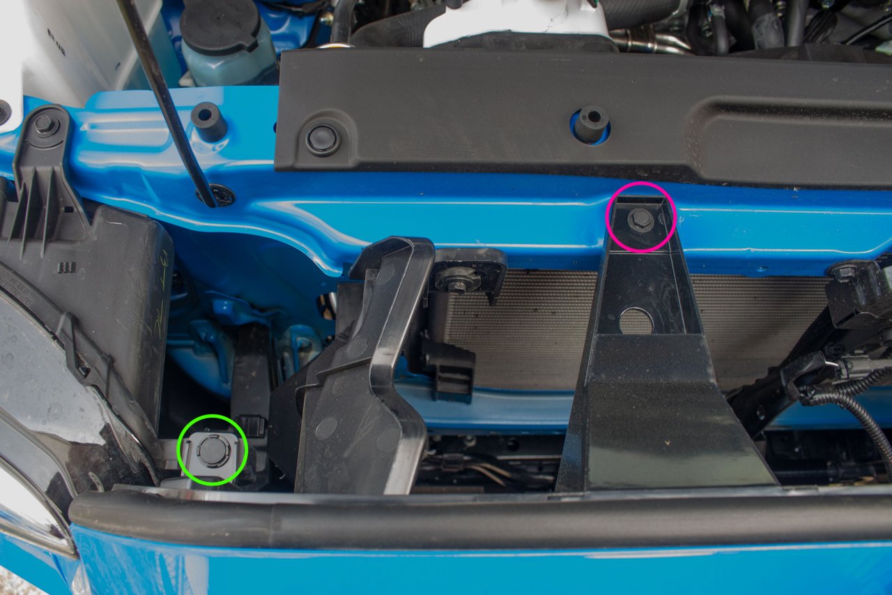

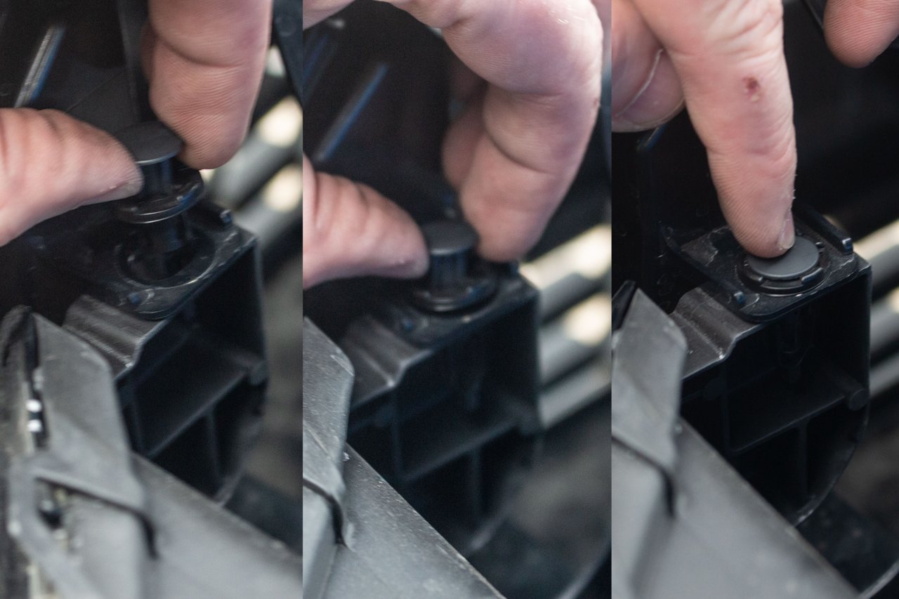

    STEP 1 - Remove bolts and plug clips
    Start by removing the (2x) plastic plug clips, and (2x) 10mm bolts that secure the grille assembly to the truck.
    • Shown in GREEN - plastic plug clip
    • Shown in PINK - 10mm bolt
    To remove plastic plug clips, use a flat head screwdriver to pry up the inner cap, then pull up on the cap to remove the clip from its housing.

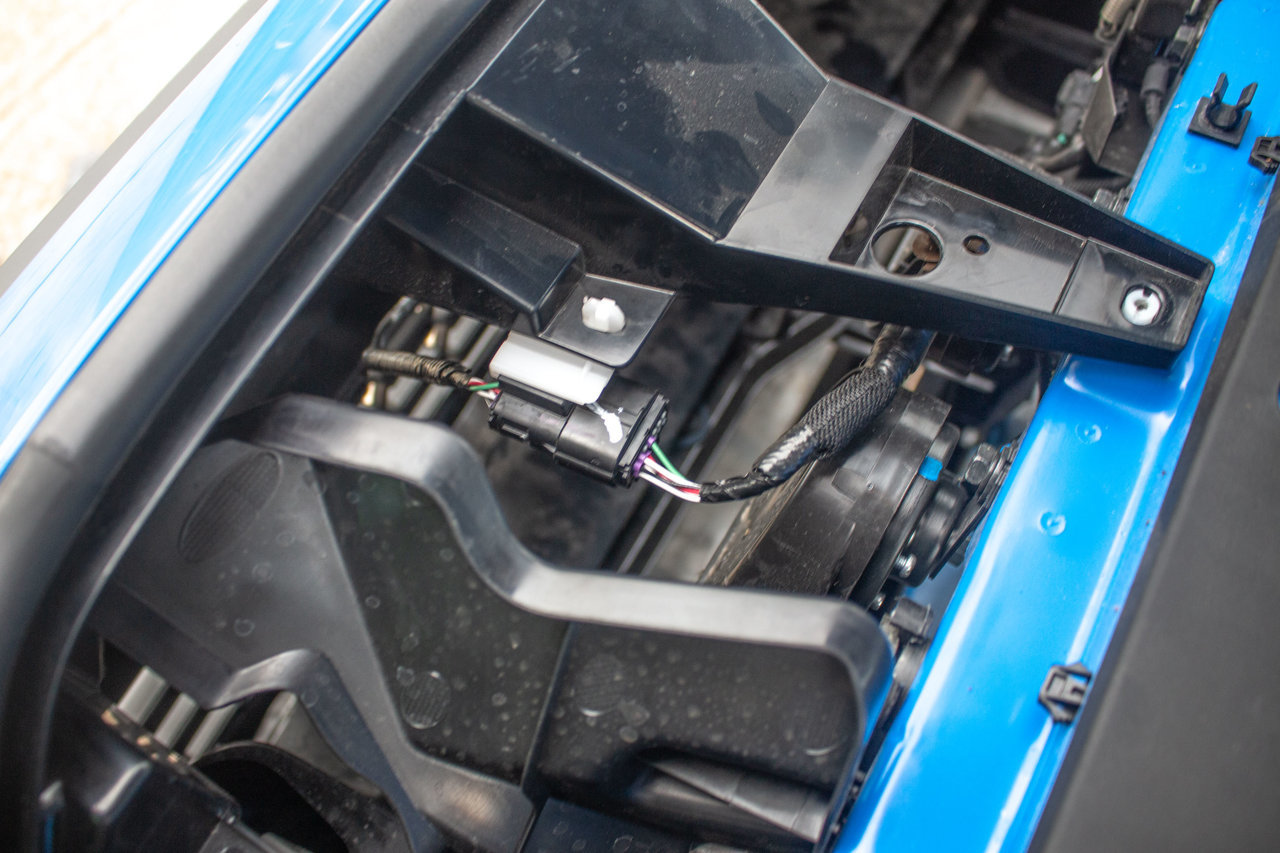

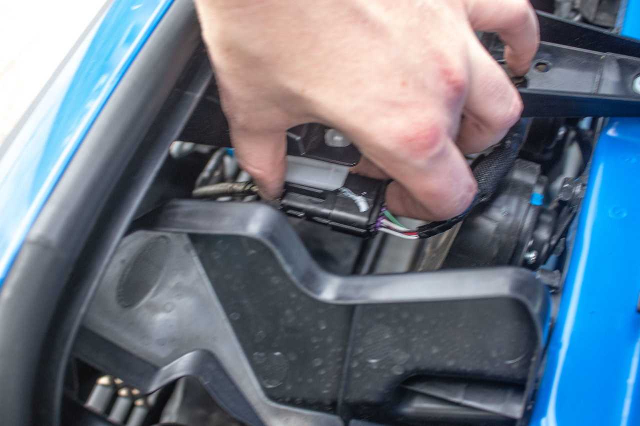

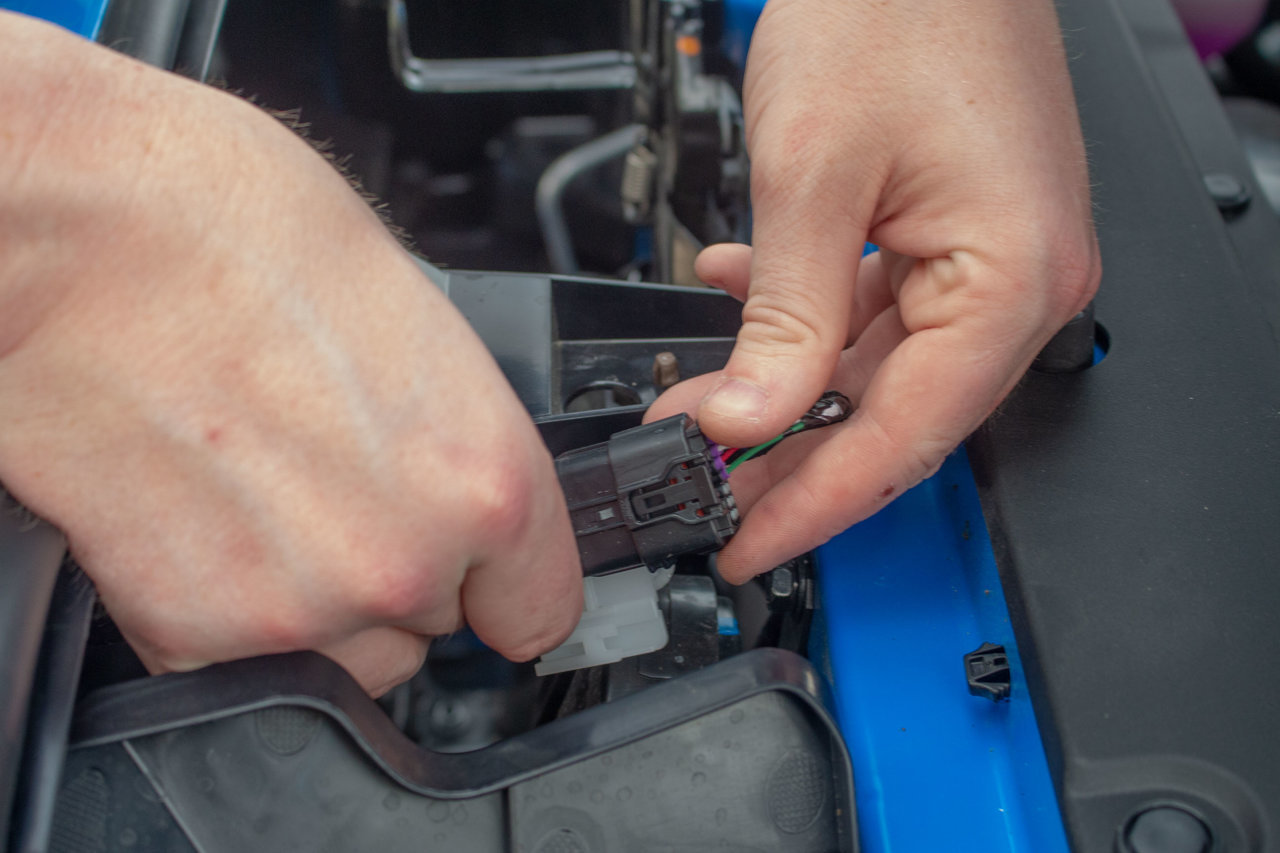

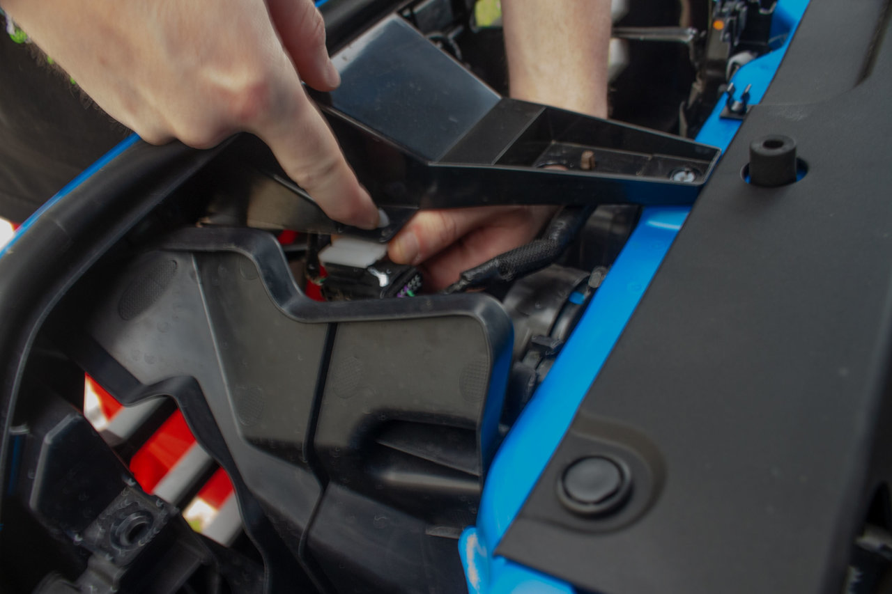

    STEP 2 - Disconnect the TSS wiring harness
    Start by removing the white harness clip from the top of the grille. To remove, pinch the exposed top of the clip to compress, and apply downward force, it should pop right out.
    This will make it easier to un-plug the harness connectors since they take a bit of pressure to release.
    Once the white clip is released, you will have easy access to un-plug the connection from the truck.

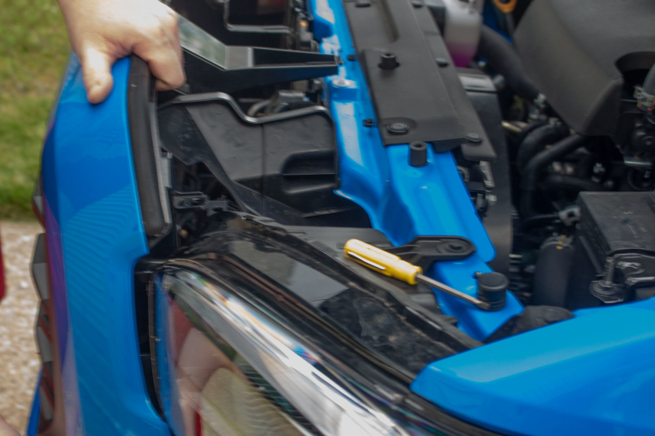

    STEP 3 - Remove the grille from the truck
    To remove the grille, apply slight upward pressure on the plastic arms that were unbolted during step 1, and pull toward the front of the truck until they move freely.
    Next, choose a side and start giving the ole wiggle-n-pull. This might take a bit of force, but don't go all Hulk on it if there is resistance, we're not here trying to break anything. If this is your first time removing the grille, it may take a bit of force. Just take your time, wiggling and pulling along the top and side until it finally gives.
    After one side is removed, the opposite side comes off much easier.
    Bam! Now your grille is off.

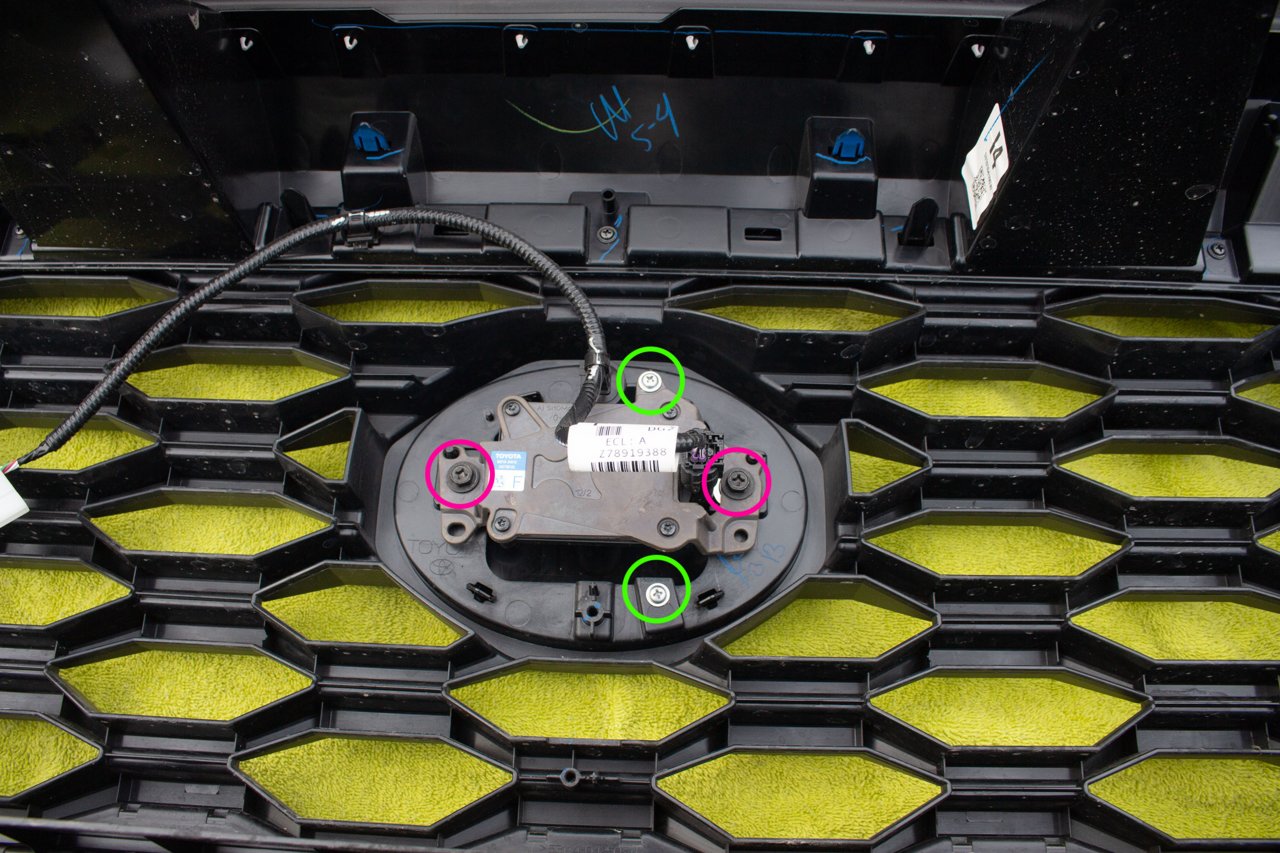

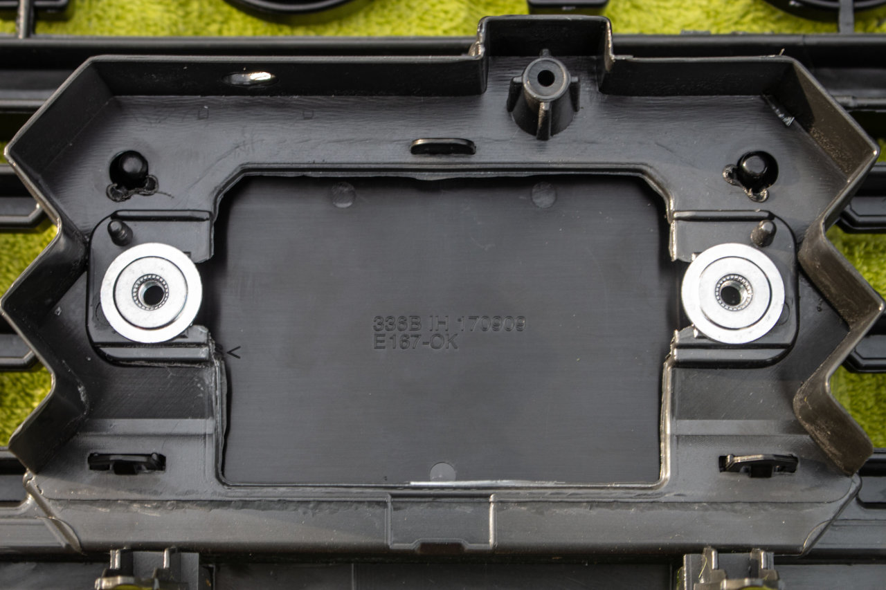

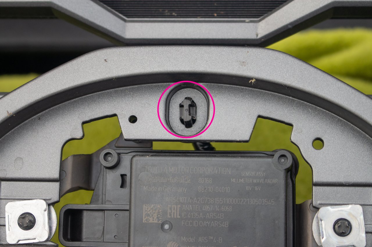

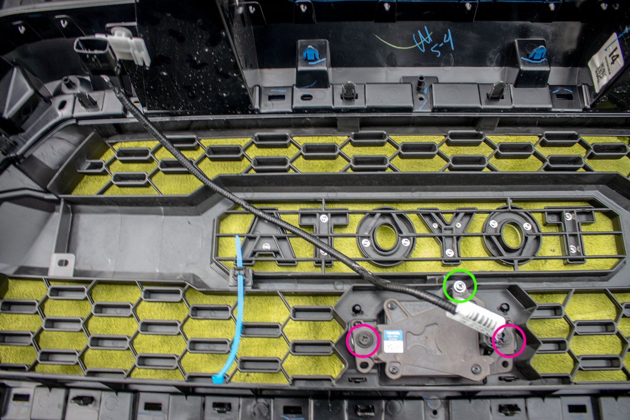

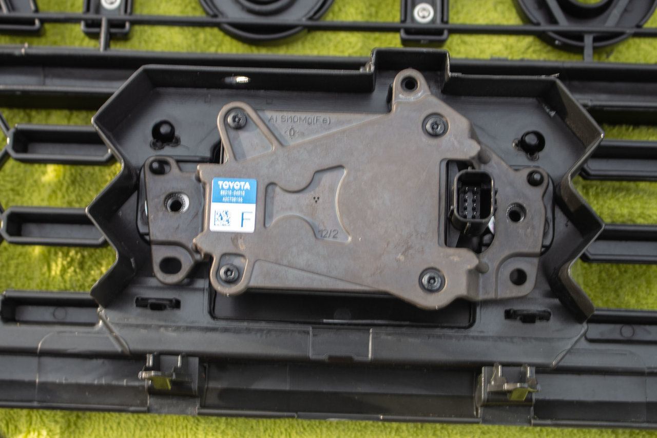

    STEP 4 - Remove the TSS sensor from the grille
    Un-plug the wiring harness from the back of the TSS sensor.
    Remove the (2x) phillips head screws and (2x) 10mm bolts holding the sensor in place.
    • Shown in GREEN - phillips head screws
    • Shown in PINK - 10mm bolts

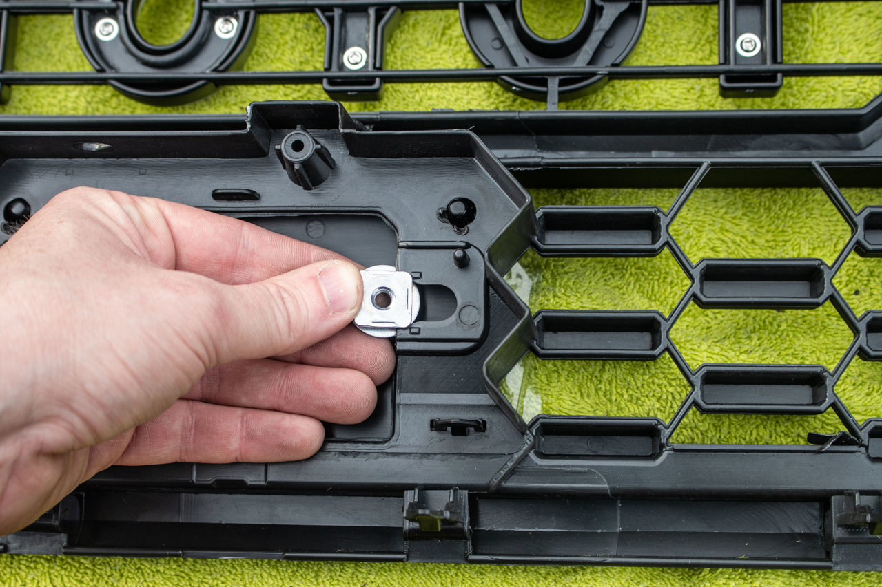

    Remove the TSS sensor retaining nuts from the original grille. These will be transferred to the new grille.

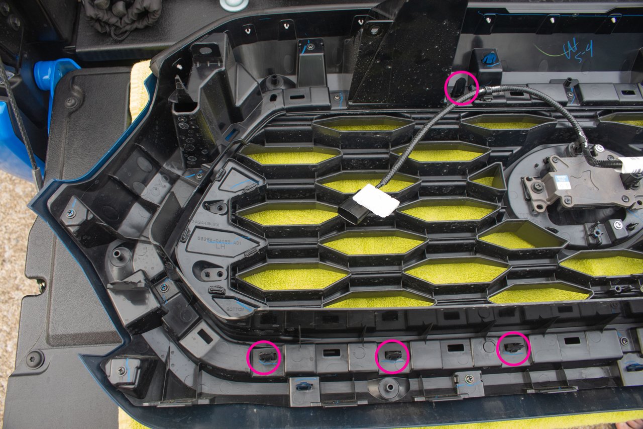

    STEP 5 - Detach the grille and wiring from the surrounding body trim
    Remove the (8x) phillips screws holding the grille onto the surrounding trim. There are other screws on the back side of the assembly, but we are only concerned with the ones shown below.

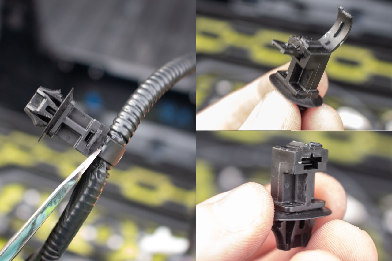

    Remove the TSS cover from the grille by releasing the (4x) clips shown below. I've found the best method to be releasing two at a time, while applying pressure to pop them out of their slots, then doing the other side.
    Un-clip the black zip tie clip from the TSS area, accessing it from the front to release. This is easiest if you pinch one side and apply force to wedge it back through the hole, after that the other side should come through with a bit of wiggling.
    There is a second zip tie clip needing removed using the same method as the previous clip.
    Now the grille can be removed without any interference. The last step is to release the million (I counted) little clips along the edge of the grille that connect it to the body trim. There are other clips further toward the outside of the trim piece, we are not concerned with those, only work on the inner set of clips.
    There is no real trick to this, just work your way around and eventually the grill will release.
    STEP 6 - Attach the new grille to the body trim piece
    Line up the new grille with the body trim and push the two pieces together until all clips are securely in place. In my case it took a good *smack* for two of the clips to take hold, and then everything was rock solid.

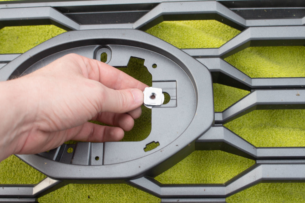

    STEP 7 - Attach the TSS shroud and TSS sensor
    (Not pictured) the TSS shroud simply snaps into place on the front of the new grille.
    Insert the (2x) retaining nuts from the original grille into the designated slots on the new grille. My image shows the nuts going in upside down (d'oh!), make sure the circular side is facing you while inserting, or the nuts will not fit.

    Set the TSS sensor in place and ensure everything lines up.
    Secure the TSS sensor using the (1x) phillips head screw and (2x) 10mm bolt.

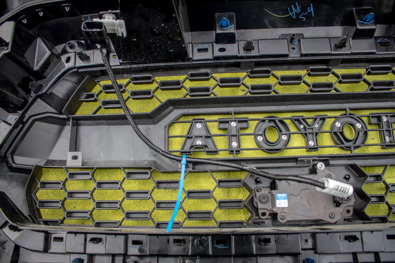

    Remove the zip tie clips from the TSS sensor wiring harness. After removing the clips, cut the "zip" portion of the clip off the base of the clip, and pull it through to remove; This should leave you with just the base of the clip, which is all we need in order to re-use the clip.
    Run a new zip tie through the now modified zip tie clip.
    Re-attach the white retaining clip at one end of the TSS wiring harness to the grille where it was originally located. Plug the other end of the harness into the TSS sensor. This will give you an idea on how much play there is on the wiring harness, and where you can place the modified zip tie clips to best hide it.
    In my case, only one of the two clip attachment points was viable. Place the clip in whichever location works best for you, then secure the wiring using the newly added zip tie.

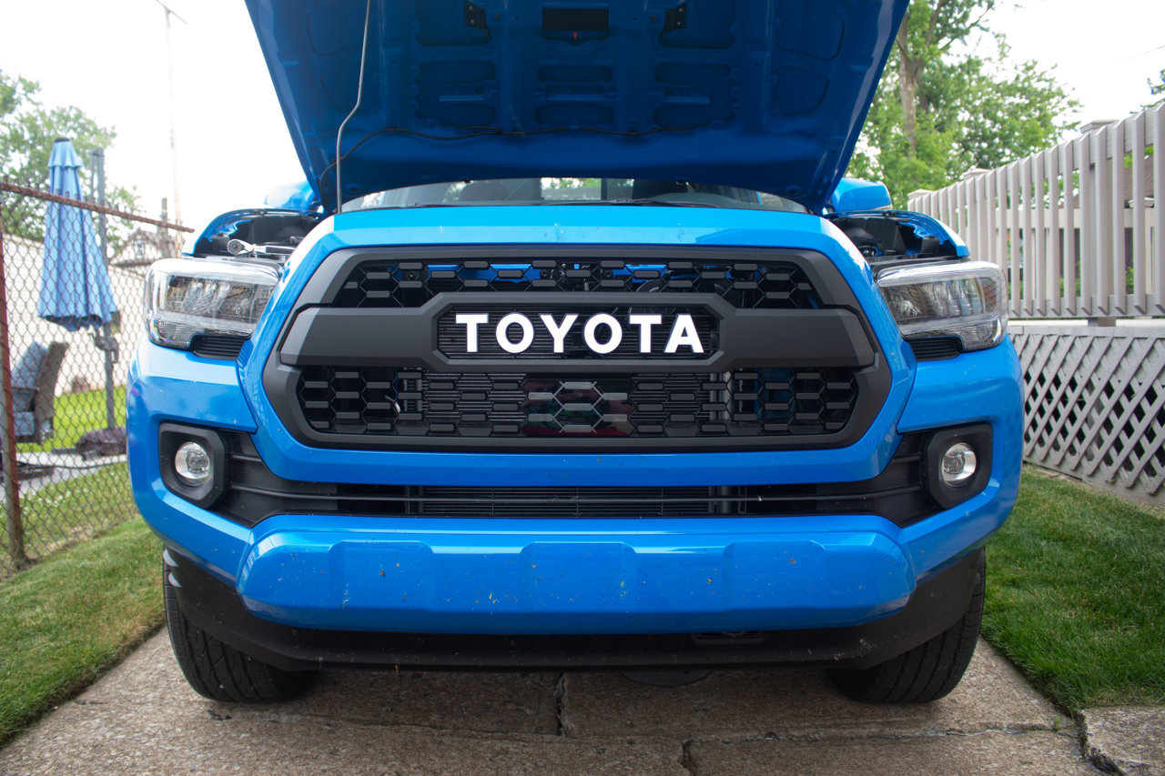

    STEP 8 - Install the grille onto the truck
    Take your newly assembled grille and place it back onto the truck. Be sure to give care to lift the plastic arms just like in step 3 when placing the grille so they clear the white plastic pieces on top. The grille should easily snap back into place at this point.
    Re-install the brown wiring harness clip from step 3.
    Plug the TSS wiring harness back in.
    Reinstall the (2x) plastic plug clips, and (2x) 10mm bolts from step 1.
    STEP 9 - Admire your handiwork :cheers:

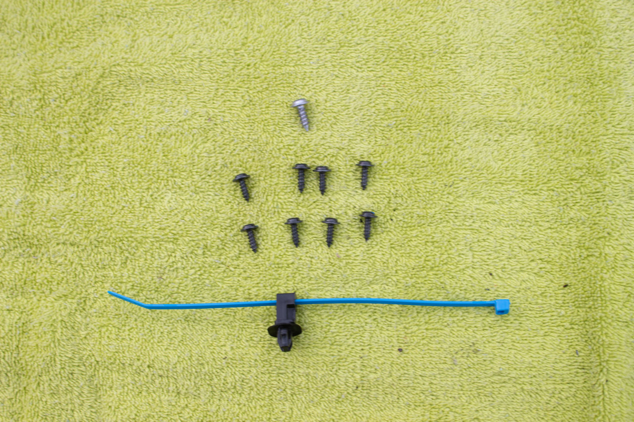

    STEP 10 - Don't sweat leftover parts
    None of the (8x) screws recovered when removing the OEM grille are used during the install of this new TRD Faux grille. We also only re-used one of the (2x) phillips head screws recovered while removing the TSS sensor. Lastly, only one of the (2x) zip tie clips were re-used while routing the TSS sensor wiring harness along the new grille.

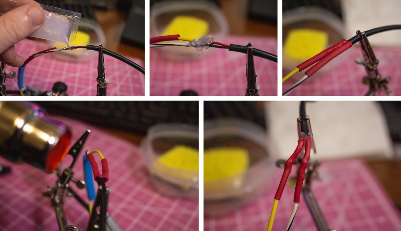

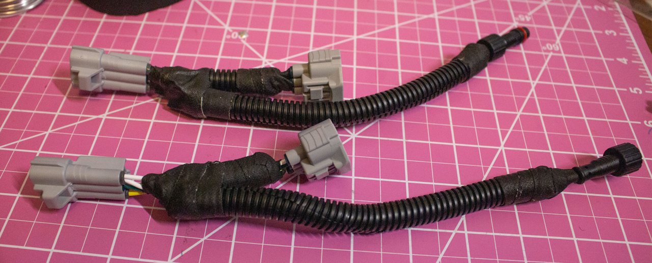

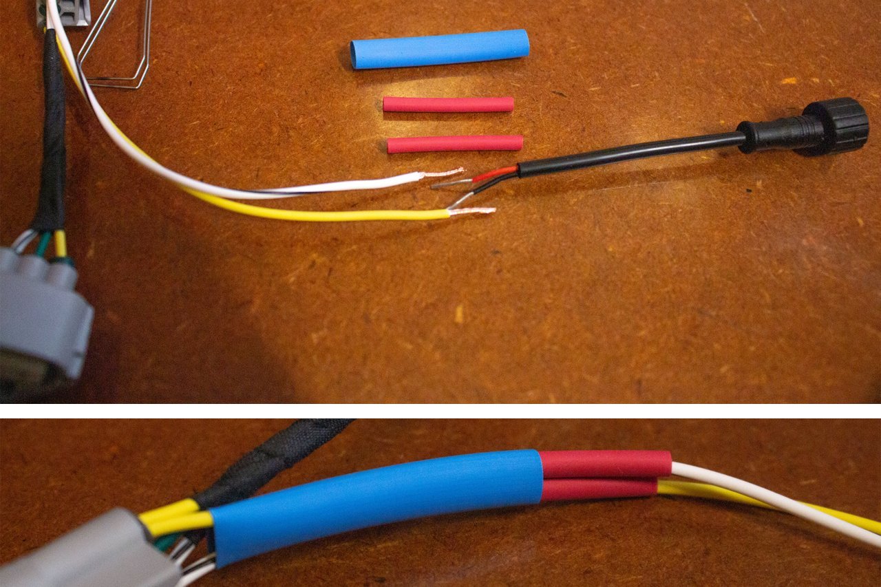

    WIRING VLEDS VLR-3 LED RESISTOR
    Parts
    • VLEDS VLR-3 resistor + DuoTap harness
    • Dielectric grease
    • Double sided high-adhesion foam tape
    • Shrink tubing
    • Electronic solder
    • Friction tape
    • Flex tubing
    Tools
    • Wire strippers
    • Utility knife
    • Soldering iron
    • Lighter or heat gun
    • Scissors

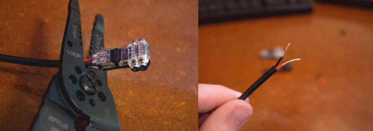

    STEP 1 - Remove DuoTap from the tap end of the wiring harness
    Start by cutting the shrink tubing off where the wiring meets the tap by slicing lengthwise using a utility knife. This should peel right off once it's been cut, exposing the wiring.

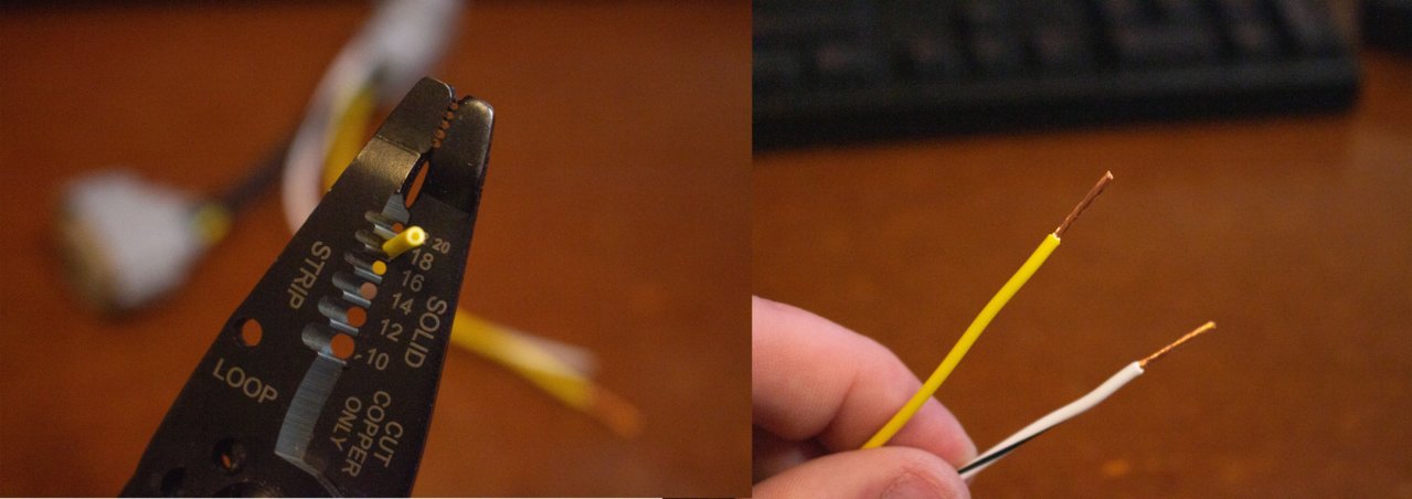

    STEP 2 - Prep the harnesses to be soldered
    Cut the tap off the end of the DuoTap harness and strip the exposed wiring.
    Strip the ends of the tap wires from the passthrough t-harness.
    Add the shrink tubing to the wires prior to permanently soldering them. On this project I opted for smaller diameter tubing on each individual wire, with larger diameter tubing to go over the individual wires/tubing for an extra bit of overkill.
    You may want to test the shrinky-ness of the shrink tubing to ensure it'll be the correct size once shrunk. This passed muster.
    STEP 3 - Solder it up
    It doesn't matter which wire on the t-harness is connected to which wire on the DuoTap harness, so just solder everybody together with abandon. Make sure you get a good connection and aren't soldering just one side of the wire together.
    STEP 4 - Shrink Tubing
    Apply the dielectric grease to the soldered connections and slip over the smaller diameter shrink tubing. Heat the tubing with either a lighter or heat gun to shrink it to a tight fit along the wire.
    Move the larger diameter tubing into place and heat it to a tight fit along the wire as well. This should make for a bomb proof weather seal.
    STEP 5 - (Optional) go apeshit with friction tape and flex tubing
    Shrink tubing and dielectric grease aren't enough reassurance for you? Me either...
    STEP 6 - Admire your handiwork :cheers:
    The harness is now ready to install. The rest of the installation goes like any other resistor install, with the exception of using the t-harness rather than a traditional wire tap connection.

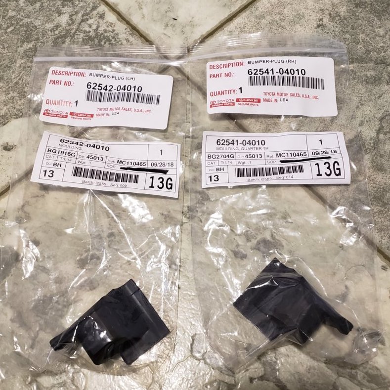

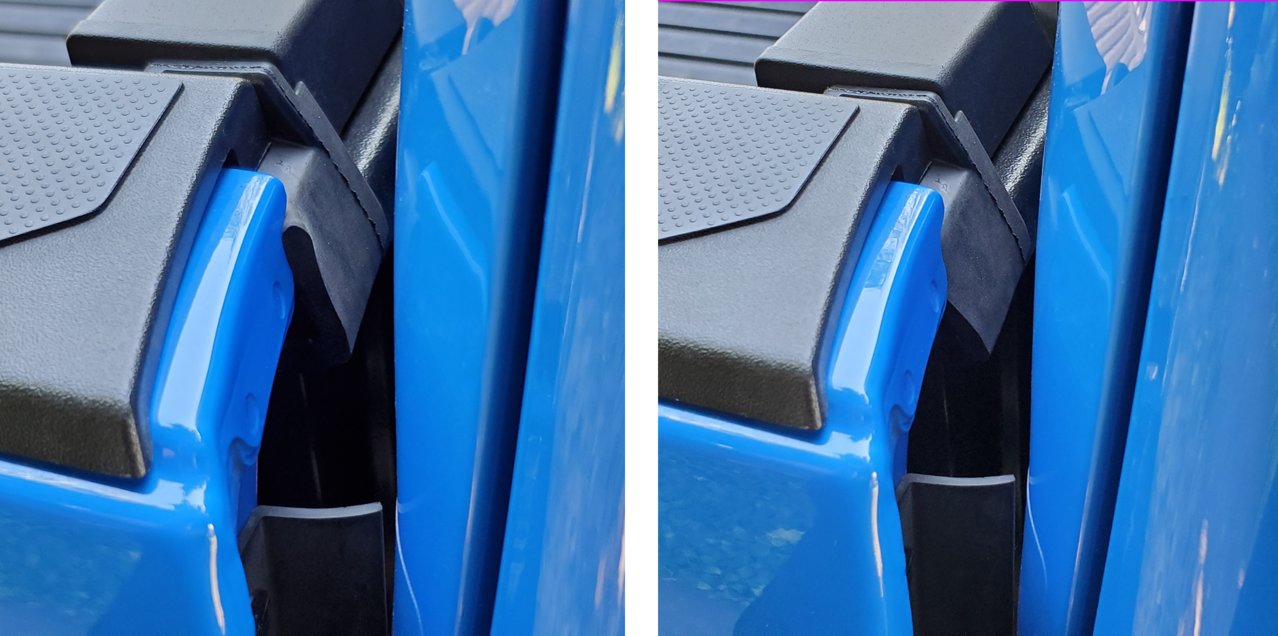

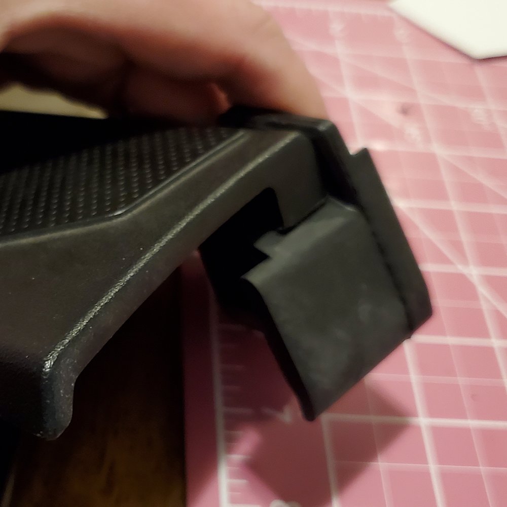

    INSTALLING OEM TONNEAU BED GASKETS
    This guide shows how to add OEM bed gaskets from OEM tonneau cover kits to a model that did not come with those options. This is very simple and only involves making a couple small cuts to the bed side cap trim pieces to allow for the gasket.
    Parts
    • 62541-04010 - OEM bed gasket (passenger side)
    • 62542-04010 - OEM bed gasket (driver side)
    • Card stock or printer paper
    Tools
    • Utility knife or hot knife
    • Scissors
    • Metallic sharpie (or anything visible on black plastic)
    • Pen or pencil
    • Scotch tape
    STEP 1 - Remove the bed side caps
    Start on the front side by pulling up on the inside edge of the black cap trim, it should pop right up without much of a fight. Continue along the length of the cap releasing all the clips until fully removed.
    STEP 2 - Make a cut template by tracing the gasket

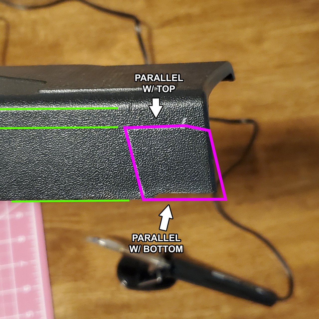

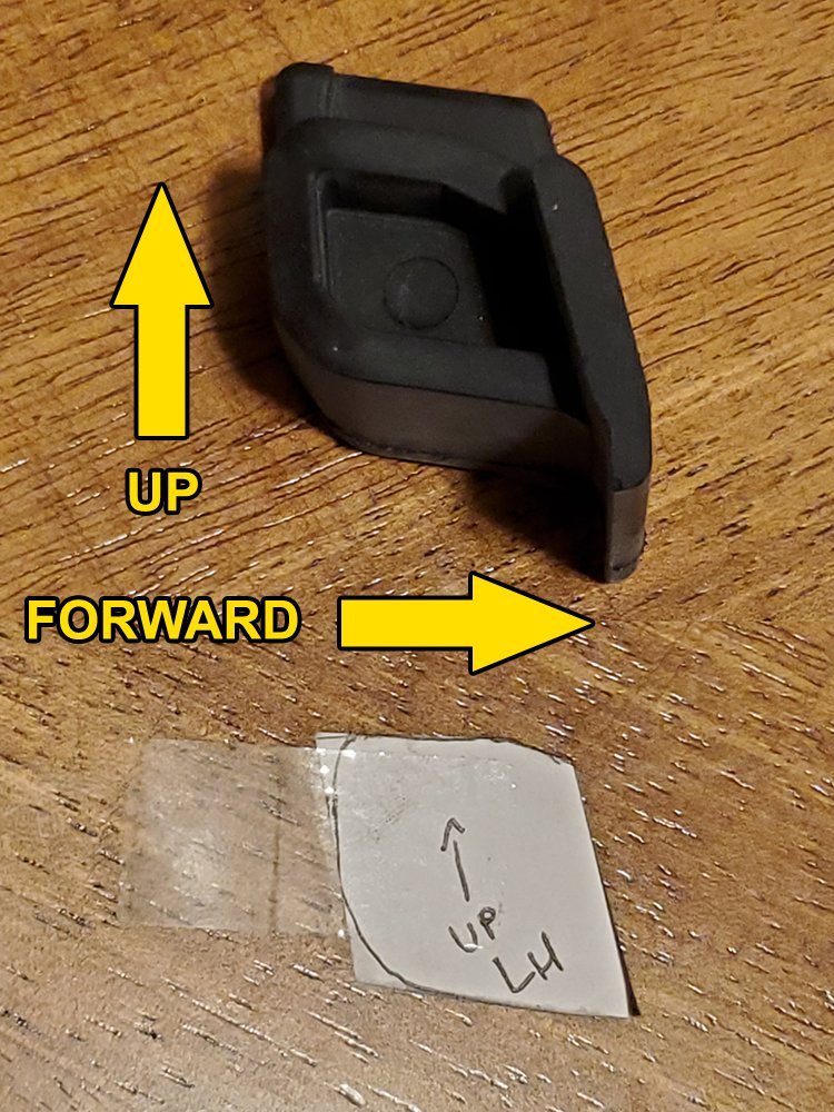

    Trace the small face of the gasket (marked in pink below) onto a piece of card stock for the cutting template. Cut the template out.
    The orientation of the gasket once installed is marked in yellow.
    Put a small piece of scotch tape on the cut template to attach it to the bed side cap. The cap has a small notch on the bottom end toward the end, my best results came aligning the template with the un-notched portion of the bottom edge to the template (marked in pink below.)
    Make sure the top edge of the template is parallel with the top edge of the cap trim.
    Once you're happy with how everything's lined up, trace the template onto the cap trim with the metallic Sharpie.
    STEP 3 - Cut out the marked section
    Using the hot knife make slow, even pressure passes along the straight marked lines of the marked cut. Using multiple slow passes all going the same direction should help reduce the amount of slag building up along the edge of the cut, and result in a cleaner cut.
    Test out the gasket fit and make sure everything lines up.

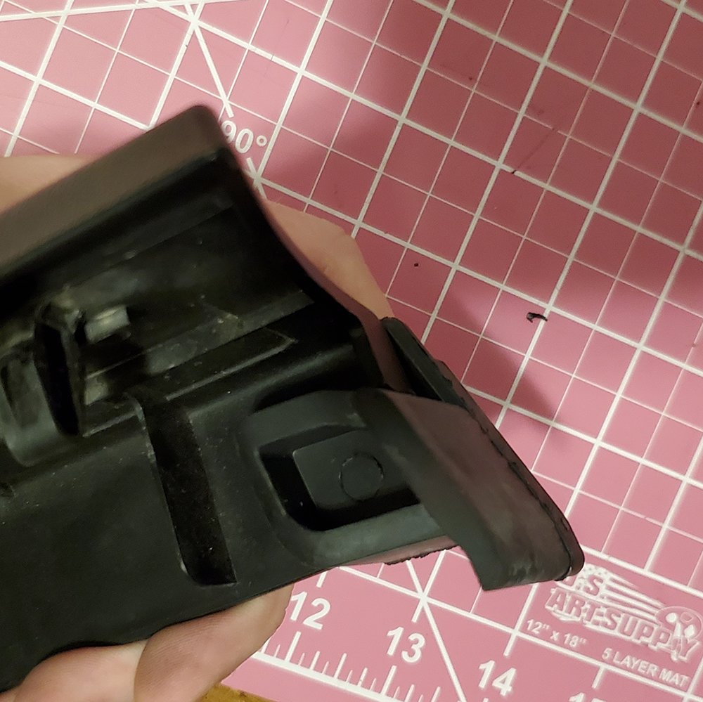

    STEP 4 - Install the gaskets and modified bed side caps
    What worked best in my case was to place the gaskets, then pop the bed cap trim pieces into place over top of the installed gaskets.
    Working the gaskets in while the cap trim was installed was almost impossible, on the truck that had OEM tonneau-compatible bed side caps this was possible.
    With the gaskets installed, re-attach the bed side cap trim starting with the forward end. Snap the trim into place, working along the length until all clips are snapped in.
    There's a small metal overhang on the outside front edge of the gasket. Not being able to recall whether it was tucked on the truck with OEM tonneau, I opted to tuck the gasket under the metal. If you have any info on whether Toyota tucks the gasket, let me know!
    STEP 5 - Admire your handiwork :cheers:
    With everything back in place you'd almost never know anything changed. The bed should be more weather tight once a canopy is installed since the large gap is now filled.

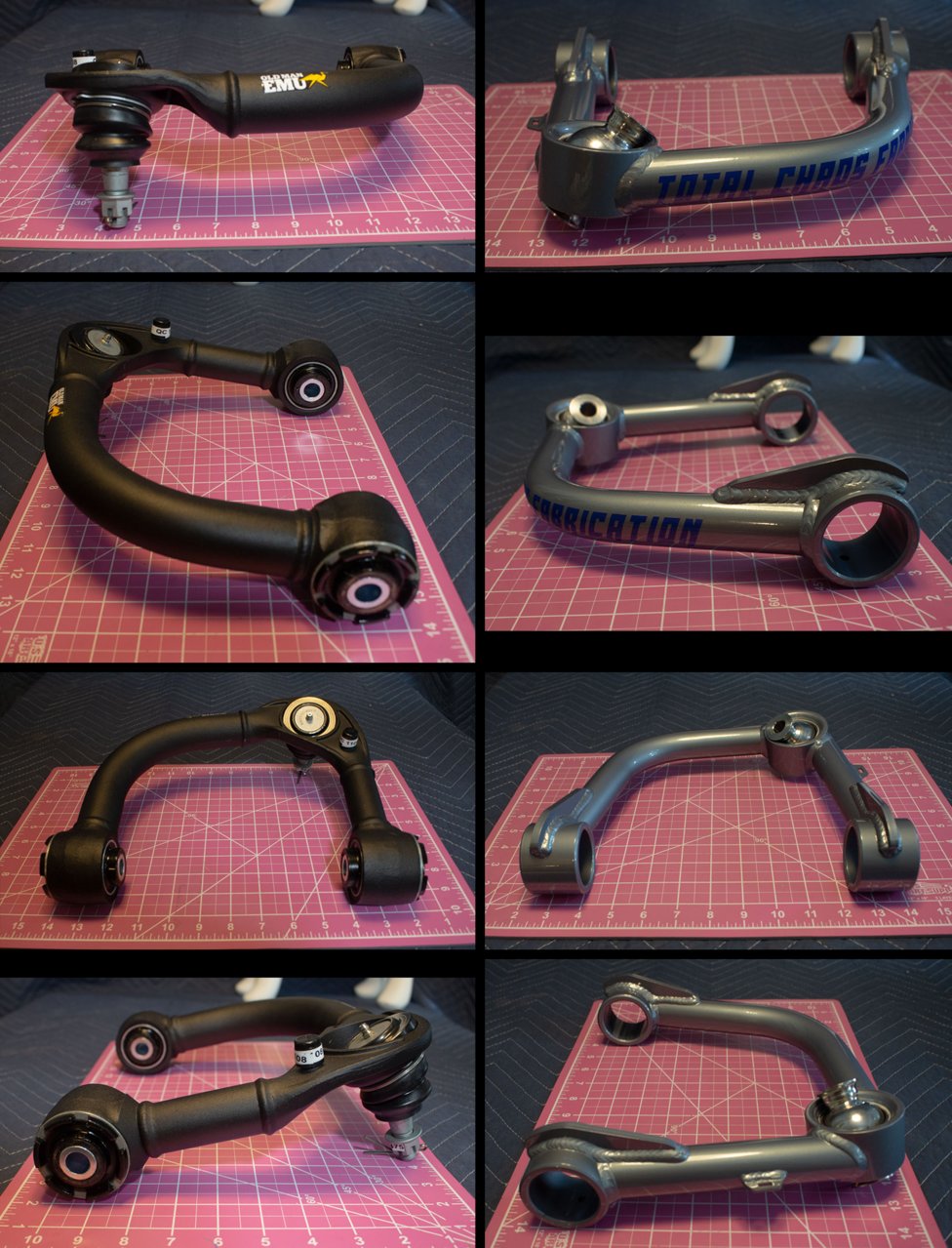

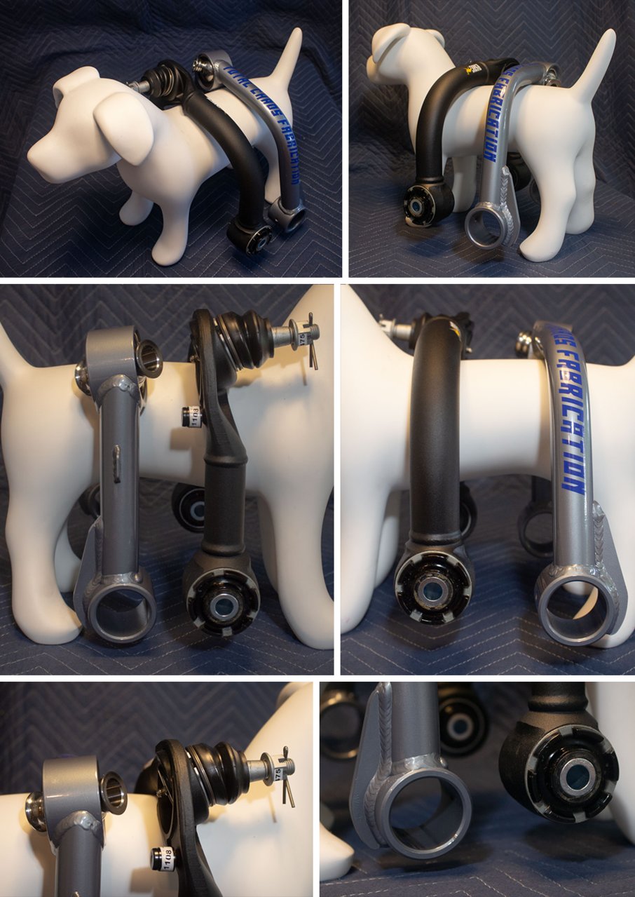

    UCA UNBOXING COMPARISON: OLD MAN EMU & TOTAL CHAOS
    This started with ordering a set of OME UCA from 4WP back in early March, which was repeatedly delayed for various reasons. Eventually by mid-October I gave up on ever receiving the OME UCAs and ordered a set from Total Chaos. Literally the next day 4WP called to let me know the OME set would be in the following Monday.
    Rather than cancel the order of one of the UCA, I decided to let both arrive so I could have a hands-on comparison to help choose which to keep and which to resell. So here we are, a post with 1:1 comparison pictures and some other questionably helpful information.
    PART 0 - What's Being Compared?
    This could be apples to oranges for all I know, but we're comparing the Old Man Emu #UCA0005 "UCA Tacoma" and the Total Chaos #96504 "Urethane Pivot UCA".
    PART 1 - Receipts
    OLD MAN EMU
    Purchased locally at 4WheelParts for $568.15
    TOTAL CHAOS
    Purchased at OffRoadWarehouse.com for $792.16

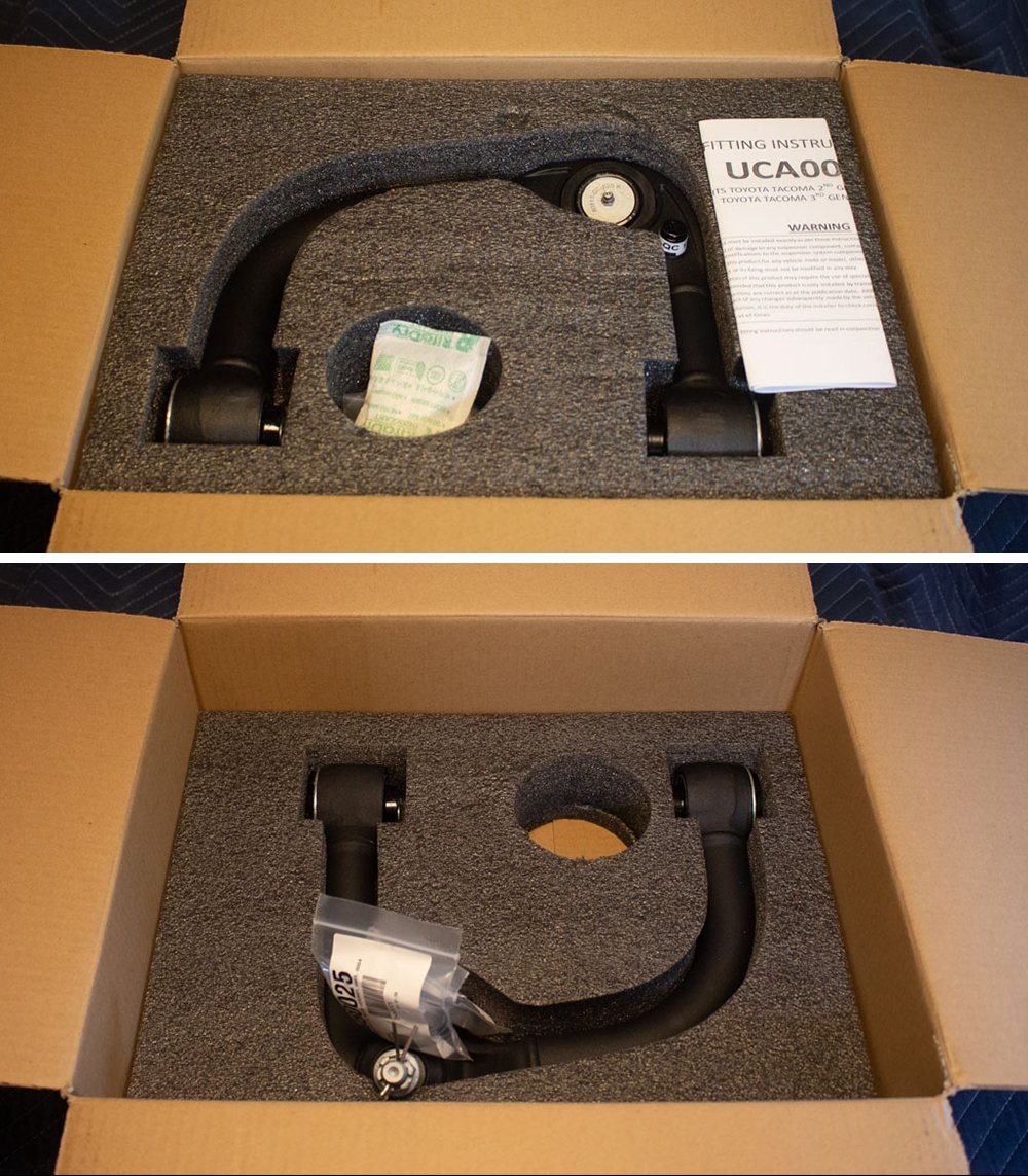

    PART 2 - Unboxing
    Note: The OME set was picked up locally at 4WP and the Total Chaos set was shipped.
    OLD MAN EMU
    TOTAL CHAOS

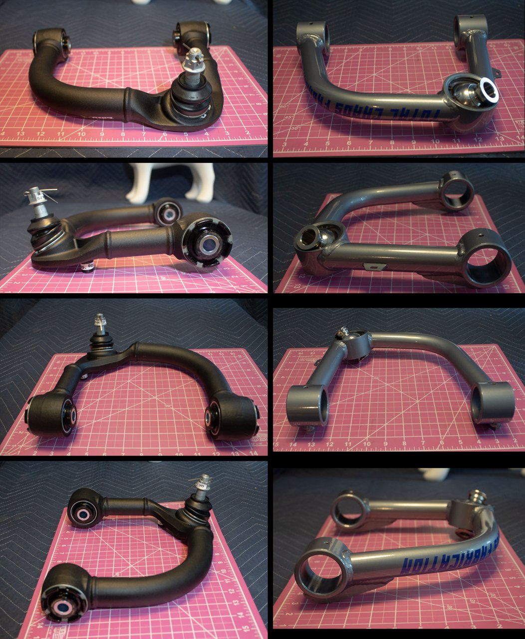

    PART 3 - Comparison Shots

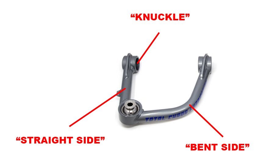

    PART 4 - Weights and Measures
    These measurements are highly scientific and performed with only the best postal scale money can buy (...at Harbor Freight.)
    Notes:
    • Weights given are for one full UCA and its provided hardware.
    • Measurements given in mm were done using digital calipers.
    • See the diagram below of highly technical terms used in measurements given.
    OLD MAN EMU
    • WEIGHT: 9lb 6.0oz
    • DIAMETER (STRAIGHT SIDE): 32mm
    • DIAMETER (BENT SIDE): 38.5mm
    • DIAMETER (OUTER, KNUCKLE): 62mm
    • WIDTH (KNUCKLE): 45mm
    TOTAL CHAOS
    • WEIGHT: 6lb 1.0oz
    • DIAMETER (BENT SIDE): 32mm
    • DIAMETER (OUTER, KNUCKLE): 57.5mm
    PART 5 - Wrap-up
    So here we are at the end and what have we learned? I'm not sure to be honest...
    If you've got a suggestion for which UCA to use, feel free to comment and let me know which and why -- I could really use the help! :thumbsup:

    I don’t have any yet so I can probably take the set you end up not wanting.
    You might want to ask someone like @memario1214 to chime in on the differences?

    I have the OME arms on my truck. Have no experience with any other arms. I purchased the complete BP-51 setup for my truck that included the arms. What I like about them is the very low maintenance and the sealed ball joint. I spend a fair bit of my time year round either exploring the woods in the mud or out in central/eastern Oregon in the dust. Less to have to worry about in my opinion.

    TC UCA more likely to squeak, bushings go out faster, uniball = higher maintenance. Built solid, will last a long time.
    OME are simpler, I'd bet the bushings and ball joint will last longer than the TC bits.
    UCA I'd prefer OME or SPC over TC, and I run TC currently.

    I've been convinced to opt for OME mainly by laziness of not wanting to put in work maintaining the TC.

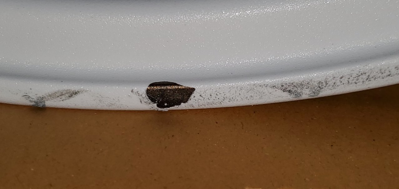

    17" TRD SEMA WHEELS GONE WHITE
    These wheels are the bane of my existence, and a textbook example of a moron embracing the sunk cost fallacy.
    STEP 0 - Do Your Research
    That was a joke! Who has time for all that? Simply walk into whatever local shop Yelp claims is best and trust they are not taking you for a ride.
    STEP 1 - Greatly Overpay for Basic Powder Coating Services
    This can be as easy or hard as you like, just don't do what I did -- comparison shop!
    STEP 2 - Take the Wheels Back to the Shop to be Re-Coated
    Only after loading all the wheels up, hauling them home, and unloading them should you begin to scrutinize the quality of work performed.
    And... surprise of surprises: it looks like absolute trash.
    Now load the wheels back up, haul them back to the shop, unload them, haggle with management about the work quality and then wait another two weeks for (re-)completion.
    STEP 3 - Give Up On the "Professionals"

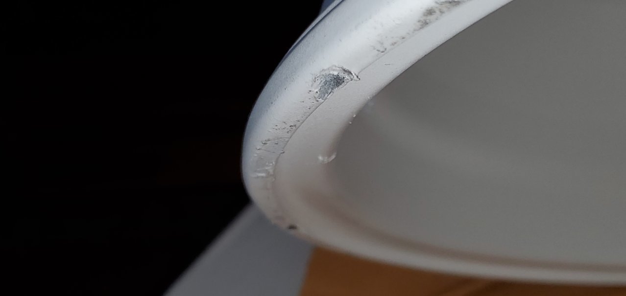

    Alright so now your wheels are back in-hand and the powder coat is actually, y'know, coating the wheel. But something still looks off... Could it be the center cap that appears to be "color matched" using a can of Rustoleum off-white from Home Depot? Yeah, probably.
    So at this point at least the powder coat is on the wheel and not marred like it's been dragged across a gravel parking lot... Maybe I could try and color match the center caps myself?
    STEP 4 - Find You Some New "Professionals"
    Maybe color matching is hard, so let's go to the pros who do it all day every day! Enter Sherwin Williams Automotive Finishes.
    Go ahead and load up a wheel again, haul that bad boy to Sherwin Williams Automotive Finishes, unload it, and then ask that they mix you up a rattle can of automotive paint to match the wheel.
    This part takes ~10 business days.
    You'll also need to purchase a can of clear coat to protect your fancy new paint. All told, for two cans of custom white paint and two cans of sealer, paint cost was ~$150 -- that's on top of the original ~$2k from the powder coat shop which included color matched center caps.

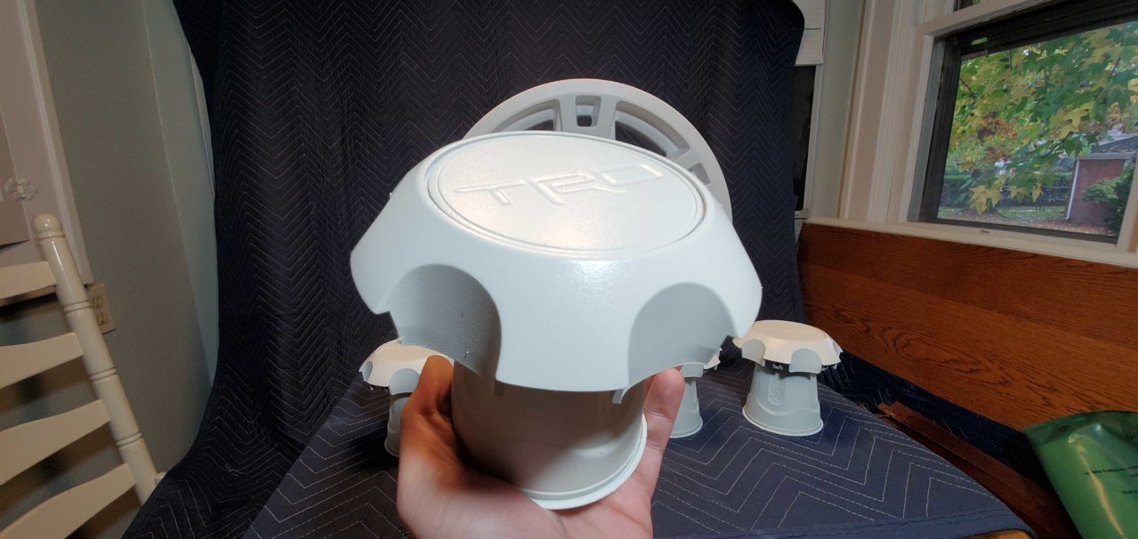

    STEP 5 - Buy New Center Caps and Paint Them
    More expense! Buy five new center caps, the powder coat shop put about a 2" coat of mismatched white paint and they cannot be salvaged.
    Now go ahead and use whatever method you prefer to paint the new center caps and seal them up. Be sure to follow the directions on the cans for best results.
    STEP 6 - Give Up On Yourself
    After sanding, painting, and sealing the new center caps; let's grab a wheel and check how it matches up.
    Hoo boy, in blueish light the color still looks quite off...
    Lots of orange peeling on the clear coat too...
    Well... shit. The color is ever so slightly closer to matching than it originally was but is still quite noticeably off between the wheel and center caps, and the clear coat sheen is a better match too.
    What's to do? If you ask me? Nothing.
    After all this expense and hassle, it's close enough for now. If it bugs me enough once the wheels are on I'll go buy another set of center caps and even more (likely mismatched) paint to give it another shot.
    Do not admire anything, this project has been a complete bust!
    indoomitable and vorkuta775 like this.
