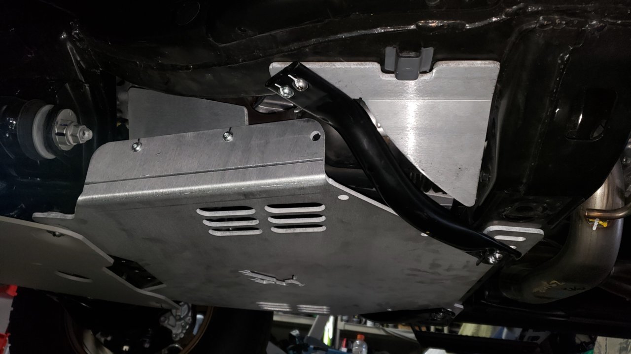

    Very Nice!
    And yes, the guys at Talon are great with this product.
    The CAT plate is just as thick as the TRD Skid on my Sport. I don't have the cutout on the winglet but I was able to position both in a way that sidesteps the plastic doo-hickie I did not want to break off.
    Glad you are happy with it...and yes, put that driver lock somewhere you can find it.

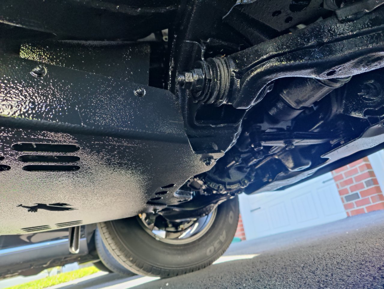

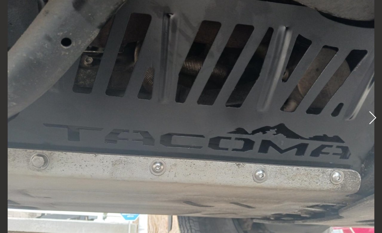

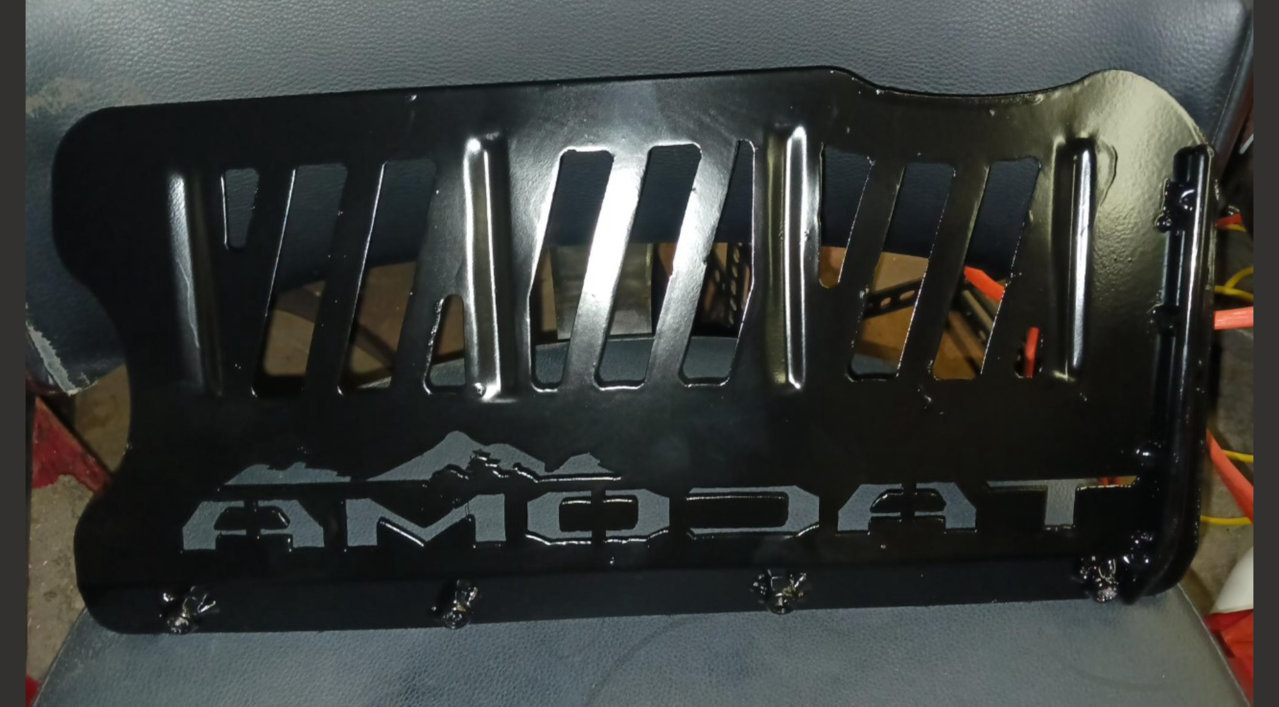

    Also got a cat protector from Talon's Garage. Sprayed it with some Woolwax black undercoating before install. I really like how it came out. Thinking about getting their skid plate they just came out with, but I wanna see more pictures of it first.

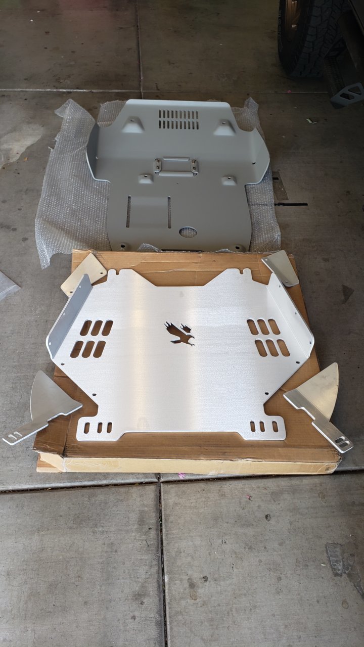

    I need to get more photos up on the website. Here is a good one from another lady that just installed it.
    https://www.tacomaworld.com/threads/welcome-to-talons-garage.743159/page-11#post-27239507

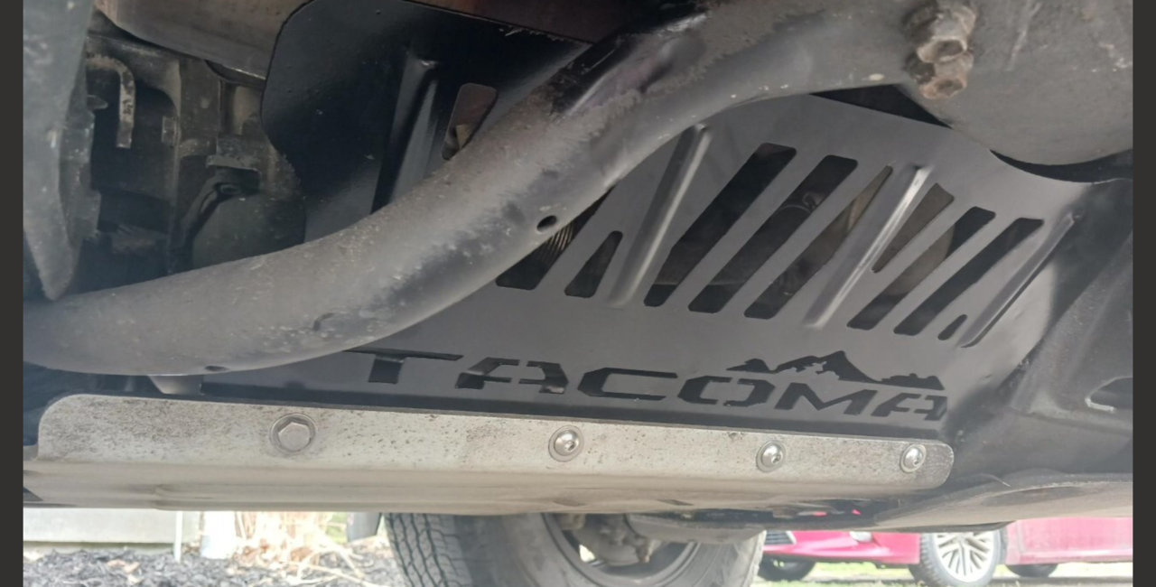

    I used some cardboard and scissors to make templates for the initial sizes. Cheap 18G steel sheet metal cut on a plasma table with stainless steel nuts and a brace welded to the back of each. Spray painted, rust proofed and bolted to my aluminum trans skid.... ($142 for the original aluminum skid from eBay and ~$30 in parts for the cheap cat covers)
    Nothing is 100% theft proof but hopefully it’s enough to make even a dumb thief look under my truck and decide to move-on......

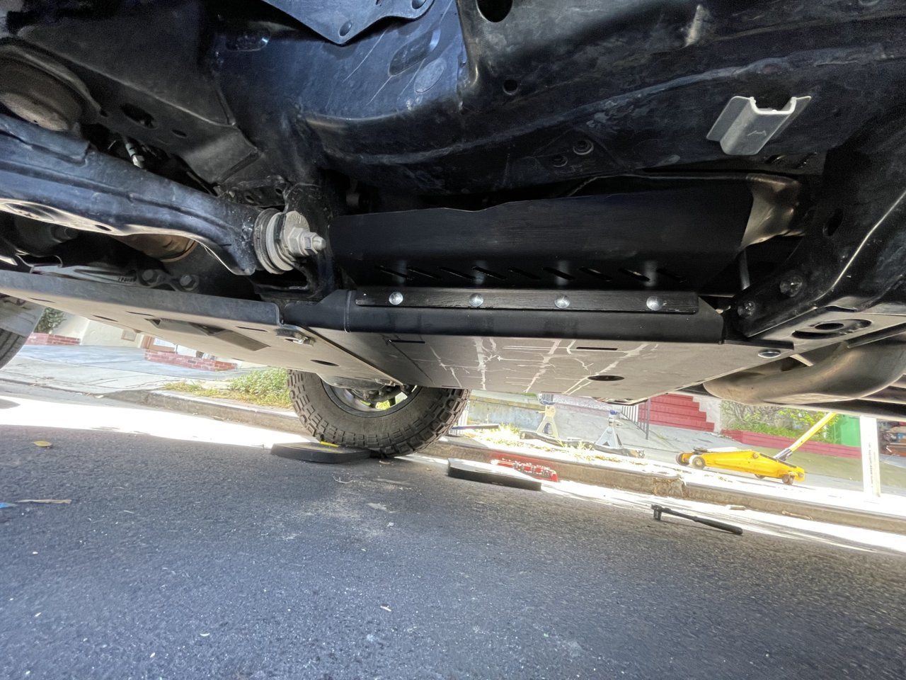

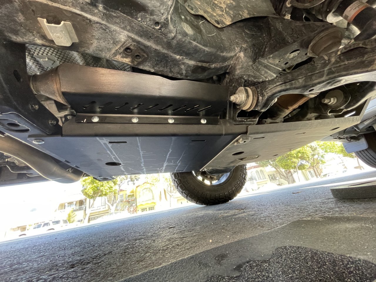

    I really like the design of the front skid. Let me know if you want more pics other than the ones in my quote below (few pics under the spoiler button in the quote, didn't want the post to be super long).

    Thanks for the pics. I noticed on the website, the bottom part of the front skid seemed to be two separate parts, but on yours it's a solid piece with a door. There also appears to be another "door" other than the oil filter one. Am I safe in assuming that is to where the front jack point is on the vehicle?

    It is two separate pieces that are held together by a bracket added to where the end of the stock skid attaches. I am not 100% sure what the second "door" is for (added a close up for you though).

    • The "front" door is I believe for the oil filter
    • The "rear" door is for access to the oil drain plug.

    I thought the shield for the cat protector was supposed to "mate/connect" underneath the skid plate. That way if you are on a rock of something and "skidding" along. the obstacle has something to slid onto.
    With that lip showing and the cat protector below the skid, couldn't you get hung up on an obstacle?

    With the trd skid, the cat shield goes under. I think with the Talon skid it is supposed to mate up to it evenly, but I had already added both spacers when I installed the cat shield first. I've been too lazy to undo it to take out one spacer since adding the front skid though (I will eventually).
