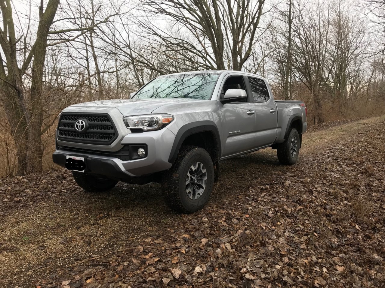

    @HeadStrong Off-Road makes a 1/2" top plate spacer that will give you 1" of lift on the front. Will get you close to level for just a few $$$. Will keep your stock ride and it can be installed pretty easily right in your garage. Don't let these folks on here tell ya that ya need to spend thousands to do what YOU wanna do. Ya don't... If it wasn't a quality product, @HeadStrong Off-Road wouldn't carry it. Here is the link... And here is a pic of my truck with the 1" Rough Country top plate spacer and a 1" block in the rear. Still just a slight nose down rake, which I wanted to keep. Remember that if you do a spacer, ONLY get one that mounts on TOP of the strut assembly. Otherwise 1) it requires disassembly of your strut which only an auto mechanics shop can do safely, and 2) because it goes inside the strut assembly it will compress the spring which pre-loads it and causes a much harsher/stiffer ride.
