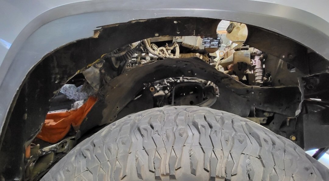

    Stock-ish
    Pretty much unless you want to run maybe 2 or 3 tires out there that are 37s/16s.

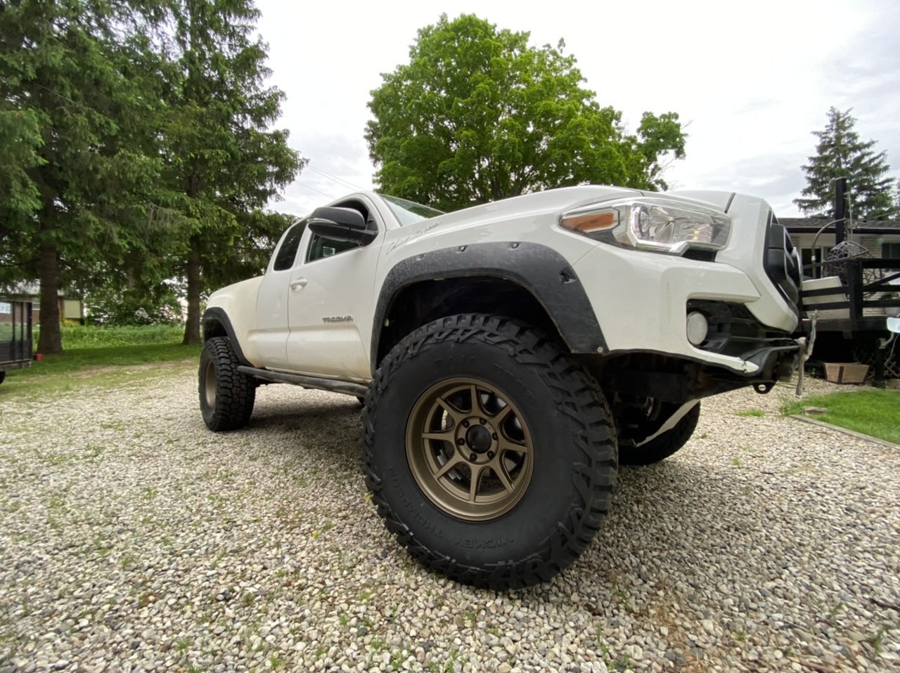

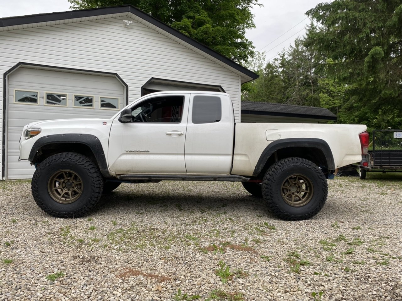

    I did a thing, now :sawzall::welder:

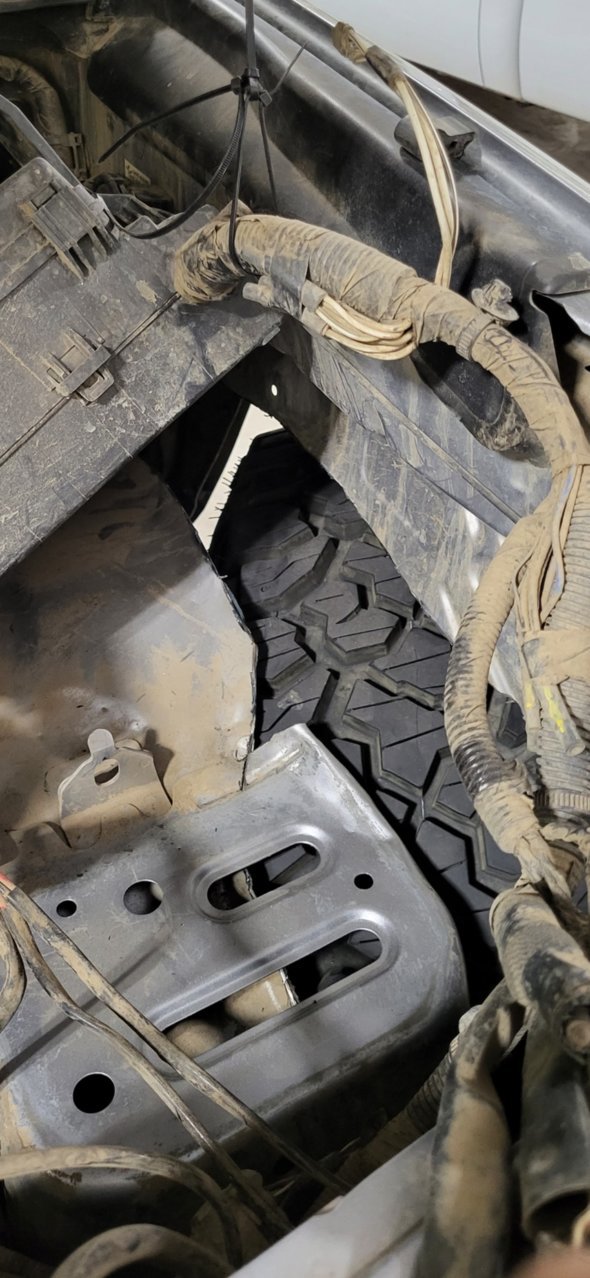

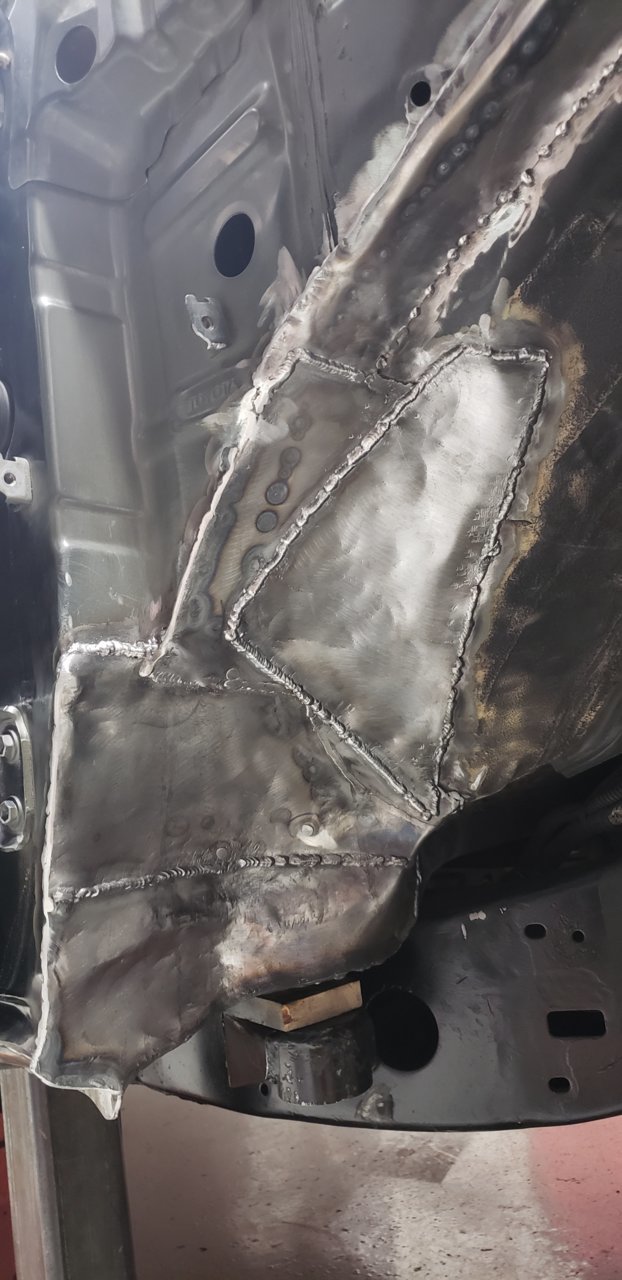

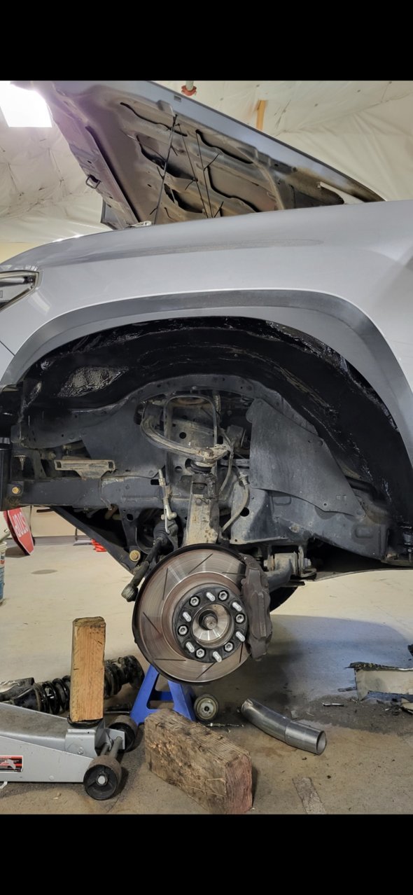

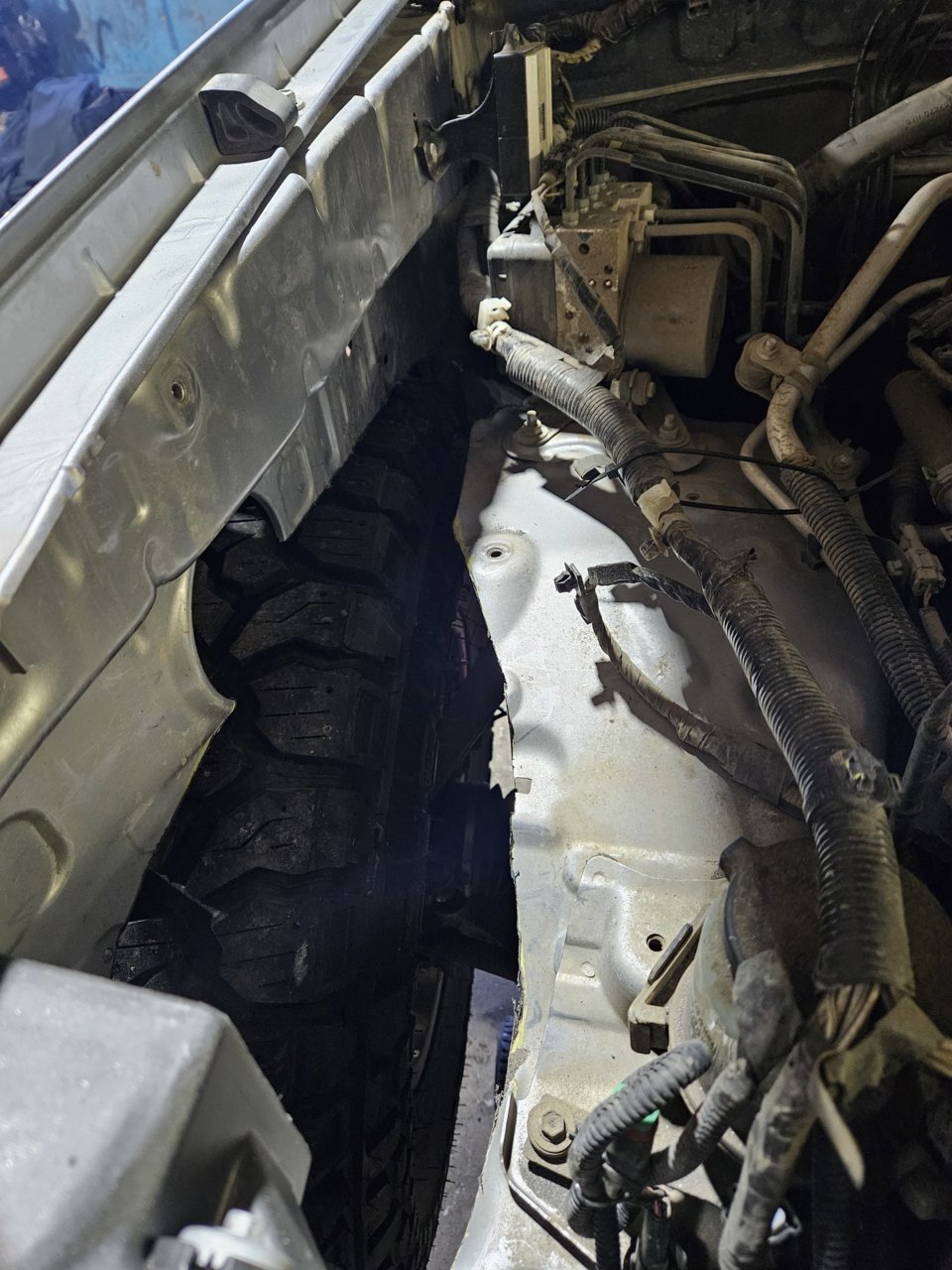

    This was when I was stock travel, but just did lt and the same amount is needed.
    Screenshot_20230328_074144_Gallery.jpg Screenshot_20230328_074229_Gallery.jpg Screenshot_20230328_074222_Gallery.jpg
    And current cut level with lt
  13. Mar 28, 2023 at 7:46 AM

    And just tubbed a buddies 2nd gen this weekend with Tc +2 kit and 37s. Same cut height

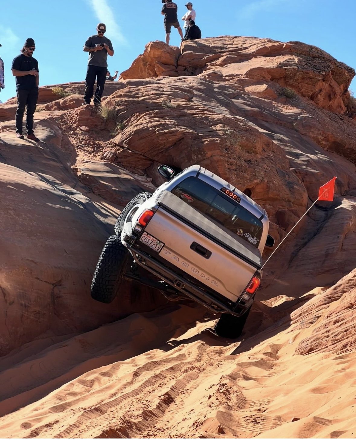

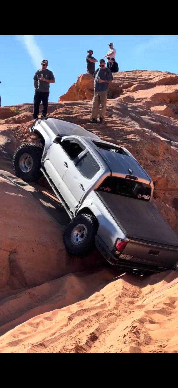

    Still rockin 37s. Allpro +2 kit up front, dual tcases, 3 link rear end. Only things I’ve broken was a Tundra steering rack, a tie rod here and there, and broke a Rcv front axle the other week. Otherwise I drive it 1200 miles at 85mph, beat the crap out of it, drive it home and to work

    Looks good. How much trimming did you do on the fenders

    The fronts are cut a hair past the top of fender flare, so like 4 or 5”.

    Not too bad then . Honestly I would've expected more lol
