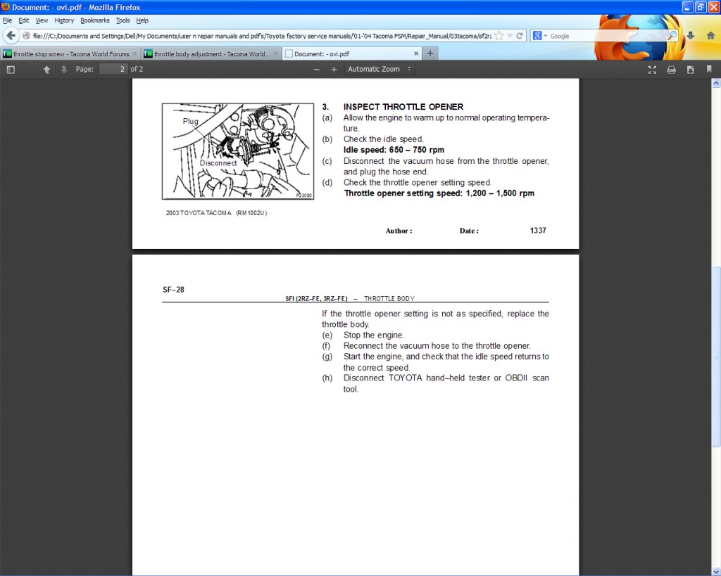

    I am back to daily driving my Tacoma for a few weeks and have noticed a rough idle for <30 seconds during a cold start. The pedal is stiff, hard to push and have read that I need to clean the throttle body. I was in the process of seeing what else could be causing this rough idle and noticed a screw is missing[​IMG] from the throttle assembly. This is for a 97 2rz.
    I found the following thread that is similar to my problem.
    http://www.tacomaworld.com/forum/1st-gen-tacomas/111440-throttle-body-adjustment.html
    Where can I find the screw that goes there or should I just find one that will fit there?
    How far away is the screw supposed to be from the valve when the engine is off?
    Does anyone else have pictures they can share?

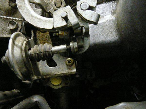

    I did manage to find a screw to put there and have been adjusting it to where i think it should be. However, this has not solved the problem of odd idling. I removed the throttle and cleaned it, but now it idles worse and gave me check engine codes. PO300, PO301, PO302, PO303, PO304.
    I can hear a loud hissing sound near the egr valve. I noticed I had pretty much all the vacuum hoses cracked. I changed them all hoping this would solve the problem, but it hasn't. It idles a bit better, but the hissing sound is still there and still idles rough. What else can this be? I have parked my truck and am daily driving my car, but need the taco[​IMG] to run properly.
    The fuel filter, spark plugs, distributor cap, rotor are brand new and were installed a few hundred miles before cleaning the throttle body. The rough idle and engine codes began after removing, cleaning, and installing the throttle body.

    I would say you still have a vacuum leak somewhere.

    Use a 2-foot length of vacuum line as a stethascope, and try to locate that vacuum (hissing sound) leak.

    Here is a photo of my throttle stop. There is no gap when cold and not running. Actually, mine is adjusted so that its beyond 0". The 'dash pot' strut is holding the throttle open a bit. Mine may need adjusting, I'll have to research it.

    Thanks for all the replies guys. I also read about disconnecting the battery to allow the computer to reset itself now that the tb is free from gunk. I am going to inspect it again and see what I find.

    Problem solved guys! I made a rookie mistake and noticed something when I removed the throttle body bolts/nuts. I installed the gasket upside down and was not sealing properly. I reset the check engine light and she started up perfect. At least I was able to catch several bad vacuum hoses from this ordeal and now have a clean throttle. Thanks to all the replies.
