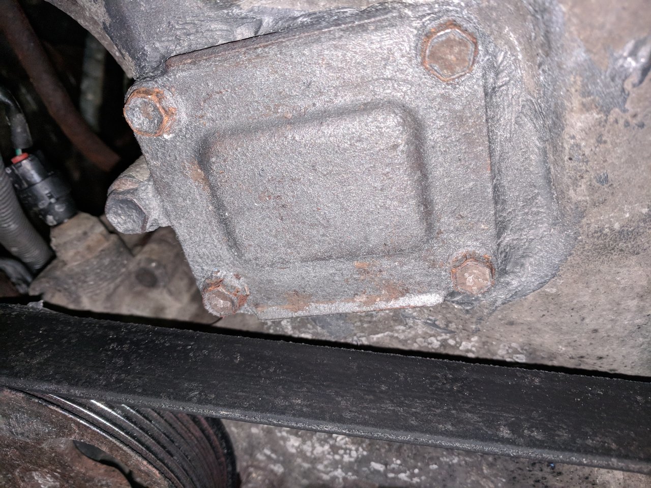

    I think I really got a bad deal with this truck (bought it in Jan): first the power steering fluid is mysteriously over filled and spilling all over the place; then I found a big transmission fluid leak, turns out to be the transmission cooler outlet line has rusted through, so I had to replace both cooler lines and change the fluid (only about 1 qrt old fluid came out; so my transmission could have blown up if I hadn't noticed the leak for another two months). Now, I realized that I may have the dreaded timing cover leak: I should haven taken a picture before I cleaned the area with 4 cans of carb cleaner -- because I wanted to make sure there is oil leak. But all the read circled areas are covered with black oil (completely black):
    Also, when I was working on the transmission cooler lines and fluid change, the areas below these areas are also covered in black oil.
    I was hoping it was the power steering fluid spilling over, so I cleaned area. It seems to be surrounding that square rusty cover right below the hose circled in green (is this the timing cover)?
    After 1 weeks of in town driving, I clearly see oil seeping out to the bolt pointed by the arrow. So there is no doubt that it has nothing to do with power steering.
    I want to confirm with the experts here is this the timing cover leak?
    Also, I have found that the repair is extremely labor intensive and costs thousands of dollars. But it seems to me that I can just unbolt the four bolts holding that green circled cover, applying some RTV. Please tell me where I am wrong.
    Thanks a lot!

    Going back to the original thread, can someone confirm whether I have the dreaded timing (chain??) cover leak issue based on the picture and description in my original post?
    Thanks!

    So this is the timing cover leak?

    What is the green circle cover? Is it the timing cover? Or timing cover is something more inside?

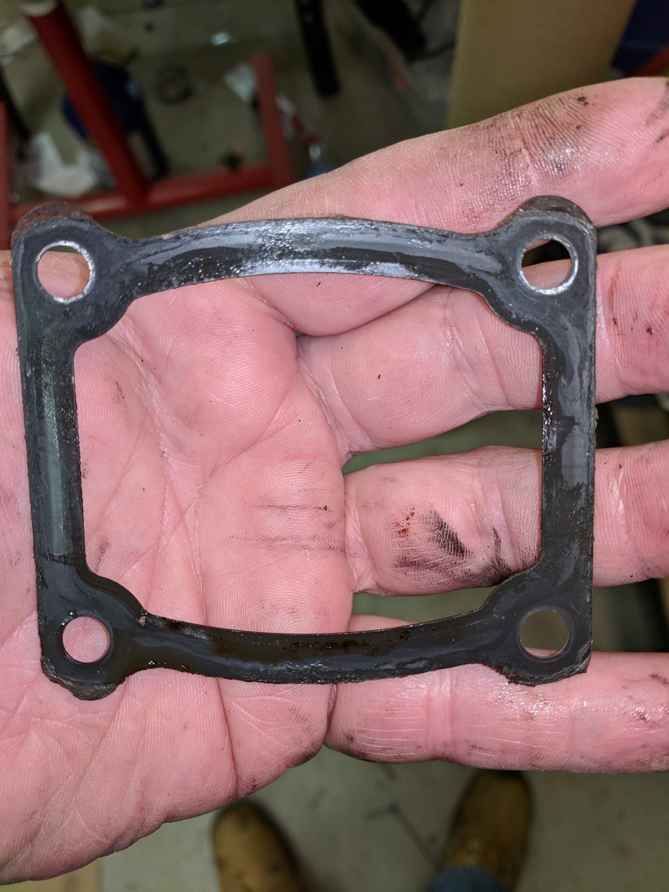

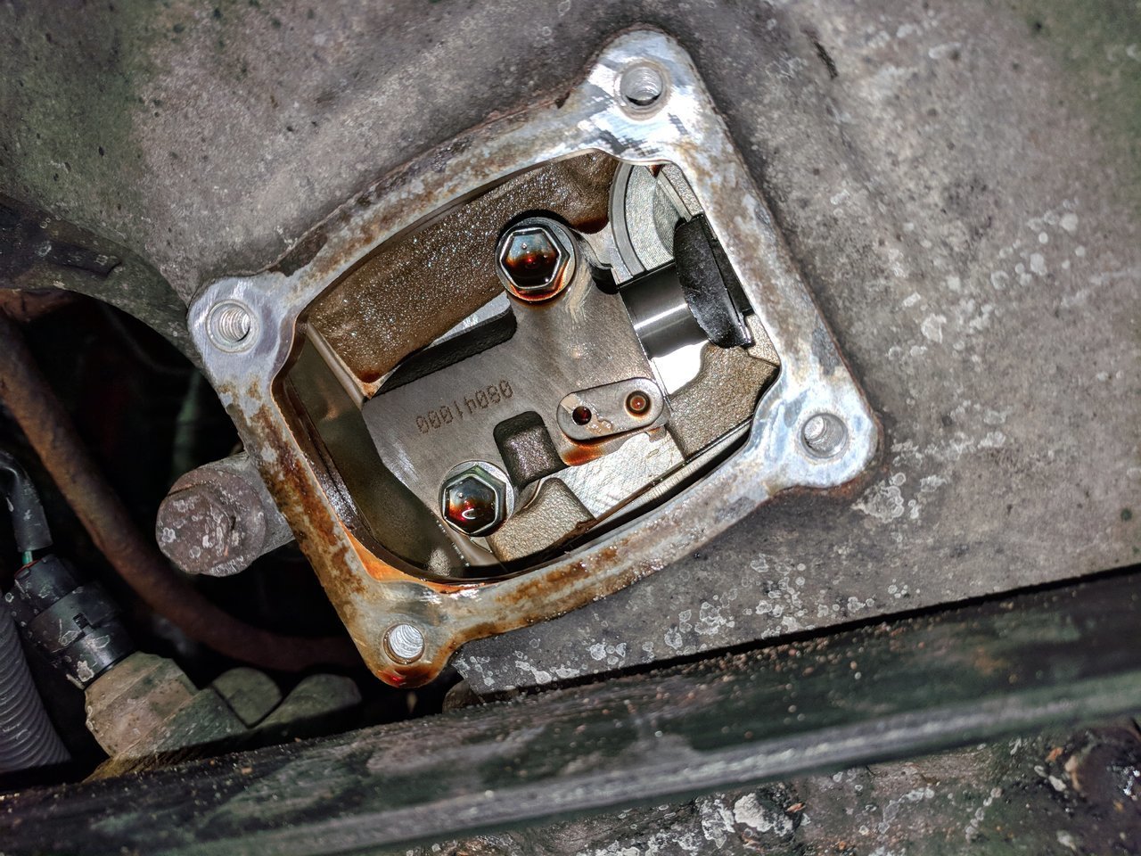

    I am doing some research online and found this post on TW by Mingy:
    https://www.tacomaworld.com/threads/how-to-fix-the-timing-chain-cover-oil-leak.525227/
    It seems to have done exactly what I suggested in my post. See his pictures below:
    If this can fix it, it doesn't seem like a very difficult job and I should be able to handle it. Especially given the excellent detailed step-by-step description by Mingy. Can someone comment? This job, even at the dealer, shouldn't cost thousands? I start to think there might be two different issues: one is this one described by Mingy (seems like I have the same issue) with a seemingly easy fix, another one is much more involved and expensive.
    I am really new to Tacamo, please help me!

    That little square piece is the timing chain tensioner inspection port. The actual timing chain cover leak happens at the seam of the engine block and timing cover seam a little above where the the power steering pump bolts to the engine. This is a common problem on 4.0 V6s all the way back as far as 03 I believe.

    Thanks a lot. This is 3rd Gen, so a 3.5L V6. Does it have the same problem as the 4.0L engine?

    Yes the 3.5 and 4.0 are from the same family of GR engines (1gr is 4.0 and 3.5 is the 2gr) they basically share the same engine block. The 4.0 V6 had this timing cover leak for a long time and the 3.5 basically inherited this defect. To fix it on a 4.0 you take off all the engine accessories and pull the timing chain cover, clean the mating surfaces and reapply silicone rtv gasket material. If you have the proper tools you can do this in maybe half a day or even less with some help without needing to pull the engine. The 3.5 may be a little trickier because it has more accessories and the engine bay is smaller. I tried this on my 05 Tundra which has a lot of room in the engine bay but I didn’t finish the project because I discovered other issues with the engine and aborted the mission. If you have experience with working on cars, it should be rather simple but takes time imo.
