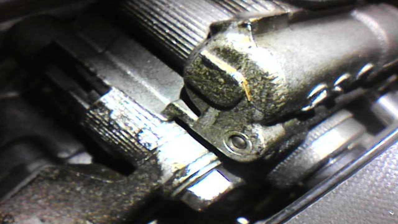

  17. May 13, 2019 at 3:06 PM
    #237
    Beerpayzdabillz
    Beerpayzdabillz Pastryatarian
    Jul 28, 2016
    #193169
    1,528
    Nor Cal
    2016 DCSB 4x4 sport
    Checked mine today. I'm a Mexico 2016 with 34K miles.
    Appt set for next Monday.
    JmsWms, ian2016 and surfyota like this.
