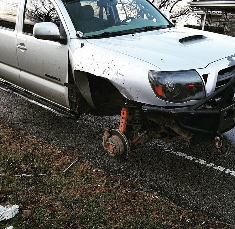

    It's a 2wd, there's your problem. And that's not a BORA or spidertrax spacer. Probably some eBay special with cheese grade studs

    Not mine; thank god.
    There was a member on here that had a name brand spacer and he had the lugs sheer off on the highway. No thanks. (I'm trying to find the thread)
    EDIT:
    https://www.tacomaworld.com/threads/the-rectified-prerunner-build.155157/page-179
    https://www.tacomaworld.com/threads/wheel-spacers-be-smart-with-them.314604/
    http://www.jeepforum.com/forum/f9/tire-fell-off-going-down-road-wheel-spacer-failure-1054227/

    I thought this member was running with a sheared stud and this was the result? I didn't think it had anything to do with the spacer itself
