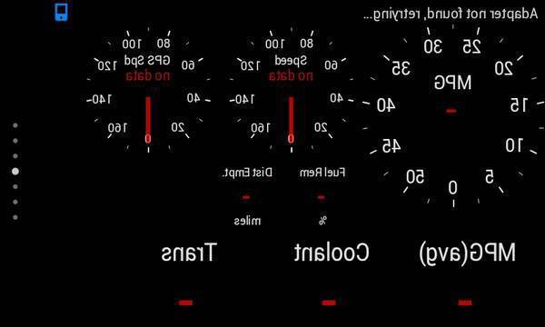

    Here is what I have set up at the moment on my real time display (not connected to the OBD when I did the screenshot so showing no data.) I really don't need the speed info but want to get a feel for how the GPS speed and the OBD speed line up. There is also a gauge that will display the difference between OBD and GPS speeds.
    The fuel remaining and distance to empty are a bit disappointing as they are calculated by the program and not provided by the OBD. You have to input the % remaining fuel in the vehicle profile and that will drive those displays. It is ok I guess, but not as good as it could be.
    The Transmission sensor data may not be accurate for my 5-speed manual. I am not sure if the transmission has a sensor! The PID (that is the programming behind the displayed info) I used was one I found for the Tacoma's with automatic transmissions.

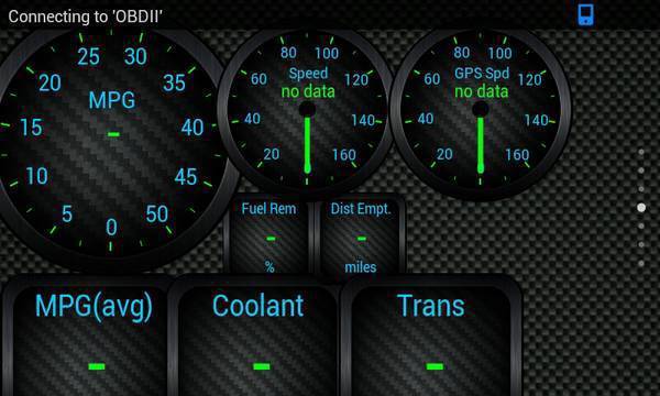

    Different Theme - same screen

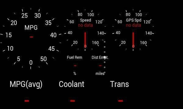

    There is also a HUD toggle-
    In the above screen shot you can see there are 7 screens available to me to display real time information. This can be set as anything from 1 to 15 screens (odd numbers only) so there is the possibilty to dedicate screens to groups of sensors. 15 screens would be way more than you need.

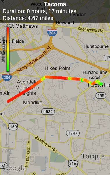

    Trip log - This is a trip log on google maps. You can show on basic map as here or on satellite map. The trip log is automatic unless you disable it. This log is tracking speed only but you can add any sensor you wish to the log.
    When you zoom in you can see each data point.

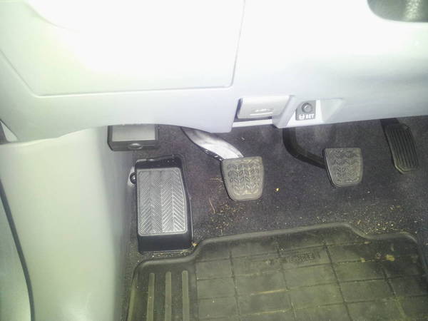

    Can anyone post a pic on where the BT unit hooks up to?

    The exact spot depends on the year I believe, my 2013 is left of the driver knee, about half way from my knee to the door. When the unit is inserted, it sticks out under the lower dash cover about 1/2 inch.

    Here - it is the small black rectangle

    That looks like it sticks out pretty far....Or is that just the camera angle?

    That's the bluetooth unit or the unit that it connects to? Never been under there so I don't know.

    OBD2 port.

    It is just the camera angle. On the 2013 it only sticks out 1/2 inch, may 1 inch. Not much at all.

    That is the blue tooth reader. The port is under the lower dash so you can't see it.
