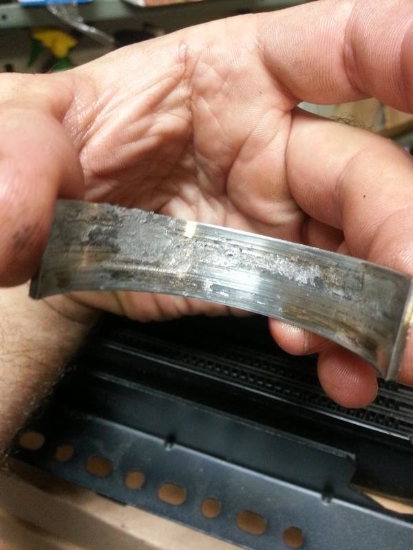

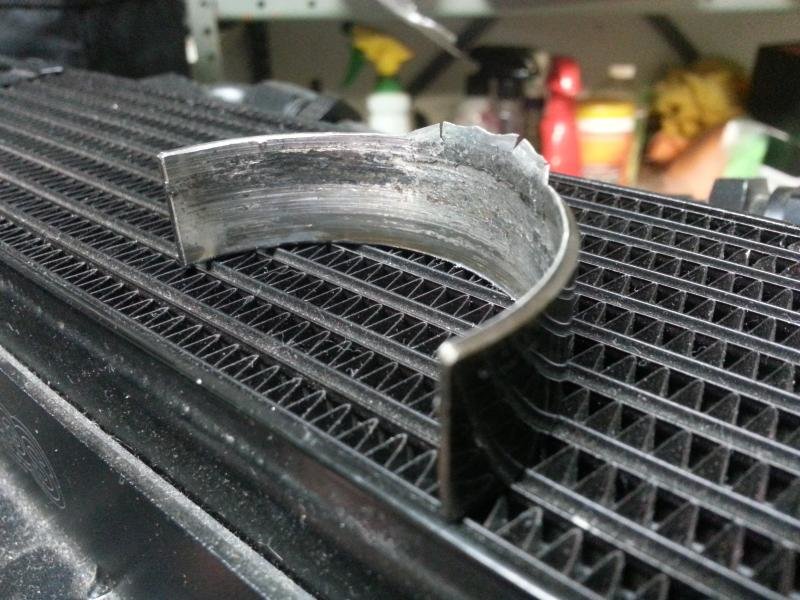

    #3 rod bearing, cap end.
    Rod end.

    That is fantastic stuff there...I'd call it mint.

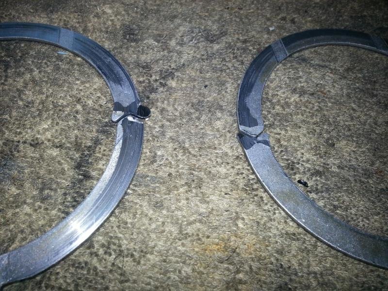

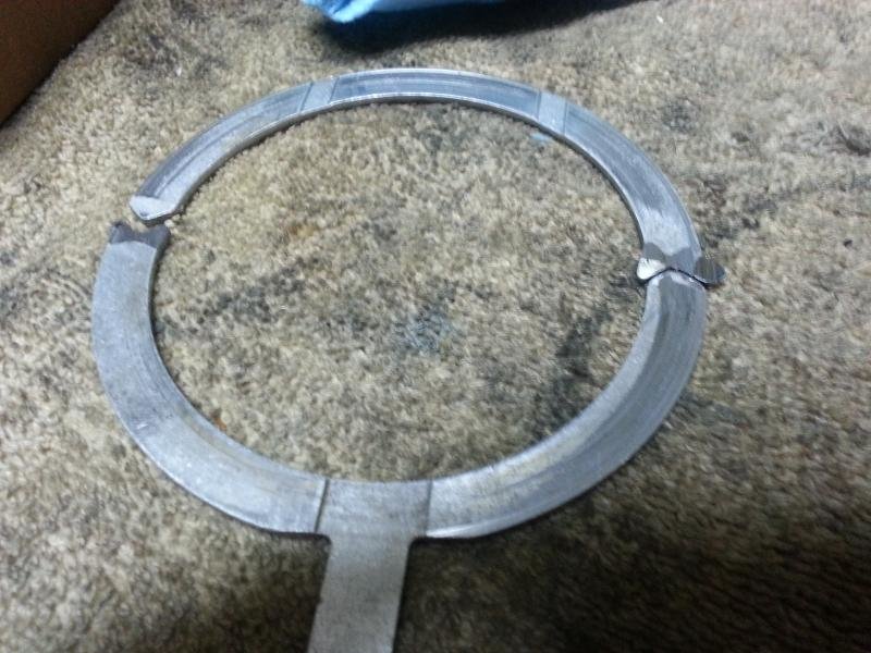

    These are the thrust bearings. These are the Clevite brand. Similar to the OEM except that when I was trying to install them on my stock engine, I noticed that the interlocking ends would butt with over a 1/16" gap before the main cap was seated.......I chose to install OEM thrust bearings because if that.
    This is what happens to them when the don't fit properly. The Clevites:
    The interlocking ends get squished apart. Added friction and wear.
