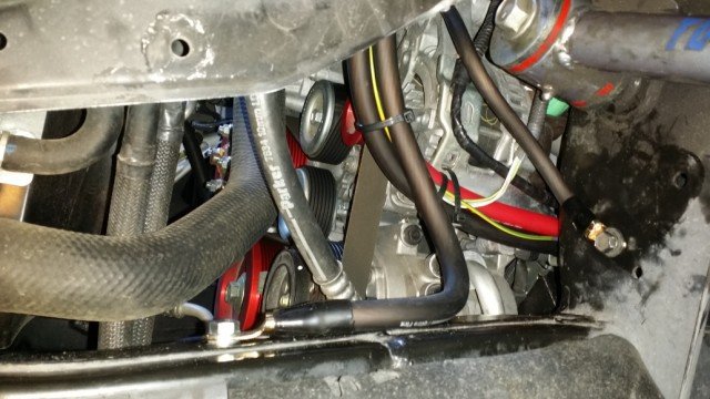

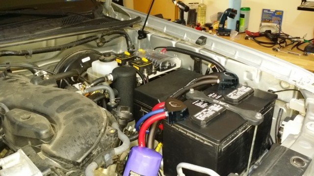

    Here you can see the ground wiring from the alternator and starter going to the battery
    dubo_7e078dee780fb7966c3d5b0ddd22717fc74deea3.jpg i

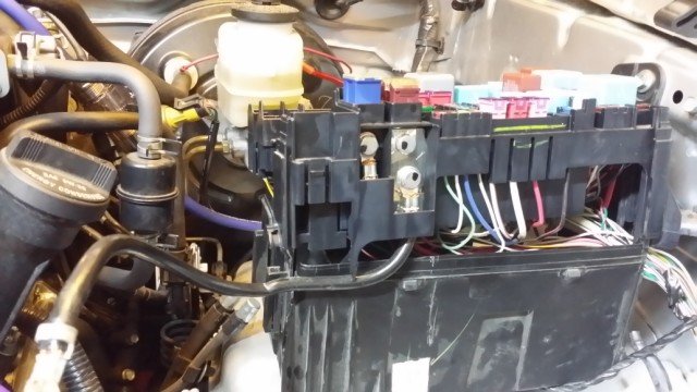

    And alternator to fuse box wire that I replaced3bqb_aabcf45c4baf1f9e7e3b2e4e974eafa59c0b6f00.jpg

    Those pictures are terrific! Thank you!

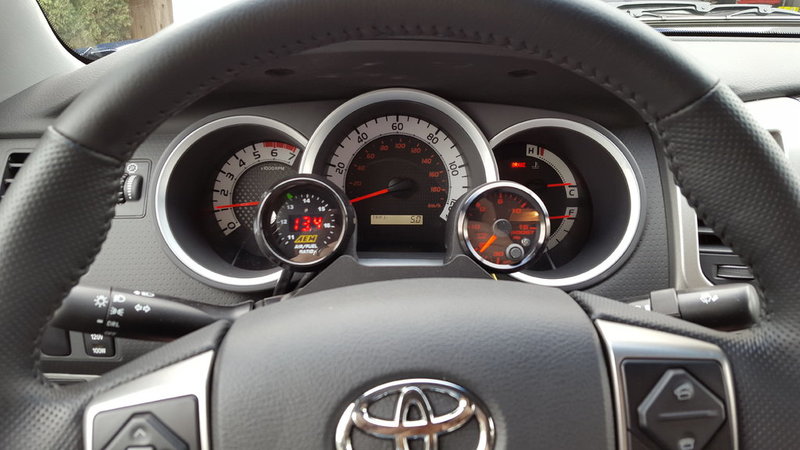

    Install went good! Neighbor came over and helped for most of the day, so i started at about 9 AM or so and pulled the truck out of the garage with no leaks at about midnight! Got the reflash the next morning, and installed intake, exhaust and Y pipe as soon as i got back home. Gauges are up and running, whew, you guys aren't kidding, I'm popping down to 10.0 at full throttle, hovering in the mid 11s while pulling hard.
    Just got down to Southern California after driving from NorCal all night. Driving back up on Monday, so its getting a nice break in!
    Installed-
    Hurst core shifter with hurst T handle
    AEM wideband
    Speedhut -30/+15 boost gauge
    TRD S/C
    AFE Stage II Si ProDry CAI
    URD Mark III 3" Exhaust (Didnt realize it was a magnaflow muffler...sounds awesome though)
    URD Ypipe
    To be installed-
    URD 2.85 Stealth pulley
    Doug Thorley Short Tube Headers
    And im still sitting on my Maf Calibrator...not sure if i want to install it or not...I might try to find a unichip dealer nearby for something more plug and play.

    The pictures...
    tmp_20794-20150803_1544591084411629.jpg tmp_20794-20150804_1257571838562764.jpg

    I used 1/0 for everything except the alternator to fuse box, that is 4 gauge. Red wiring goes to distribution block and starter, blue goes to fuse box and then to alternator, black goes to stock location, chassis and starter.
