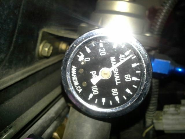

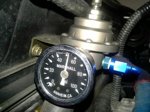

    Checked my fuel pressure the other day, after thinking about some performance issue. Or the basic lack there of, up top.
    I don't have a gauge normally attached to the FPR. When I installed it, I used the gauge to set it where it needed to be. Then I installed the sensor in its place. So when I hooked the gauge back up to it, I noticed something which confirmed my suspicions.
    At some time in the past, one of the shops that had worked on my truck, turned up the fuel pressure. Which makes perfect sense as to why I was low on high rpm power, why my exhaust smelled so rich, why I was burning fuel, why my AFR's were in the 9's, and why my oil felt very thin and washed (at the last time that I changed it)
    Corrected it, and it has picked up quite a bit of zoom zoom.

    So you dropped the fuel pressure by about 10psi right?

    Correct. Was around 51 - 52 psi. Dropped it down to about 43 psi. Where it should be.

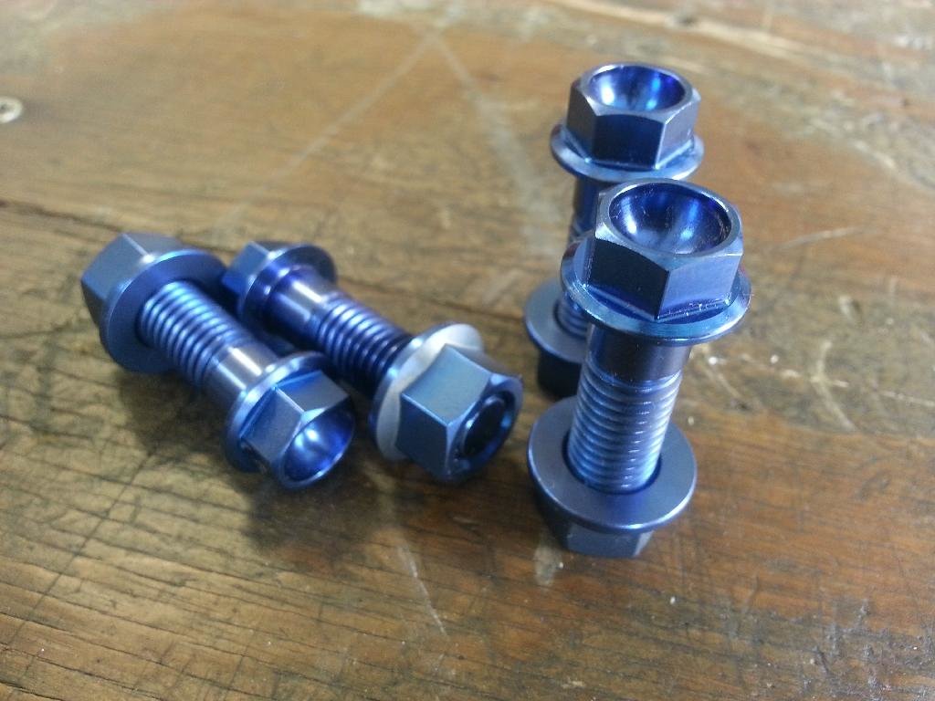

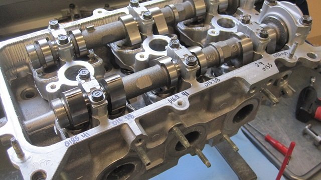

    During Clifford's turbo install, I donated my turbo manifold bolts to his build, since his were missing. Among other things..... It was the perfect time to upgrade to the ones that I have wanted for some time. Here is his thread - http://www.tacomaworld.com/forum/2nd-gen-builds/200243-x-runner-build.html
    Titanium bolts and nuts. Grade 8 equivalent. [​IMG]

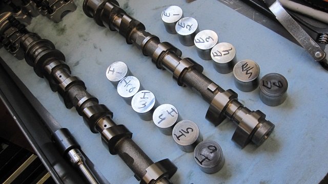

    Annnnnnnnnndddddddddd after way too long a wait, I finally have a few more pictures from Darton.
    The fabled Kelford cams! [​IMG]
    I should also add, that a new set of dual valve springs (SuperTech) was ordered because the original set, from when LCEngineering originally built this engine, was binding when the valves were at full open. New SuperTech springs are in and work as intended. :thumbsup: All of the intake bucket shims lashed out perfectly in spec, but a few of the exhaust bucket shims were out of tolerance. Those were ordered and will be in soon.
    Here are the specs of my camshafts, for a point of reference:
    Kelford Camshafts Stage 2 Turbo cams.
    Total duration 265 intake, 270 exhaust.
    Duration at 1mm valve lift, 225 inlet, 231 exhaust.
    Total valve lift with lash set, 10.55mm inlet, 10.75mm exhaust.
    The OEM total durations are 232 intake, and 236 exhaust.
