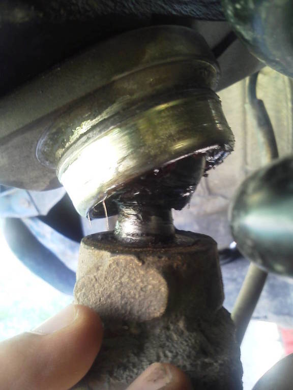

    Just to clear up som misinformation that i've seen thrown around since i've been on this forum.... the light racing upper arms WILL work with extended travel coilovers. in fact, if you unbolt the lower shock mount and continue to push the suspension downward (past where if would ever go with a shock mounted), the CV joint starts to bind before you max out the balljoint on the LR arms.
    below is a picture of the balljoint without the boot on it. the suspension is at full drop, with Icon's extended travel coilovers fully extended. the balljoint can continue to articulate past here until it make contact with the cup. this will not happen or be an issue however, as long as your suspension is assembled correctly and everything is tight. you are nowhere near damaging the balljoint with extended travel suspension
