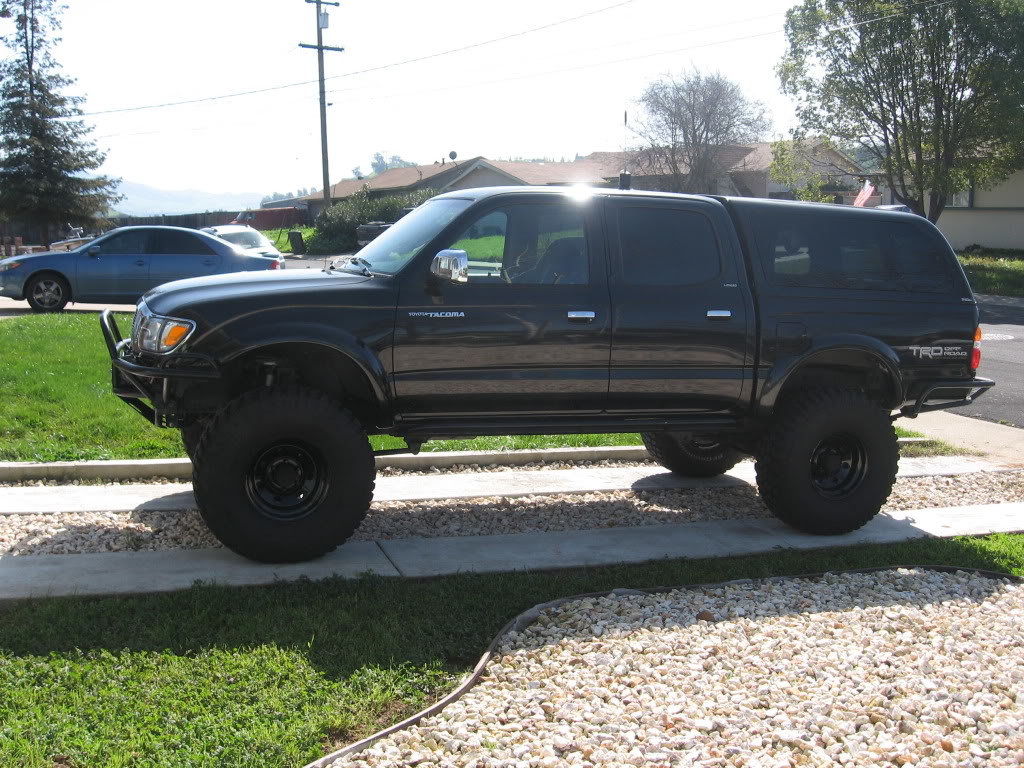

    man i got my date with the toyota dealership this coming tuesday, but but i hope nothing is wrong with my frame, i have shit welded on it, Stubbs Welding rock sliders, Demello Offroad rear frame reinforcements, and a few more things that was welded when i got the lift. i hope nothing comes out wrong b/c ill be so sad

    but my truck is not stock, i have alot of aftermarket parts on it, a few welded on there, if my truck does get a new frame will they take off my parts and put them on my new frame or will they not add it on. ill put some pictures up later, since i cant right now since my little brother wanted to drive my truck to show it off to his friends :D
    this is my truck but ill put some picture up later of the things that are welded on there
