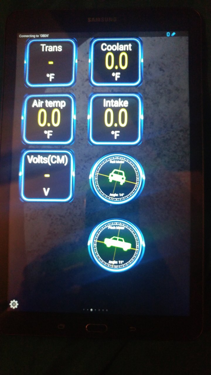

    Use OBD2 reader with OBD Fusion app and the Toyota expansion pack (make your own electronic dashboard), monitor on a tablet... below is my towing dashboard for the iPad:

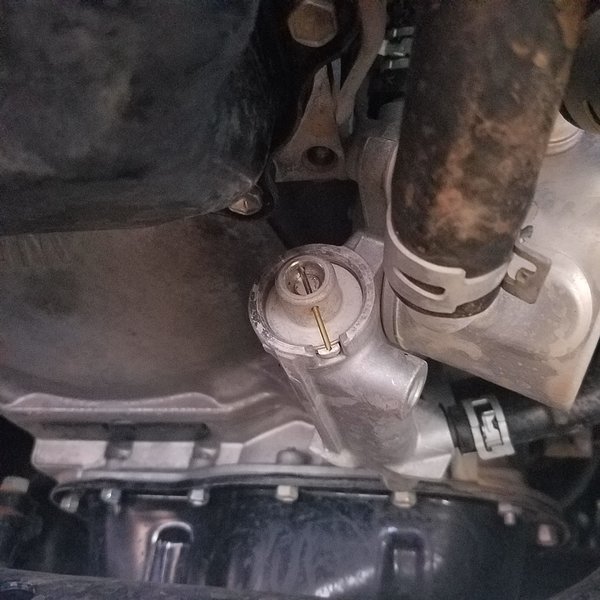

    Believe you need the tow package, but you just push in the thermostat and put a small nail in it to hold it open.
    Like so:

    Keeps temps low. Mine doesn’t get above 160*F on the highway.
    Do some research and decide if it’s worth it for you or not, but I like my trans to run below 180*F if possible.
    The stock thermostat is programmed to open/close to keep the trans temp between 195-210*F at all times.
