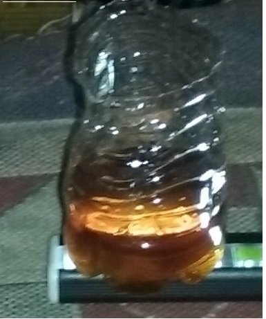

    I know this sounds bad, but had I not read this thread, I would have never known to change mine. I take such good care of the truck (this 2011 is my 4rth new Tacoma, the first one I put over 300K on, the second two under 70K each, and this one now has 137K... its by far my favorite though) and drive so smoothly I honestly have never had to do anything to any of them other than batteries, tires, and brakes really. I did have to do a left front wheel bearing on this one however at 130K. A friend did it for me. As an example of how I drive, I replaced the original front brake shoes at 120K and they still had a teeny bit of life left in them.

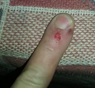

    So anyway I kinda got worried when I read this thread and went ahead and did the rear axle. Soaked it for a day with PB but still busted my hand like an idiot. I had gloves laying on the workbench too.
    Really easy job though. The fluid looked decent. It didn't have any viscosity to it though. I mean it was damn close to the viscosity of water really which is interesting. The magnet was basically clean, it had very little shavings on it.

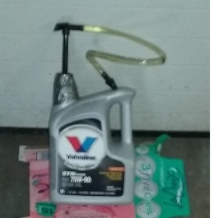

    Here's some pics, notice my pump. I bought the $7.99 one at Harbor Freight, used the extension that came with it, and then secured it to the gallon jug of Valvoline Synthetic ($45 + tax)... definitely the way to go vs the 1 quart bottles. Cheaper, less mess, and the pump with the extension was the perfect length sitting at the exact bottom of the jug. Using the duct tape held it perfect and made pumping it easy without the risk of my clumsy self knocking it over or something. I'll buy the individual quarts for the transfer case and front axle, but I'll pour them into the hole I drilled where you see I have the end of the hose stuck in now. Didn't spill a drop.

    My pump rig ($7.99 Harbor Freight special)
    ouch
