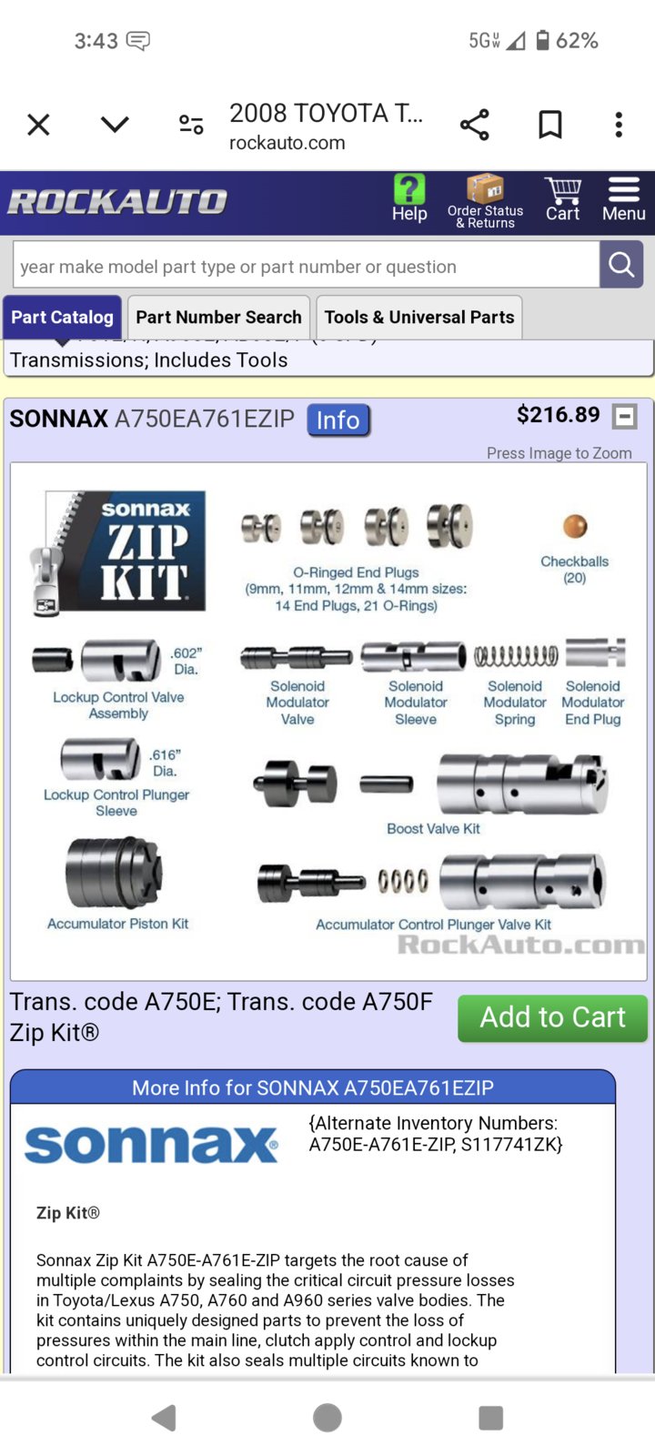

    Screenshot_20240531-154347.png$216 from RockAuto. They have the solenoids for $100 also. Don't forget to find some valve body gaskets. I still haven't installed mine. The LubeGuard solved a bunch of my issues.

    do you need reaming tools like the transgo kit? Or this kit just swaps parts?

    No sir . No reamers in the zip kit
    That's the benefit of the Sonnax kit .
    I wouldn't trust some guys reaming out a valve body using a cordless drill .
    Those reamers need to be perfectly straight when you open up the bores .
    Helps if you have a jig to hold the valve body .

    from the video I watched it includes a sleeve to hold the drill bit and reamer perfectly square to the valve body, but yes I wouldn't trust it to be perfect either. Also nice not having to flush out a bunch of metal chips.
