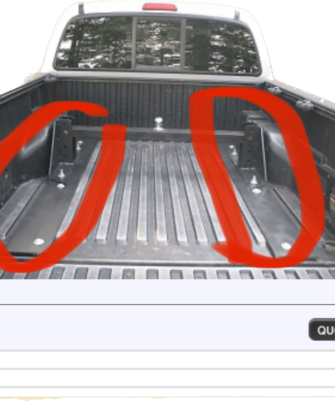

    I added an engineered crossmember to my old F150 (under the bed) - and then installed a "hidden" 2-1/4 hitch ball that was both super strong and easily removed. We modified the trailer fifth wheel by converting it to the agricultural gooseneck stem. Tubes and sockets are available for this. Eliminated a ton of hitch weight the truck must carry - and importantly - the ball will hitch and unhitch easily, even when the trailer and truck are grossly inclined to one another. Big problem for conventional 5th wheel outfits. Made it possible to use unimproved USFS campgrounds deep in the mountains - where it was tough to get everything on the same plane to connect. Lots of scrap lumber and flat rocks required. Before I made the change this was a huge PITA.
    When the truck was being used as a DD and other light truck stuff, it took minutes to stow the ball and leave a flat bed floor. I fitted the forward area ahead of the ball with a tool box that only came up flush with the bed sides.
    Add a Hayden trans cooler to it and don't look back.

    Thanks for the hitch info! This is the plan for the 5th wheel ball hitch. I think it can be done, like most things, just requires modification.upload_2023-8-9_14-42-26.png
