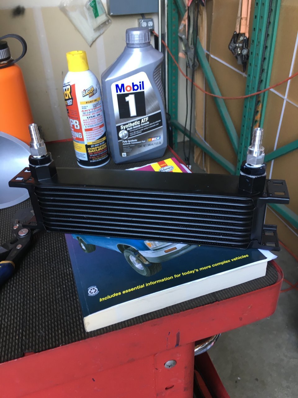

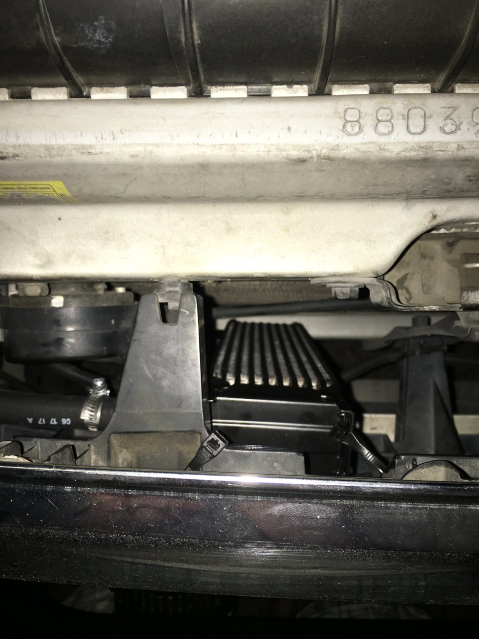

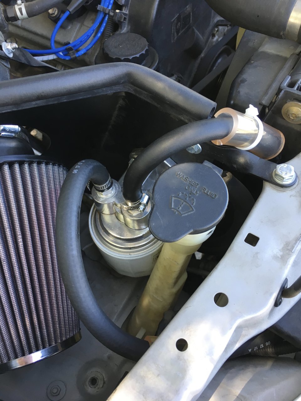

    I did this over a year ago and would easily chose the same brand again. https://derale.com I bought their in-line trans filter and one of their nice coolers. Don't hate on the multiple corner zip-tie method. It's still holding like the day it was installed. I took the opportunity to change the cooler hoses while I was at it. The vinyl tubing on the outside is a form of abrasion protection from metal edges. No issues with any of the parts I installed. I just recently replaced the filter after about 8,500 miles of use.
    Pretty cool to see the trans temp drop via my Scangauge when I hit the highway and the trans goes into overdrive. Overdrive plus all that air over the cooler and the temps drop fast.
