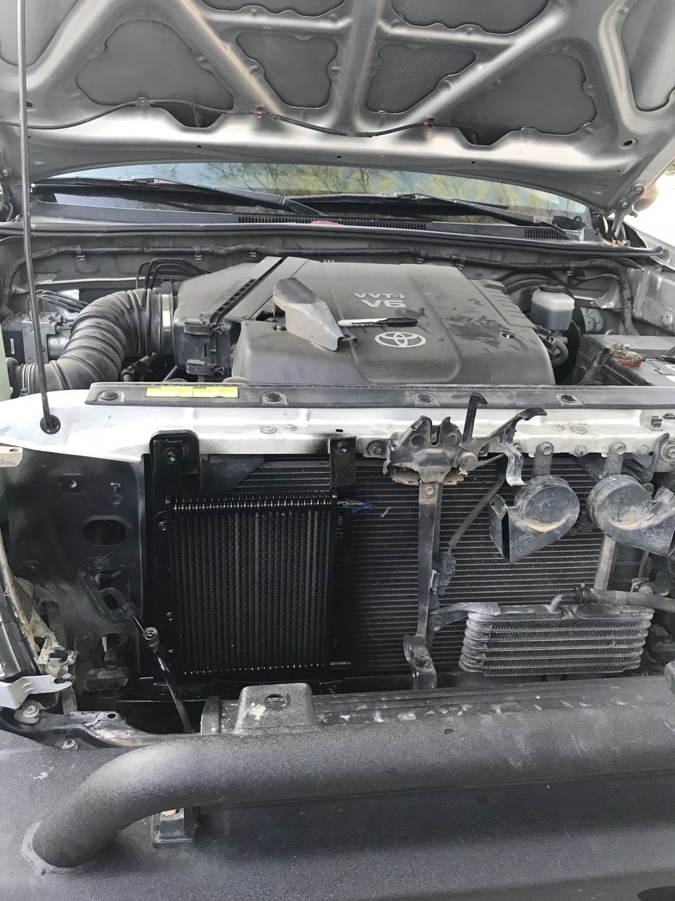

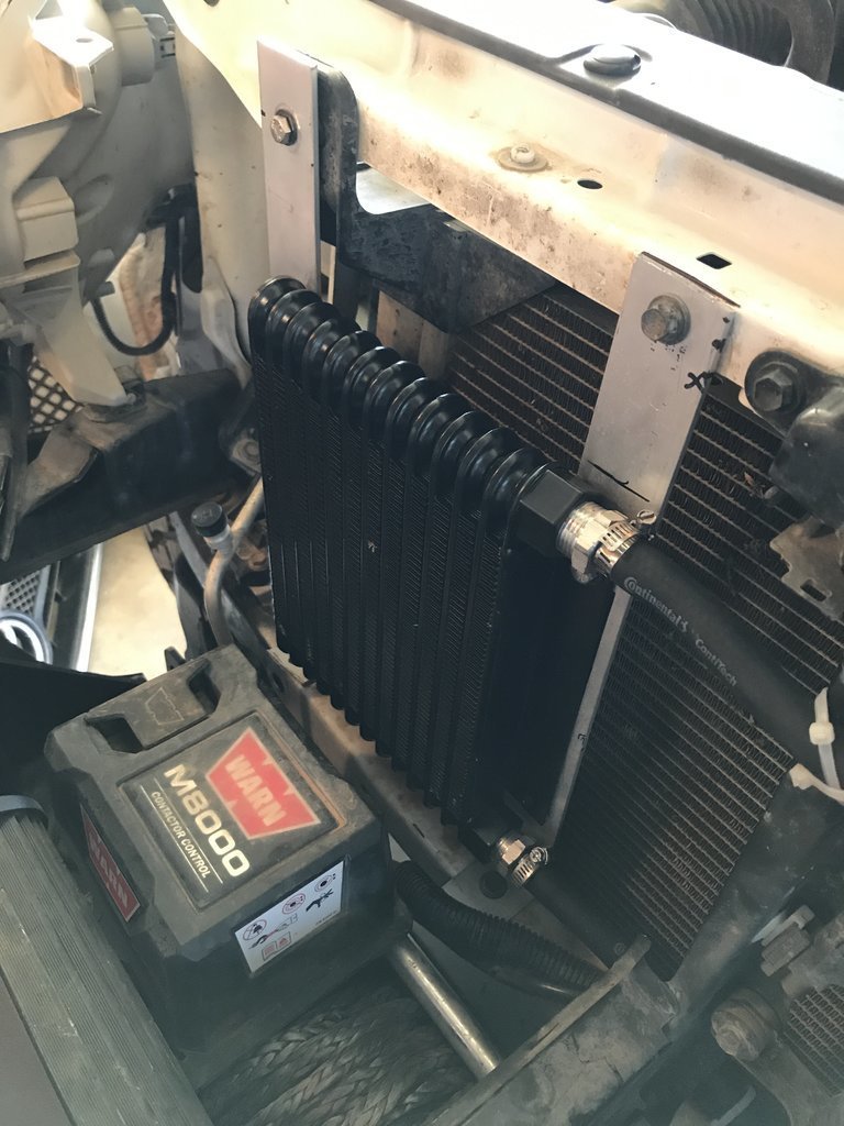

    I installed the 679 and noticed a significant drop in trans temps. I mounted mine right on the brace in front of the condenser. Perfect fit.
  12. Oct 28, 2017 at 6:20 PM
    anthony250f
    anthony250f Well-Known Member
    Feb 18, 2012
    #73066
    16,779
    Anthony
    San Diego, CA
    2008 dcsb trd offroad 4wd

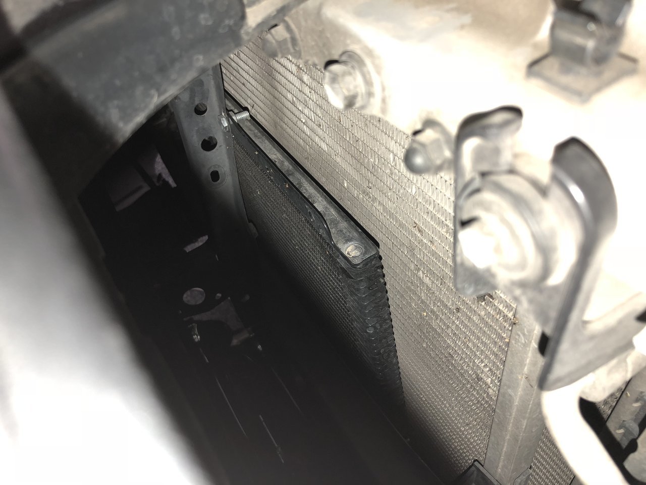

    Pics? I’m planning on mounting mine the same but it looks like the hood latch cross member might interfere
  13. Oct 28, 2017 at 6:27 PM
    Justinlhc
    Justinlhc Not looking for a relationship
    Jul 7, 2015
    #158945
    3,512
    I’ve posted other pics of it, but I just took these:

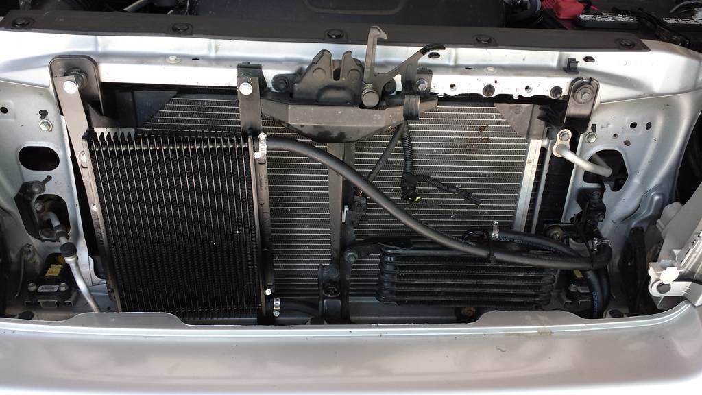

  19. Oct 29, 2017 at 7:02 PM
    #19
    anthony250f
    Feb 18, 2012
    #73066
    16,779
    Anthony
    San Diego, CA
