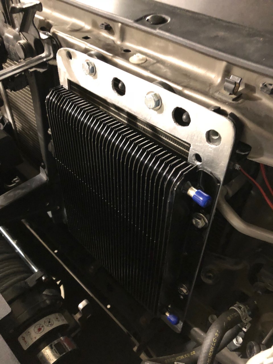

    Gearcruncher, First, thanks for the very helpful thread and useful info!! Next... I'm thinking of going with the Tru Cool LPD 4589 and no fan because of size and the 24K btu benefit. I don't crawl or climb slowly much with a load but will be doing a lot of "getting there fast" driving while towing. I can always add a fan later if needed.
    My question is with the LPD (Low Pressure Drop) or "bypass" built into the Tru Cool plate and fin coolers, does it matter how you mount them? Do the inlet and outlet fittings need to be up? Can they be mounted to the side? I've got a call in to Dana/Spicer/Victor/Glaser...etc. But I thought you would know.
    Please advise. Thanks!

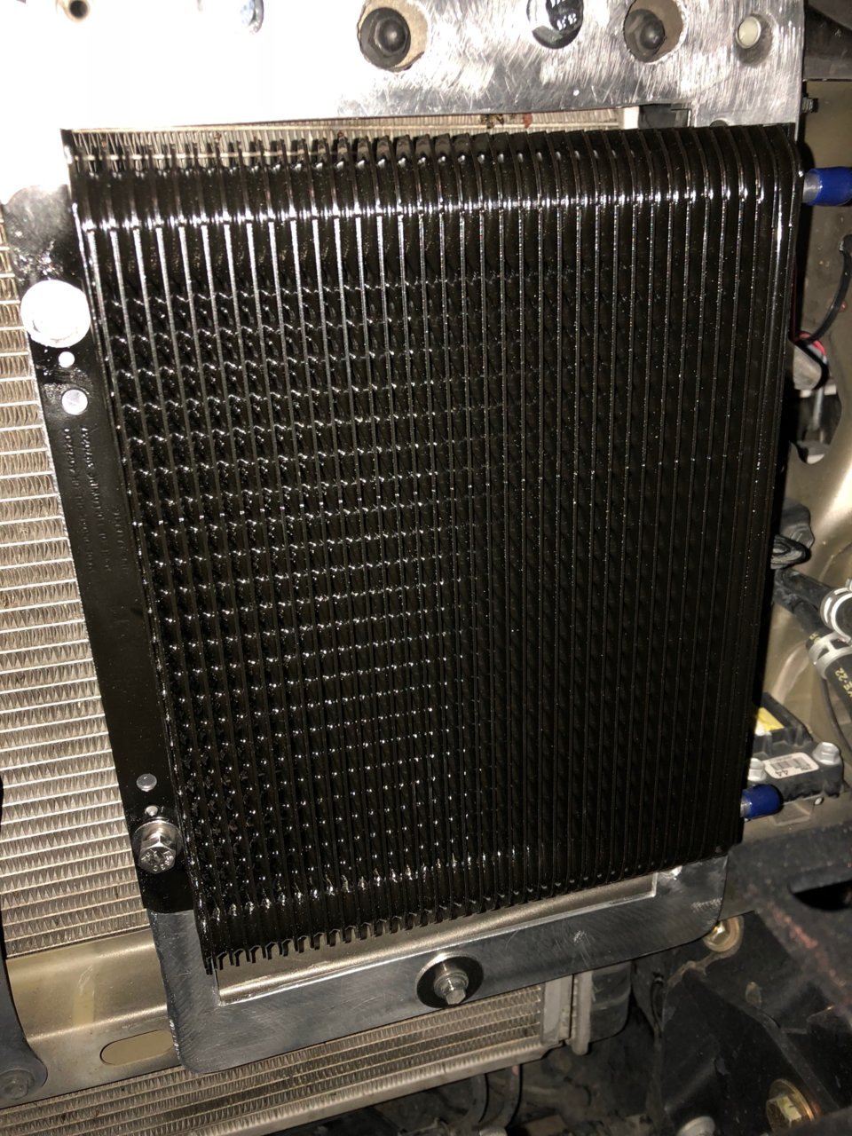

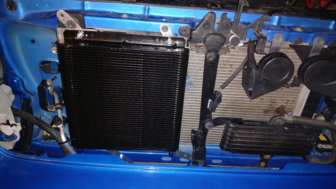

    I threw in the 4590 (28k model). Large, but was able to fit it. Made HUGE difference in my temps towing, and I run through the ADK's on long hauls. My fittings were on the bottom. I'm pretty sure with the Tru Cool you can mount them in any direction. Mine are both down and have been for almost a year. All is working fine.

    Cool! I finally did talk to the Tru-Cool guys and they confirmed your suspicions. Any direction is A-ok. I’m mounting mine to the side. I finally finished the bracket and test fit everything. Should have everything finished in a couple days. Your cooler is HUGE! Super low temps for you I’m sure.:bowdown:

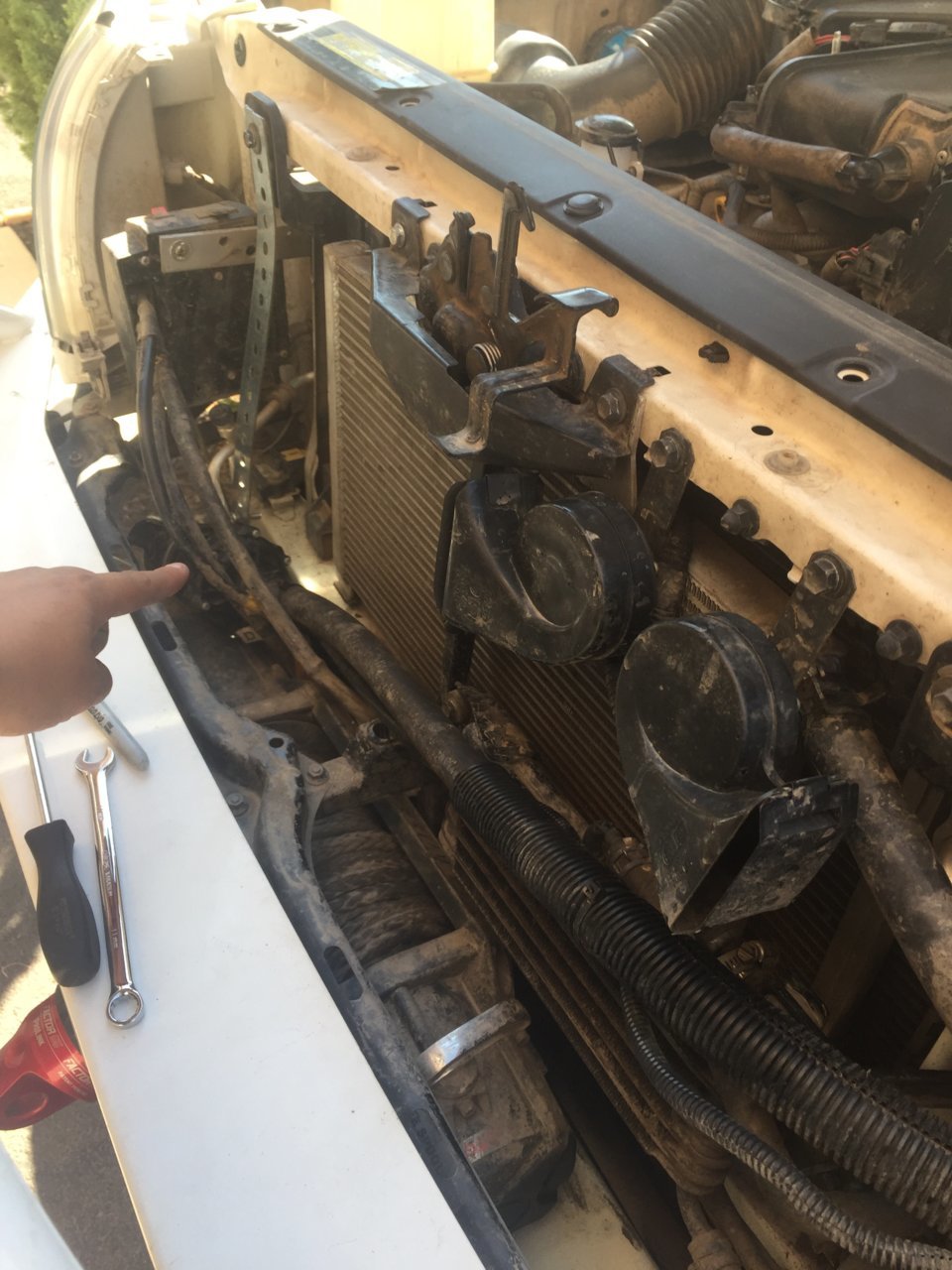

    Man you have all kinds of room! Just dump the old small cooler, move the horns, get the giant snake tube stuffed or tied forward and you should have plenty of space for the 24K gvw Tru Cool! I’ll post pics of mine when I’m done. My winch controller box sticks up way high on the left side so I can sympathize with what you’re thinking but if you strip everything down and move it out of the way....you can do it.

    Giant snake tube is for the supercharger.

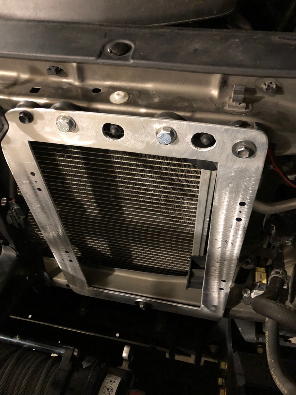

    Here’s a few pics of my test fit:
    Bracket, almost done.
    DC775BB4-CC3B-482B-B421-08F14ABF2770.jpg 3CD69F3D-7AE1-437B-A643-4DB5094E02F2.jpg I

    Go as big as you can. 1st gens have space constraints. My temps got kind of high before I added an additional cooler. Temps are way better with two coolers for me.
